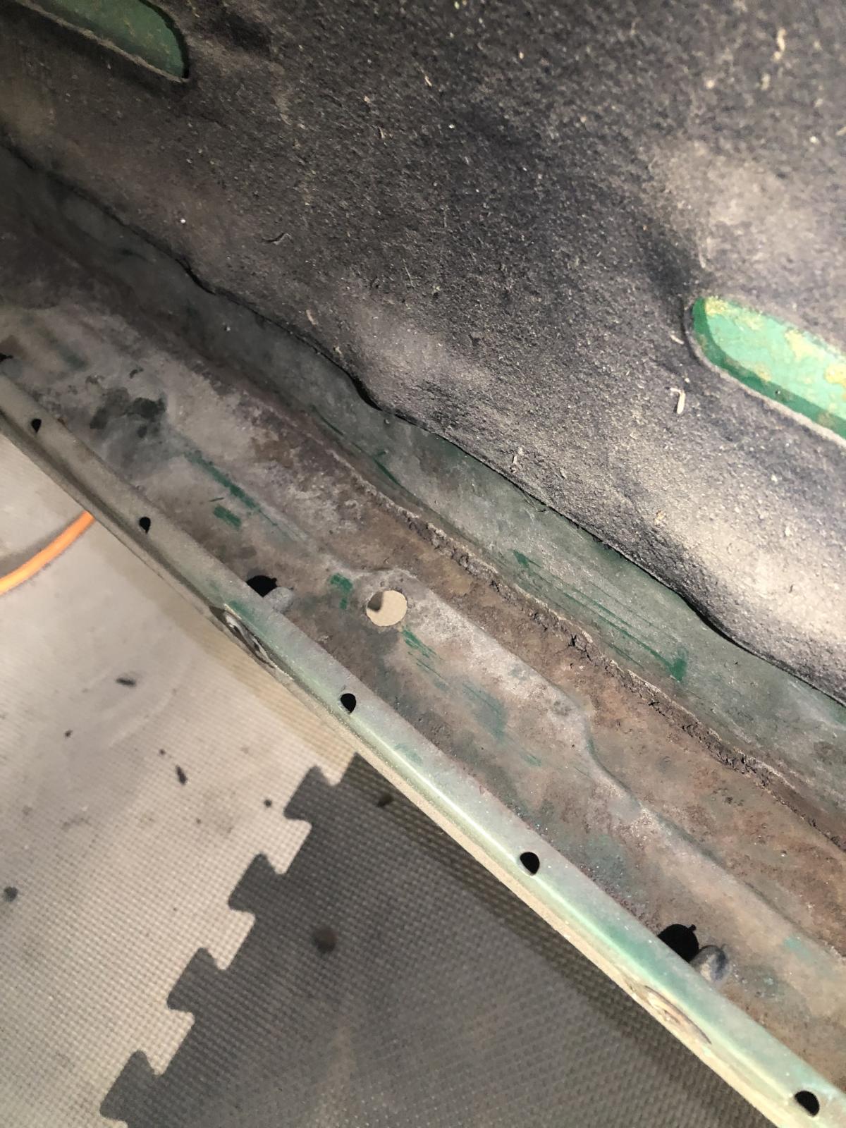

The body is in pretty damn good shape, which makes me happy. But the rust underneath and inside, well, that's a different story. I'm planning on making it safe, replacing all the necessary tin, and leaving the exterior alone as much as possible. But we all know where these projects tend to go Laughing
There is evidence of a few crappy floor pan patch jobs, but they didn't hold up well. The rear window seal was installed with a gap at the top of the window, which expanded to nearly 3 inches wide, allowing all of the Tennessee rain inside the rear of the car. Ouch. Typical rust inside the frunk and pillar areas, but the doors are good, heater channels seem to be in decent shape, etc.

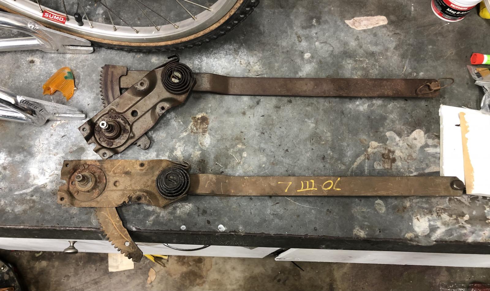

While I contemplate what I've just gotten myself into, I decided to tackle the stuck windows and hopefully get the regulators working better.
The driver side window was stuck at about 3/4 of the way shut, and the handle was on the drivers seat, still screwed to the internal gear shaft of the regulator.
I figured the only way to remedy this was drop the glass, remove the regulator, and find a donor to replace it. Of course I'll look into new rubber, scrapers, felt, etc. while I have the door apart.

I've spent several hours already reading previous posts about window regulators and them binding, but can't seem to figure out if it's possible to get the regulator lubed and moving again without removing it and the window glass.
I'm guessing that since the seals/scrapers are just garbage at this point, the only way to get the system properly lubed and working is through removal.

Found a window regulator pretty much locally from another member here, and it was shipped and delivered within a few days. It’s the lower one in this pic.
Did a slight rust removal/cleanup, lubed and greased all the contact points, and had it ready to install.
It’s from a great year!
Didn’t photograph the install, but I also cleaned and lubed the chanel on the bottom of the window, and transferred the spring/clip from the old regulator.
After fitting the glass into the window channels, I slid it down and placed the regulator clip into the lower channel before mounting the regulator in its place.
Worked a charm, and the glass goes up and down smooth as butter.

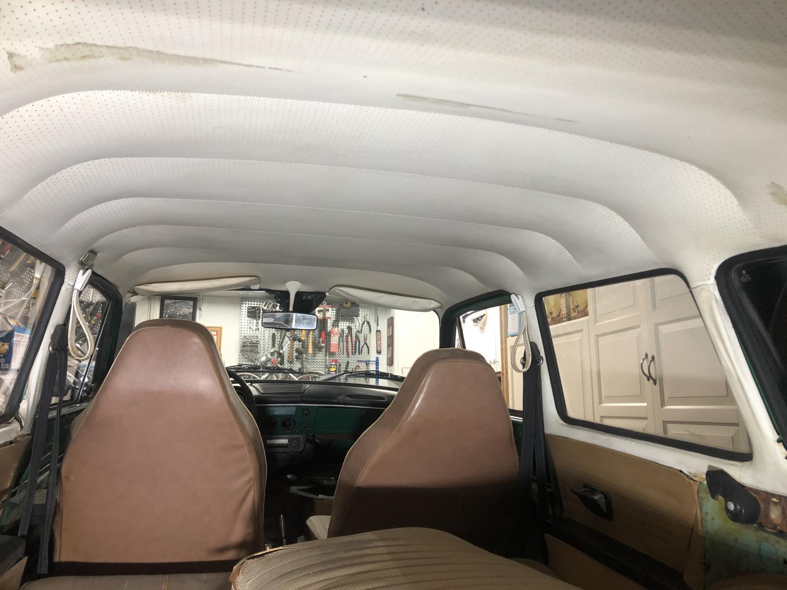

PostPosted: Mon Dec 18, 2023 8:40 pm    Post subject: Re: Another Pickle Post - 1973 Squareback Reply with quote
Cleaned up the headliner. I’m amazed that there are no rips to speak of, just a weird narrow stain across the back a few inches wide that feels like glue.
