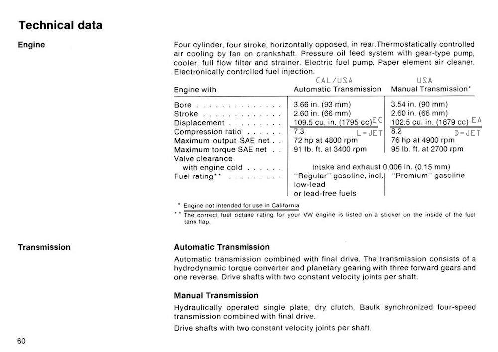

PostPosted: Tue Jul 02, 2024 1:17 am    Post subject: Re: Bad news about the VW/Porsche 914...True/false? Reply with quote
johnnyvw164 is correct.
the 411/412 two door fastback was not grey market in the USA.
the way it went was
411/412 Variant and 4 door were exclusively auto gearbox in the USA.
the fastback 2 door was exclusively a manual box in the USA.
(it was different in the rest of the world, you got your manual boxes in all the variations generally speaking).
the variant and 4 door vastly outsold the 2 door as the USA market preferred the autobox cars in the big VW. thats not to say they were the better variations.
people of discerning taste would have been going for the 2 door.
a bit of a sleeper. don't doubt for a minute it would have given a bog standar 914 owner a fright away from the light. no strange moment trying to find 2nd gear.
in 1974 the last year of manufacture and sales the 2 door fastback was excluded from sale in california but was available in 49 states as it only met USEPA emissions standards and not californian standards. it retained the 1.7 D jetronic injection system with the 4 speed box. only the variants and the 4 doors were equiped with the 1.8 L jetronic mated to the auto box. the 1.8s were sold USA wide. not entirely sure on emission set up differences for 1.8s but in california at minimum they had EGR. not sure if EGR on 49 states L jets.
the last of the european 412s were fairly interesting. in 1974 they had the twin carb high compression 1.8 AN engine same as the euro 74/75 1.8 914. 85hp stock.
the most powerful VW aircooled sedans ever marketed (if you don't count the 914 as a VW Very Happy ) good enough to nearly give a USA spec 2.0 L 914 a run for its money.
we found all this out and verified it looking deeply into the 74 L jet 914s.

PostPosted: Tue Jul 02, 2024 3:49 am    Post subject: Re: Bad news about the VW/Porsche 914...True/false? Reply with quote
fahn fahn fahn on the autobahn. Very Happy
as you can see from official owners manual in the glovebox.
the pretty little fastback with a 4 speed box.
official USA merchandise.
check your own archives on this website.
the glove box manual is listed as a pdf right here.
where i got the info.

PostPosted: Tue Jul 02, 2024 10:49 am    Post subject: Re: Bad news about the VW/Porsche 914...True/false? Reply with quote
Thank you for that kind of information.
I´m only wondering about the dates for power and engine types.
As far as I know, or have seen up to now, in original VW manuals, the EA-engine has 1679 ccm, D-jet, 80 hp and the 1679 ccm 72 hp D-jet EB-engine was for california only (at least till model 73) and the 74 EC-engines had 1795 ccm, L-jet and 76 hp for model 74 412 and 914.
Maybe there is something wrong in this especial owners manual.
suggest for 411, 412 US-models:
V = 1679 ccm, dual-carb, 68 hp
Z = 1679 ccm, dual-carb, 68 hp
W = 1679 ccm, D-jet, 80 hp
EA = 1679 ccm, D-jet, 80 hp (USA)
EB = 1679 ccm, D-jet, 72 hp (cal only)
EC = 1795 ccm, L-jet, 76 hp (USA + cal)
914 USA
914 with 2 litres, USA
GA = 1991 ccm, D-jet, 95 hp
GC = 1991 ccm, D-jet, 88 hp
Addition, in germany, the 74 model 412 cars came only in 2 versions of two carb-engines with 1795 ccm: AN with 85 hp or with lower compression AT with 75 hp, allways at 5000 rpm.
The german 914-4 models had W, AN or GB-engines, 80, 85 or 100 hp.
