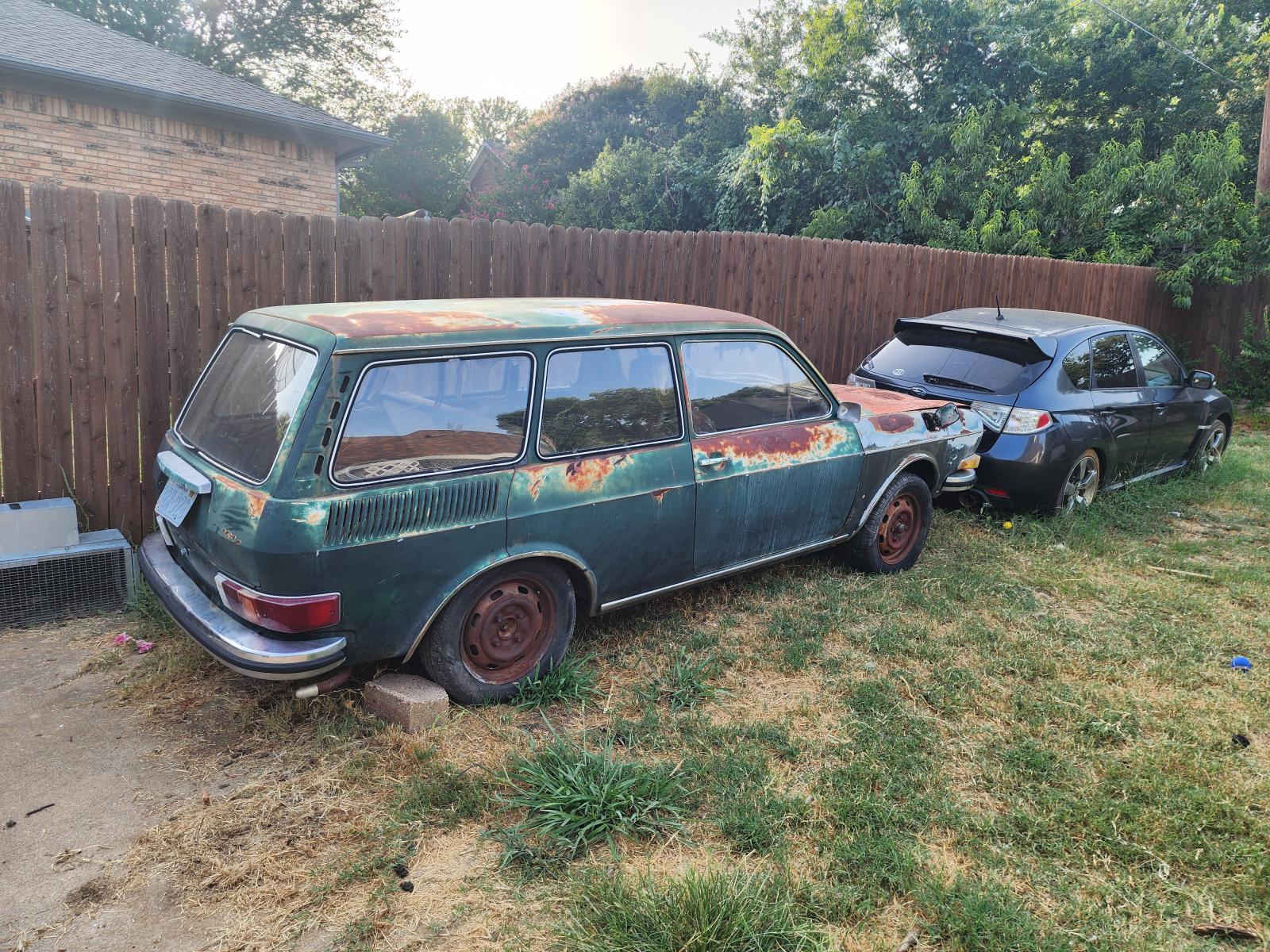

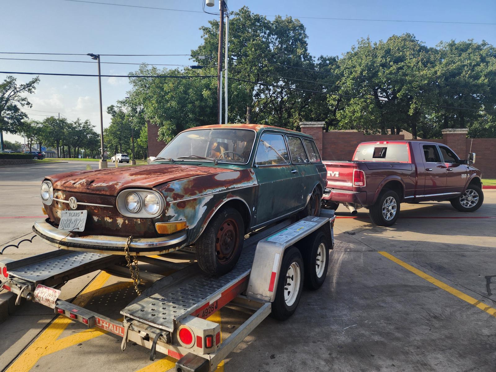

Hello everyone!
I've always liked aircoolers, but never owned one until a few weeks ago. I picked up this 1971 411 wagon from a friend. It has been sitting in a field in Texas since 1987 or 1988. I have started to dig into the car and get replacement parts. The body is in great shape, the front fascia and the front of the spare tire well has some perforating rust but not too bad. The floorboard where the battery goes under the driver's seat is gone, but the rest of the car (and chassis) is solid. Suspension moves freely, shocks are in working order and pass a jounce test with flying colors. To my surprise, the wheels and brakes were not seized and the vehicle rolled freely on and off my trailer. There are tons of issues with the car, mainly the entire interior upholstery.
I will be manual swapping this car, and have already purchased the pedals, clutch master cylinder, and the elusive 004 transmission itself. I am still in need of the rest of the parts, mainly shifter, shift linkages, and related parts. I have a member now looking through his collection for a complete 210mm clutch kit and flywheel.

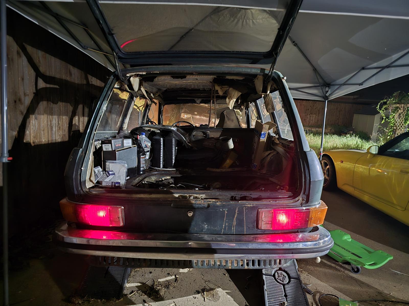

I then started to get the car's electrical system repaired as best as I could. Fortunately, most of it was still there and unaltered. I replaced the fuse box and all the relays and fuses on it. Using the wiring diagram, I made sure every wire was in its proper place. I replaced all the exterior bulbs save for the headlights. I have 3 relays in the fuse box, but there are two more slots with wiring going to them. I am not sure if there is another relay I am missing, I believe the door buzzer fills one of those slots.
After triple checking all the wiring, it was time to give the car battery power for the first time since 1987 or 1988!
I replaced the ground cable, put the battery on the ground under the floorboard where it should be, and hooked the terminals up. This hole will be repaired of course. Turning the key, I started checking everything I could. The headlights, taillights, and marker lights work! The hazard switch lights up, but the hazards and turn signals flash very strangely, extremely quickly (way faster than your typical "bulb out" flash) or sometimes not at all. I suspect that the used flasher relay I put in is bad. The wipers work, on both speeds too! The interior lights flicker when turning the dimmer switch, but don't light up strongly. I suspect the dimmer switch is bad. Turning on the blower motor/heater (not the gas heater), the switch lights up but the blower motor does not turn or make any noise. The high beam switch and turn signal switch both function. The turn signal indicator on the instrument cluster does light up, as well as the generator light.
Turning the key to the start position, nothing happened. I took off the shifter bezel and found that the metal piece that is supposed to contact the neutral safety switch was not springing out. I checked the resistances, and bypassed the switch to get power to the starter. Unfortunately, the starter clunked but did not turn the engine over. It is completely locked up, not surprising though due to the time it had been sitting outside in a field. I'm going to soak the cylinders in ATF and try again in a few days. If that doesn't fix it, I'll pull the engine and rebuild it!

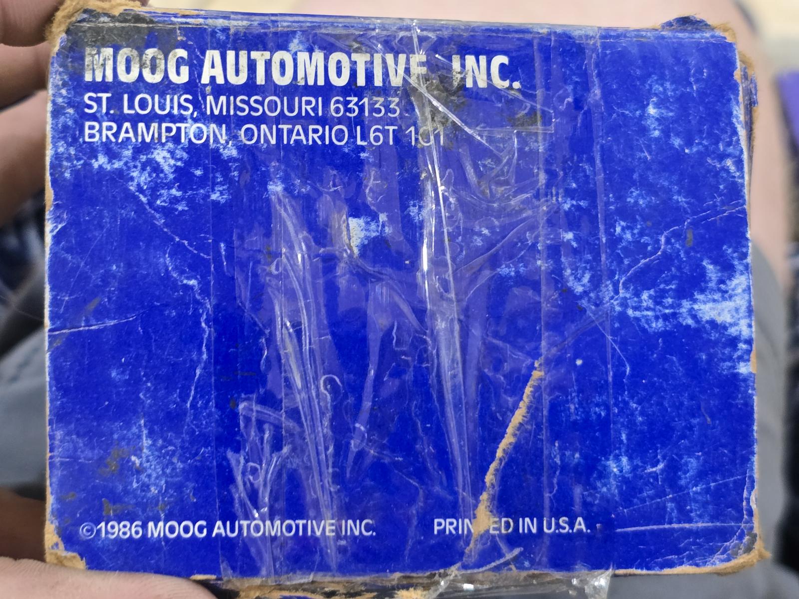

So, a little update on these ball joints. I have removed them from the package to inspect the condition and make sure they're correct. The seller on ebay did list them as fitting my 411. I haven't installed them yet, but the shape and size look correct for a Type 4.
The rubber boots are in remarkably good shape, even when pulling at the extra part sticking up out of the retaining rings with my fingernail I couldn't get it to peel, crack, or tear. The ball joints are MOOG part number K9037. The other box did not have the rest of the label torn off, and there are no numbers after that, I just happened to get a picture of the torn label instead of the intact one. I have not been able to find them in any online MOOG parts catalogs, not even the vintage ones available for download. The box says "same as KF 45" and "Made in Germany"
The box is dated 1986:

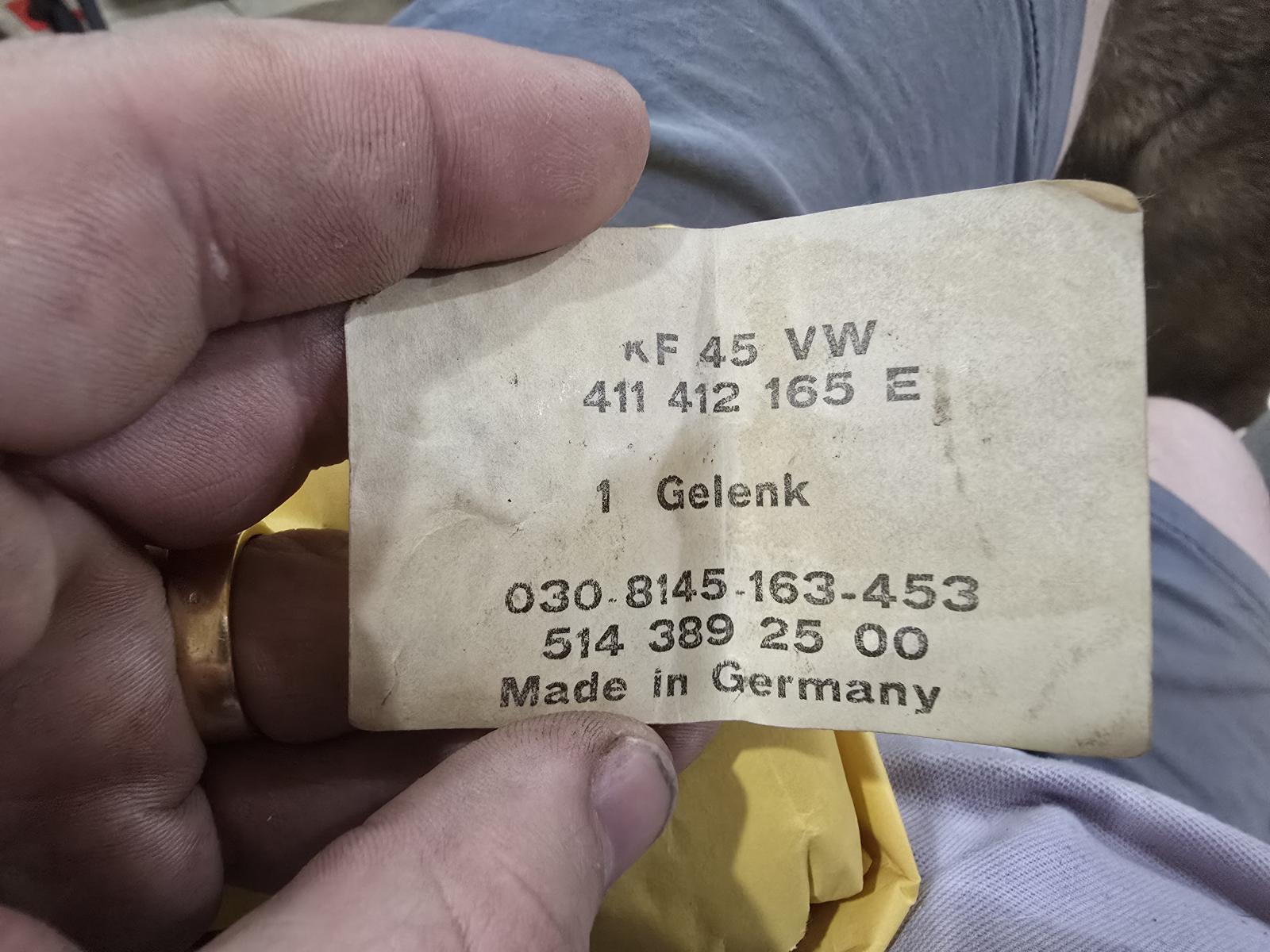

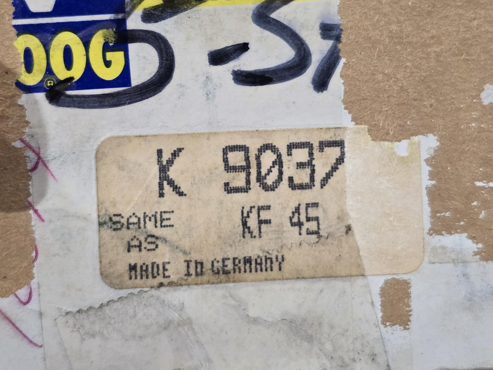

Now for the very strange part. In both of the boxes there was this tag, which appears to have some sort of adhesive on the back. It seems like an OEM VW parts box label, complete with the part number of the ball joints themselves and "1 Gelenk" which is German for "1 Joint".
I am not sure if MOOG was an OEM for VW at one point, or if they got these from VW's OEM manufacturer and re-boxed them as their own (I'm leaning towards the latter). Here's the tag:

Sorry for the delay in answering.
Yes, those are correct for vw 411 and 412. I have never seen one in a MOOG box. That does not mean that they were actually produced by Moog. That symbol on the rubber boot between the numbers is a manufacturers trade mark and I cannot for the life of me remember who they were. Oh.....wait....I believe that is an "Ocap" logo. An Italian company that made OEM ball joints and tie rod ends.
But.....you need to show us two more pictures please. Look on the inside of the back of the joint. Is it completely cast iron or is there a swaged on steel cap?
The steel cap versions which had a spring inside similar to many other ball joints and tie rod ends ....was likely made by Ocap. The later all cast parts....I believe....were made by TRW.....and TRW is owned by Moog (Federal Mogul).
If your joint is fully cast....with no cap inside and I believe it is....the boot having an Ocap logo simply means they are all using the same boot which they do and are just using Ocap boots.
So.....we also need you to unscrew the nut and take a picture of the end of the threaded stud. From the part #, you should see a small dimple on the end with a line intersecting it.
The part # you have....if that piece of paper is correct....411 412 165 E...means that they are special "eccentric" ball joints used for correcting the castor angle on the car. The normal part # is 411 412 165 C.
They will work just fine but you need to put a wrench on the end and orient the engraved line to straight forward for 0 additional castor.
But....these are a very good thing to have. The 411 and 412 are notorious for having n9t enough castor from the factory. The lower subframe has an adjusting feature to allow you to equalize the existing castor between left and right sides but it does not give you any extra castor. These joints should give you somewhere around an extra degree.
Other things you need to do. I learned long ago why these ball joints have a built in hole in one side (inner side). It's a weep hole because water leaks between the joints where the strut tube is bolted to the steering knuckle above it. It causes massive rust in the long run....insuring you will need a prybar and 5 lbs hammer to take things apart.
So....I have been putting gaskets between strut and steering knuckle and steering knuckle and ball joint. When you are ready I will explain the simple way to do this.
Once that space in the back of the balljoint is sealed.....put a grease fitting in it. Then drill a 1/8" hole dead center in the back of the joint inside of that cavity. So once it's bolted together and sealed up you can pump the joint full of grease so it will last pretty much forever. You need to do this because these joints are rare.
I will post pictures of how the eccentric joints work in the am.
Ray

Aztecducky wrote:
Hello Ray,
I really appreciate the knowledge. I'm assuming installing the gasket just involves cutting one out yourself, which i have done on many projects in the past. Should the gasket material be rubber?
The ball joints are fully cast, even on the bottom. There is also a dimple/line on the top for caster alignment indication. I remember seeing your thread about the ball joints a month ago or so. Good information there! I will definitely be installing grease zerks and drilling a hole in the bottom to keep them greased properly.
I wonder why there were what appears to be OEM labels in the boxes with the ball joints.
The gaskets work really well but you need to use gasket paper that is as thin and hard as you can get it. I can give you a part # that NAPA readily carrikes for 1/32", fuel proof gasket paper.
But hold off....give me a day and I can show you a better way than gaskets.
At one point in time I used RTV to seal with the object is that most RTV is too soft to resist the greasing pressure and you tyoically get it on too quick. The surfaces of the top and bottom of the steering knuckle are machined very precisely. The ball joitn flange is a little less so. With about 2 minutes of lapping the joint on a flat surface (I use glass) with 600-800 grit paper to make ure you have no big grooves is all it takes.
Then coat the face of the ball joint flange and top and bottom of the steering knuckle with a thin coat of Motoseal or Yamabond and let them dry. Then give them another coat and let them dry.
Since they are ~65% solvent, this gives you about 0.0015" to 0.002" maximum thhickness for sealing and that is all it takes.
The problem with using gaskets I have found is that they have to be thin and hard or the bolt tension after a while flattens the gasket out and the bolts get loose.
Ray
