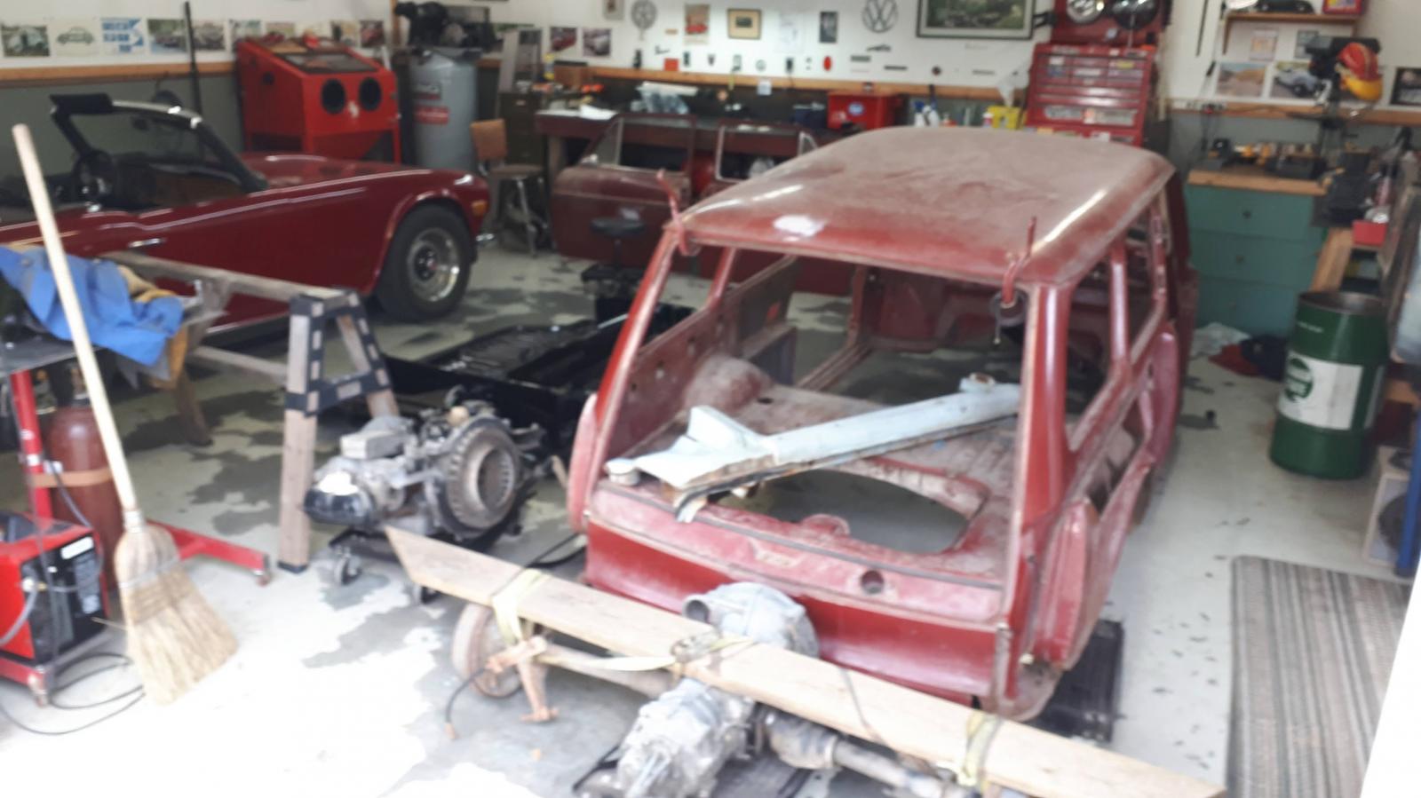

PostPosted: Sat Oct 19, 2024 11:35 am    Post subject: Re: Square back resurection Reply with quote

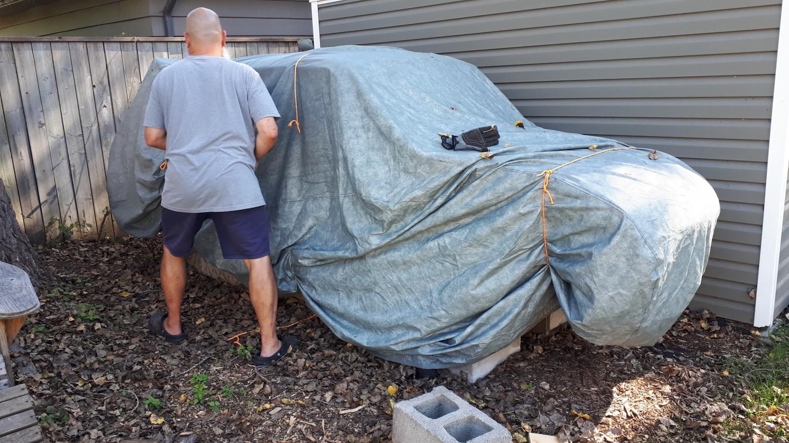

So today we loaded up the truck (trailer actually) and moved the body to my place.
Where the chassis was already waiting
Things are a bit of a mess right now but I will sort things out and start planning my attack

Great looking project. I will second the get it rolling part. Pedals, wiring, gas, brake lines shifter bushing are so much easier before the body gets bolted down.

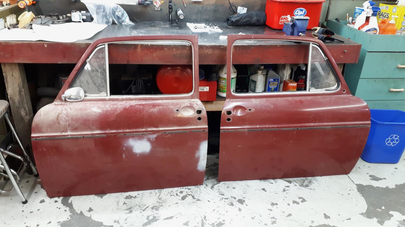

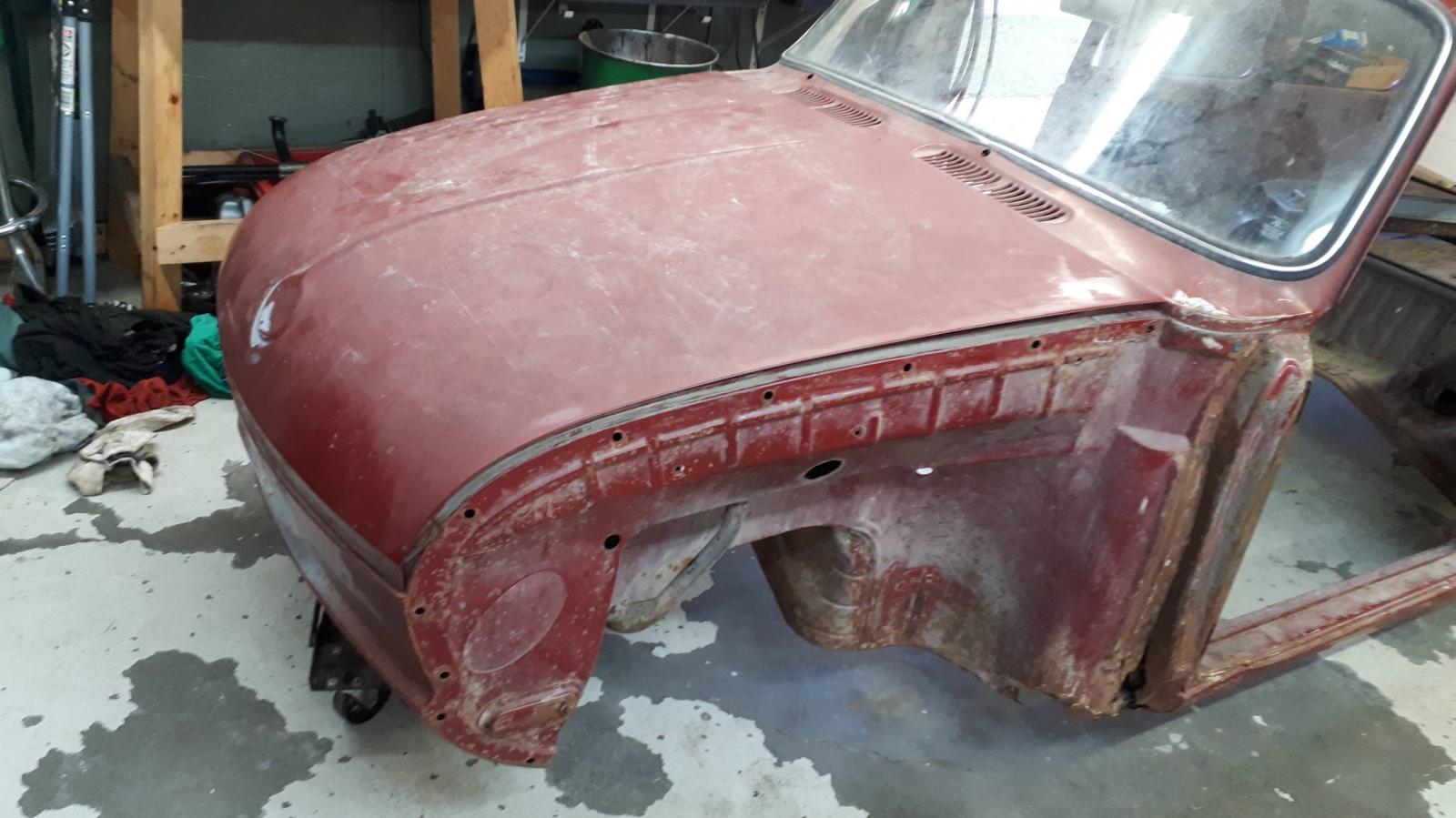

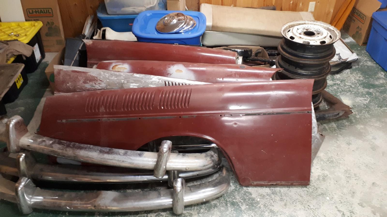

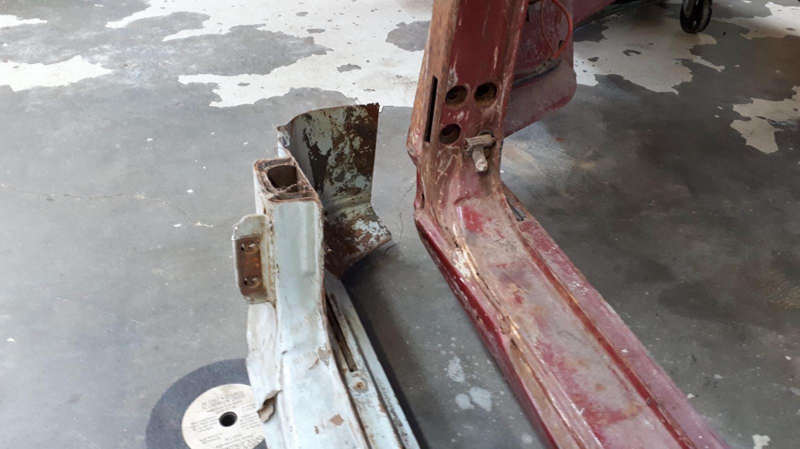

PostPosted: Thu Oct 24, 2024 12:59 pm    Post subject: Re: Square back resurection Reply with quote
Garage straightened up somewhat. TR6 covered and stuffed in a corner.
Engine:
Transmission
Beautifully straight, rust free nose:
Beautifully straight, rust free doors
A bit of ugliness here on both sides
The car came with a set of solid heater channels
I suspect they are for an earlier car tho, the lower door hinge mounts are slightly different
Tomorrow I will bolt the pan to the body and decide where to start.
Probably with this bit of nastiness

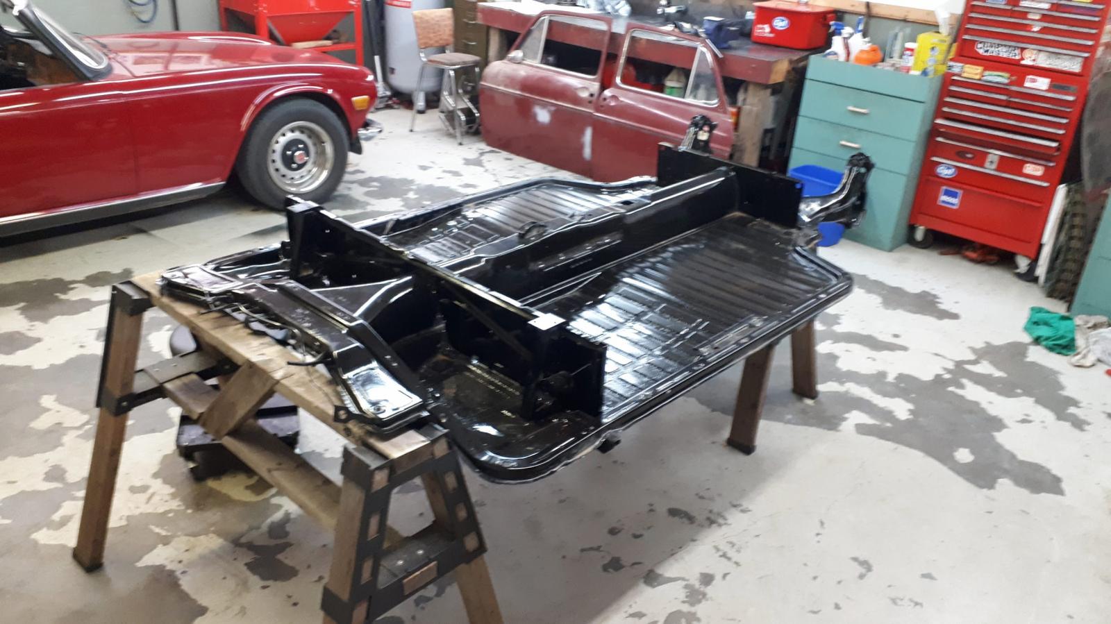

PostPosted: Sat Oct 26, 2024 1:39 am    Post subject: Re: Square back resurection Reply with quote

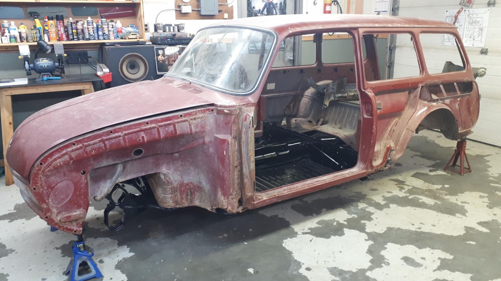

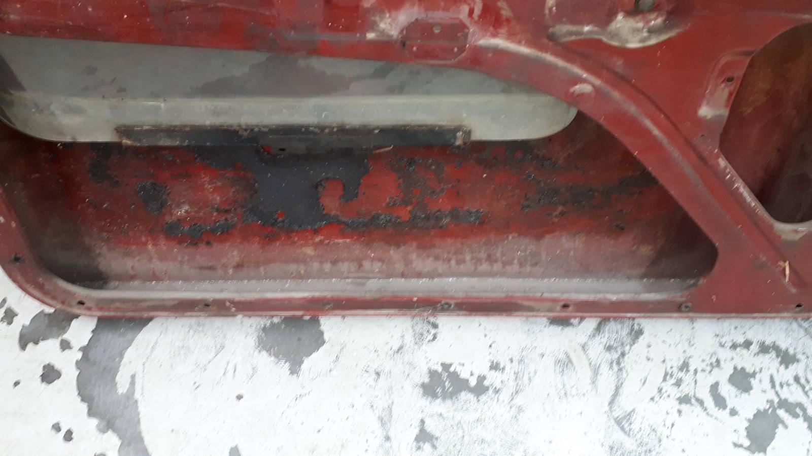

Bolted the pan to the body today so I can start rust repair
Now what the hell is this?
Don
Better and better mistakes!
Bobnotch
Joined: July 06, 2003
Posts: 23265
Location: Kimball, Mi
Bobnotch is offline
PostPosted: Sat Oct 26, 2024 11:25 am    Post subject: Re: Square back resurection Reply with quote
Don
It allows the front seat on that side to fold forward when the door is open (cable operated).

Oh wow, you got a special 66. Nerd fun fact - the 3 bolt doors are a carry over from the year prior. Due Im sure to where you live and the fact that its in the first 1000 made for 66.
Very cool. Cool
Oh ho... Not a feature I was aware of. Of course they are both seized solid so that is going to take some effort to make work. Very cool.
Again great information. I knew I could count on you.

Here is the only other 66 I've seen in the wild with 3 bolt doors. It too was Canadian. Pics seen here at the Vintage Show at Shoreline Community College in the Seattle area.
