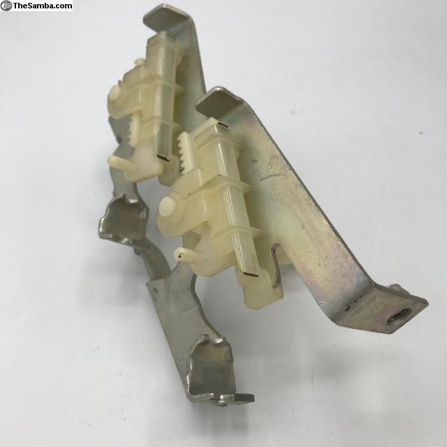

Does anyone know how many cables are on the 1969 fresh air controller?And, is the 69 fresh air systems different than other years?My 69 boxes only have on lever to open and close the vent on each box.The PO removed the controler and the cables so I'm starting from scratch with trying to get fresh air back in the car and it's my first Type 3.Thanks

If I remember correctly there should 4 cables to the vent boxes and control unit. Two to each box, as one will control the upper outlet that feeds air to the base of the windshield, and the other cable goes to the lower flap to allow air to dump out near the bottom of the box (putting air to your crotch). I hope this helps.

hat does help.On my 69 there is only one vent on the box or place to connect a single cable on each box.The're are controlers out there with only two cable for the two boxes,one cable to each box.I saw a controller for a 68 that only had a two cable hook up .Thanks for the help.
