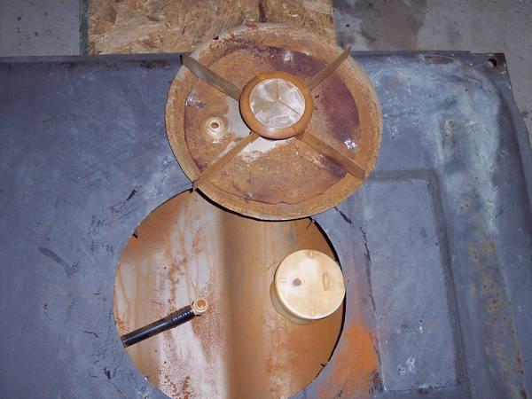

Part of the GoWesty kit is that you get rid of the little square pre-filter. I find a lot of times the fuel tank is going bad and the sediment from inside of the tank without the pre-filter will ruin a new or an old fuel pump in short order. There is a screen that there is no way to clean inside of the fuel pump. Just so this is clear, there is no way to get to this screen without ruining the pump. If it were me, the first thing I would do is flush fuel through the pump backwards just in case you got sediment from a rusty tank caught in that screen. Then I would put a square filter back in before the fuel pump and see what happens. That might be all you have to do to quiet it down. Can you get your original pump back and reinstall it? John
The answer is do not use the square filter for a "pre-filter". Most of these are 10-12 micron fuel filters.
Pre-filters like the sock filters put inside of many acvw fuel tanks are 25-50 microns and some as large as 100 microns. The pre-filter is just there fo keep sand out. They are better termed as "fuel strainers".
You can buy simple inline fuel strainers that have very low resistance to flow and typically are 25+ micron filters. They use them in diesels all the time. This way you catch the rocks before they ever reach any strainer in the pump (which many modern pumps do not have).
Strainer before the pump....pump to the large volume, high pressure digifant filter that Gowesty sells.
If you need part numbers for cheap disposable diesel type pre-filters, let me know. I think I have a list somewhere.

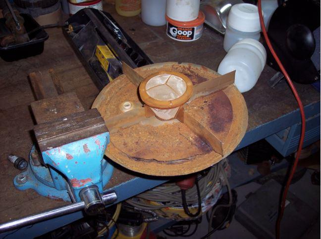

I had posted some 'this bobbyblack guy is nuts' stuff and deleted it early enough that perhaps nobody looked...
BUT, I have to go at it again, and here is the basics of the original post I did;
Clamp off the fuel tank outlet.
take fuel pump out. With some fuel hose for both sides, and a small container of gas, and some way of applying power to the pump, see what happens with the pump while it is not hooked up to the bus EFI. There is also the option of reversing the polarity, the pump will spin the other way. I've done this both on purpose, and by accident. A couple seconds of running the pump backwards did not harm my pump. It did expel some debris.
I do understand that you would normally take your rig to a shop for them to do the work, but they may decline. I can't take my Vanagons to any shops within 2 hours drive anymore, so I get to do my own work.
-bobby

No....really.
A couple of points:
1. you cannot use the Go westy digifant filter before the pump. That big metal filter is designed to be on the pressure side. That is why it is so big so the restriction is low.
2. You do not want "pre-filter" mesh and finer than about 150 to 200 wires/threads per inch. It's just for debris large enough to do damage to the pump.
3. The original cube filter is already a restriction on the pump inlet....but L-jet and digifant got away with it from the factory....ONLY.....because there was no upstream restriction from any other filters.
So you need just a pre-strainer on the inlet side....not an actual filter. The factory work filters that came in many acvw tanks would be fine. A diesel pre-strainer would be fine....but nothing that filters below/smaller than about 25 micron which is right at 0.001". In fact, the vast majority of pre-strainers that do not go through a filter before they hit the pump are about 50 microns.
Those that are designed to go from tank, through a sock or bag type pre-filter/pre-strainer before going into a a fine filter are more like 75-100 microns.
The upstream fuel filter that is 10-12 microns will take care of the rest.

Below are photos of the internal fuel screen assembly inside the fuel tank. This was from an Air-cool era Vanagon.
Below, you can see where it is located at the center bottom of the tank. The white round box to the right is where the returning fuel is dumped. It snaps onto the white connector there on the other side near the pickup pipe (the unit is flipped). I suppose the returning fuel goes through that round box to reduce air bubbles during a low fuel level. The black pickup tube snaps onto a connector under the edge of the strainer on the other side (it is out of view). Look at the last photo below of the stripped down plate. In that photo, you can see the location of the connector for the pickup tube. Hope this makes sense.
Below, is the fuel pickup assembly lying on the work bench. Notice the screen mess goes all the way around and is also on the top.
As stated above, the pic below shows the bottom plate, which is flipped, with the strainer removed. Near the center where the strainer snaps on, you can see the connection point for the fuel pickup tube, the black pipe. The snap connector further to the outside perimeter is where the round box snaps on for the returning fuel. And, that plate is tack welded to the concave bottom and sealed around the perimeter with some sort of sealant. Thus, all gasoline goes thru the mess screen as well as water to the very bottom of the tank ... Very Happy
I hope this is helpful with the discussion.
