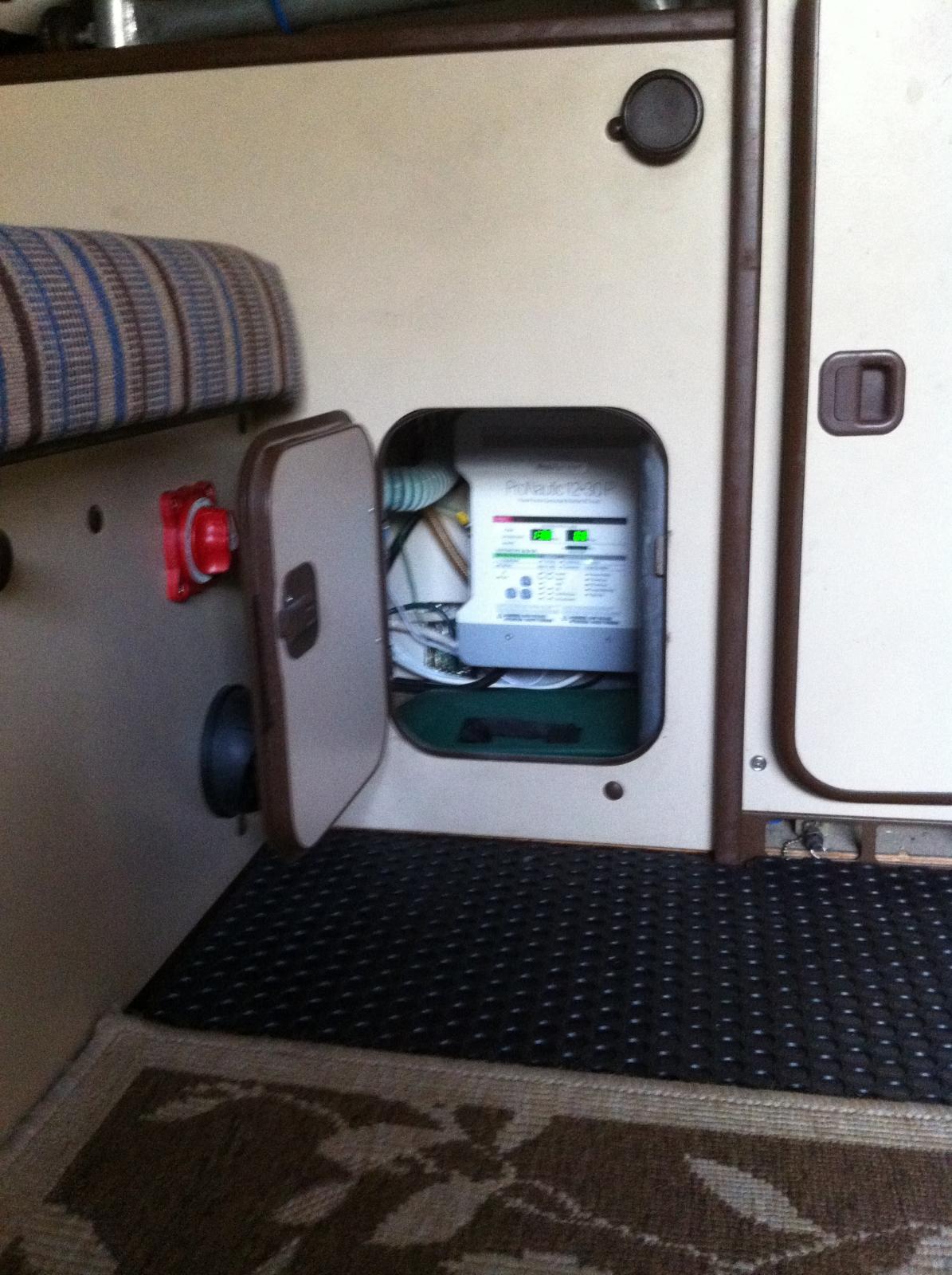

I am running a battery switch that is also a combiner from Blue Seas I recall. Very common in the boat industry. It's also come in handy a few times when one of the two batteries died at an inconvenient time.
You can just make it out in this picture I uploaded long ago. It is the red thing.

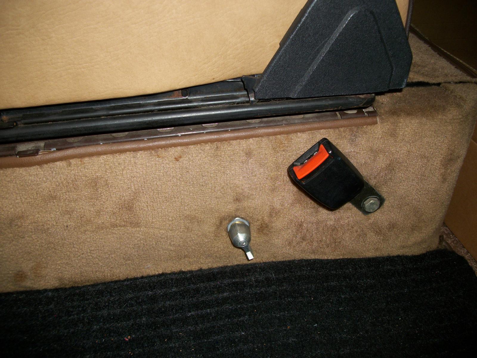

We just got our '85 Westy in mid-June and I'm still learning where everything is and what everything does. The previous owner told me he installed an auxiliary switch for the starter battery so it wouldn't drain and located it on the lower left side of the front passenger seat. In the photo it is shown in the off position. When I want to crank, I rotate it clockwise and any time after starting I can turn the switch off or leave it on which I assume will let the battery charge.
