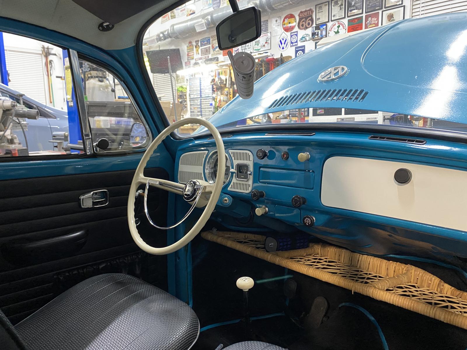

Got a little work done on the bug this weekend.
I've had the horn disconnected for about a year now after it got stuck on like the bus in Little Miss Sunshine.
My dad at the time suspected the horn bearing in the steering column to be the culprit, so I ordered a new one. Well, I never really need the horn in the car, so I never got around to installing the new bearing until this weekend.
Started pulling the guts out of the column
Had a little trouble getting that 57 year old bearing out, but it finally gave up the ghost
Hooked back up the horn amidst the rat's nest of wiring in the trunk
Interior all buttoned up, and ready to go! My 2.5 year old daughter absolutely loved going "beep beep" in daddy's blue bug.
We actually got the wiper motor and mechanism all hooked back up this weekend as well, but no photos yet. I'm having dad sand-blast the wiper arms next week, so I can fully polish and clear them before they go on the car. I couldn't stand the matte-black paint that was on them, and wanted a little flair.

PostPosted: Sat Jan 25, 2025 1:01 am    Post subject: Re: Squeaky Clean 68 - Father/Son Project Reply with quote
Your photo of the ignition switch shows that you have a mixture of white (8amp) and red (16amp) fuses. My Bentley manual specifies they should all be 8 amp on a '68. Maybe worth checking
Good to know! I truthfully did not think a thing of that, but I will take a look at those next time I work on the car. (It lives in my dad's shop this time of year so I can keep mine and my wife's cars in the garage away from the winter)
Thanks for pointing it out to me!

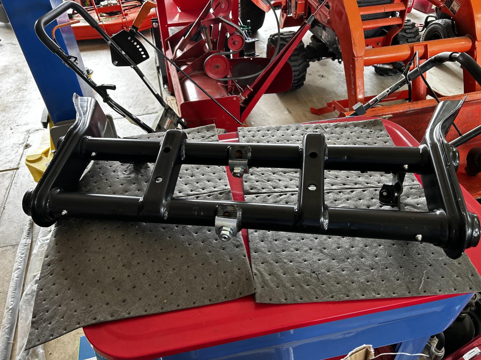

Decided to go with a 2" narrowed beam on the car. At the height it's currently at, its rubbing the tires a decent amount even on the 135's. I think tucking the wheels in an inch on each side will be just the ticket.
Really contemplated a 4" narrowed, but I don't like the sunk wheel look, and I think it's overkill for my ride height.
Will post some pics when it's in.

PostPosted: Mon May 19, 2025 7:29 am    Post subject: Re: Squeaky Clean 68 - Father/Son Project Reply with quote
New beam is in!
The plan is to get it in the car this weekend so I can get it on the road for some test miles!
