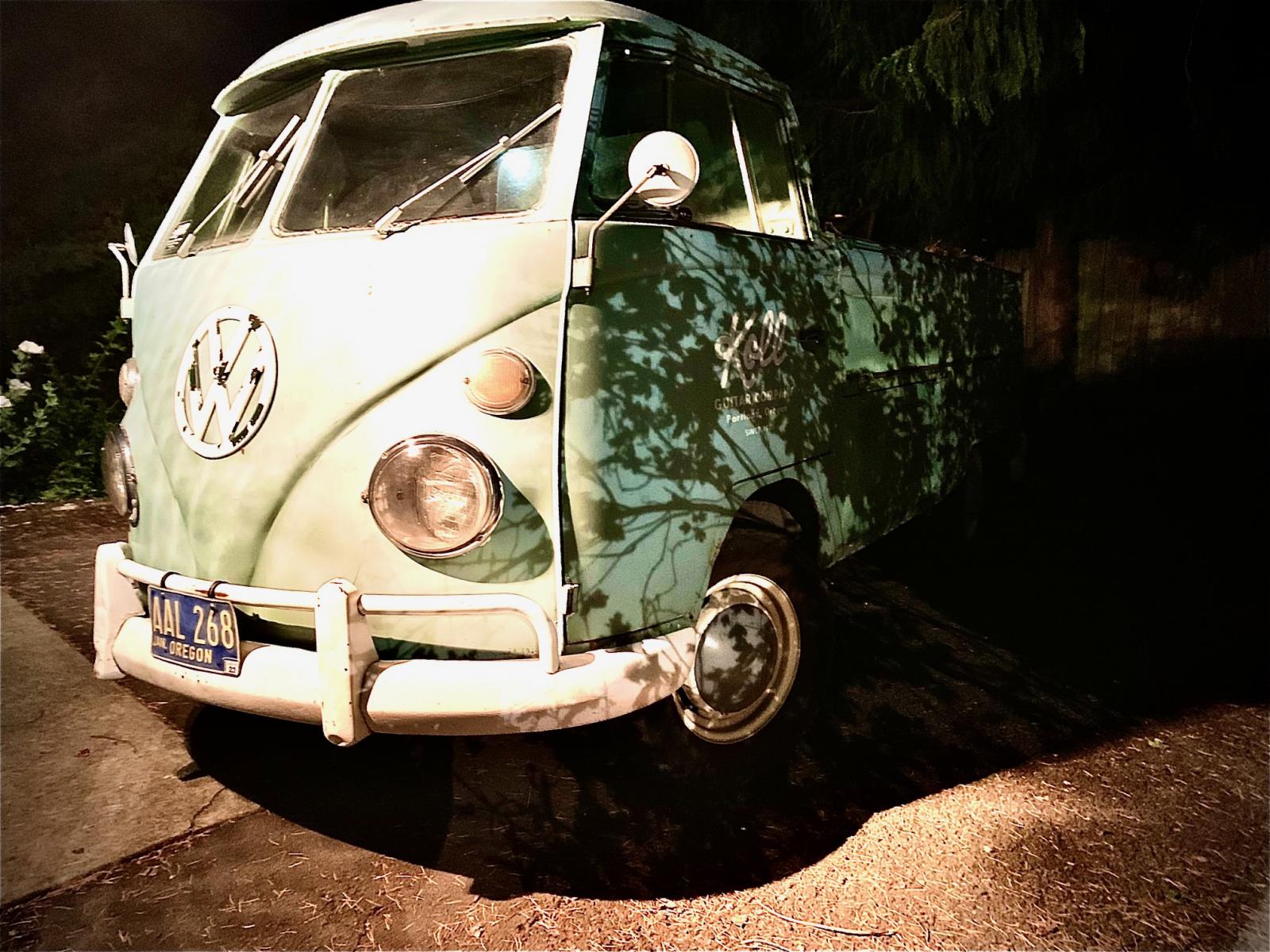

I'm running the Type E kit with 15" General Grabbers on my early '64 big nut single cab. Zero clearance issues or tire rub with the spacers.
These brakes are fantastic and and easily my favorite modification to my truck.
Here's a pic right after I installed them, and later with hubcaps back on. (Sorry it's not super clear)
