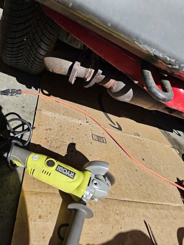

Next, I lucked upon a fella in Aspen selling a Vintage Speed exhaust elbow pipe on Fbook for a very fair price.
I had to pull out the death wheel for the rusted exhaust bolts.
Installed, a nice, clean fit. But as with most all of my Vanagon work, there were complications: I shifted things enough that a broken exhaust stud is causing a little ticking leak that wasn't there with the original pipes. It's not affecting anything at this point, but it's annoying. Gotta get that fixed.

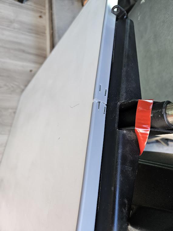

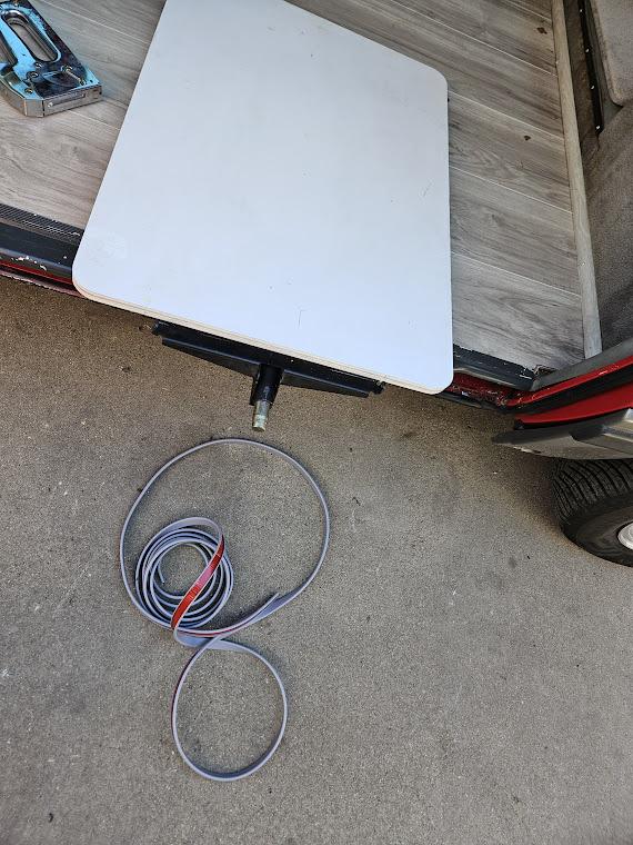

Finally found a plastic heater cover for next-to-nothing. I know it's not a big thing, but I like it for completeness and to protect the valve from shifting cargo.
My table was missing the T-molding. Instead of spending $30 on oem-equivalent, I spent $10 on amazon.
Snug fit with a few staples added.
It's not very robust, but it fits and the backing adhesive was nice and sticky. It looks much better, anyway.

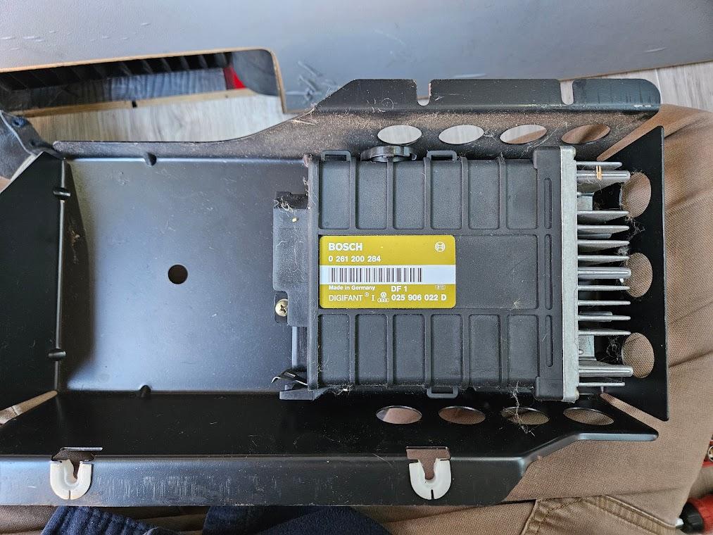

While Mansi's FI kit is planned for the future, I wanted to try the performance chip from Techtonics. I followed the instructions of Mr. PhishMan and Mr. Baldwin.
Still amazed by how clean most areas of this van are.
Feels silly putting a Techtonics sticker on a Vanagon, but hey, it's accurate.
After getting it all back together and driving it around all day, my thoughts are in line with what others have said:
Is it placebo? Possibly, but it seems to idle better and has slightly better throttle response. I can really feel it above 3000 RPM, like when in 3rd but not quite ready to shift to 4th, if I put my foot in it, it has more power than before. I'm pleased.
Between tuning it up with good parts, new injectors, the better exhaust collector pipe, the chip, and zero extra weight, this is a peppy van.
I also removed the throttle body and cleaned the gunk out of it, and cleaned the contacts on the position switch. That and idle screw adjustment have settled the idle down slightly, from steady 1400 to 1200 RPM.
I still need to time it, but found out yesterday that at some point in the last 20 years, mice feasted on my timing light's cables. Sad

I cut the bottom chunk out so it just slides over. I've had to do that with every van so far. Not a very user-friendly design from our friends at VW Smile

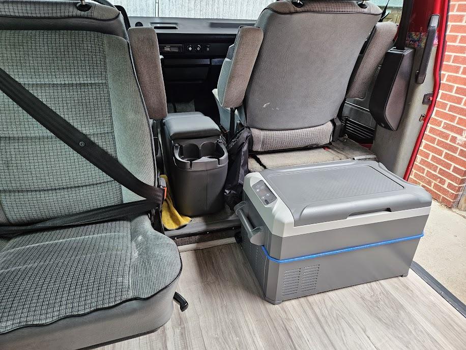

Found a cheapo fridge on Amazon that checks all the boxes:
-34 quarts, perfect dimensions for behind the seat.
-Lid opens the on the correct side and the power port and control panel are towards the interior.
Used Rampage center console for Jeeps:
-Lots of storage and cup holders and pretty conservative looking--it matches better than some of the overly-curvy plastic ones I've seen.
-Narrow enough that the e-brake and passenger rotating seat aren't interfered with.
https://www.amazon.com/dp/B000V9FWSU?ref=ppx_yo2ov_dt_b_fed_asin_title&th=1
Because I added a fridge, I put together a bare bones dual battery setup. Pay no mind to the antique 44AH Duracell battery; it's a placeholder.
I lined the base with sound deadener, insulation, and some leftover subwoofer carpet. I used a cheaper Amazon isolator and a couple of inline fuses at the batteries.
https://www.amazon.com/dp/B0D4M6QP2D?ref=ppx_yo2ov_dt_b_fed_asin_title&th=1

Great progress. That is a really nicely sized fridge. I also like how it's pretty even with the base of the passenger seat. I'm consistently annoyed at the size of my fridge, it's taller and wider and I never really fill it to the brim anyway.
dobryan
Joined: March 24, 2006
Posts: 17127
Location: Brookeville, MD
dobryan is offline
PostPosted: Sun Jun 29, 2025 4:17 pm    Post subject: Re: Reviving a Tornado Red Carat Reply with quote
Agreed. That is a good ottoman size.

Thanks for the mock-up! I've looked at the smoked lenses but agree that the orange works.
Regarding the fridge, I could have left the right side handle off and it would sit even more flush with the B-pillar, but that would completely obscure the vent on the drivers side front so it's offset a bit.
Now I'm waiting for parts. I drove the Syncro to work today, still with its campground emergency supercharger repair. I gotta get that apart when I have the red van going again.

Is there a link for the fridge?
Thanks!
joetiger Premium Member
Joined: January 27, 2005
Posts: 5234
Location: denver
joetiger is offline
PostPosted: Mon Jun 30, 2025 8:31 am    Post subject: Re: Reviving a Tornado Red Carat Reply with quote
Thanks!
Yep, here it is:
https://www.amazon.com/dp/B0DP8LMMFZ?ref=ppx_yo2ov_dt_b_fed_asin_title&th=1
