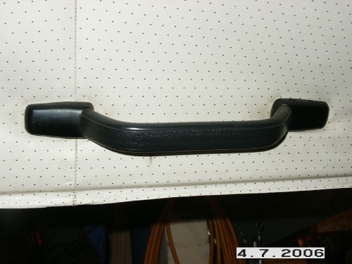

Any one know if buses were fitted with screw plates to add these assist grab handles?
I want to add some to my double cab. Thanks in advance,
Martin

PostPosted: Sat Apr 26, 2025 12:57 pm    Post subject: Re: The Stupid Question Thread Reply with quote
I don't think so.
https://www.thesamba.com/vw/forum/viewtopic.php?t=763269&highlight=double+headliner
