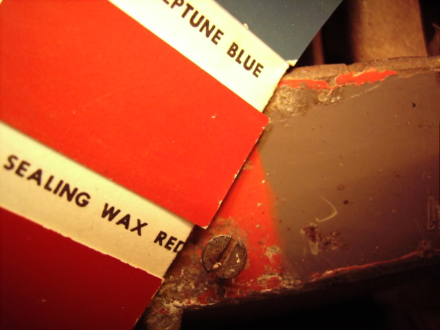

The only way you might be able to find the original color for the body would be to look in places that are difficult to strip. On a vert you can pull the trunk lock to see if they actually pulled it apart for paint or just masked. Under the gas tank on the front firewall may work but your front clip (not sure if its a 1/2 or full clip including dash) has been replaced. If the rear of the vehicle was not altered the best place Ive seen was the channel for the engine seal. With the work quality demonstrated I doubt they pulled the seal remnants to sand out the slot in the channel. Depending how much of the body shell existed when it was chosen for build up the last place to check would be under the small aluminum plates where the top hinge is.

This link shows what vert colors were available and the interior colors as well
https://www.thesamba.com/vw/archives/lit/8_57_color_book.php
This might help a bit more but doesnt say kabrio specific

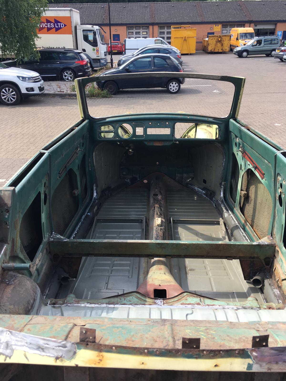

so, as i wrote, they met a rhd vert body on a rhd sedan pan. i got birth certificates from vw for both stating that the sedan was build on 10.6.1958 and delivered completely knocked down to south africa. vert was build on 15.8.1958 and it's colour was alabaster, remnants of which i've found on the speedo cable tubing and under new old laquer in some interior spots at door hinge attachments. with its body# 47904 it actually can hardly be a 2/57 body.
pan wasn't welded and has its mounting plate for split trans prior to 8/59 when they altered the suspension of the driving unit, thus according to its vin#.
subsequent to my first euphoric entry from when i got the car newly delivered at home, i found it a confusing blend of asynchronies and i understood that quite a number of parts (and even more) weren't as untouched as i had expected.
more i examined it more i discerned its specific conditions as to what had been modified over the years: support channels were replaced but are looking sound, rear apron has been replaced as well as they did with the wrong decklid.
front is original as well as the fenders except the rear left one which is spare part. semaphore pockets seem org but sedan semaphores are installed.
some mecanics like break drums and shockers had suffered from negligence while the car was an insignificant part of a collection.
my heirs are obviously happy with the bug Wink i'm not less, and inheritance is secured nonetheless Smile

i've seen all these great samples but they don't shed light upon the question how accessories were finalized in early verts before vw better documented it in subsequent publications. i've read various times of l471 stone beige being the colour of choice but since glasurit is offering two different shades under this denomination i got unsure about plausibility of that assertion.
how comes that everybody deems l471 being the right thing when even vw remains silent on that matter? more than rumours?

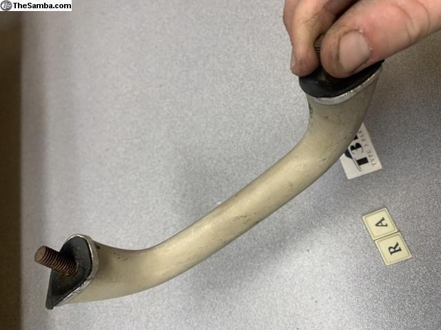

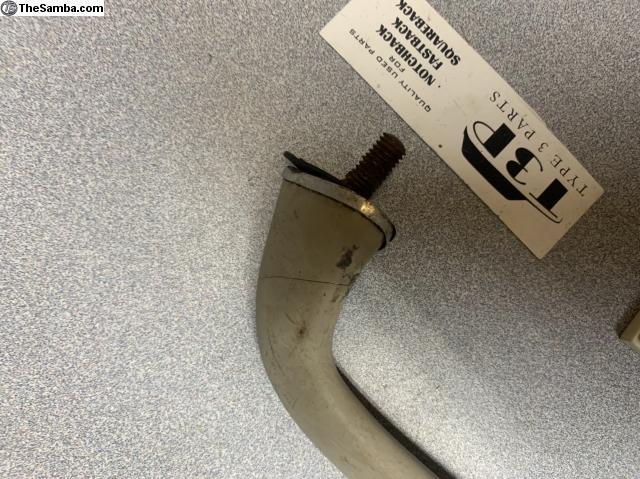

Ive collected dash handles when ever I find them cheap. My Nov 58 did not have these small chrome accents nor did any of the ones Ive purchased or seen for sale. Anyone see these before?

found same handle type yesterday at bad camberg beetle meeting. have another one with plastic gaskets, but in less fine shape. rare items indeed, and hardly to understand that oval handles are commonly seen.
