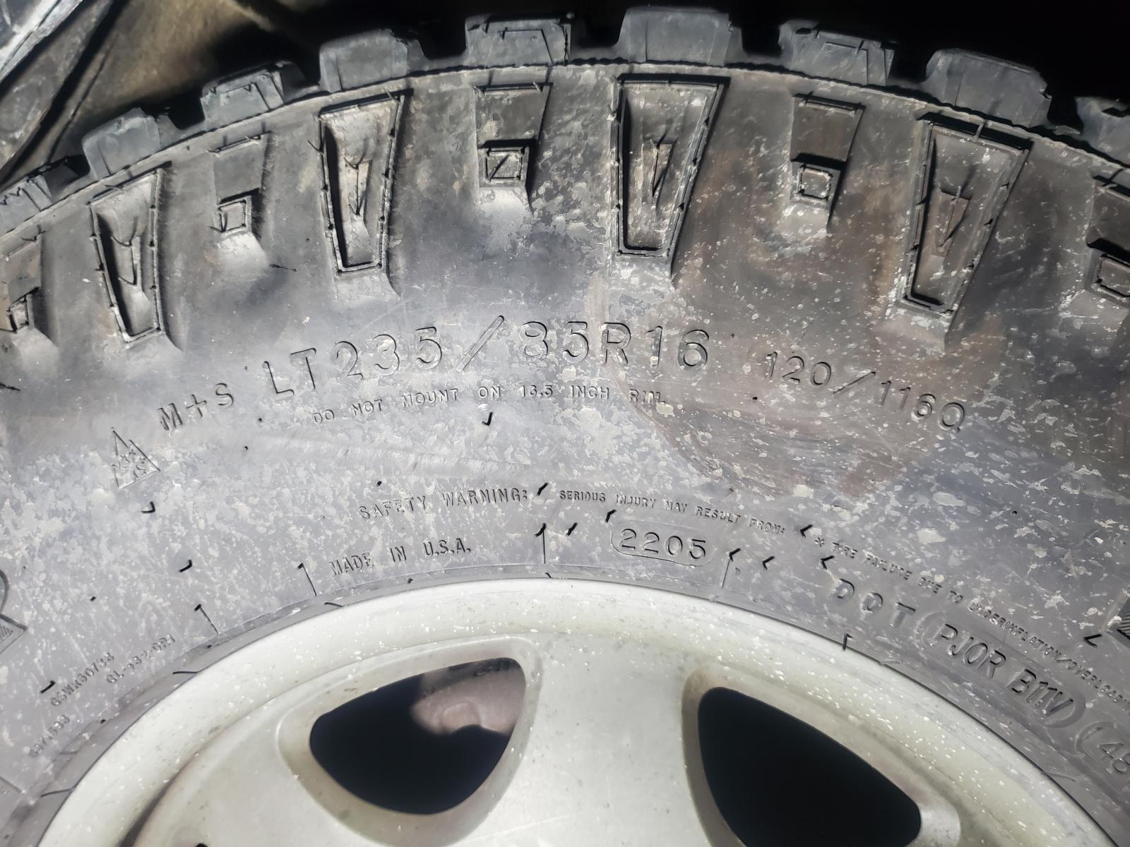

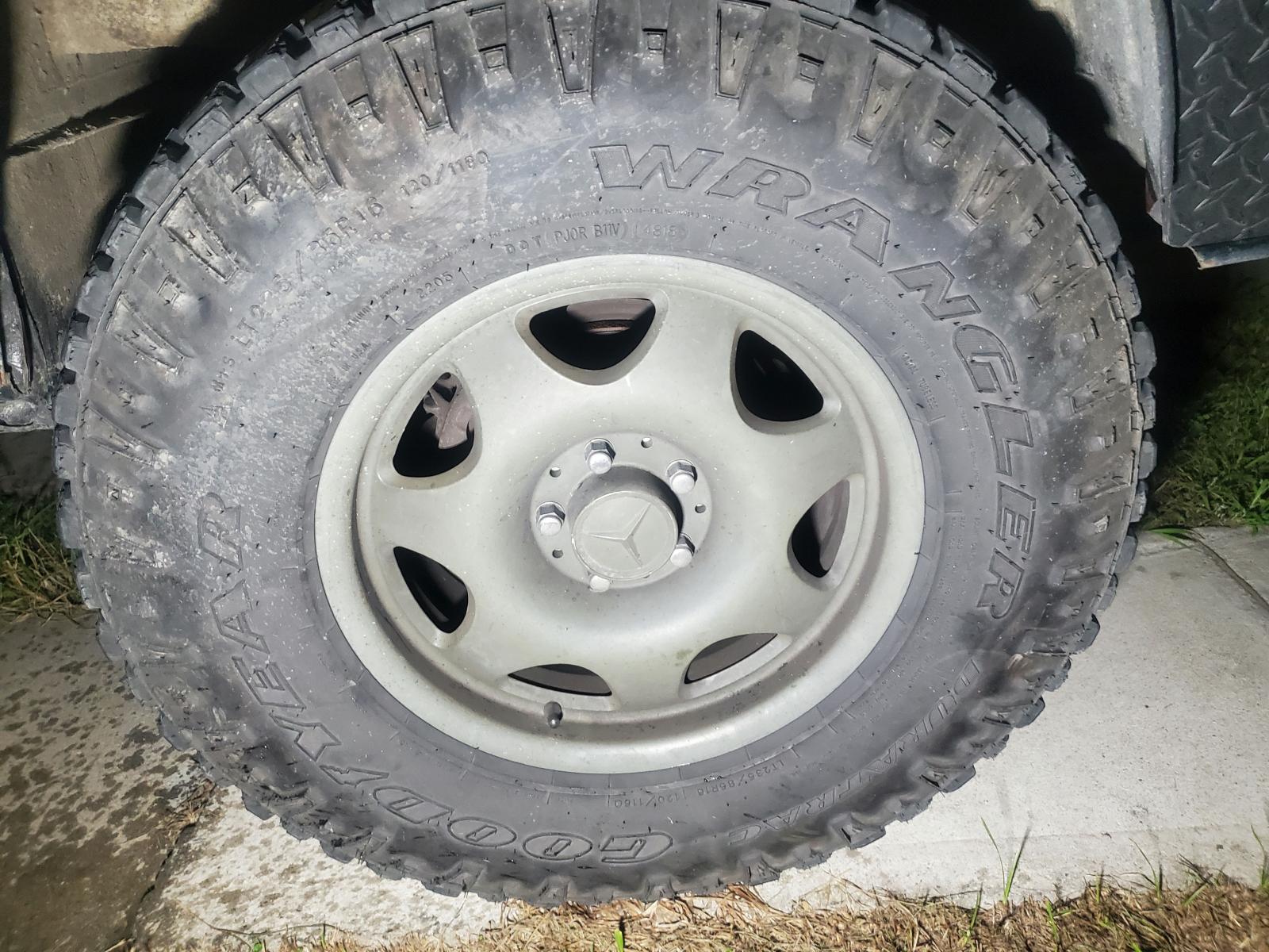

PostPosted: Mon Nov 20, 2023 12:06 am    Post subject: Re: What TIRES fit? The ultimate tire thread! Reply with quote

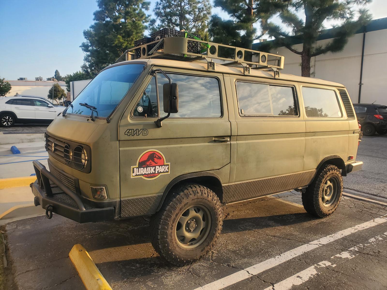

Just wanted to add my tires for others' info / reference - LT235/85R16 installed by previous owner; rear diff is 5.43, tranny gears all standard (I think). At 75 mph engine is going 4000 rpm and it's always made me a little nervous first time I jump in after a long hiatus.
I wouldn't really recommend this size because they're a few inches too big and rub on the inside of the wheel wells on sharp turns if shocks are depressed at all. Even driving up a small driveway / ramp into a gas station at the same turn radius as any standard stop sign is enough to make them rub. Flat ground they're ok. Maybe this could be considered like some kind of "maximum semi-functional size".
I haven't checked if there are spacers installed, but previous owner's receipts say he put in extended wheel studs in the back.
I'm planning on going down to 235/70R16 which will maintain a beefy sidewall, and I'm thinking it'll help reduce engine rpms at speed while torque comes up for easier hill climbing. Maybe Falken Wildpeaks since my brother has them on his 06 FJ.

PostPosted: Mon Nov 20, 2023 10:58 am    Post subject: Re: What TIRES fit? The ultimate tire thread! Reply with quote
BigPapaV wrote:
Just wanted to add my tires for others' info / reference - LT235/85R16 installed by previous owner; rear diff is 5.43, tranny gears all standard (I think). At 75 mph engine is going 4000 rpm and it's always made me a little nervous first time I jump in after a long hiatus. At 75 mph engine is going 4000 rpm and it's always made me a little nervous first time I jump in after a long hiatus.
I may be misunderstanding, but a smaller diameter tire size is going to increase engine rpm. The 4,000 @ 75 will now be, approximately, 4250 rpm.
I don't want to sound like I know it all, but from the variety of things you mention about rubbing, etc, I would not think these tires belong in the category of fitting...
Fun to look at tho. Thanks!

PostPosted: Mon Nov 20, 2023 10:30 pm    Post subject: Re: What TIRES fit? The ultimate tire thread! Reply with quote
Ah you know what, I think you're correct.
I guess what I'm shooting for really is for the tires not to rub, slightly better gas mileage (currently ~16) and not to be painfully slow on inclines haha. Driving out to Zion up the long grades toward Las Vegas we were doing 55-60.

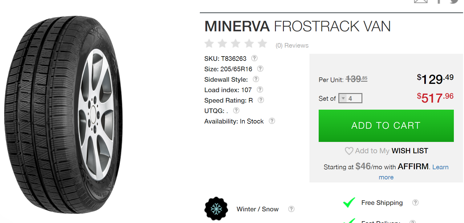

PostPosted: Fri Feb 16, 2024 1:00 pm    Post subject: Re: What TIRES fit? The ultimate tire thread! Reply with quote
Anyone tried Minerva tires beforeÉ not crazy about straying away from my usual Nokian, Goodyear, Continental, but getting sick of calling tire shops to find out nothing is available. Price is CAD btw
Andross
Joined: December 07, 2011
Posts: 147
Location: Robson, BC
Andross is offline
PostPosted: Fri Feb 16, 2024 1:33 pm    Post subject: Re: What TIRES fit? The ultimate tire thread! Reply with quote
Okay nm pulled the trigger on a set of Radar RV4S tires 205é65é16 107é105 for $140 CAD per tire as recommended by the local shop. Shout out to Integra Tire! Kal Tire could not find any tires that would work...
I guess time will tell...

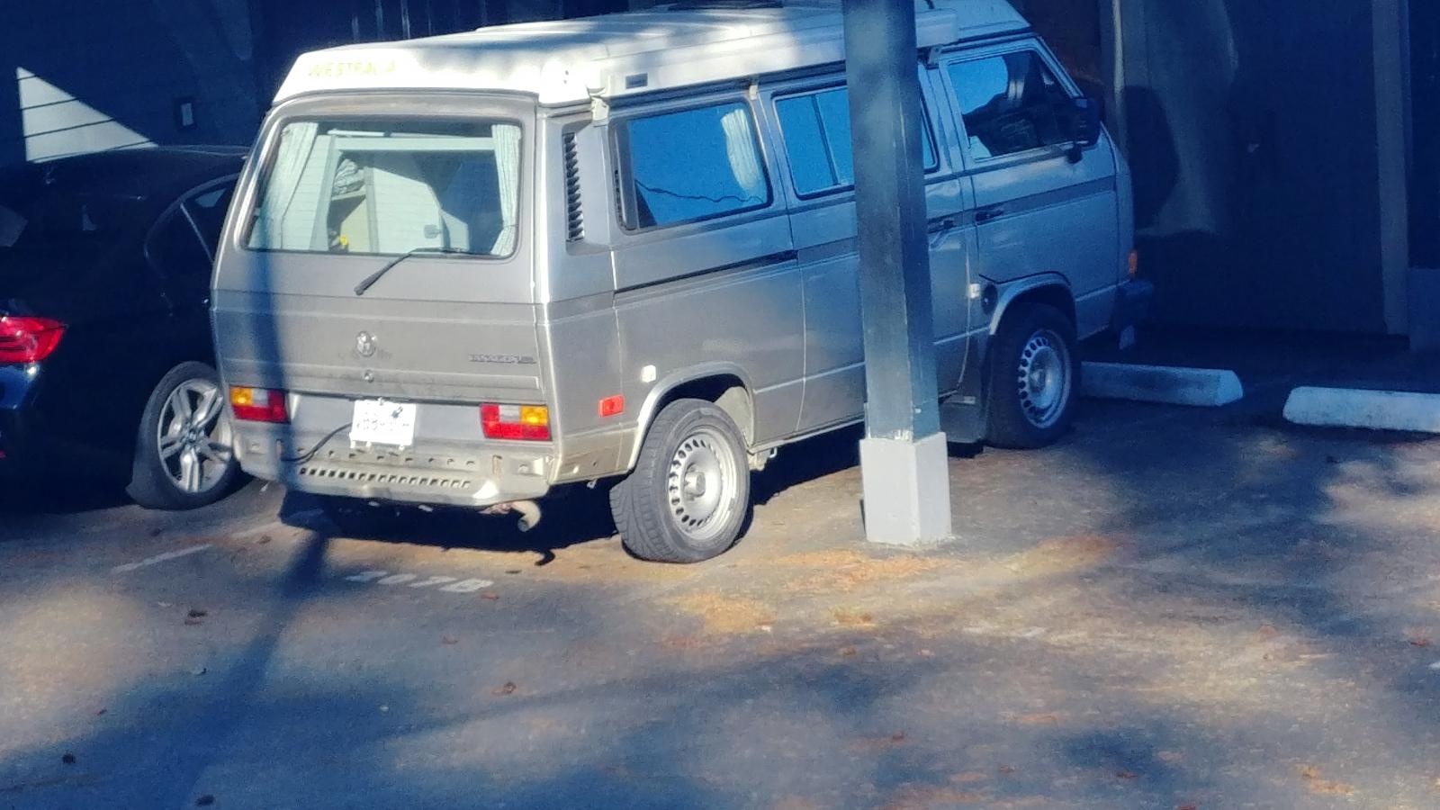

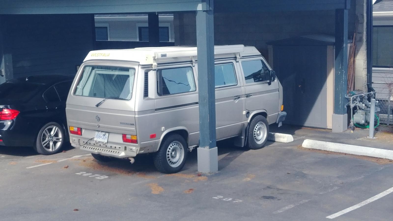

PostPosted: Fri Mar 08, 2024 12:41 pm    Post subject: Re: What TIRES fit? The ultimate tire thread! Reply with quote
I did it...I was worried about the size of the tires and rims.
This is a Before pic of 225/55/16 rubber on my
16"x7.5" Mercedes rims.
I bought VW rims 16"X6.5" with tires and the center bore was too small for the front end. I contacted them T3 technique and they gave me all the information I needed about spacers and that guy is knowledgeable. He has an awesome sight and lots of product for fitment of tires.
https://t3technique.com/
Here is a before and after pic... side by side of my new 215/65/16 on the 16"x7.5" Mercedes rims
Thanks for all the info on here.
