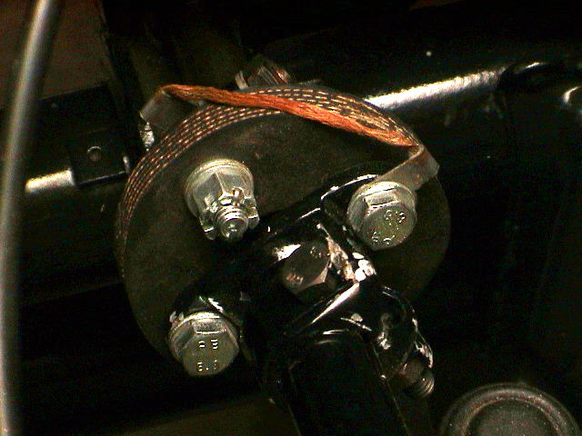

Disconnected the wire- now I get absolutely nothing. Next step- I'll pull the steering column to make sure all of the bottom washers/ springs and clips are in place.

Put everything back together with the help of the instructions at the beginning of this topic. Found that the plastic ring needed to be turned so the larger holes were in the correct position.
Horn still wouldn't work.
I reattached that lead wire that bridges the steering column to the steering box.
Now the horn works. Not very loud, but it works.
Go figure

PostPosted: Sat Aug 03, 2019 1:19 pm    Post subject: Re: 1960-61 horn assembly hell made simple. Reply with quote
6T5 square wrote:
Go figure
Figure you have voltage drop/s. Get a multimeter and check for how much voltage is getting to each connection when the horn is operated. Also can try a jumper wire to see where you get loud horn or not very loud.
Also how much voltage at the battery and how much of that is getting to the horn itself??

PostPosted: Mon Aug 05, 2019 10:52 am    Post subject: Re: 1960-61 horn assembly hell made simple. Reply with quote
I’m getting 6.43 volts at the horn- and it drops to zero when I hit the horn

PostPosted: Mon Aug 05, 2019 6:32 pm    Post subject: Re: 1960-61 horn assembly hell made simple. Reply with quote
Sounds like a voltage drop. Check up stream at the fuse box.

yea contrary to what eric&barb is saying i think 60's do need the ground strap bridging the coupler.

My 61 has this issue. I do have all the competent original parts. I noticed that the only originality difference is the steering wheel has been replaced at some stage with a +65 wheel with the curved brass ring on the back, but the original 61 column.
I have spent days trying to get the horn system re-established including insulation of the column, with no success.
Given the mixed nature of the steering system on this car, I wondered if anyone had come up with a way to add a simple contact micro-switch under the push ring on the steering wheel that could active the horn?

I don't think there are very many that understand the original '60-'61 system very well so they don't know how to modify it. I have an idea that may work...
You will need all the horn parts that are part of the later steering wheel. You will need to run a wire down the hollow steering shaft and out the slot at the clamp at the beam (that wire is likely to be a lot easier to fish in if you run it up from the slot until it comes out inside the car.) You will need to remove the jumper that goes from one rag bolt bolt to another rag joint bolt. The new wire you ran up the steering tube will connect to a bolt that is part of the steering box side of the rag joint. The other end of the new wire will attach to the place provided on the horn button of the later steering wheel. At this point the horn won't work (unless your steering shaft assembly has already worn through its insulation somewhere.)
If you go to page 1 of this thread and find the diagram of the 1960-1961 Steering Column Setup you see the second item from the top called "plastic washer." If you remove that it should defeat the factory efforts to insulate the steering tube from the steering shaft. That should allow the steering column assembly to function the same as the later 1962-1967 assembly and so work with your later steering wheel.

Thanks very much for this. I did go to the trouble of running new wire down the column but not the last modification that you have suggested!
One thing do I remove the woven connection across the steering coupler connecting the shaft to the steering box?

I did this today - slowly and carefully. Removed the jumper lead across the rag joint and ran a wire down the steering column (pulled out the column as that was easier and also I had to slightly elongate the slot at the base of the column to accomodate the exit of the new wire). Attached the new wire as you describe - and after testing the 'switch' action on the horn push with a meter, installed it all. It works well, after several failed attempts earlier. Many thanks, Merv
