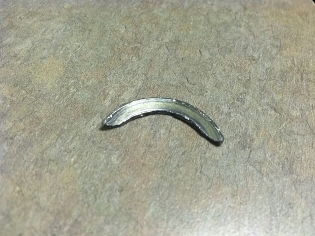

Update on the 1679cc. I bought it from Jake last June/July and put 5K miles on it in my '64 with dual 36 DRLA's. I had to tear it down to fix a cam bearing, and found that the heads aren't 39x32 041 heads. They're just stock 35.5/32 stock dual port heads with no porting. The Engle cam and lifters look great after about 10k miles. The lifter bores look great and are still tight- no problems with the FK-41 eating the bores. Thought this would help anyone wanting to replicate the build. I haven't even checked the mileage yet- don't have the self control to drive normal for a whole tank. Embarassed It's been a great little engine and I'm anxious to get it back together so I can start beating on it again!

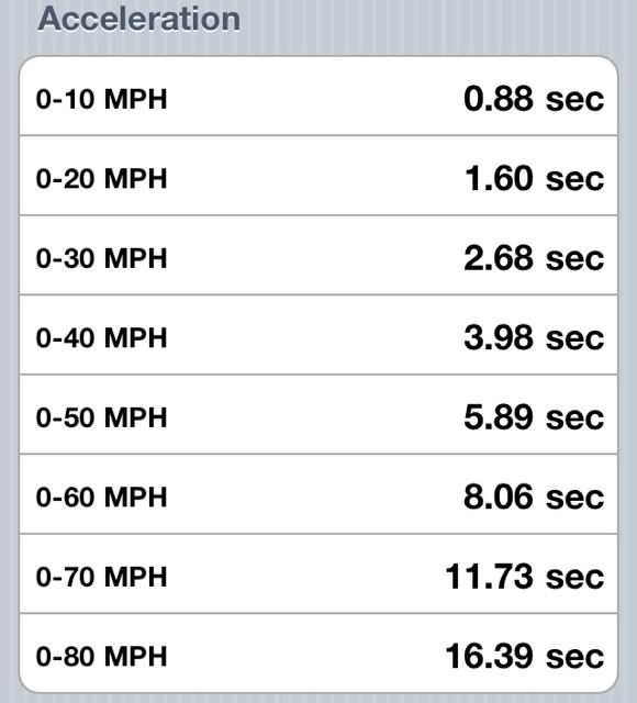

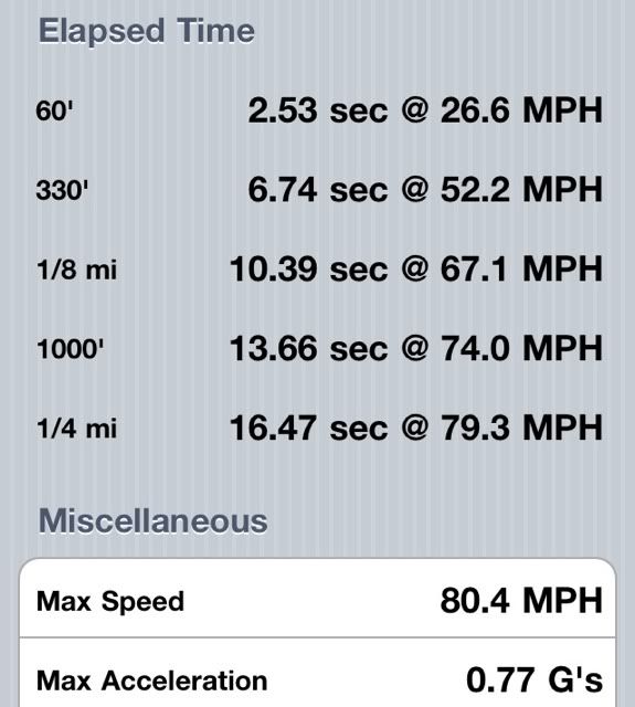

BTW, with a "dyno" app on my Iphone, it's putting down about 68 hp at the wheels. It calculates HP based on weight and acceleration (using the iphone's accelerometer). I used the curb weight listed in the owner's manual plus what I weigh. Since that's not 100% accurate on the weight, the HP will be off a hair, but 68 WHP is close to what Jake was getting. The 60' time is 3 tenths slower than what it used to run with the old 1600, and I think with the mph it's running there's room to drop the 1/8th mile ET a little. I'll take it to the local 1/8 mile track once I get the engine back in to get real numbers, but I think these are fairly accurate.
Here's a video of it running 0-80 mph.

Awaffull wide seats, & boogered up a bit too.Whats with it not being what jake said it was?brain fade?At some point we all suffer from it when you have done so many of almost the same things & when they all looke alike they all tend to run togeather.thus I did a lot of everything& allmost remember them all.Some were a joy, some were a headache due to the owners.

yup knock off the corners& "D" port the exhaust a bit.I would redoo the seats but thats just me.kinda hard to tell you just what to do, Im not looking at them you are & I'm not doing the work, you are. what was the cam bearing issue??

One of the thrust flanges broke off. Here's the thread I started about that.

isant that the issue he had with it?might want to dig farther & find out why it broke.sharp corrner on the case,to loose on the case(back&fourth not side to side) notch in the case on both sides and one in the rong place.(I just remove the tang on the bearing,dont notch the case most of the time.or for some reason it is pounding the crap out of it.both should contact the cam at the same time& be well supported, if the case isant wide enough& it isant even it may do what your did.you might need to asemble the case and check to see if the case matches up , or if something has shifted.also look at the gear for a nub,bump,funny wear pattern(both gears) to see if possiably one was droped or something and it forces the cam back or foward when it contacts that spot.I have a set hear that has some fucked up whitness marks on the cam gear from the cranbk gear that was afu when somebodt assembled this motor from the northwest.there both getting replaced as is the cam.
also check to be sure the cam towere contact each other when the case is torqued they may be moving(you should see fretting if thats the case unless they dont even tuch.
straight gear or hypoid(angled)?thrust on crank & case ok?
if the bearing fits tight, take a feller gauge.001 or .002 and see if it will go under the flang,see if something is bending the flange out,burr,not enough raidi on the case.so when the cam go's back&fourth it is contacting toe outer edge pushing it and just flexing it back&fourth till it snaps off.dont just stick it back togeather and think it is fixed,make sure it is.good luck.

for got single or double thrust?use dubble if it was single.

read his other post, he knows why it broke.
That´s about 81-84 hp on the flywheel. Quite normal for the set up. But the 41 does make a good amount of torque, which is why the car is faster than the hp numbers indicate.
