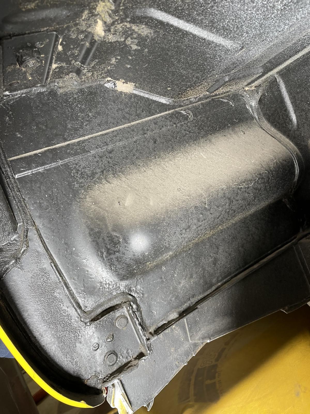

another one of those PO things that just makes you shake your head...rattle can black the fender well, and front suspension, and all the dirt/grease as well.
Rolling Eyes at least it's just paint, and not the tar undercoat that was all over the rear end.
the nice thing is there is very little rust under there

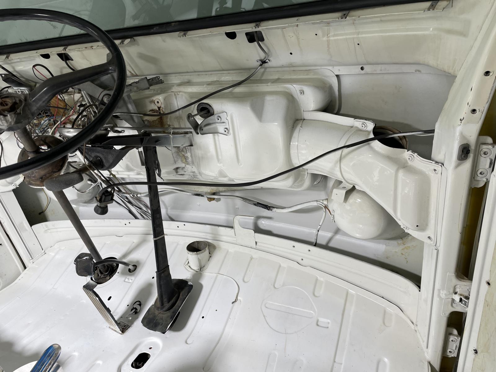

got some cleaning and painting done while the dash is out, I have a nice replacement that needs to get picked up in a week or so.
Might as well clean up the wiring, wipers, ducts, and all that while there is easy access. Need to order a 12v washer bottle upgrade and a couple switches that were trashed too
To me, that wheel well is pure porn. Aside from the undercoating, it looks original or repaired as per factory. The paint and body work are clearly not a lipstick on pig kind of job, which is the first thing I think of when I see a bus with nice paint.
I like the painted underside. The factory undercoating is nasty stuff and was sprayed on everything including mechanical parts. I painted the rear 1/3 underside of my bus a light grey. It’s way easier to see and work under there without getting smeared by the decades of oil and road grime that accumulates on the bottom of a bus.

The underside is why I bought it, it was pretty darn good.
The wheel wells had the usual cracked and delaminating seal sealer with some surface rust, so lots of scrubbing and poking around got it clean and ready to seal and repaint.
I just can’t leave it knowing there was some rust underneath

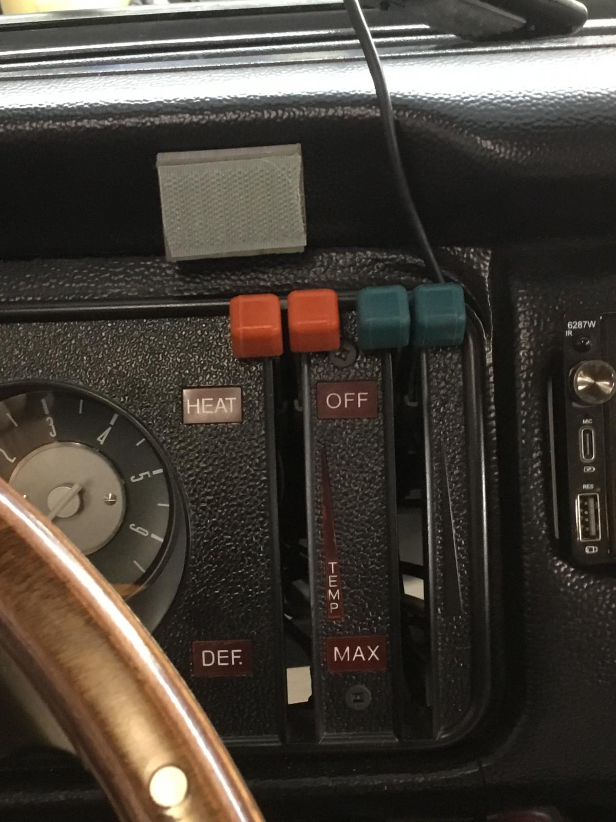

A couple updates, added another hose to the output of the heater, it will help get more air flow into the center tree.
And added an ultra-gauge for more consistent subi gauges, the blue driver connection was working sometimes and sometimes not.
A little 3m tape on a plastic wedge to hold it
And it sits nicely on the Velcro in the corner.
Tons of gauge settings available on itl

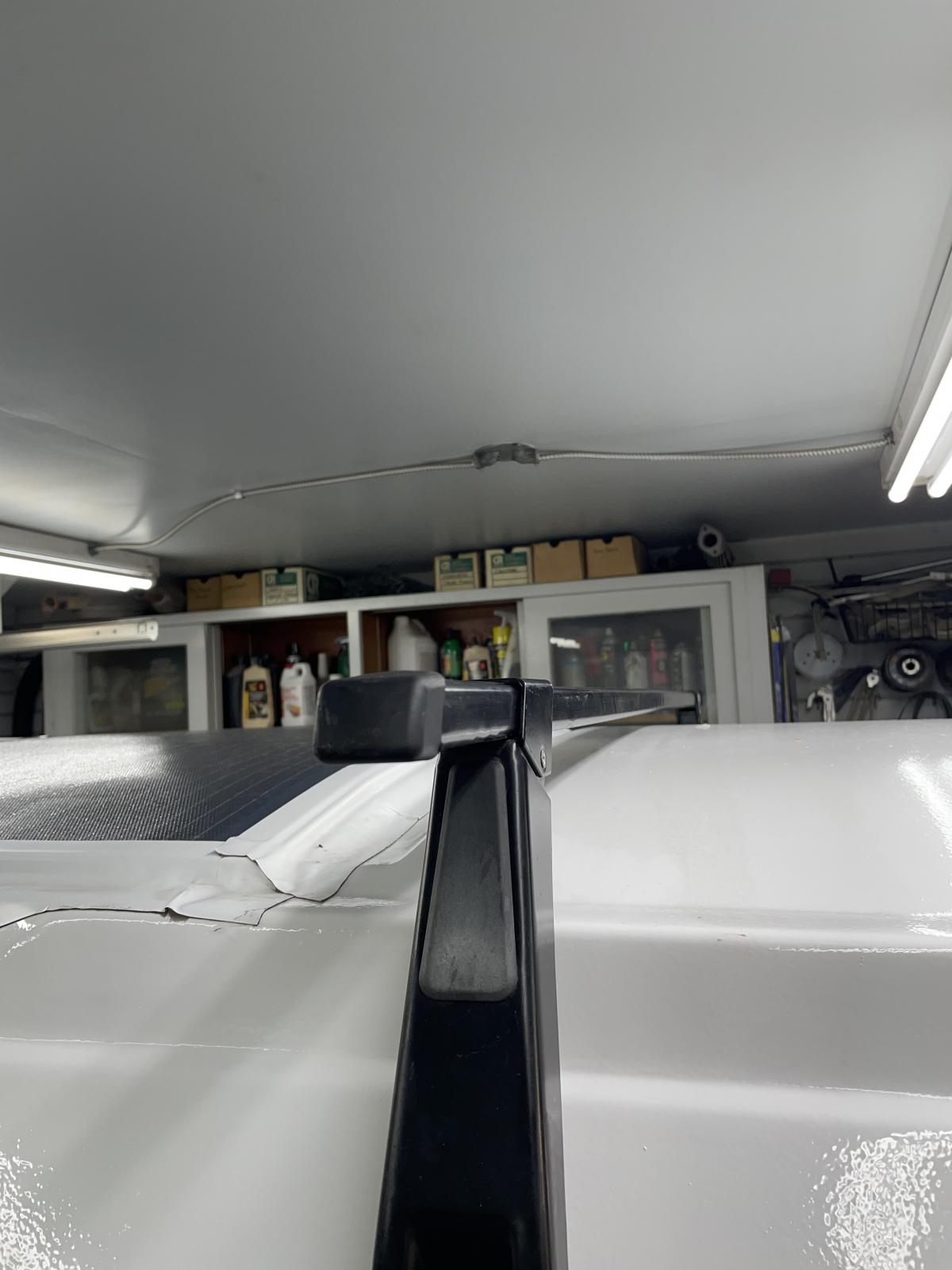

$90 for Thule 953 feet and bars. Been looking off and on for a couple years, thinking we can bring a canoe along camping and do some fishing
