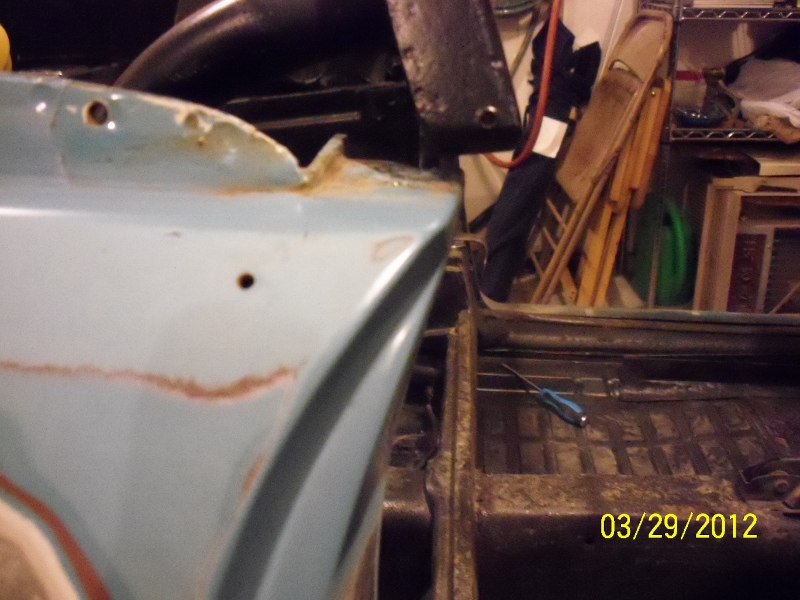

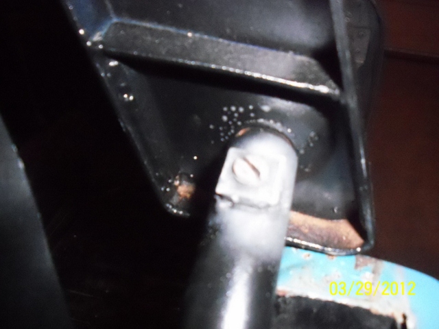

PostPosted: Thu Mar 29, 2012 7:50 pm    Post subject: Top frame Reply with quote
Does anyone know what the adjustment for this would be? What is allowed I guess is what I mean.How much of the main bow can come into the door opening?
If the set screws are loosened here will the main bow move in and out from the main hinge?
