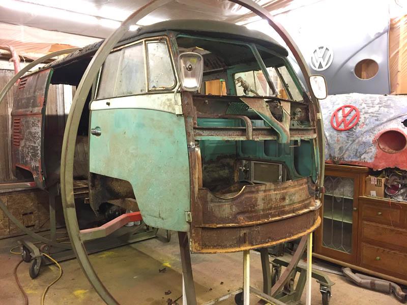

I now know more about how VW made this than I ever wanted to know.
The wheeled painting cart was a handy hight as I had to do endless trimming to get things lined up.
Got the replacement frame section bolted up at the front beam mount by one bolt each side. This helps with alignment. Got the last remnant of old floor removed. Made a headlight support panel patch.
I have not done any welding. All I have ever done on this entire project so far is removing cutting and grinding. It is nice to see something look like it is coming together for a change.

As an ex auto/truck frame straightener, I'm wondering how you're insuring you have the frame height correct at the front frame horns? It would be easy to weld it in twisted a bit. Did you make templates of each frame rail before cutting the old ones out?
It would be nice if you could hang some frame gauges on the entire bus before the welding started. It would really help insure thing are level and not twisted. Of course, there's also the frame dimensions on this site as well for lengths and side to side measurements for squareness.

I will be checking the frame for twist throughout all welding with a laser. VW's own frame tolerances was only 2mm. I can do better than that.

Installing the doors will insure you don't get any nasty surprises later.

Did somebody remind me to check my door gap alignment before I do any welding? I cleaned up the threads for the hinges with a tap and dug out some doors from the attic. Never throw anything away. The original doors are a pile of oxide now.
I am beginning to feel better about Wrecks' prognosis. I got these doors 15 years ago for Funky Truck replacements but turned out to be the wrong year for that project. They are ice picks alright but of the recessed variety. I was unaware of such subtleties back then. All is well though because they are the correct year doors for T Wrecks and I still have them. They are in great condition too. I finally get a break from finding new rust.
I welded the first two pieces together today. A milestone for this project. Headlight support patch. I will mess with fitting the other door tonight.Then I will CHECK DOOR GAP ALIGNMENT!

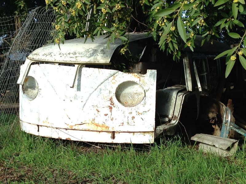

Out of curiosity was your front clip two tone grey white? It looks very much like a match to the dash section I purchased from your part of the world.

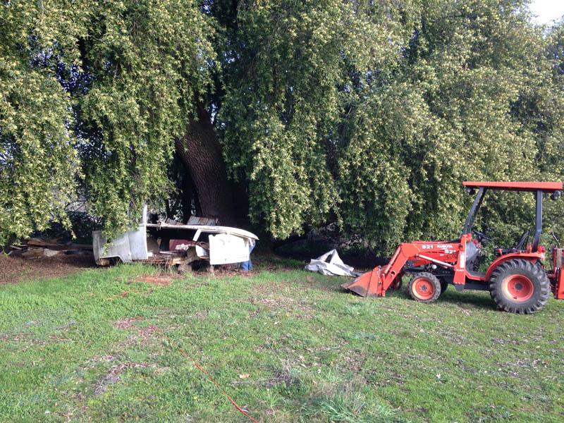

The frame clip is from the bus that goes on giving and giving. CMoore let me cut this clip from his pasture of donor buses when he convinced me to take on this project. Funky has parts from this one too. I wonder what is left of it now?

glideking wrote:
This blows my mind that the front hoop and those two frame sticks are holding everything just fine.

The bus weighs nothing right now. What blew my mind was how rigidly just the two window frames held the nose in mid air. I peeled the nose skin off that way.
The door gaps are only aligned when I level the frame. Why is that? I am getting downright optimistic that I can pull this off!

The frame replacement is done. I removed the front ring to weld that small section it covered, ground it flat and reinstalled.
I did have to squeeze things here and there with pipe clamps to get good door gaps.
