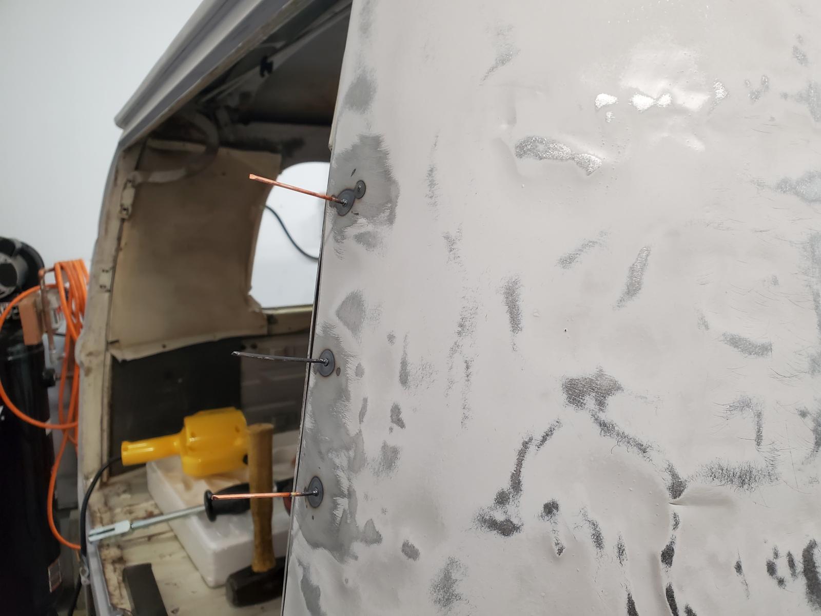

Finishing up the little stuff. JB has been relocated Cool Will I paint it? or will my disorders break down and Ill buy the 73 vert thats waiting for me. Its calling me. No one will buy the rot bucket.
BUT Question Question Question Idea Idea Idea Arrow Arrow Arrow
The stud gun is awesome Cool Cool Cool

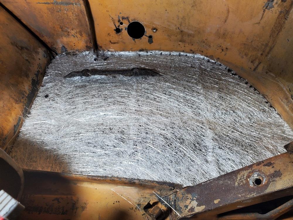

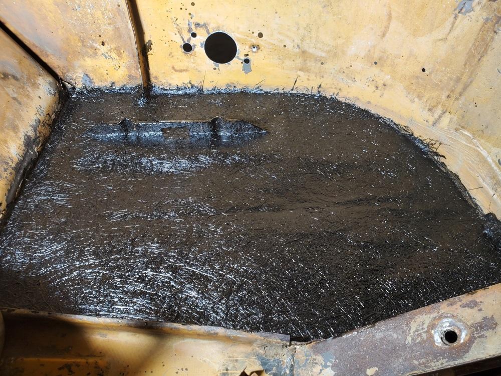

I love my original Bus Metal Cool Cool Cool
Hack & Sleeeeze Cool Cool Cool
Fiberglass, 4 layers Cool
Por 15 for battey. SoLiD Cool Cool Cool
The piddling is almost complete Cool Very Happy Very Happy Cool

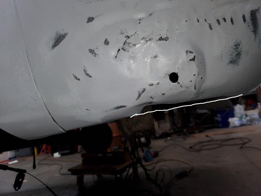

Goin 4 more, till it kills me Cool Surprised Cool
Before Arrow Arrow Arrow
After Arrow Arrow Arrow
Still more left, how much I gonna do Question Question Question Idea Idea Arrow

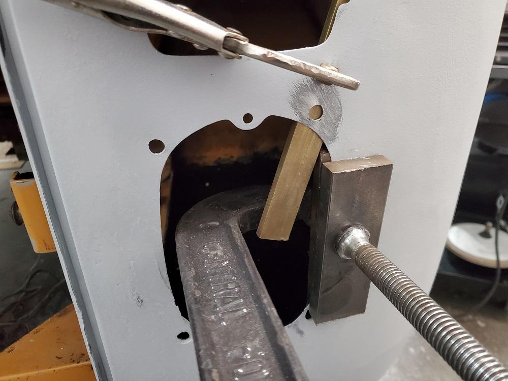

Bringing out my bus nipple Very Happy Very Happy
From this, I had no idea there was a nipple. Thanks to the other side Very Happy
Coulda put an aftermarket 1/4 in there. Hell No. Ruin my original bus metal, No Way Cool Cool Cool White Bay Bus White Bay Bus White Bay Bus White Bay Bus White Bay Bus

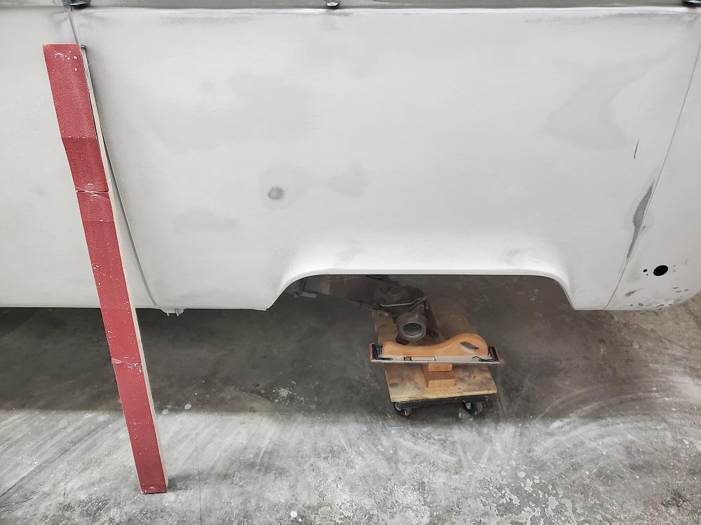

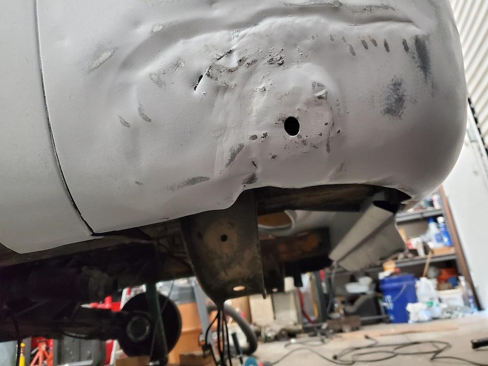

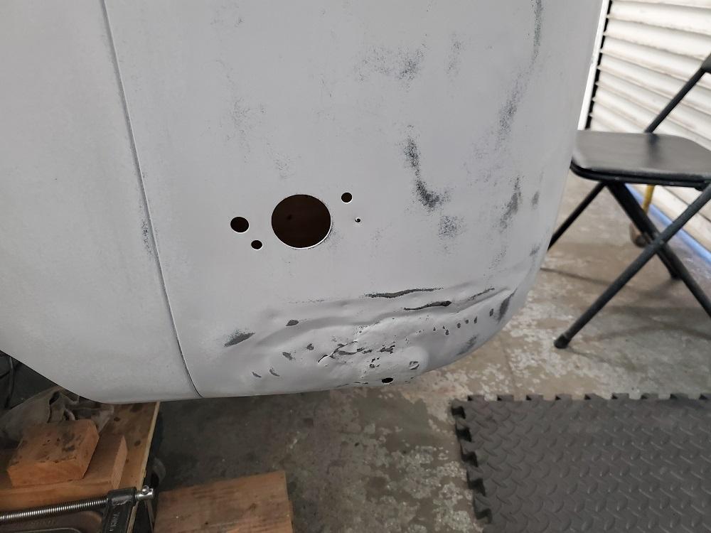

Round One almost complete Very Happy Very Happy Very Happy Cool Cool Cool
Stll pluckin away at the dent bucket Mad Crying or Very sad Confused Razz Surprised Cool
Workin it Arrow Arrow Arrow Arrow
Minimal amount of bondo.1/16, sand till ya puke Cool Cool Cool Razz Razz Cool Cool
Poly prime and sand till ya drop Very Happy Razz Razz Very Happy
Tighten Dat Booty Up Cool Cool Cool

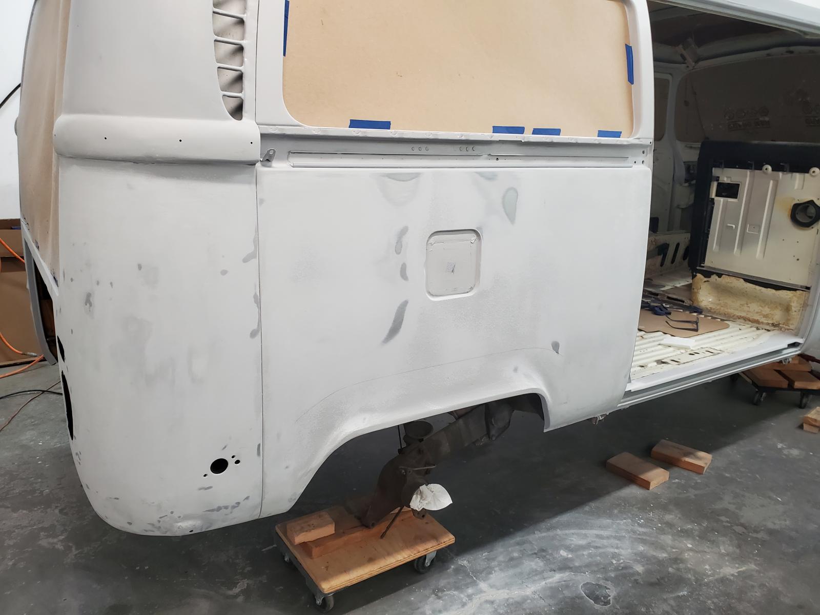

Workin Dat Backside...OOOOOlala Shocked
Ya know, gobs of filler gone Mad minimal, takes more time instead of slapping a 1/2 thick coat and sanding it smooth Exclamation Exclamation Exclamation
Welded the holes up Arrow Arrow Arrow

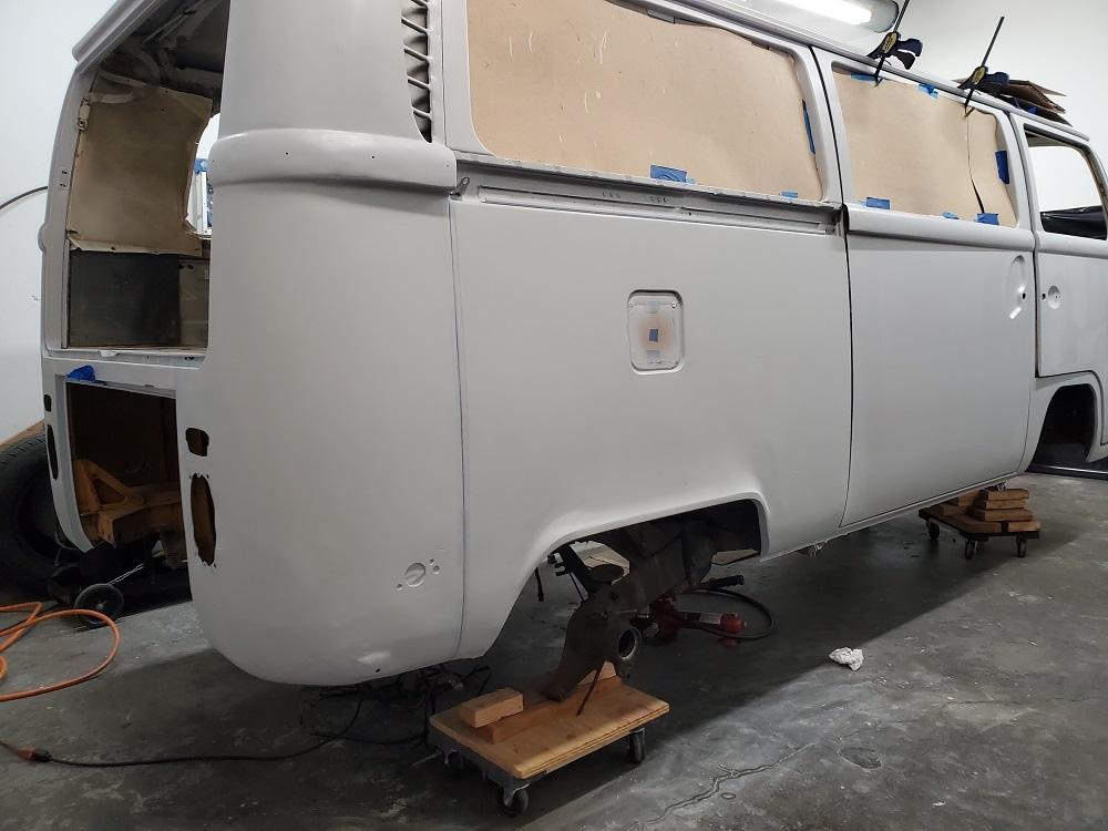

PostPosted: Tue Feb 11, 2025 10:19 am    Post subject: Re: 1971 VW Bus Resto. The BoHo Bus Reply with quote

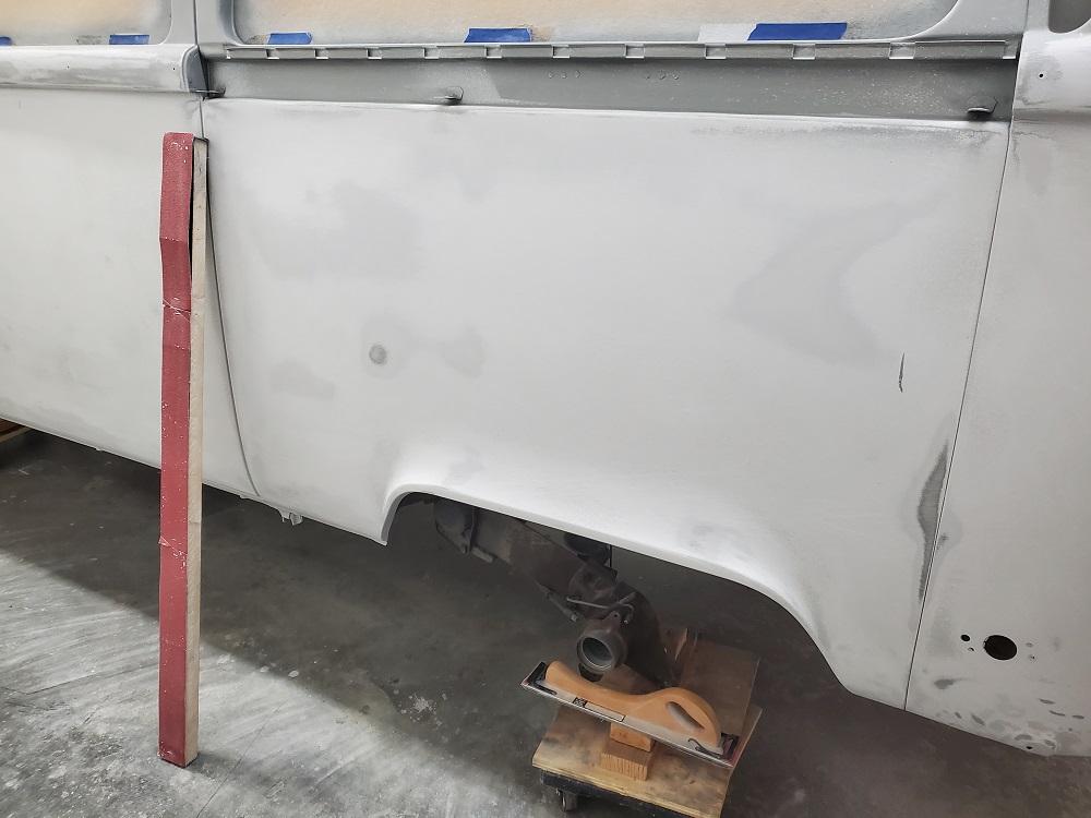

Closin in.
Soon its gonna b as flat as my ex girlfriend Very Happy Cool Shocked
Poly primer sanding. Keep going, spray the low spots, than a full coat and sand again Cool
More to go, down low, take it slow or go blow, Yo Exclamation Exclamation Exclamation Cool
Finish some welding and be done with this 1/4 Very Happy

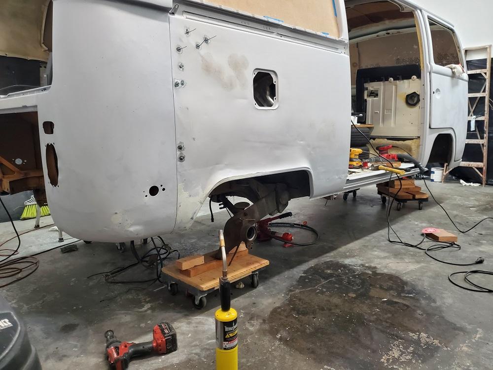

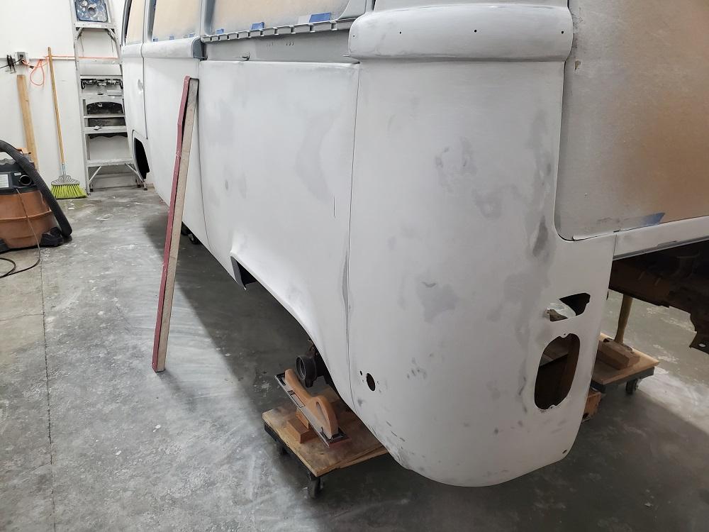

Sunday Pics Very Happy Very Happy Very Happy Very Happy Very Happy Cool Sick of sanding Razz
Got me a new thick primer spray gun. Cool I like to color coordinate Cool
When you testing Surprised Surprised Surprised
Have to match my flares Cool Cool Arrow Arrow Arrow
High and low spots. Little by little to perfection Cool Very Happy Cool

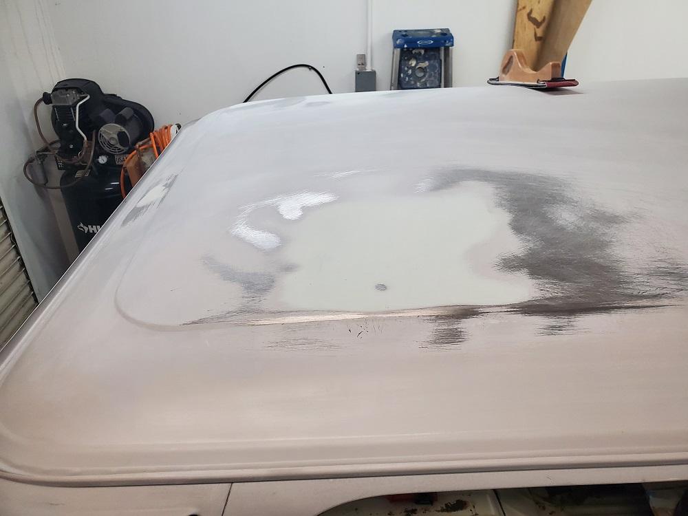

Roof fix, than epoxy, than urethane Arrow Arrow Arrow Cool
Poly primer Cool Cool Cool Arrow Arrow Arrow
Soooooo Close to paint Cool Cool Cool Cool Very Happy Very Happy Very Happy Cool Cool

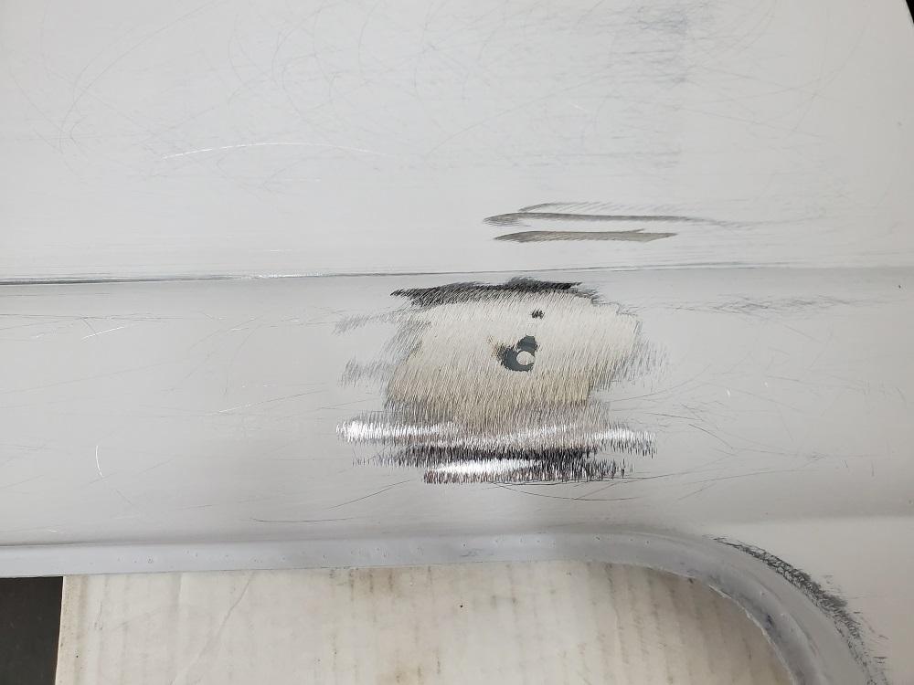

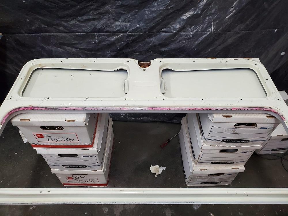

Thanks Very Happy Closing in. But, Have no clue how to do the roof. Roll it? Spray it? Spray and Roll Idea . UGGGGGG Idea Idea Idea
Nit PICing, get it Surprised Razz Idea Idea Idea Very Happy Cool

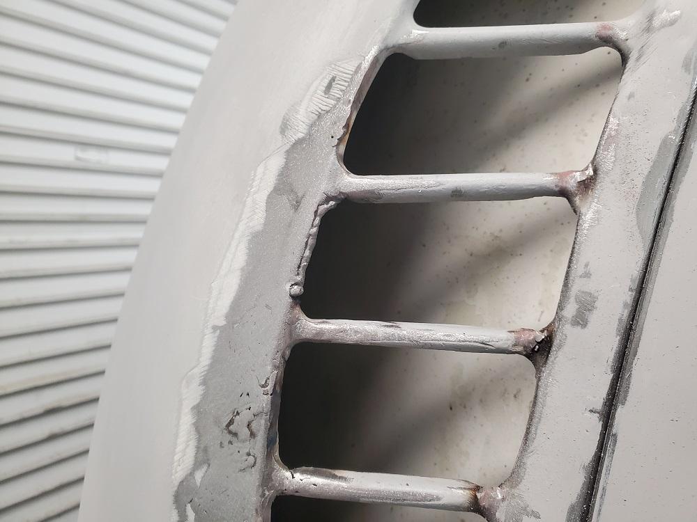

Trying to get these better Cool
In here need some help Arrow Arrow Arrow
and this, whayt to do what too doo Idea Idea Idea Arrow Arrow

PostPosted: Thu Feb 27, 2025 9:10 am    Post subject: Re: 1971 VW Bus Resto. The BoHo Bus Reply with quote
How bout a side order of Grits, 50 grit Very Happy Cool Cool Cool
The 4ft long board with 50 grit belt sander belts cut in half. Cool
The panel seemed so flat, until Surprised Surprised Surprised Surprised Surprised
Next Up Question Question Idea Idea Idea Idea

PostPosted: Sun Mar 02, 2025 10:08 am    Post subject: Re: 1971 VW Bus Resto. The BoHo Bus Reply with quote
How many of ya have a nice flat midsection Question Question Shocked
Well golly gosh, Sweet Cool Cool Cool Very Happy
Can ya smell the yellow/orange. Cool Cool Cool Very Happy Very Happy Very Happy
Next Up, piddling everything, nit picking, picking my zits, puttin on the ritz Surprised Cool Razz
