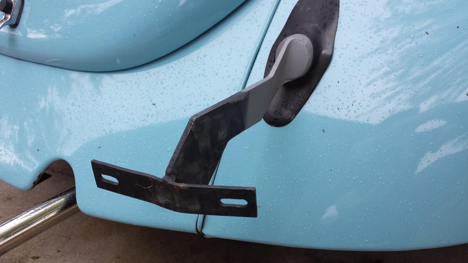

You really need to make drop brackets otherwise the bumpers end up too high, and a '75 with it's shock bumper mounts makes that a little harder 'cause you can't just do a slight mod to the commercially available '68 - '73 drop brackets.
Can message docswitzer, he did a nice job on his Super and has logged in recently; there's additional 'before' pictures and a couple of his first attempt brackets in his gallery, but none currently of the drop brackets.

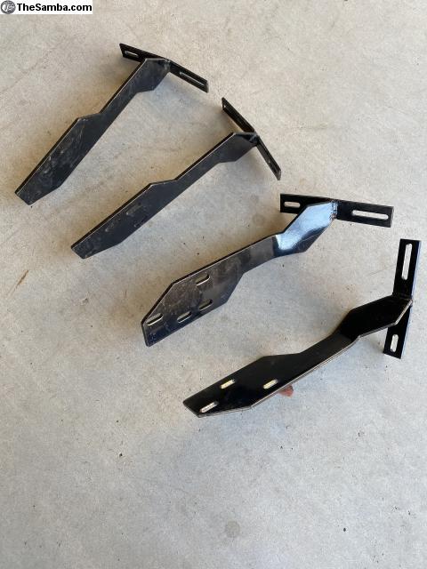

Here is an adapter bracket to mount an early bumper to a later (up to '73) STD Beetle (not SB). I don't believe they will work with the wider SB front end or on '74-later Beetles that used shock absorbing front bumper brackets (tubes), but it may give you some ideas for creating your own.
https://www2.cip1.com/ProductDetails.asp?ProductCode=C13%2D15%2D2045

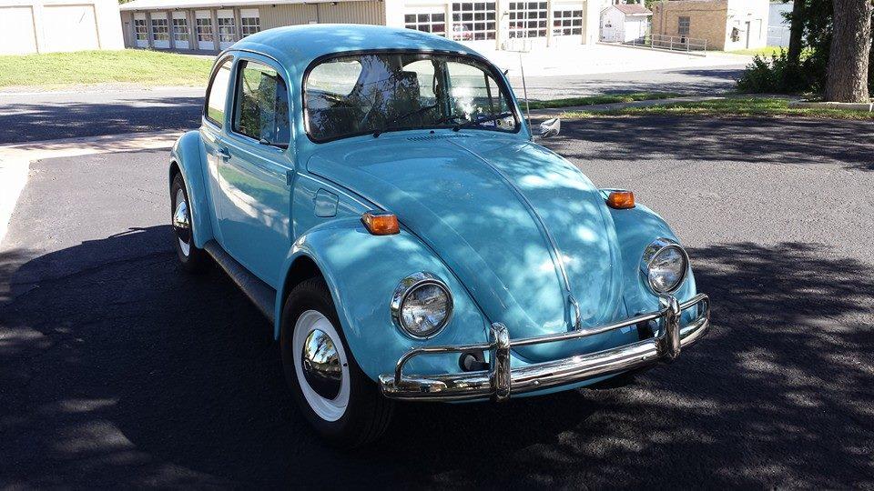

To each his own, but personally I think this looks awesome and would love to see the adapter brackets that allow this exact mounting(I have a '74 Super but want the early Euroblade bumpers for my outlaw style autocross car)

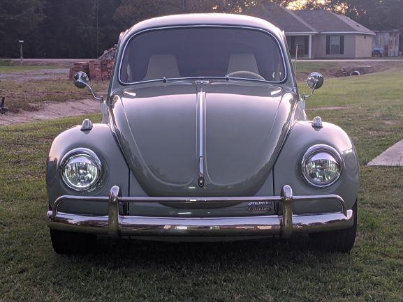

Chadabear
Joined: August 10, 2018
Posts: 106
Location: LA
Chadabear is offline
PostPosted: Mon Jun 28, 2021 4:57 am    Post subject: Re: Putting older Bumpers/Fenders on a '74 Super Reply with quote

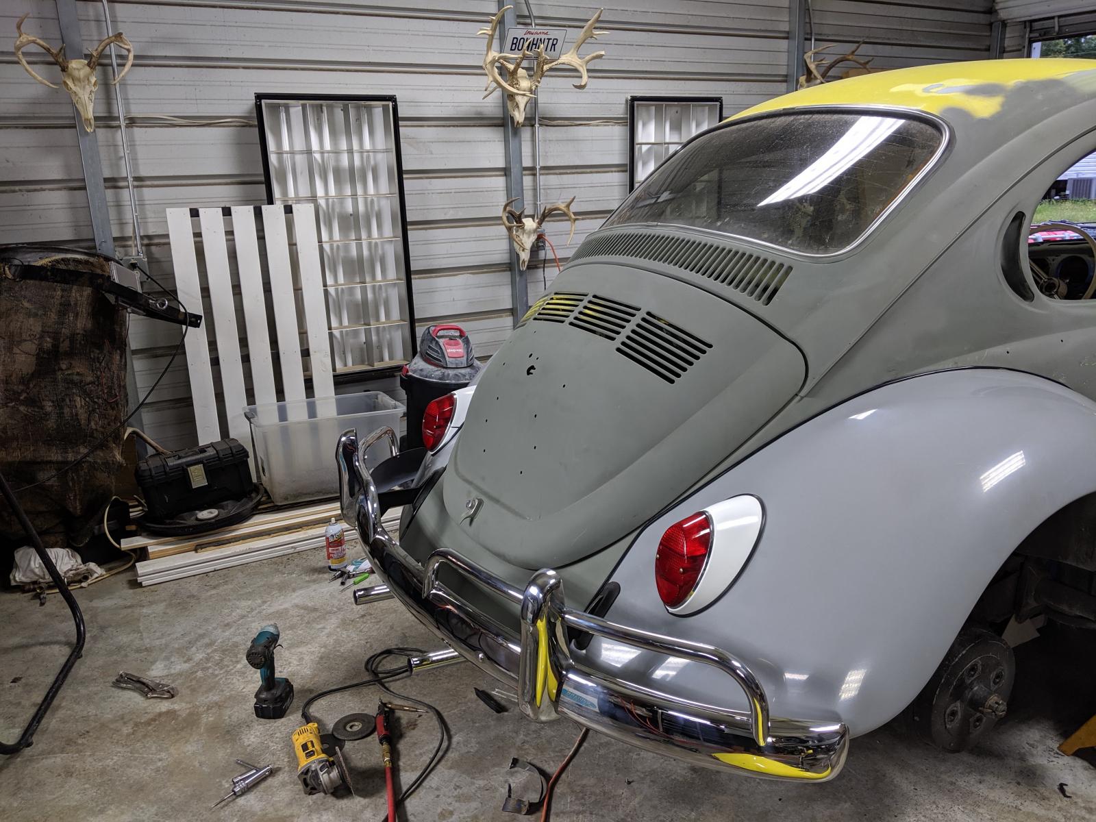

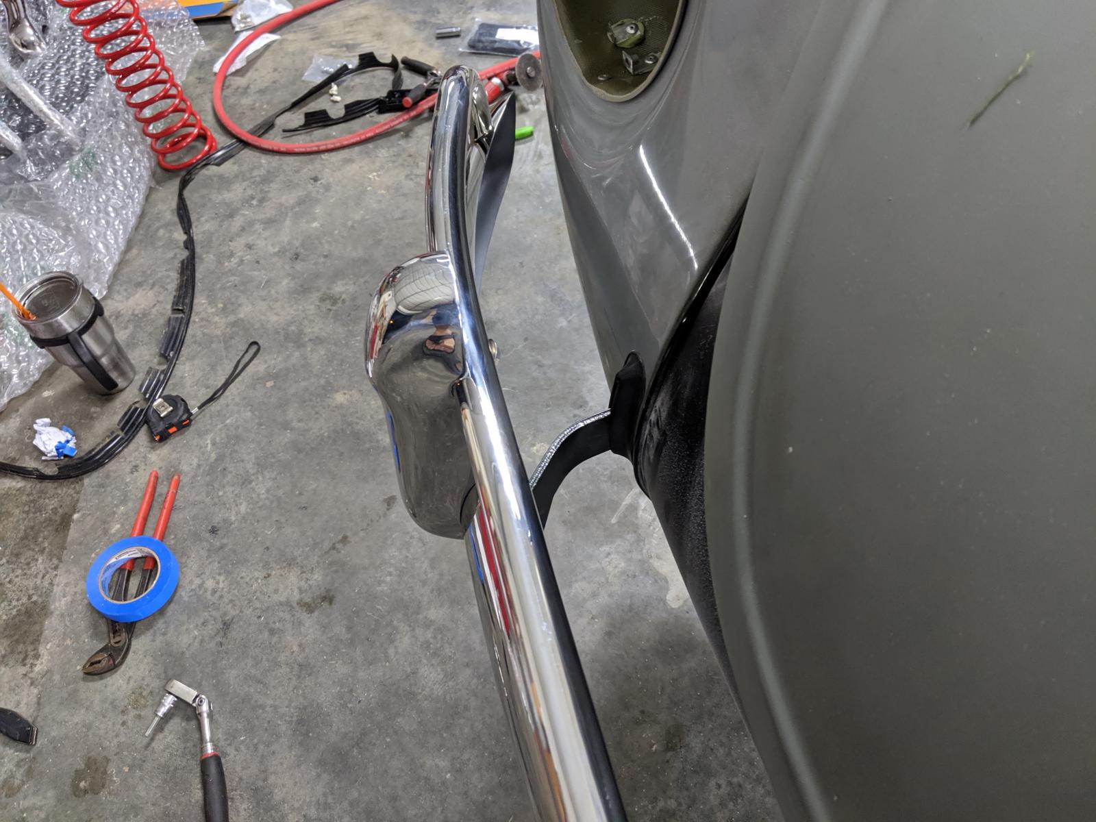

It can be done. And very tasteful if done correctly. The conversion brackets will work, but you either have to modify them to fit the bumper bolt holes, or re-drill new holes to adapt to the bracket.

@Chandabear, not clear from your pics but does the stock early style bumper span the entire width of the car in both the front and the rear? From your pics it looks like the front bumper is well within the width of the front fenders, but the rear appears just about the correct width as the rear fenders?
I bring it up because it was mentioned in the earlier thread that the front bumper was a custom stainless blade that was wider than stock to match the wider width of the SB.

Chadabear
Posts: 106
Location: LA
PostPosted: Tue Jun 29, 2021 8:54 am    Post subject: Re: Putting older Bumpers/Fenders on a '74 Super Reply with quote
I do like the retro look you have going there. Cool
Thanks man!, both front and rerar bumpers were widened to match the exact extra that was added to the fenders. In person, they both fit the body and have I guess roughly an inch inside both sides??? Could be less. But neither of them go past the width of the fenders.

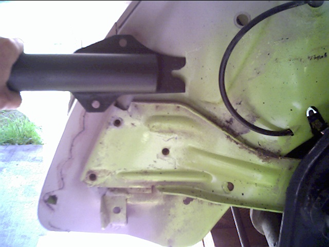

H2OSB wrote:
My issue is the car is a '74 with shock absorber bumper brackets. Is the bolt pattern the same? Will the holes line up?
I believe the answer is no and no.

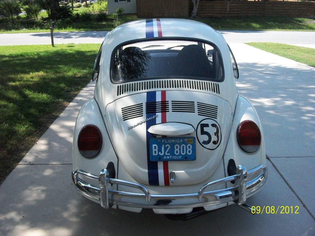

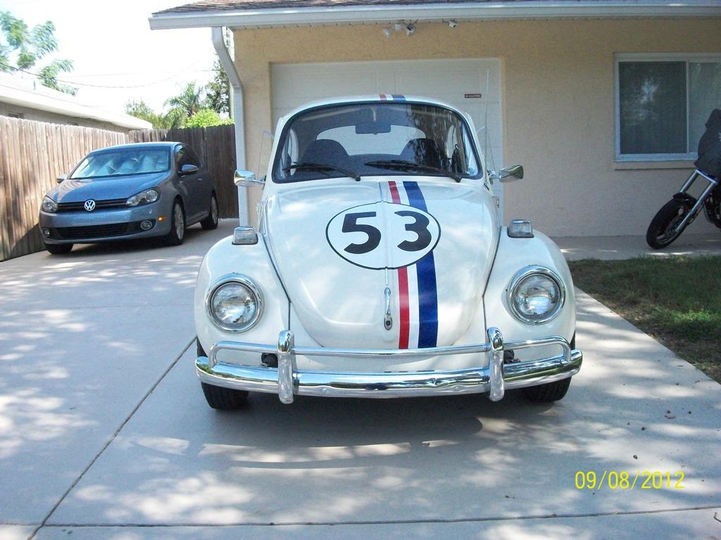

This pic describes the issue with using a '75+ shock absorbing bumper on a pre-74 STD Beetle. I've not tried it personally, but it seems like the holes/bolt placement are not at all the same.
I had a '73 Super I recently sold. On that car, my son had had a minor fender bender and I replaced the fenders with ones from a '74 i had on hand. The holes absolutely did not align in a way that made brackets easy to design. This was the rear. I had no issues with '74 fenders on the front.
Your car looks outstanding, IMO!
H20SB
All the holes do not line up, but you can redrill them with plenty of room.
