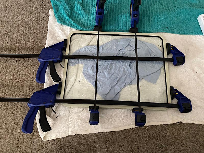

Pop out glasses installed today under the aircon. Too hot in the shed today. Clamps helped line up the screws and went together very nicely. Just the outer seal to finish but I’ll do them at a later date.

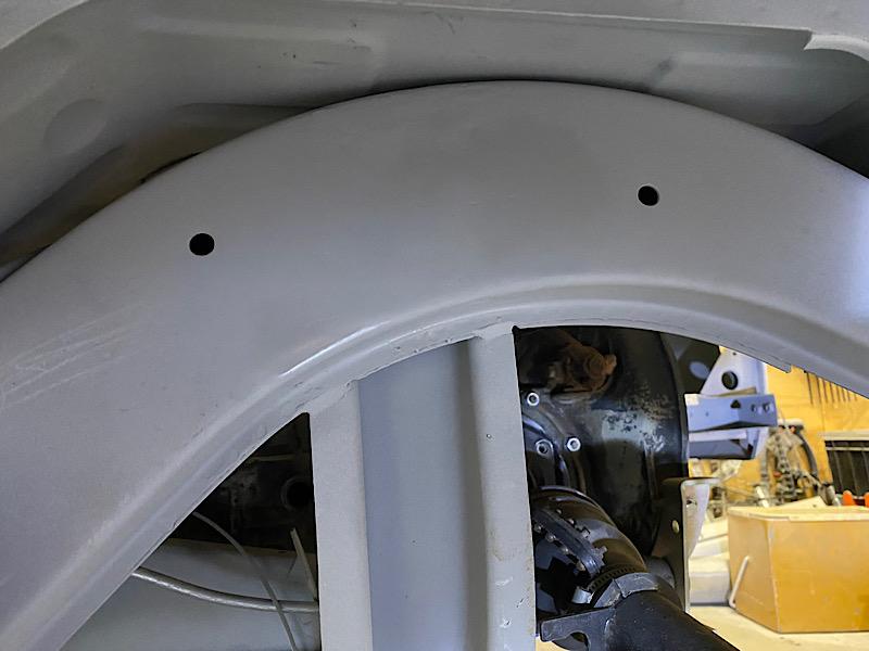

PostPosted: Mon Jan 02, 2023 12:30 am    Post subject: Re: Rusty's '63 11 window Reply with quote
Starting to work on straightening the panels out

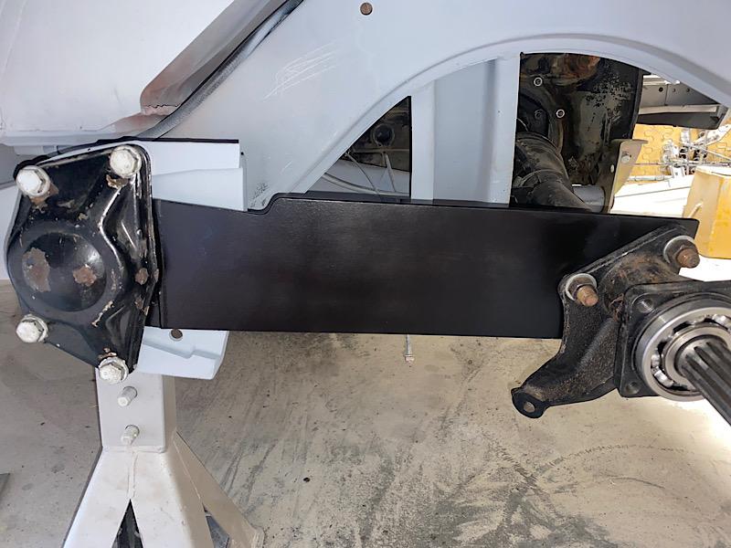

PostPosted: Sat Mar 11, 2023 2:18 pm    Post subject: Re: Rusty's '63 11 window Reply with quote

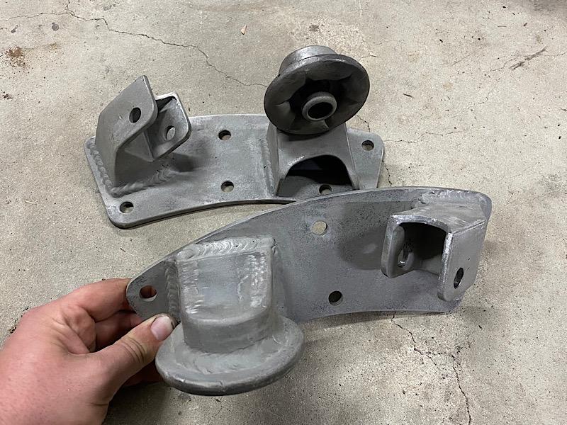

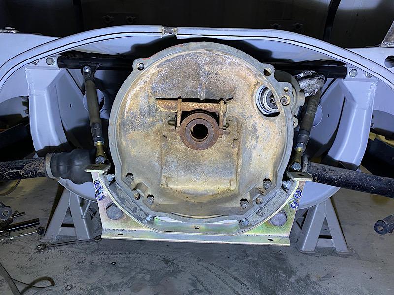

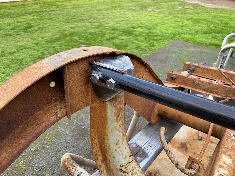

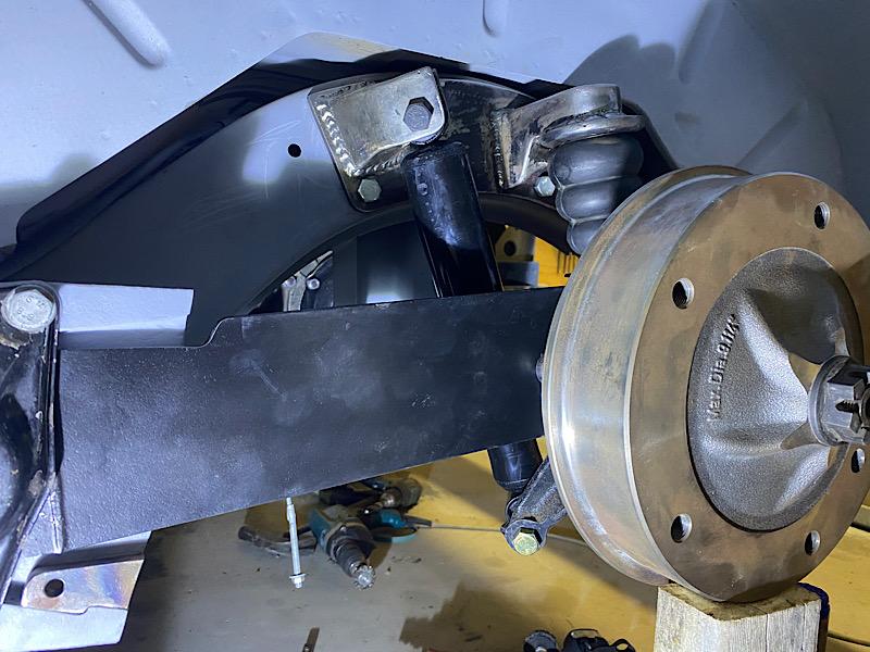

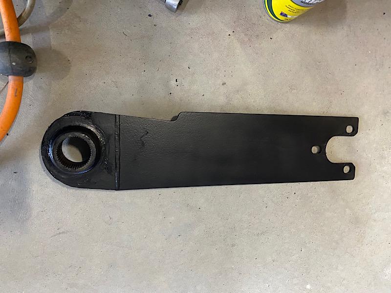

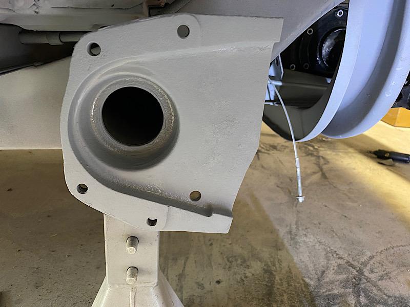

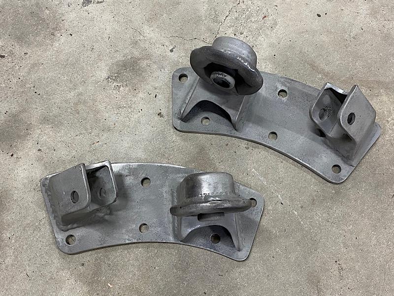

Some rear suspension work that’s been happening. Torsion housing/ spring plate work. Dummy transmission to get everything set up. Top shock mounts removed and getting ready to fabricate new mounts, bump stops etc. Piss coat of black is not final paint, just to make things nicer to work with while setting up.

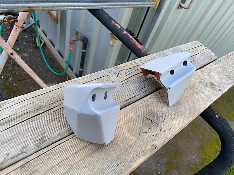

PostPosted: Mon Apr 17, 2023 3:30 am    Post subject: Re: Rusty's '63 11 window Reply with quote

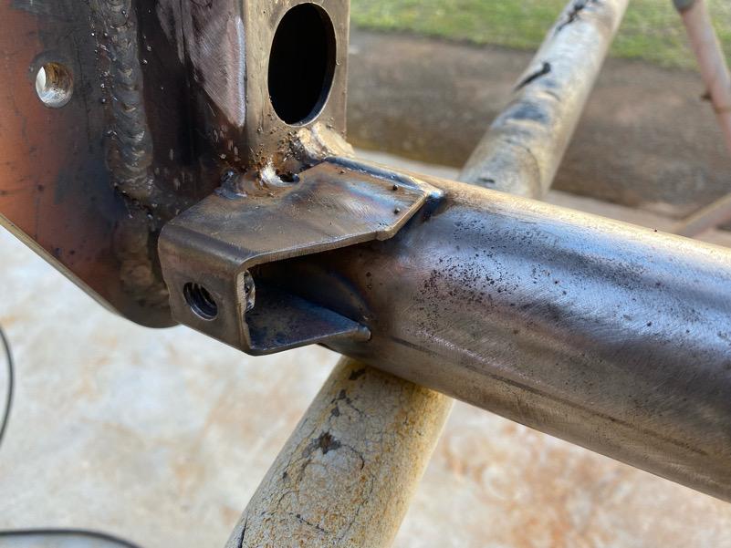

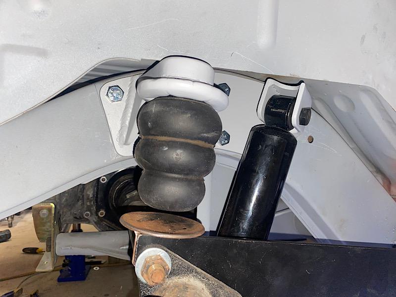

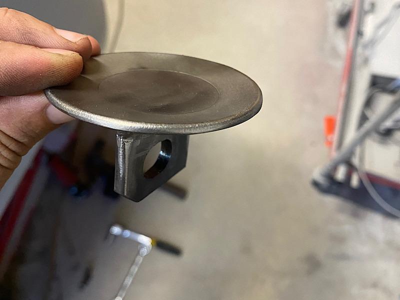

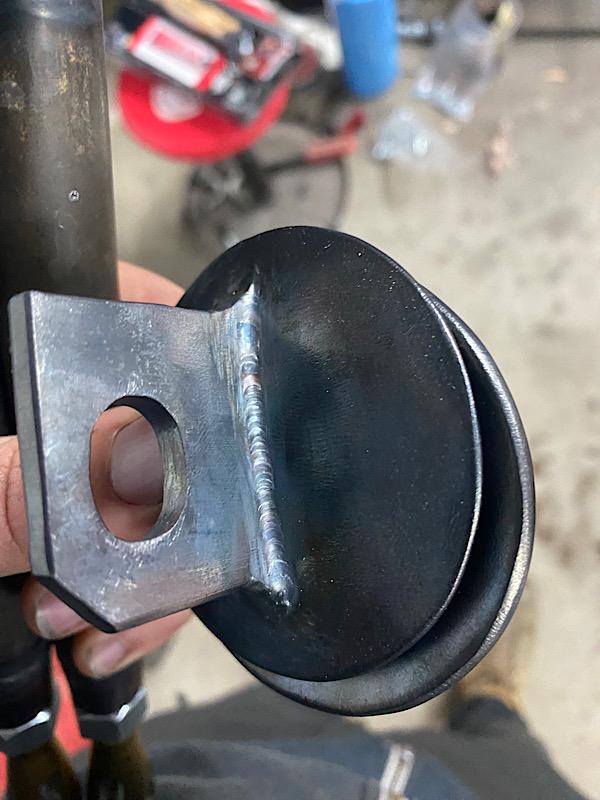

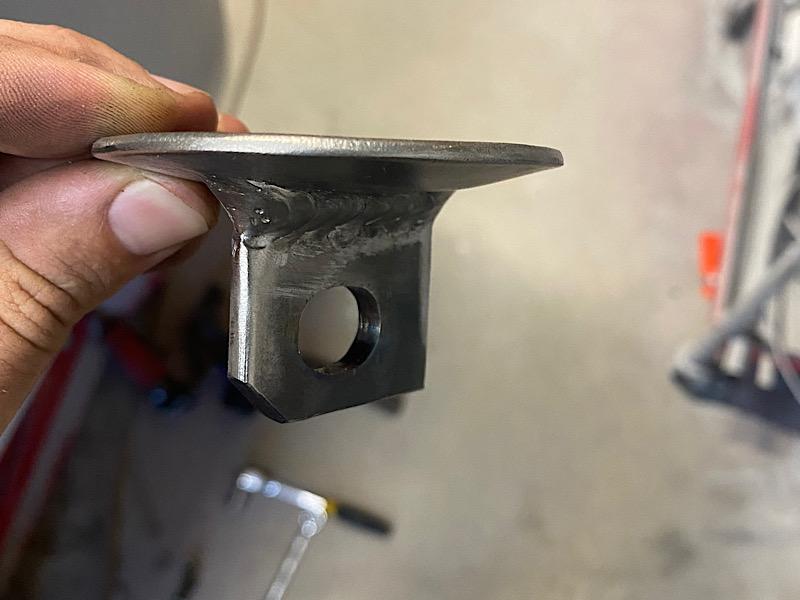

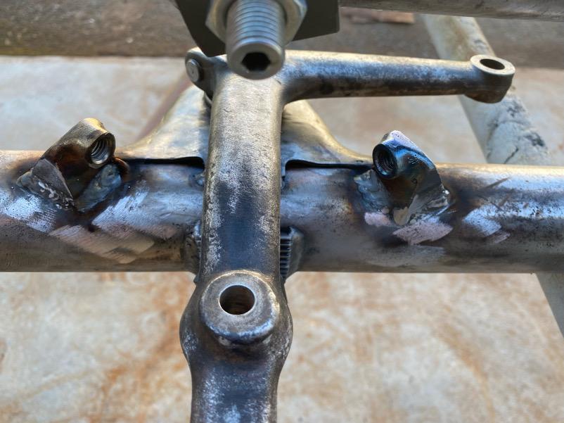

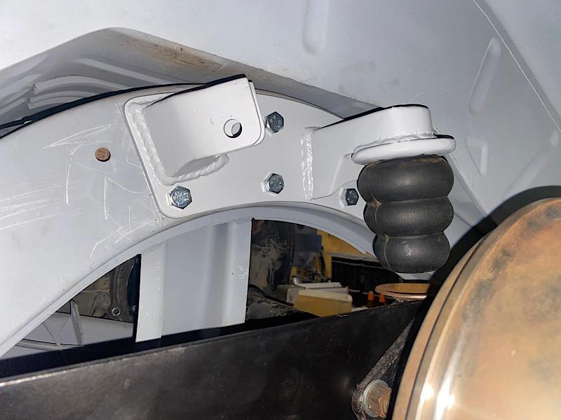

Just about done with the shock mount/ bump stops for the rear suspension. These mounts have a 6mm plate on the inside of the chassis, m10 threaded and with nuts welded on for a good purchase. These we way more work then I’d like to admit but I’m happy with how they have turned out.
ryans65
Joined: February 16, 2016
Posts: 1320
Location: Yulee FL
ryans65 is offline
PostPosted: Mon Apr 17, 2023 5:44 am    Post subject: Re: Rusty's '63 11 window Reply with quote
that shock mount/ bump stop combo is awesome!
Huetti_1989
Joined: February 13, 2011
Posts: 1324
Location: Austria
Huetti_1989 is offline
PostPosted: Wed Apr 19, 2023 2:24 am    Post subject: Re: Rusty's '63 11 window Reply with quote
wow, that wels looks clean

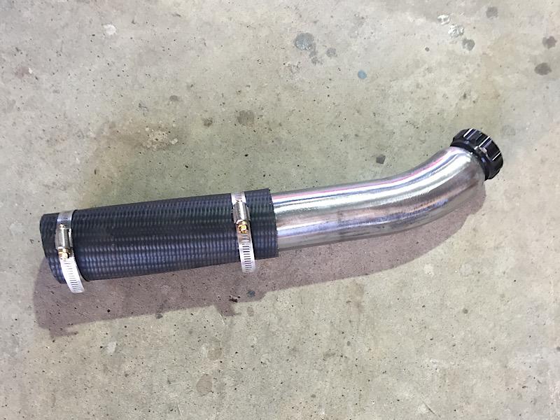

PostPosted: Fri May 26, 2023 4:26 pm    Post subject: Re: Rusty's '63 11 window Reply with quote

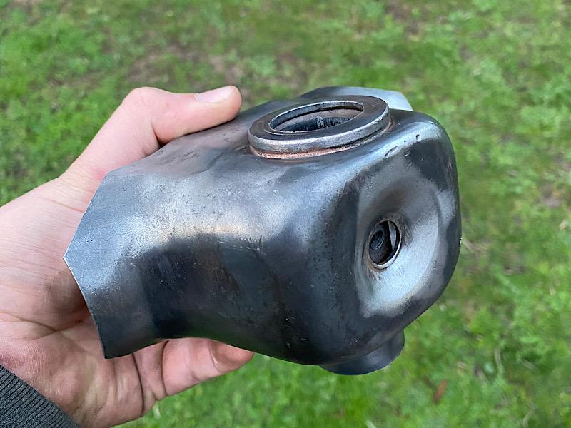

“Wizard fuel neck” trial fit for the bay tank. Can now be put in the pile of parts ready for paint.
karl h
Joined: October 10, 2005
Posts: 628
Location: austria
karl h is offline
PostPosted: Sat May 27, 2023 7:35 am    Post subject: Re: Rusty's '63 11 window Reply with quote
is that the stock bay part with the metal collar removed?

Mid West Dubber
Joined: July 11, 2011
Posts: 341
Location: Natimuk, VICTORIA, AUSTRALIA
Mid West Dubber is offline
PostPosted: Thu Jun 08, 2023 4:06 am    Post subject: Re: Rusty's '63 11 window Reply with quote
Complete remanufactured part by a friend in Adelaide, Aus

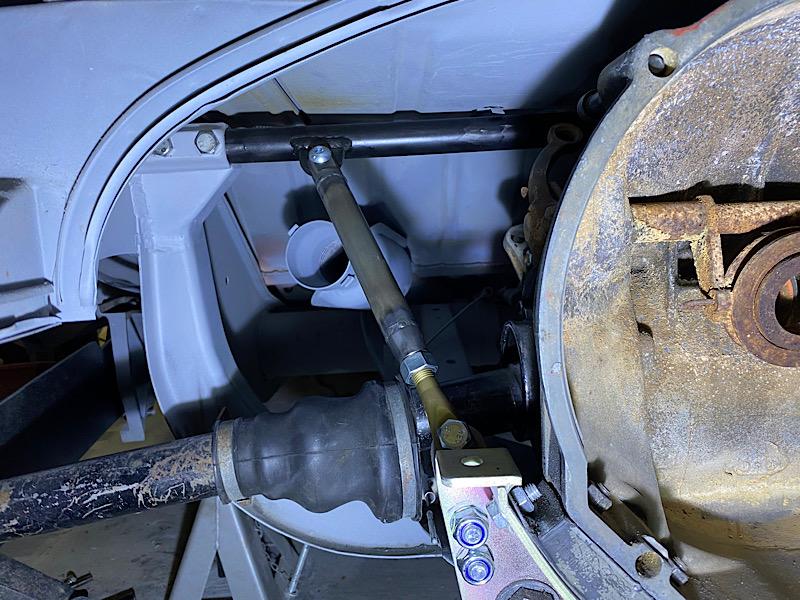

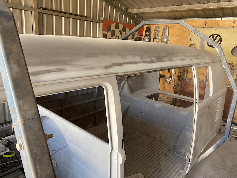

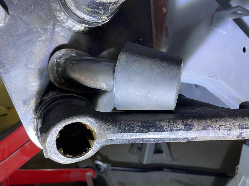

Kafer bar coming together. Another time consuming job with plenty of fabrication. Some critical placement to take into consideration, fuel tank outlet, starter motor and heater pipe clearance being the main items.
The diagonal arms I made from chromoly tube and clevises and tig welded by an engineer in town. Also had him tig the back side of my bump stop pads

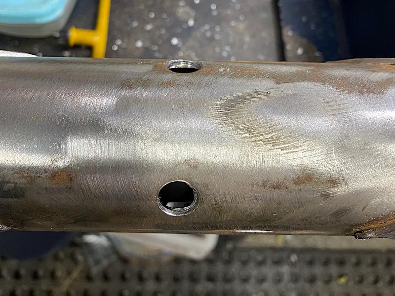

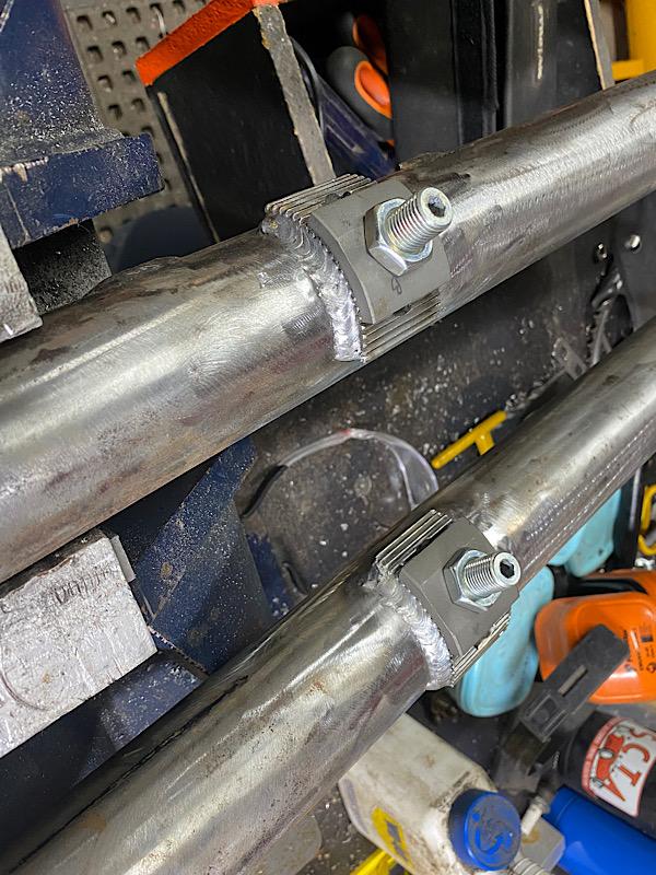

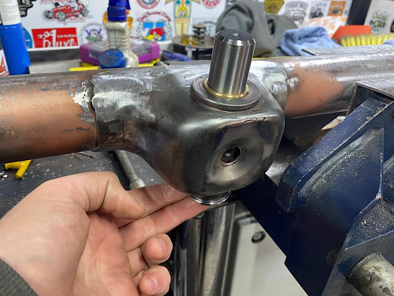

Mid West Dubber
Posts: 341
PostPosted: Mon Sep 04, 2023 10:08 pm    Post subject: Re: Rusty's '63 11 window Reply with quote

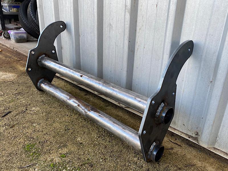

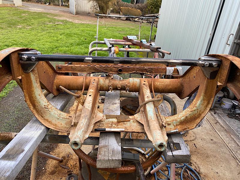

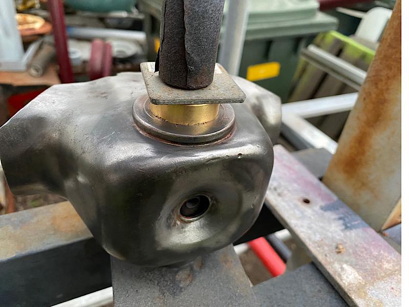

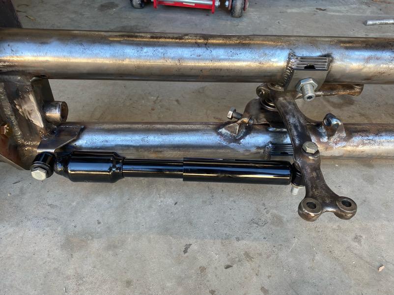

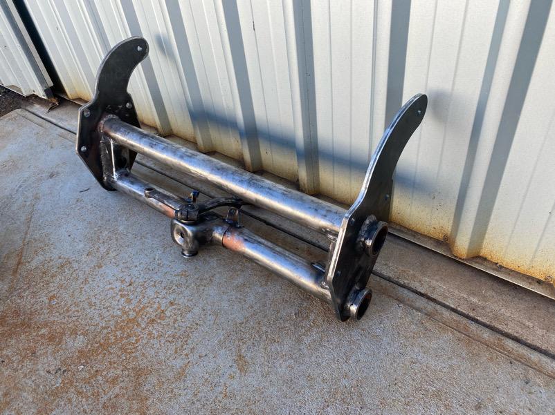

Few progress shots of the 2.5inch narrowed beam I am building.
I designed the end plates and had a local business have them laser cut for me. These were a combination of a couple of end plate designs.
CSP adjusters fitted, new bushes installed for centre pin, welded back on and reamed.

PostPosted: Thu Oct 12, 2023 4:04 am    Post subject: Re: Rusty's '63 11 window Reply with quote
Beam is almost done. Bump stop location moved down slightly to ensure the bump stop contacts with the most amount of surface area. Adjustable steering stops, steering dampener bracket fabricated to almost match an original. Shocks spaced and setup.

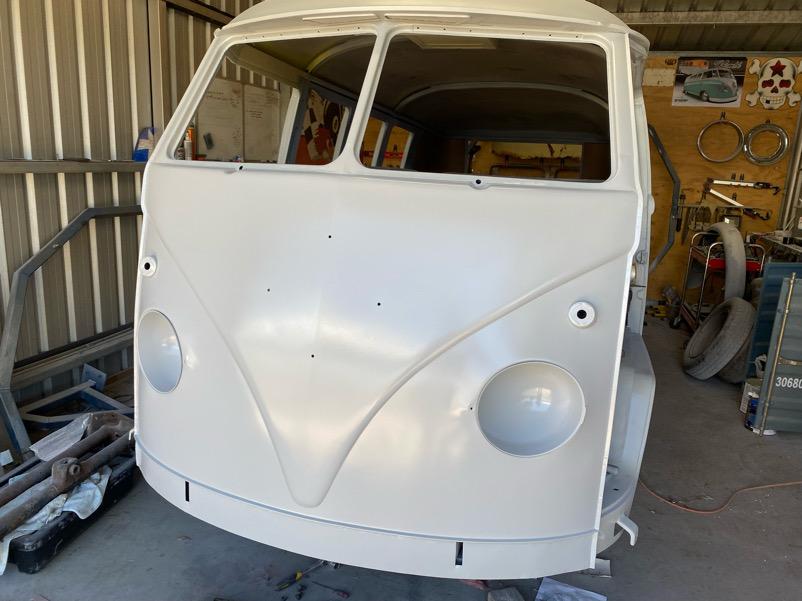

Front nose stripped and into epoxy. Also starting to sort out some imperfections on the long panel

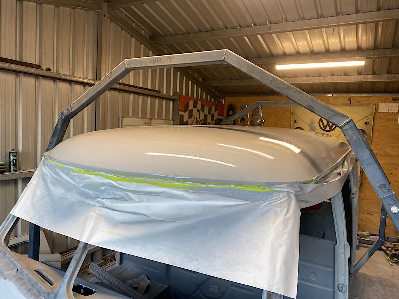

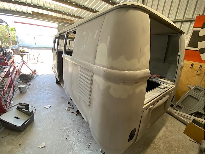

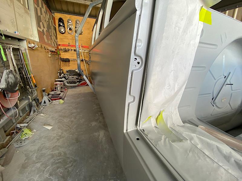

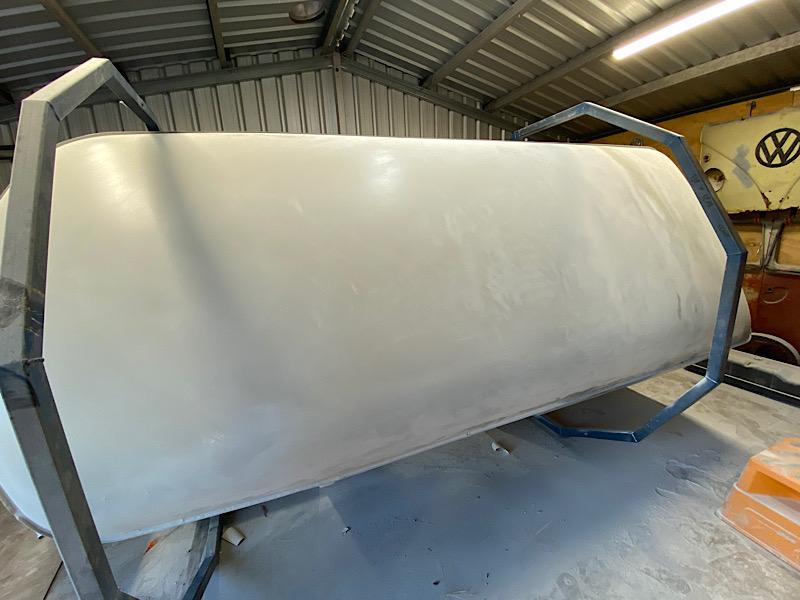

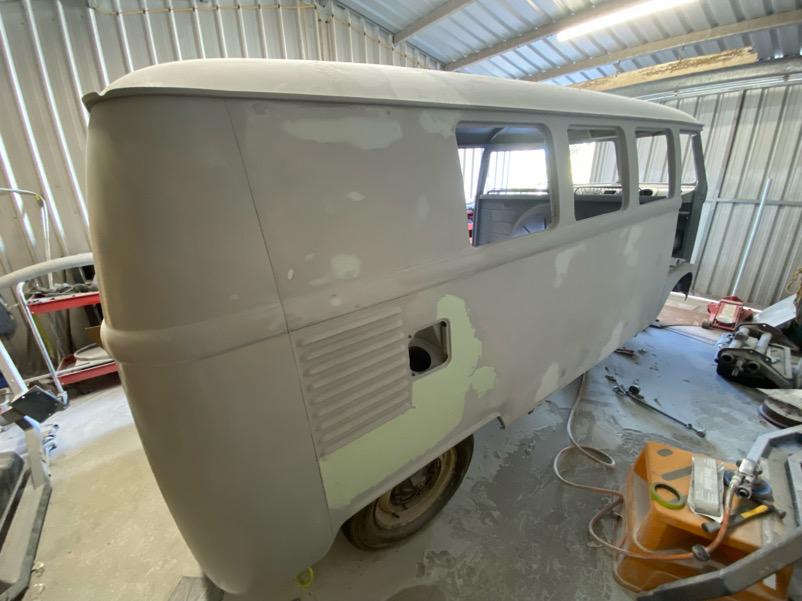

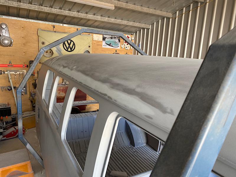

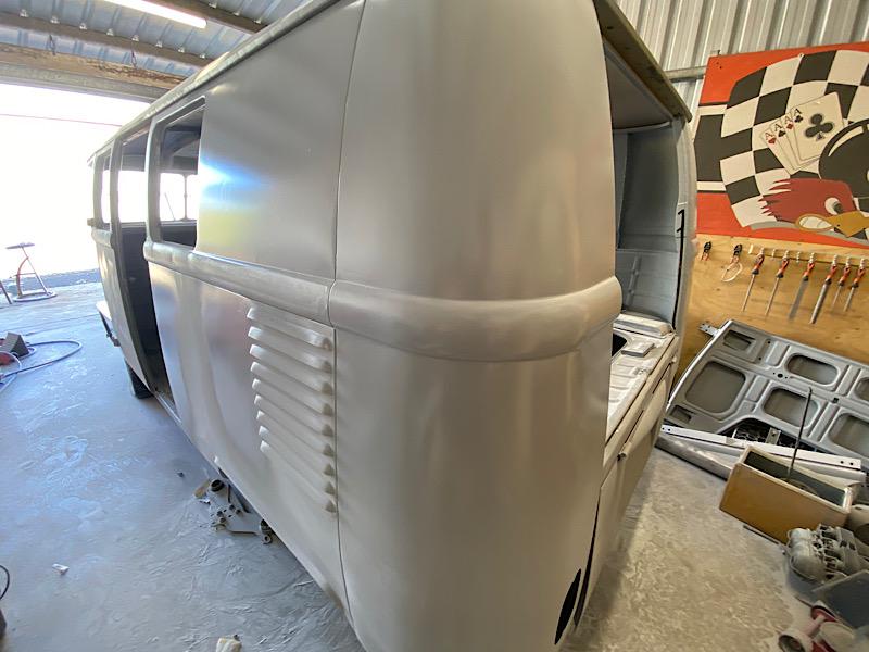

The sides of the roof had a low spot, assuming part of the stamping process. Light skim of filler to take care of this and some slight warping from welding.
Then a couple of coats of poly primer over the repairs. Blocked. Now have the whole roof into high build primer…

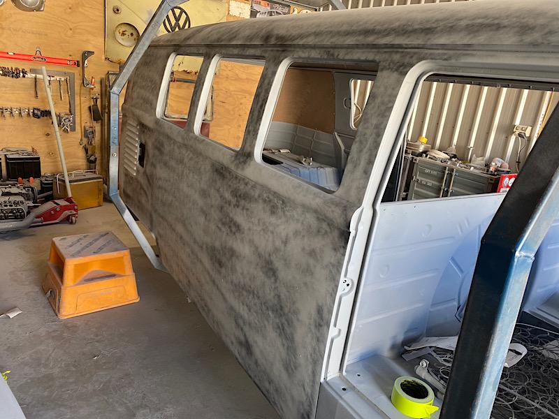

PostPosted: Sat Dec 23, 2023 11:07 pm    Post subject: Re: Rusty's '63 11 window Reply with quote

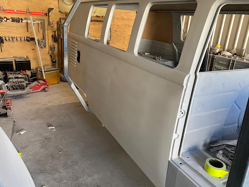

Long panel work continued. Got the bulk of the filler work done and got a good coat of poly primer on. Blocked that and fixed a few minor imperfections then touched up again for another round of blocking.

Now into high build primer…

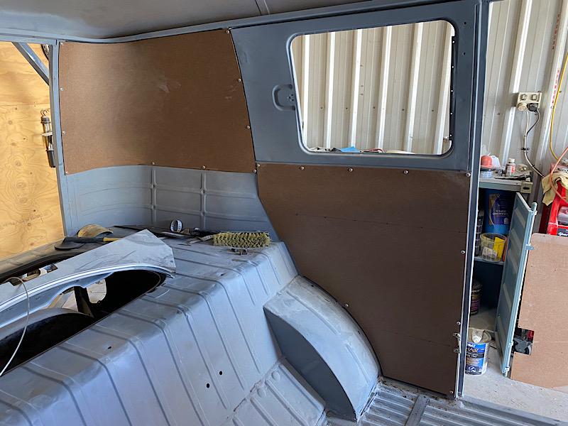

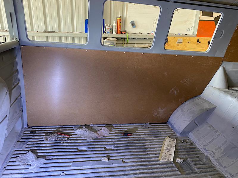

Something a little different on the hot humid days. Started making the interior panels..

How did you bend that upper rear panel? Steam? Or did you wet it? I’d like to see your process.
