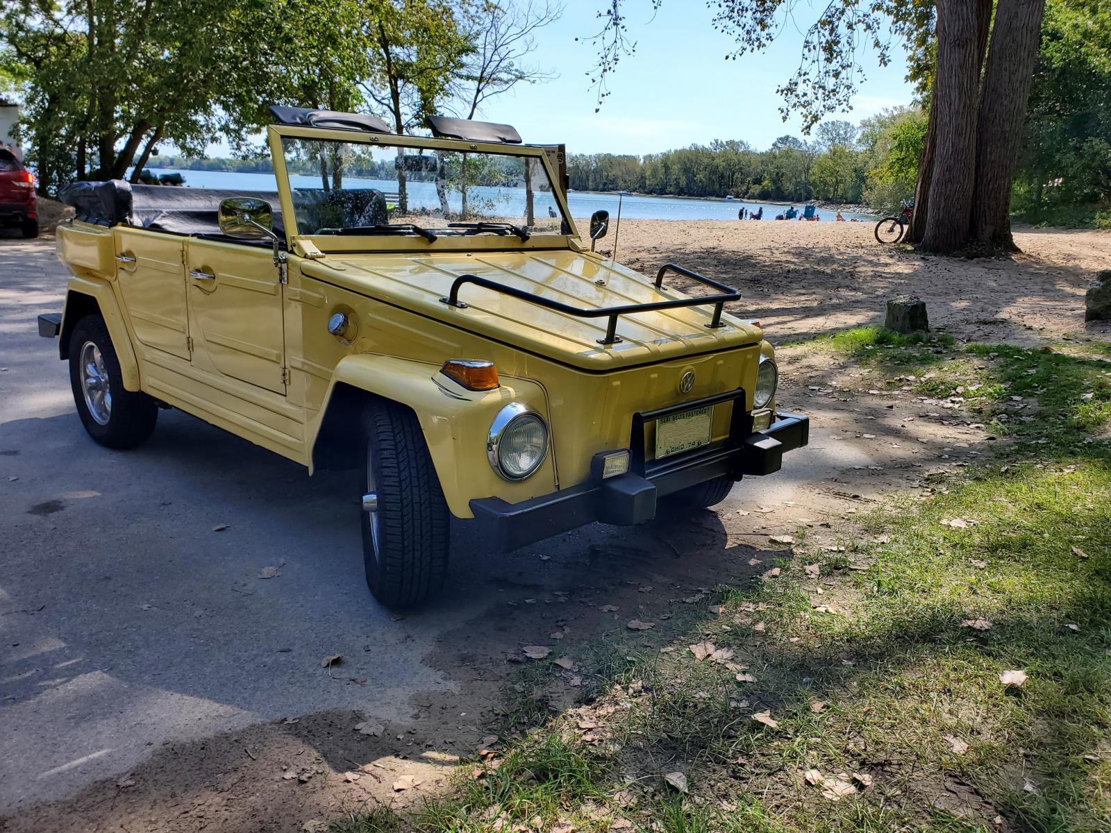

Had a brilliant idea last night while having a couple drinks, take a trip to Kelley's Island. My daughter was up for a trip so we got up today and took about a 2 hr, 100 mile drive and a 20 minute ferry trip to Kelley's island. Spent the day driving around the island, walking the beaches and enjoying a great day.
Had a front row seat on the way back and was first on, first off.
Stopped at a nearby lighthouse on the way back and got a lake side picture
Talked with numerous people about the Thing, had people taking pictures and lots of waves, beeps and thumbs ups.
Of course it wouldn't be a complete trip without something to fix afterwards. Saw my brake light was coming on when stepping on the brakes during the trip home. As it got darker, noticed the generator light would also come on. After pulling in the driveway, my daughter said the brake lights weren't working. Will need to check into that soon as I'm planning on a longer trip next weekend.
All in all an awesome Thing day!

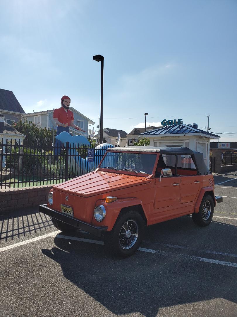

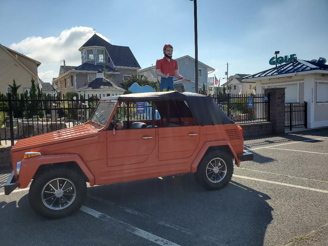

took a ride over the bridge and along the coast

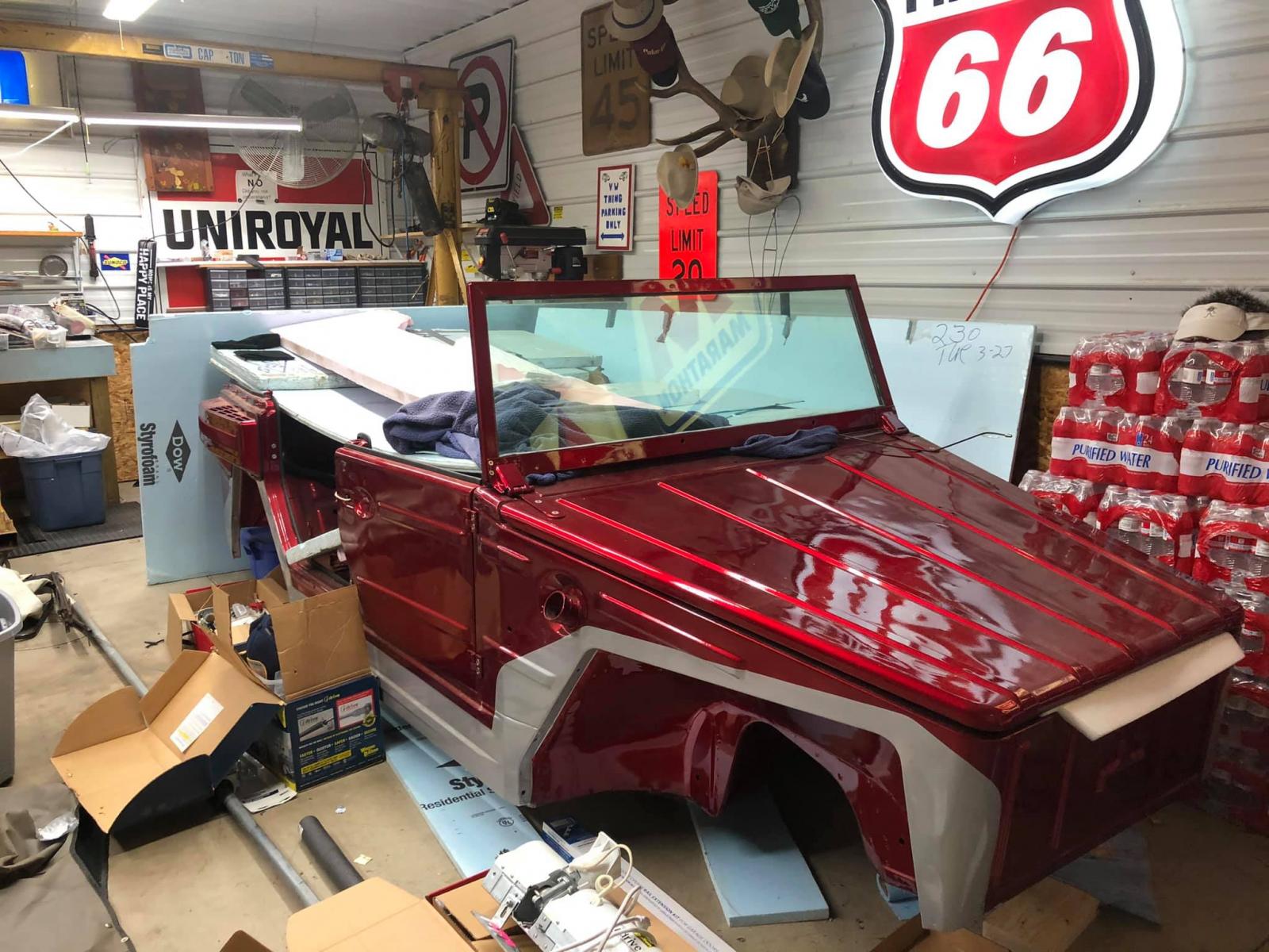

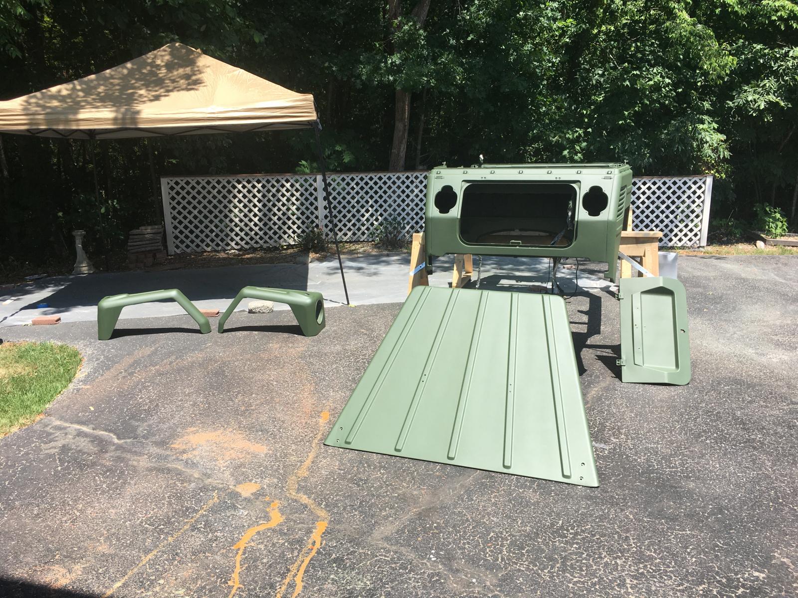

Paint day! Put the new color on it today. Finally can start reassembly. 😎

Nice! You must be excited looks great!

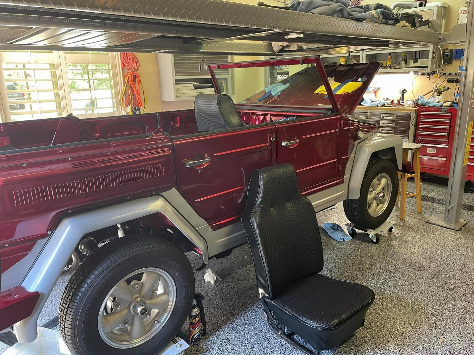

More done this week. Dreading installing the new windshield.

It's a piece of cake.
Find a large flat working surface. I used the top cover on my Hot Tub.
Laydown some padding. Moving blanket works well.
Install rubber seal around glass
Insert windshield with seal into upper frame as far as possible without using force.
Bring in lower frame to mate with upper frame.
May have to guide seal into channel a bit
Using a couple of ratchet straps, slowly and evenly bring the upper and lower frame together until the holes line up.
You can use corn starch (dry method) or soapy water (wet method) as a lubricate if you wish but I didn't need it.
Resist any urges to pound on the edges of glass or frame.

Easiest windshield I’ve ever installed. No lube or straps. Slipped in nice and tight.
Now that was done I installed the bikini. And mirrors 😎
I’m still waiting for my door handle seals to arrive 😳

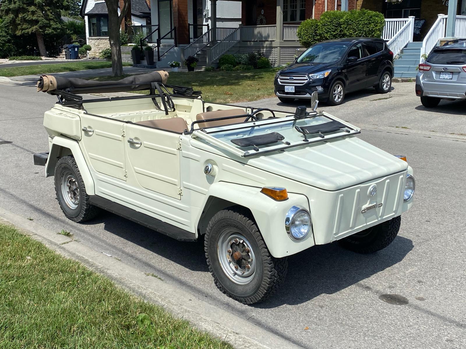

Drove it for the first time since 2005. Some small jobs left to do but felt good to drive her after so long.

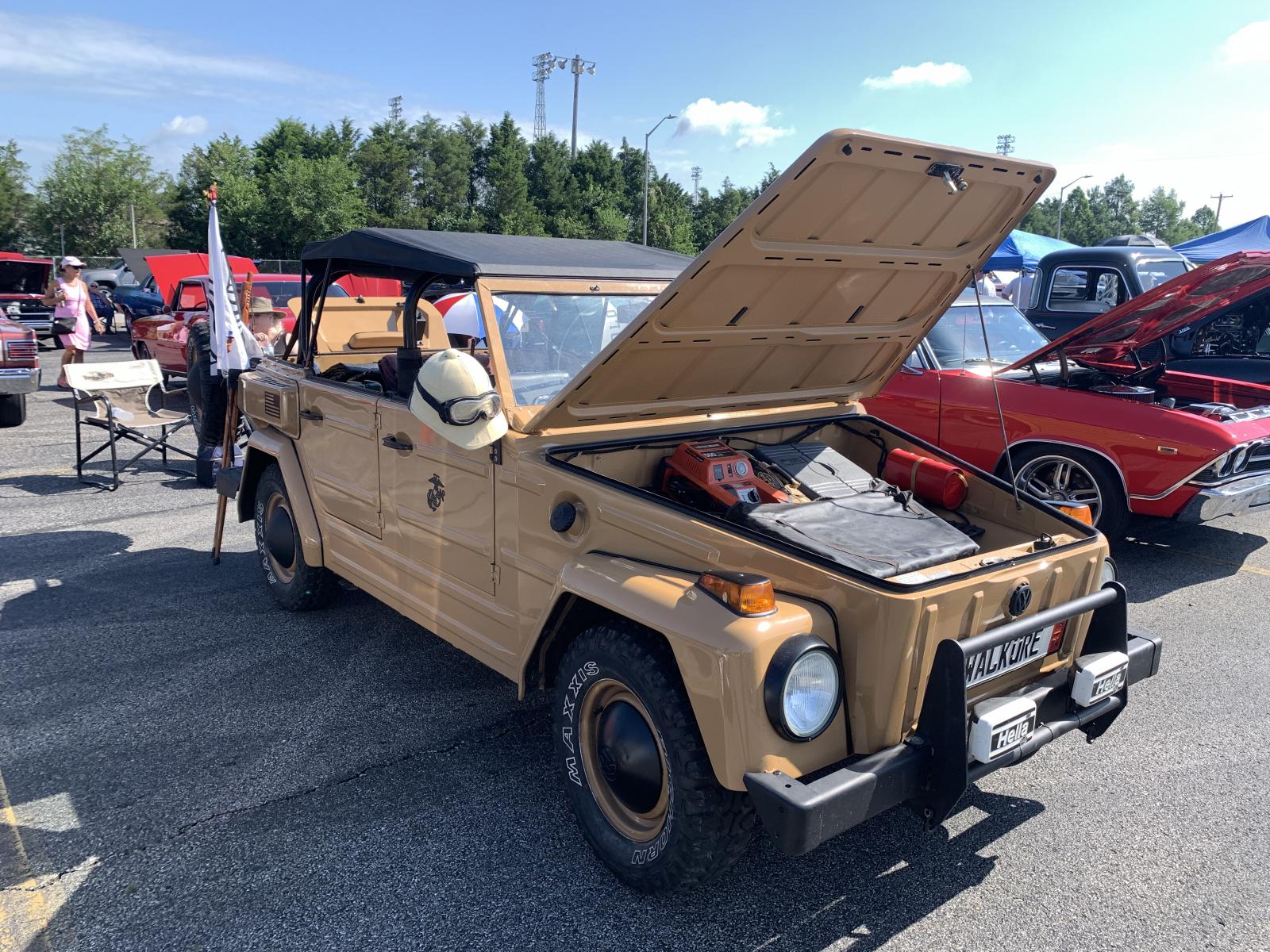

Attended 2022 "Stassenfest" car show in Jasper, Indiana. Overwhelmingly a display of American Iron. Wall to wall Corvettes, Mustangs, Jeeps and Pickup trucks. We were only 1 of 2 German based vehicles there.
