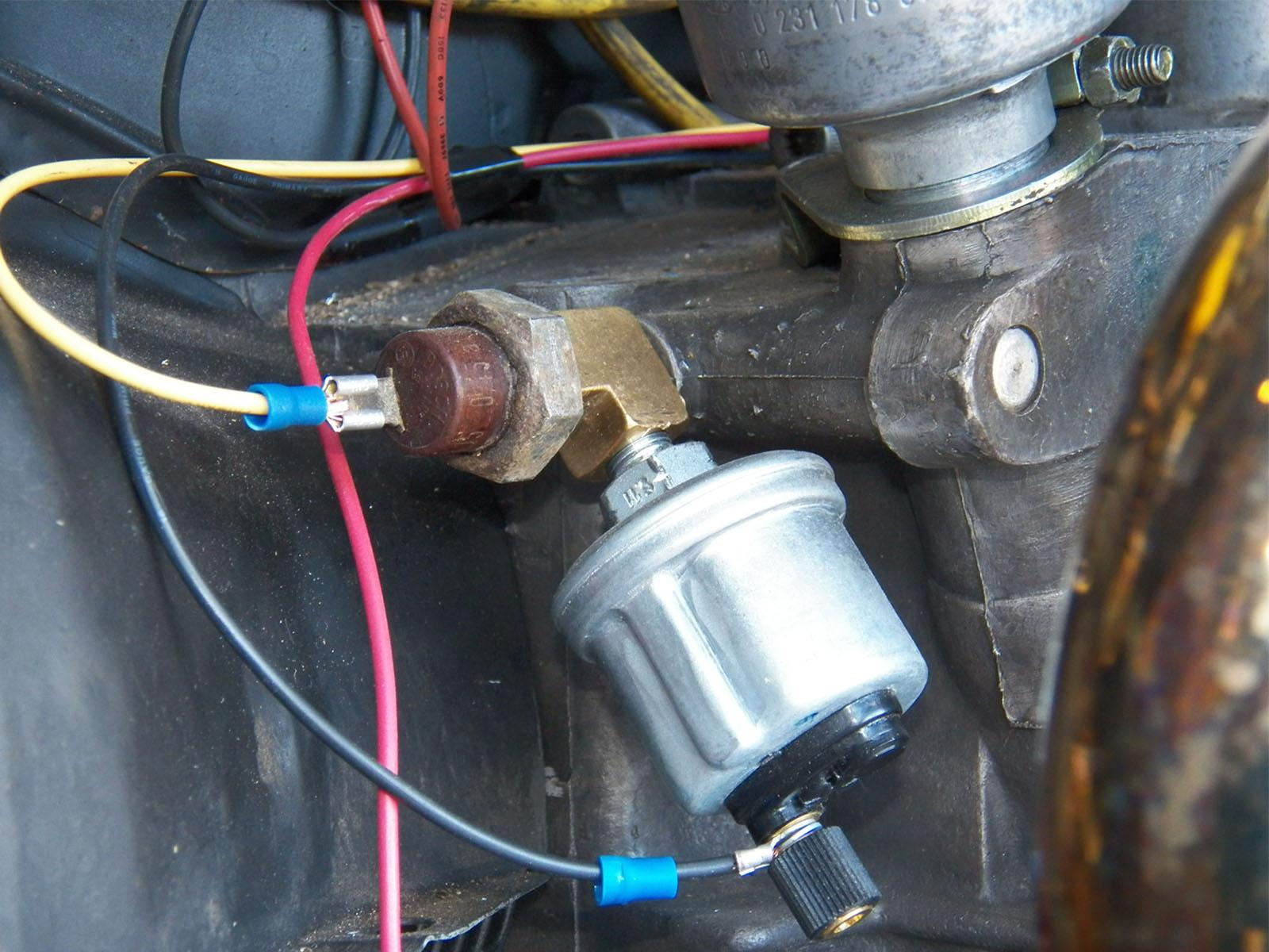

Here are the oil pressure senders, one for the light which I don't have yet and one for the pressure gauge.

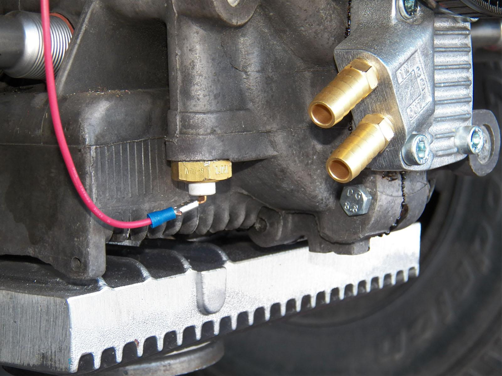

The oil temperature sender in the rear oil relief valve. The original one was a pain to get out, by the way. I took a pretty big flathead screwdriver and wedged it between some boards on the floor and the valve and turned it with a huge monkey wrench to finally get it loose. Crappy design by Volkswagen in my opinion, though they probably didn't design it with people like us in mind. Also in the pic are the hose barbs I couldn't find online without having to pay $10 or so in shipping. I finally found them local.

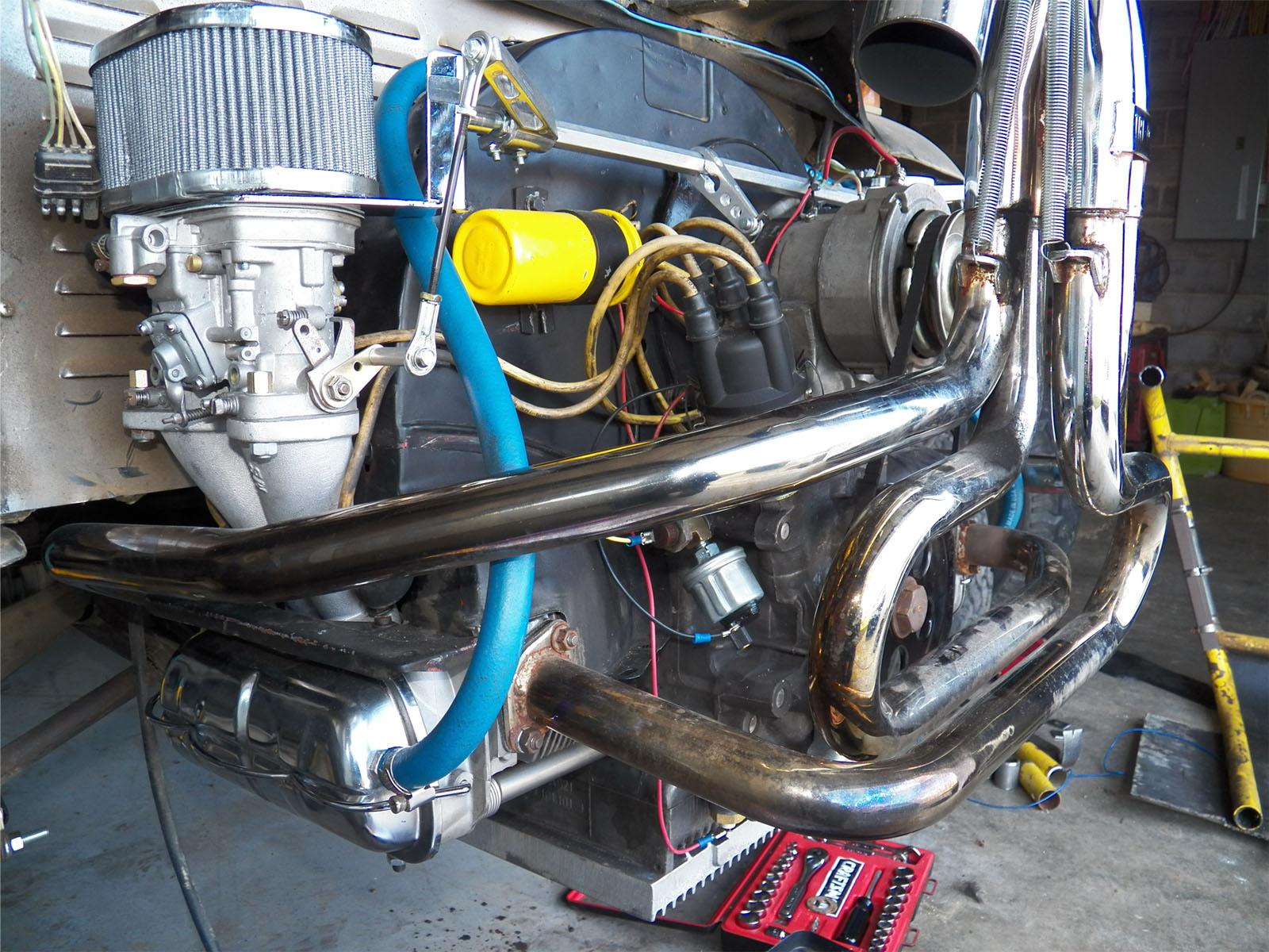

The breather box up top.
And finally the baja this engine is going in.

Your breather box is going to leak oil all over the place mounted the way you have it. They are vented between the top and box, the top MUST BE UP TOP. That's why it has the 2 mounting flange ears for bolting/riveting to a vertical surface.
