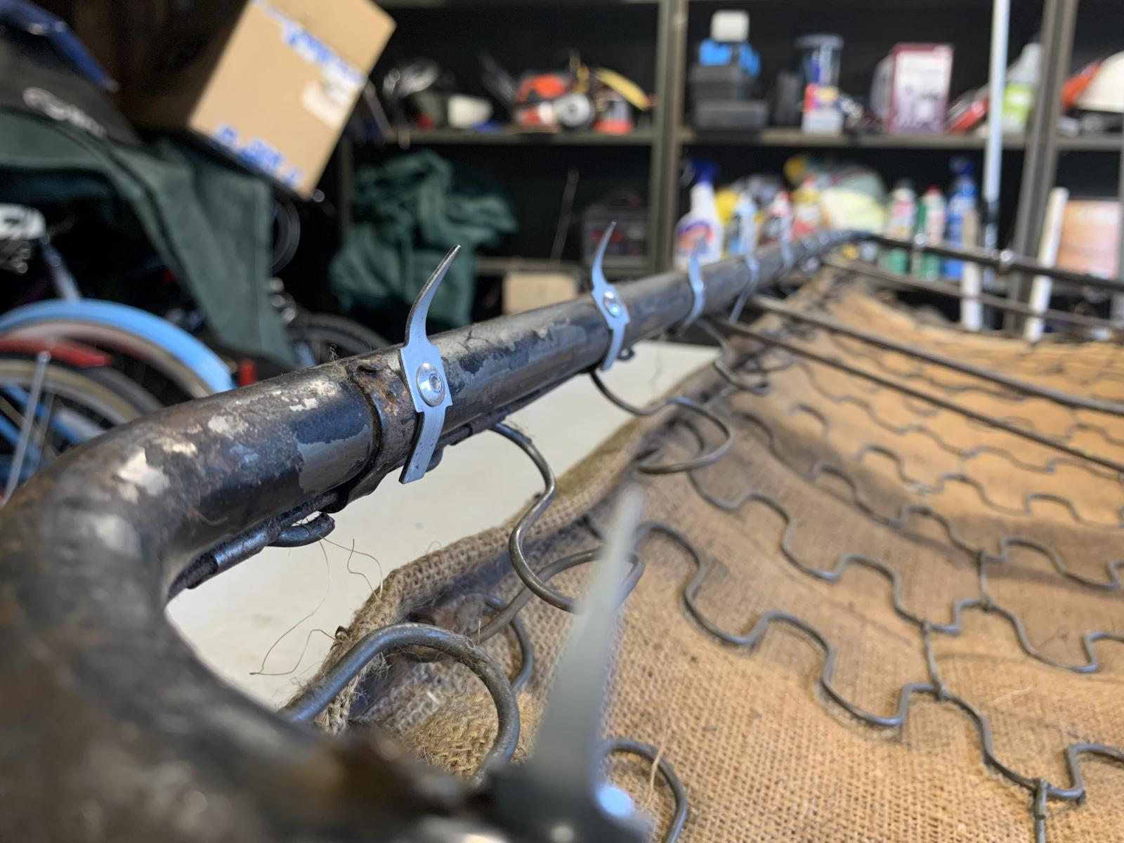

My seat frames are missing most of the spikes to do the upholstery OG so I’m fixing that problem. I was trying to figure out how to attach them to the frames and came up with the idea of pop riveting them. I had to put 21 on this seat back. These are the ones from Wolfsburg West.

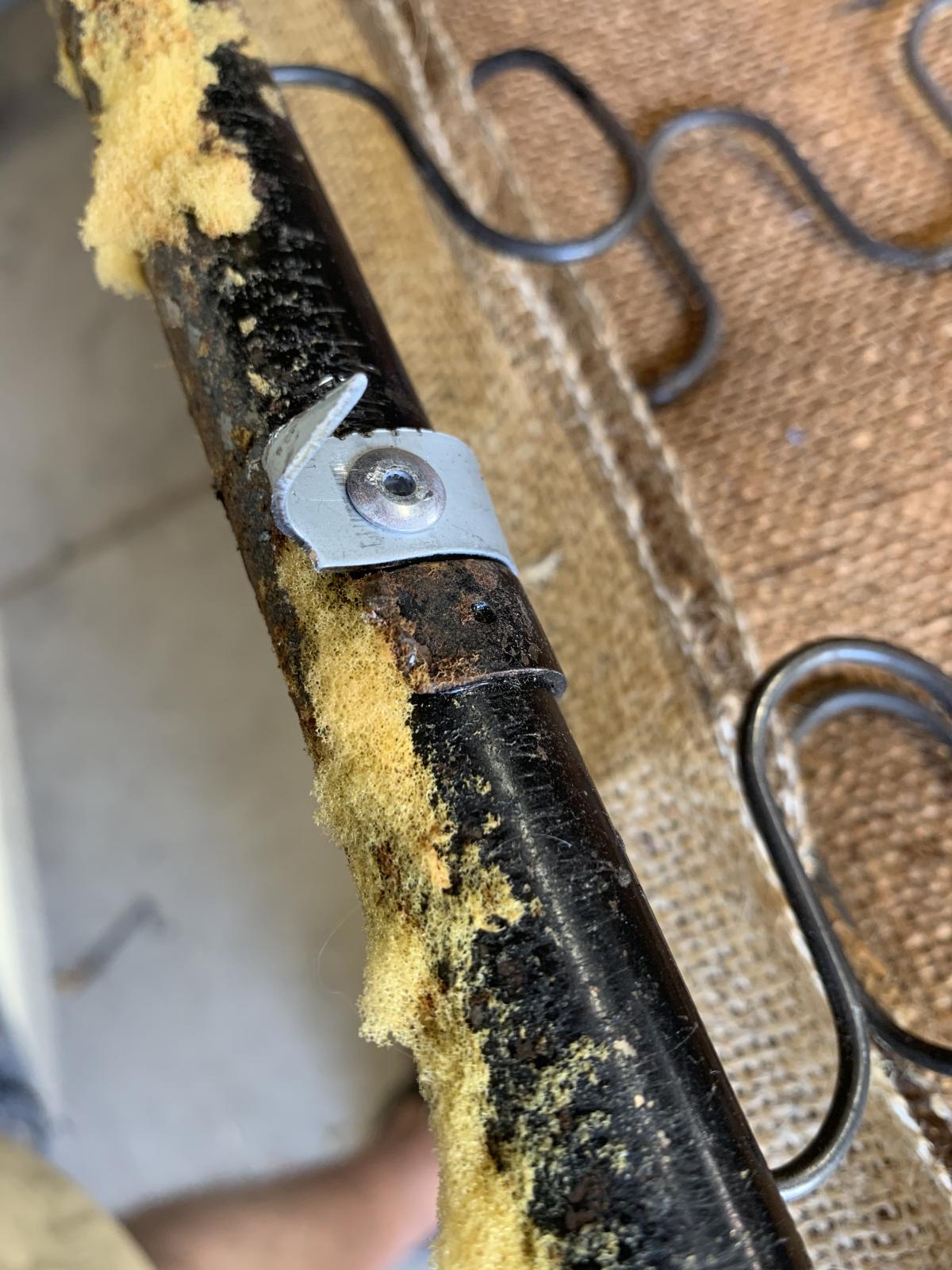

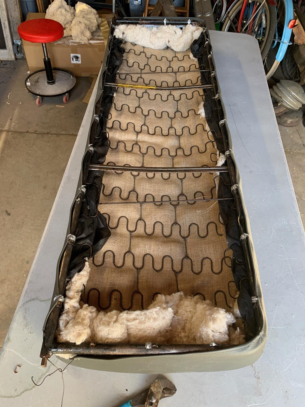

Well, I made a seat. Half a seat, actually. Not bad for my first seat. Seats are hard but it's good for me to not expect everything to be perfect. It's a journey. On a seat. Half a seat.
BTW, on that old Matt Miller video, he says go ahead use pliers, the vinyl is tough. It's not as tough as I thought it would be. Be careful.
I think my spikes were indeed too long and I had to stretch the vinyl more than I should have. Despite all that, I think it looks good.

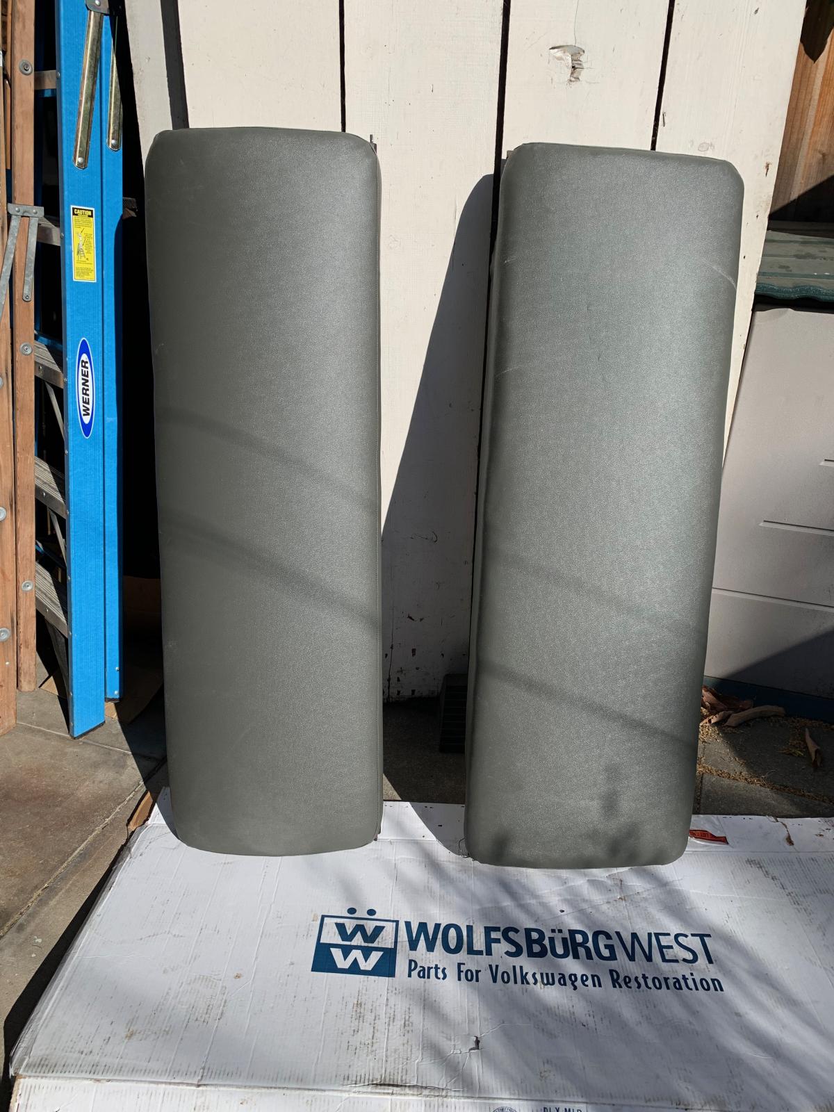

Woot, got the seat bottom done today. They look so good and they are comfortable, too, at least for the few minutes I tried them. I put some painters tape on my pliers and worked the vinyl more gently this time. Very happy with how they came out!

PostPosted: Fri Jun 04, 2021 7:27 am    Post subject: Re: Bob's 1959 Single Cab Pickup — "Otto" Reply with quote
Those came out really nice and smooth, nice work
I might be remembering wrong but I did see Matt Miller use pliers when he did the cover in a Double Cab.
I think they might have been smooth jaw pliers though.

Yeah, and I'd say to take out as much slack as you can. The seat bottom has the coconut pad, so it's much stiffer and easier to work with. I used some big clamps (with plastic jaws) to help this time, and it was much easier.
Anyway, these were from Deutsch Polster and definitely worth the money to get that OG look.

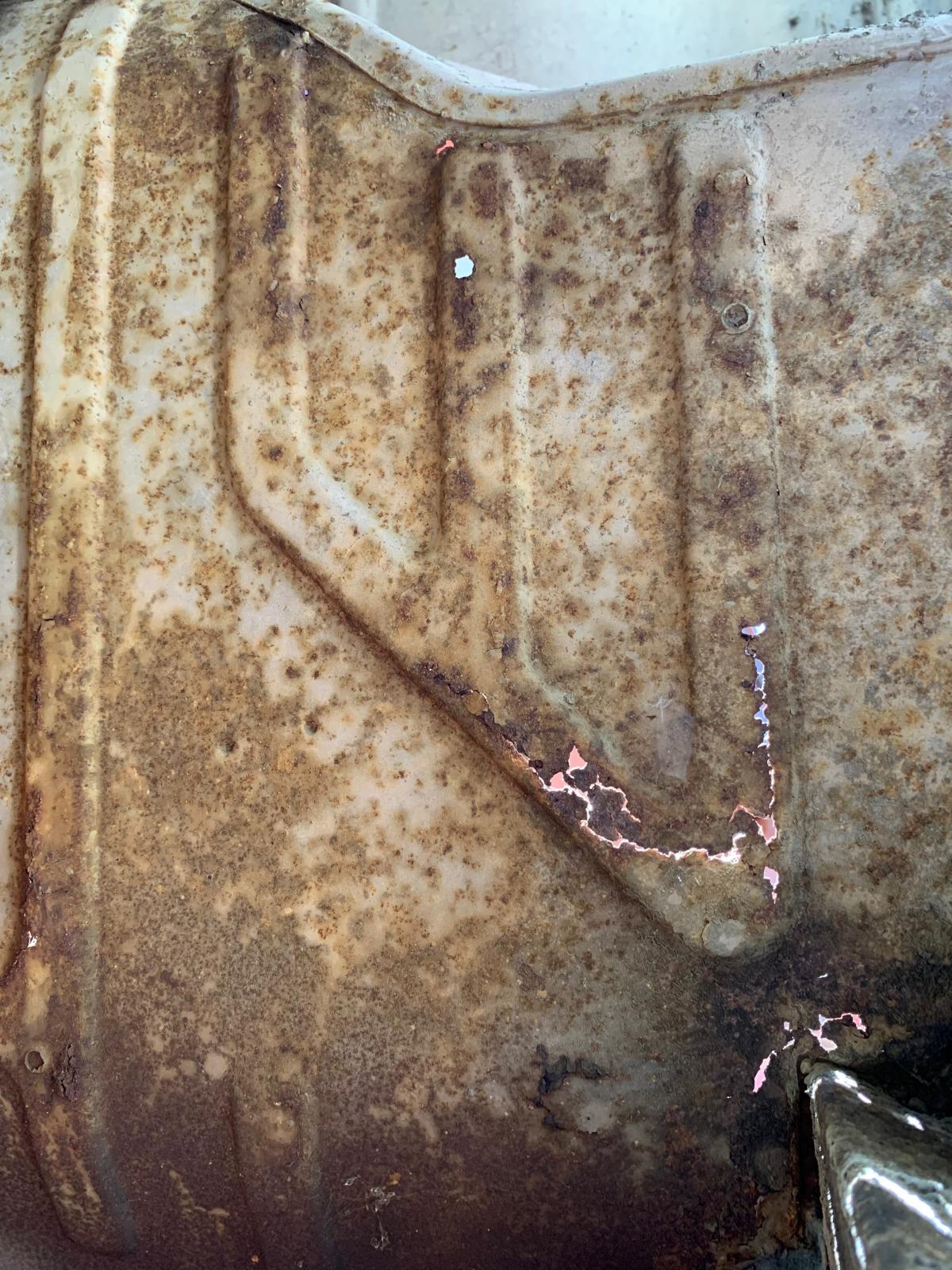

PostPosted: Mon Jun 07, 2021 9:23 am    Post subject: Re: Bob's 1959 Single Cab Pickup — "Otto" Reply with quote
Slow weekend on the truck.
Started getting this crap out of the door channels. Yuck.
Wired up the brake light switches and poured like a whole bottle of brake fluid into the brake system and still no pedal!
I think this is the most significant perforation rust on the truck

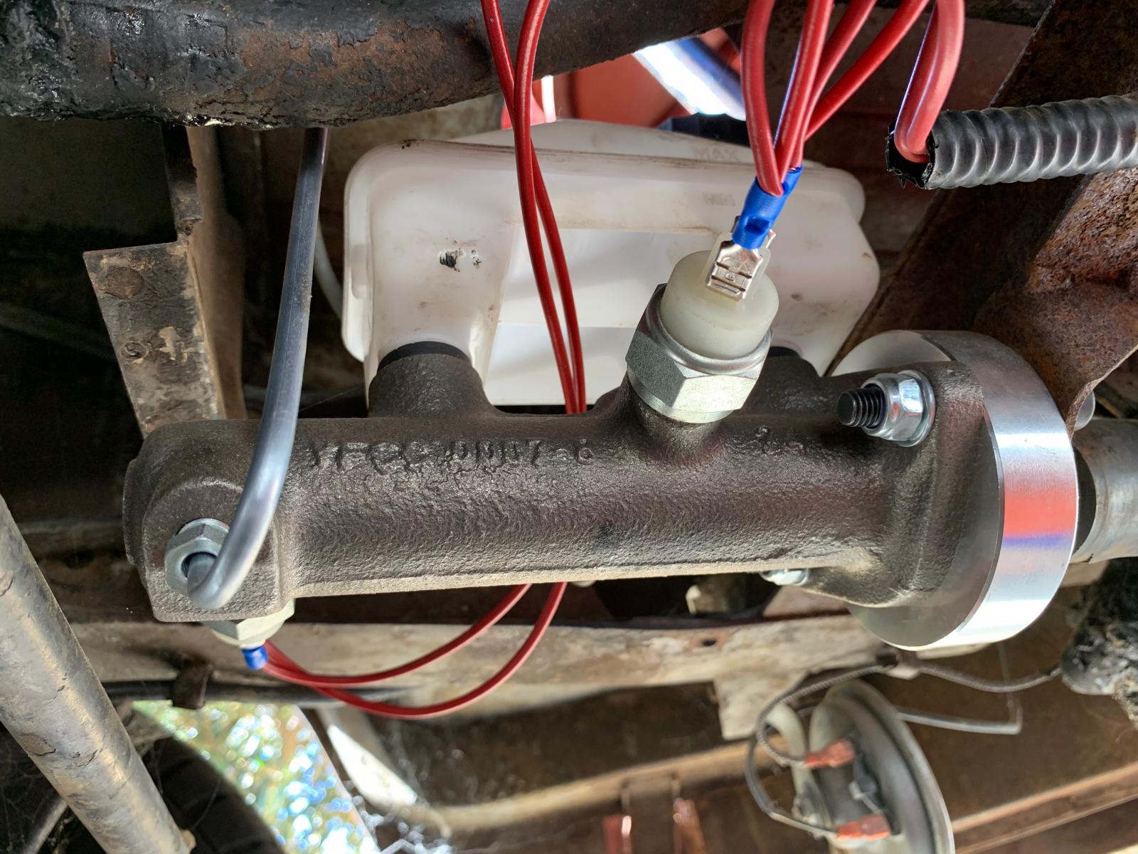

Well, finally got the brake system full of fluid, solid pedal, adjusted the rear brakes, e-brake was perfect. Looked under the car, and new puddle! Of course it's in the new stuff I put in, specifically the T fitting added for the dual circuits.
Can't get any wrenches in there, so I guess the bright side of this issue is that I can rearrange this stuff more neatly.

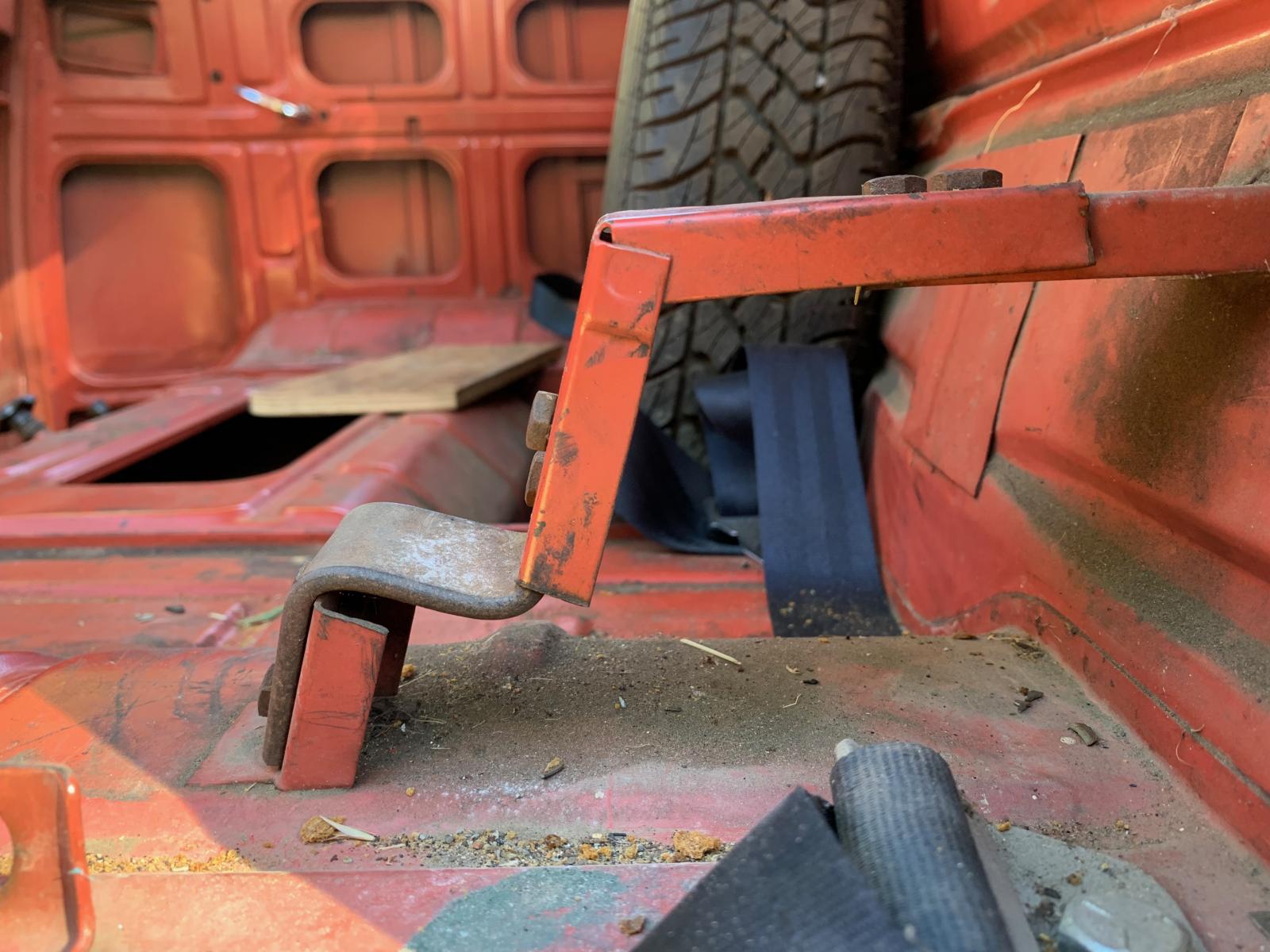

I got a PM about my modified seat stays, and realized I didn't have a good picture of them, so here you go. This allows the bottom of the seat back to be further back than it normally would be allowing a little more legroom for big guys like me.
I didn't do the mod, my truck came like this.
It just occurred to me, this is why my seat doesn't fit over my spare tire. 😂

So I decided to move the "T", which put it in a place that my old connecting pipe wouldn't reach. I had an extra rear hard line in the garage, so I made a sculpture. I blame heatstroke from working under the truck in 99° weather! 😂
I will have to bleed everything again, lost an entire MC of fluid working on this. I had an idea of sticking some front bleeders in the MC holes, but by the time I got back to the cylinder, it was empty. I also had reservations about putting those in holes they didn't belong in...
