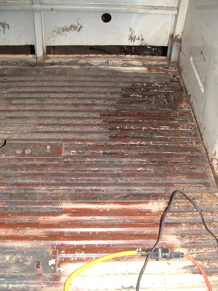

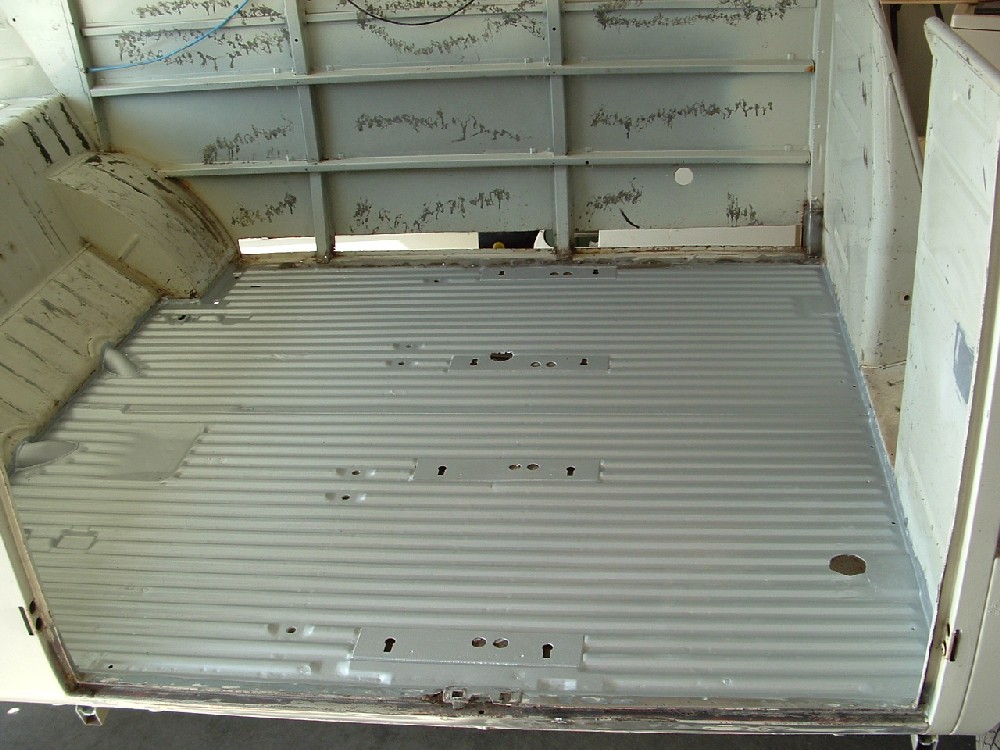

my floor was covered in tar - the aircraft stripper was slow, sloppy and very stinky at removing it - had much better luck with a heat gun and a 2"scrapper - i ended up marring the floor pretty good so i then did a quick aircraft strip of the paint and applied masterseries CT:
during:
after:
