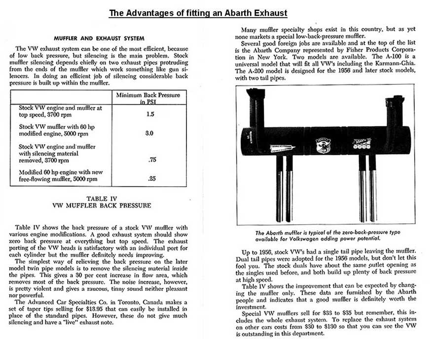

James,
This is an extract I reworked from the period tuning book "Souping The Volkswagen" by Dick Morgan at the time Stephane Lhonneux first produced his stainless steel version:
It doesn't give you that important extra HP rating but I'm guessing that under most circumstances it's not going to give you more than 2-3hp.
Is that worth the money?? You're the only one who can say, it's your money after all. Wink
John.

Thanks for that John! I need something that will work with about 60hp - don´t want to lose any power that I spent so much to gain!
