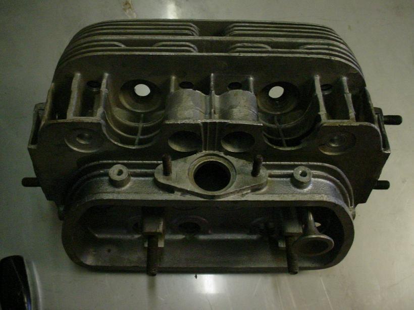

Yes, Matt is right. The head valves have the same measure when compared with the earlier 36 Hp.
Don, about the camshaft I don't have the means to measure it. It's in the engine that I'm using with the WW kit. Maybe in December I will fit a 69.5 crankshaft that I have and then I will measure the cam.
Another difference that I notice is with the intake manifold. Burly, I've used your photo to show the earlier manifold measure between those holes. With the 1963 36 Hp manifold that distance has more about 1.3 cm, and, also, considering just the two holes that exist on the small flange that connects to the exhaust, they are in a different location:
- In the earlier model they are "out of center" in relation to the tube.
- In the later model the holes are in line with the tube.
As a result, the "real" distance between those holes in the photo below is even bigger. About 2.3 cm total, hence the need to use the exhaust extensions. Those extensions have 23 mm which is the measure we need to fit everything good.

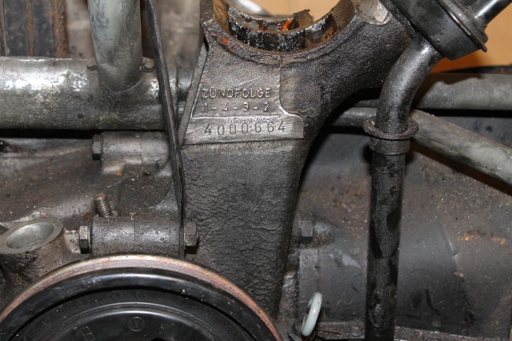

And Walter, the Etzold book engine numbers show "ending" numbers that take my engine number out of the equation. I wonder if he just goofed or missed something?
Since your info is from a genuine VW publication, I will now consider my post 61-65 replacement case as one fitted to a late 55, early 56 factory rebuilt engine.
Thanx so much!

To add to the 1960-1965 36hp information, I thought to measure the exhaust ports of my '65 engine and I could not find any difference in exhaust port diameter.. Confused
'65 36hp engine as pictured above, never disassembled afaik: about 29.75mm bore (29.5-30.0)
My '58 very complete and original engine (never taken apart either): 29.8mm (also between 29.5 and 30mm on several parts of the port)
Both engines:

Thanx Walter, I think you have provided some very substantial info for 36hp Challenge reference. Your effort is appreciated!
Burly
