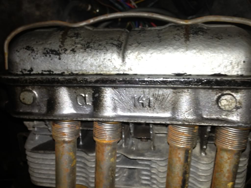

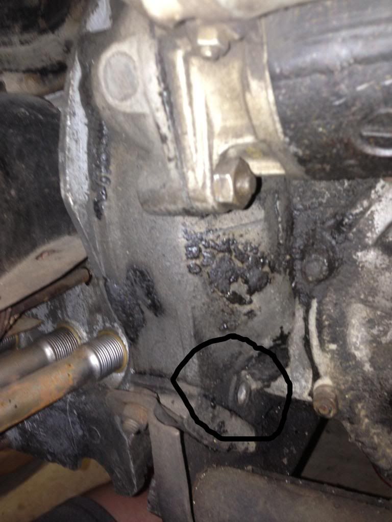

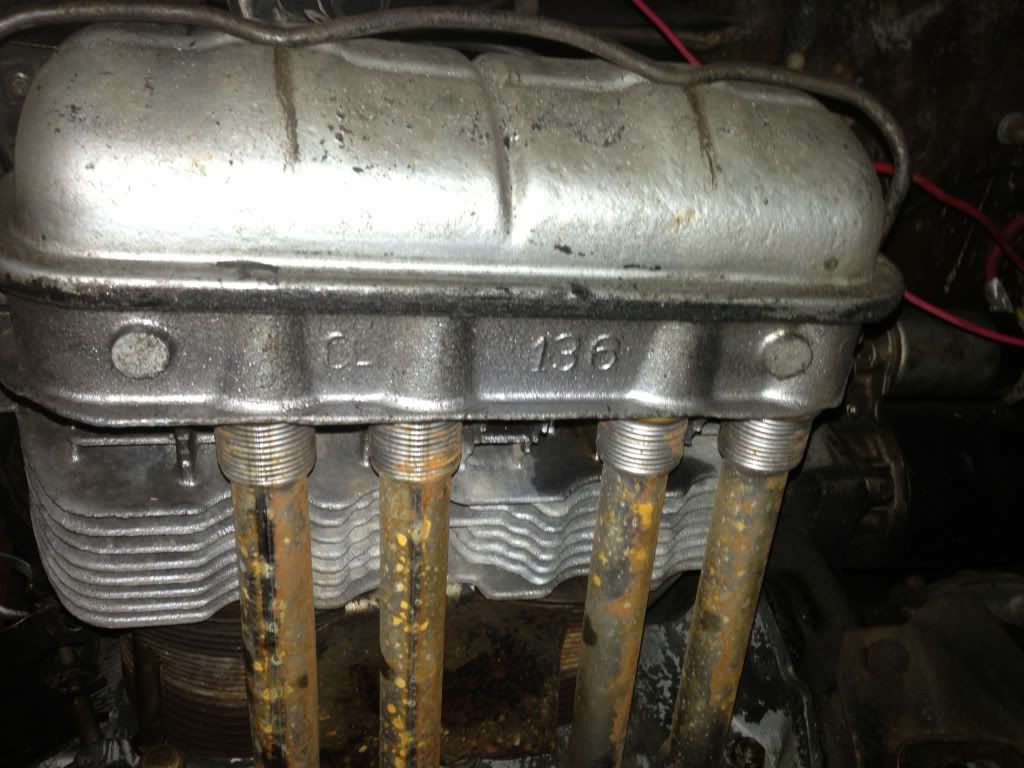

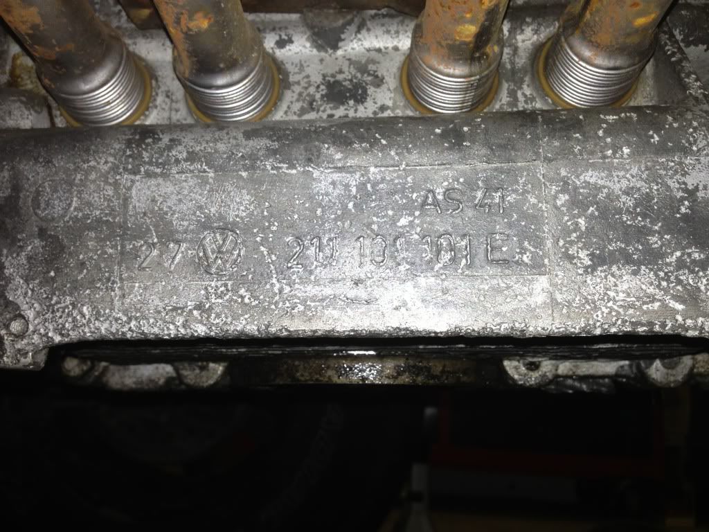

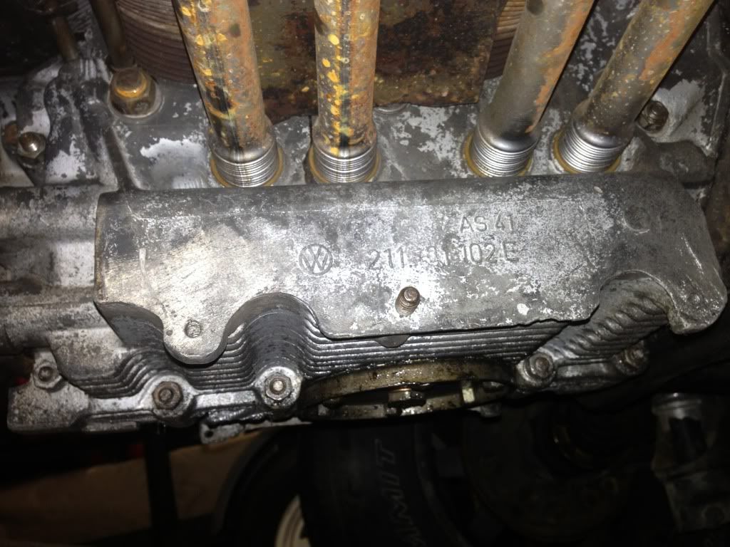

SO...no luck yet. I'm prepping to pull it. removed the exhaust, wiring, throttle cable, crappy plastic fuel line and then got puzzled by this...Is that where one of the 4 bolts that holds the motor in place is supposed to go?
Maybe some good news, I never could find anything on the motor that said it was a GEX motor, just a blue sticker that said inspected and tested or something of the sort. PLUS my cases are sequential! So provided they are NOT customized for me (cracked or broken) that may be a good sign.
Anyway, a few more pics...
AS 41 27 VW 211 101 101E
AS 41 (no 27) VW 211 101 102E and there was no nut on the stud sticking out....
One head is cast CL 136 and the other is CL 141. Is that left and right or is something really off here?
I also tightened up the rear driverside hub as it a little loose, the CV drive axle shaft on the wheel side and the transmission side. Every allen bolt was loose. Shocked
I then scaped off a pound of grim from one small side of the transmission. It looked like a lot of leakage and sludge build up. Guess I might end up cracking the tranny as well Rolling Eyes unless they just leak alot by nature. Guess it will give me a chance to paint it! Very Happy

PostPosted: Wed May 22, 2013 8:26 pm    Post subject: Reply with quote
yes that is were 1 of the 4 bolts should be ( actually that should be a stud with a nut on it )
AS41 is a great case Dual relief ( hopefully its good )
Heads will go on either side NOT R-L specific

jspbtown is offline
PostPosted: Wed May 22, 2013 8:30 pm    Post subject: Reply with quote
I wouldn't be "cracking" the tranny unless you know what you are doing. Most times these leak at the input shaft seal...a repair that does not require "cracking" anything.
And yes...you are missing a mounting stud there. Either broken or never installed.
SBD
Joined: October 24, 2012
Posts: 3283
Location: SOUTH DAKOTA
SBD is offline
Can't answer all of your questions, but yes, there should be a stud with a nut to hold the engine in the first picture.
As far as identifying a GEX engine, I know of at least one that has a GEX sticker on the rear of the top right side of the engine flange where it bolts up to the bellhousing of the transaxle. It would probably be hard to see with the engine installed in your buggy. You would need to either pull the engine or remove the fan shroud to see it. I don't know if they did that with all of their engines or not.
There's usually no difference between left and right side heads. I think the numbers you're seeing are probably just ID numbers of some type from the foundry, and not a big deal. I believe you have to pull the valve covers to see the part #s on the heads. But since it might be from GEX there's no telling what surprises you might find. Shocked
