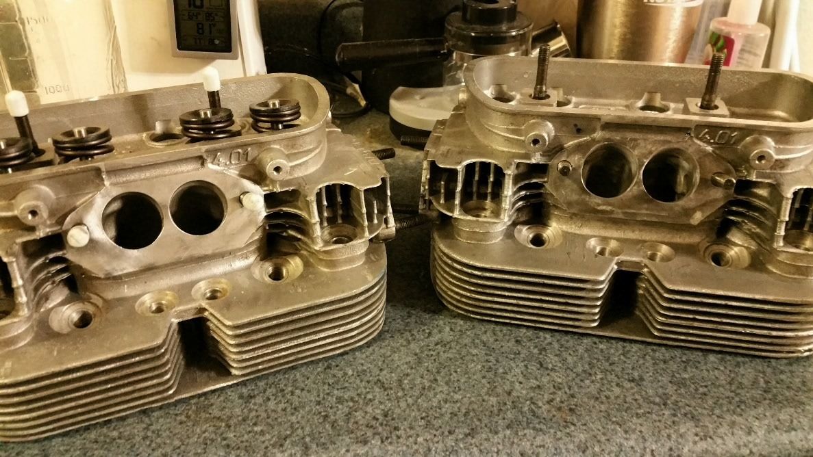

so the NGK BP6ET should work with the 044 heads?

044 have 12 mm plugs, so a D#### plug, B#### are 14 mm plugs.

So...are you saying the 044 heads have 12mm diameter spark plug threads? I doubt it.
Also you are mixing up what you are stating because you are writing the plug code in the incorrect order. If a Bosch plug part # has a "D" as the FIRST number in the code...... that would me an that it has 18mm X 1.5 diameter threads. Like... D####....that is a 18mm x 1.5 thread plug
A plug with a B as the first letter in the code.....like B#### (Bosch part # again).....does not exist. There is no "B" first digit code.

All f the plugs we are speaking of have 14mm diameter threads. The difference we are speaking of here is the LENGTH of those 14mm threads.
The W7DTC and BP6ET...all have 19mm thread length and 14mm x 1.5 thread diameter
The W7BTC and BP6HT...all have 12.7mm thread length and 14mm x 1.5 thread diameter
These 044s I just hand ported say they do. They are 12mm- 3/4". Dr7s went in them.
Wow!...learn something every day!
