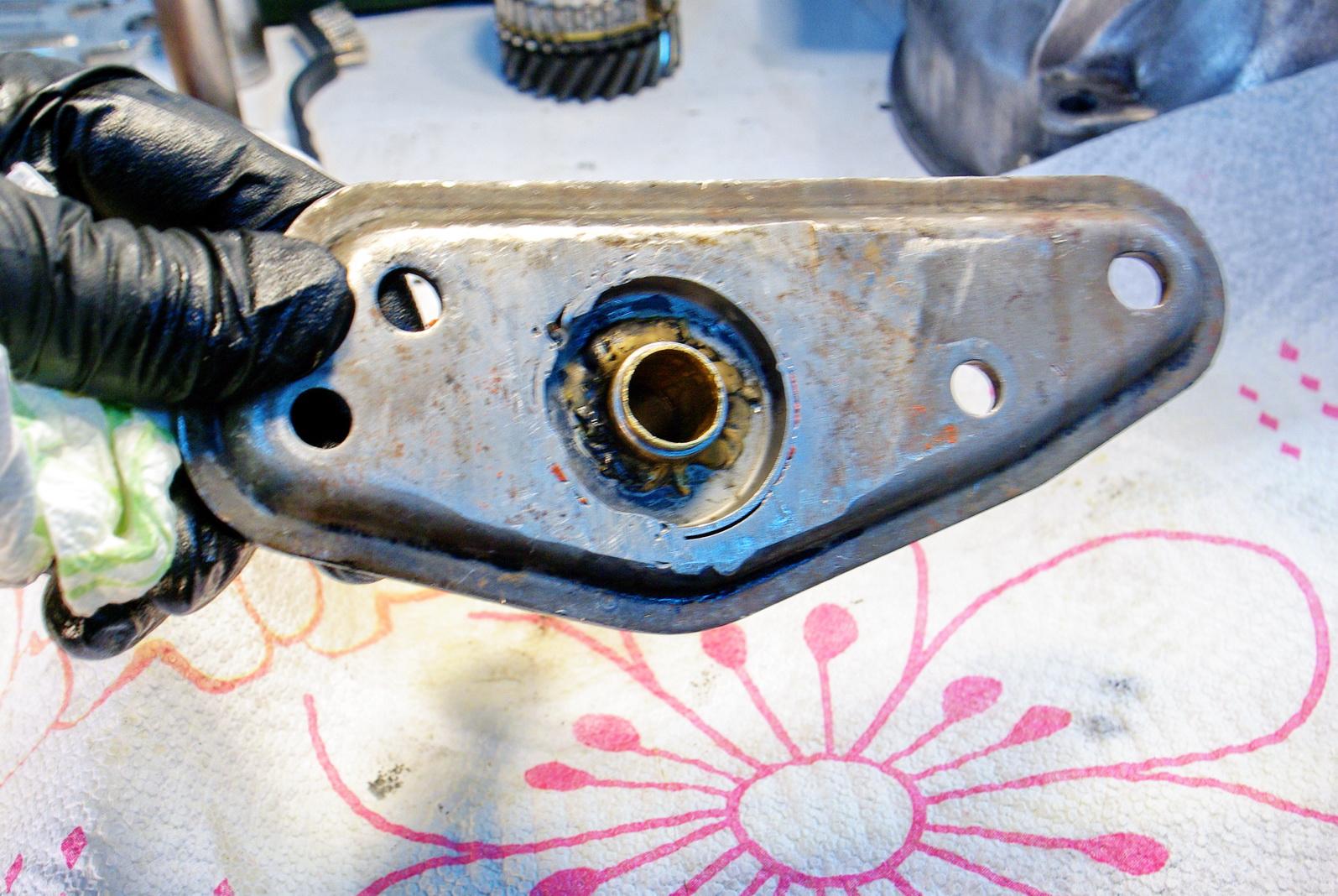

Starting from the tailcone end:

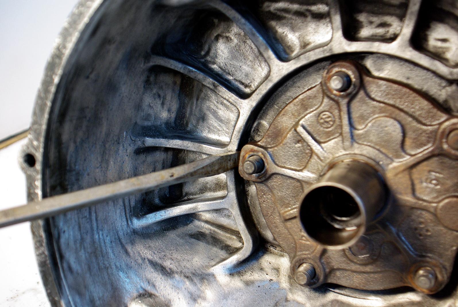

1. Cracked tailcone repair
2. Replacement tailcone rubber bushing/buffer (made/cast)
3. Replace shift lever shaft seal and guide bushing on tailcone. This is three parts. This assembly uses an outer bronze shift lever seal housing (hockey stick) bushing part # 001 301 209. This is available from Weddle industries https://www.weddleindustries.com/product/1000697
This uses a seal of part # 001 301 227...also available from Weddle, CIP.1 and many others.
This part changes: From chassis # 412 2041 028 a part # of 004 301 223 is used. I dont yet know what the difference is.
The inner bronze bush for the shaft is part # 001 301 207..also available from Weddle and is also listed as a pilot bushing for Jetta and golf mk 1 and 2

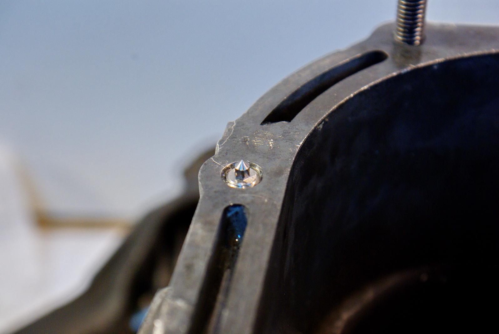

6. Adding anti-rotation pin for the countershaft along with a notch for it to lock into in the gear case boss.

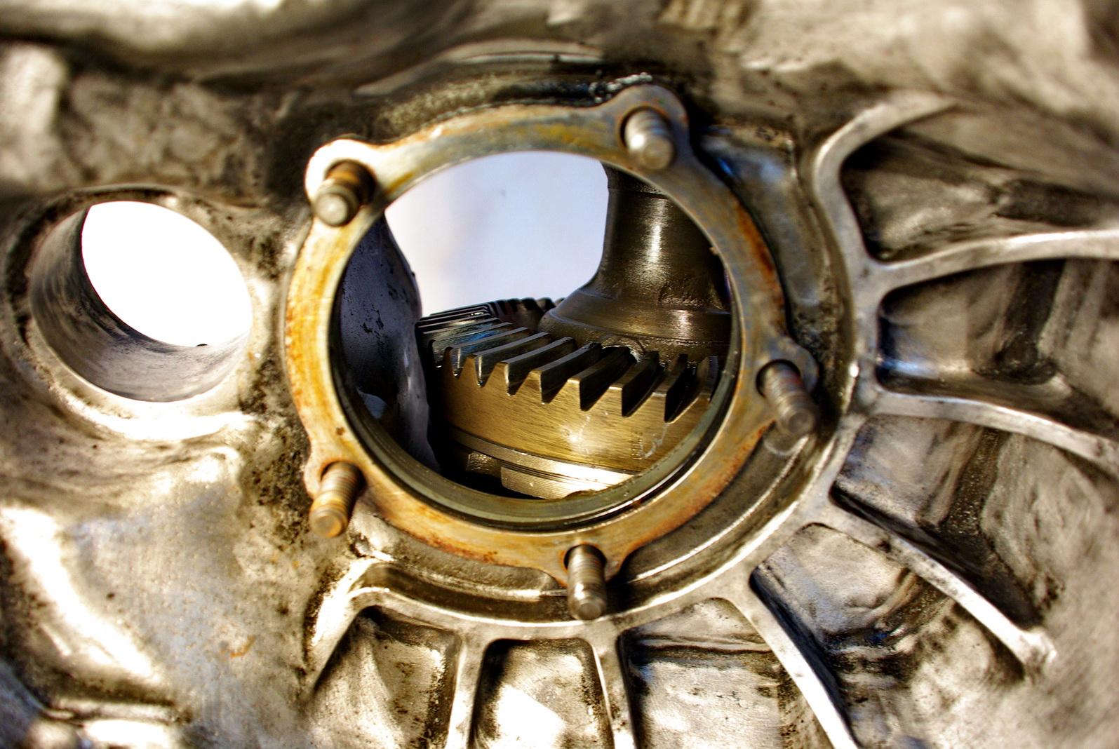

8. Repairing a worn mainshaft ball-bearing bore in the case (not necessary on this transmission but about 75% of them will need this so I will outline it)

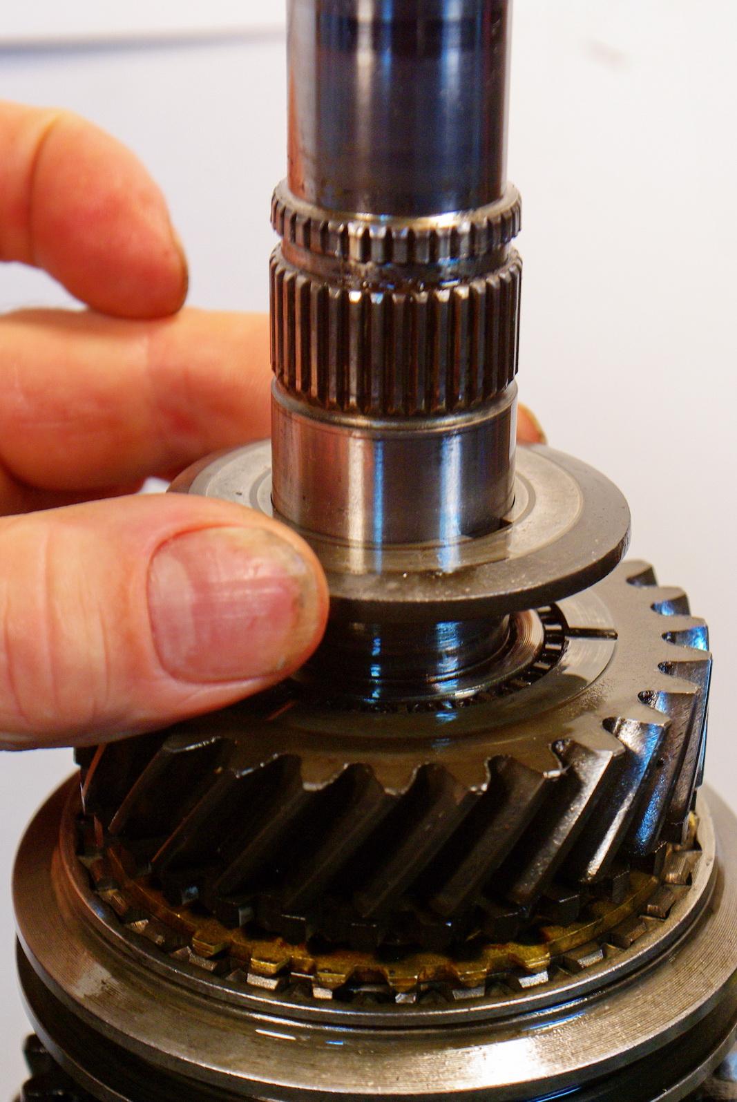

14. Measure mainshaft axial play and calculate shim (if needed). We will never be replacing this part.
Unless "new" gears are being swapped in...you will never need to change this part. We are measuring to make sure of the condition of the gear stack...and ascertain what shim/spacer is supposed to be here and that it has not been worn. If its worn and does not match the thickness stamped on it...we can replace it (have one made really)
From the factory, the mainshaft gear stack height and tolerance is set.... relative to the dimensions of the case housing section it is in....and to allow proper clearance and pressure to operate the synchronizers.
Once that is done at the factory....the countershaft is set to run with gears center-lined on the mainshaft gears (within a tolerance range)...and held in place ...again relative to the case dimensions...with a thrust washer on each end whose dimension is custom set for the case. There are a range of thrust washer increments that were available for setting this. Once the gear set is worn in...you cant change it...you must maintain it. If a thrust washer is worn....we renew it to original thickness.
WHAT THIS MEANS:...in short...if you ever damage the gear or differential case and have to replace either from another transmission.....even if no internal parts were changed...you will for sure have to get new thrust washers for the countershaft ...and they may need to be made custom as the factory increments may be between what the countershaft needs to have to stay where it is supposed to be......and very possibly (about 50% chance) you may need to adjust the main shaft spacer shim between 1/2 and 3/4 gear sets.

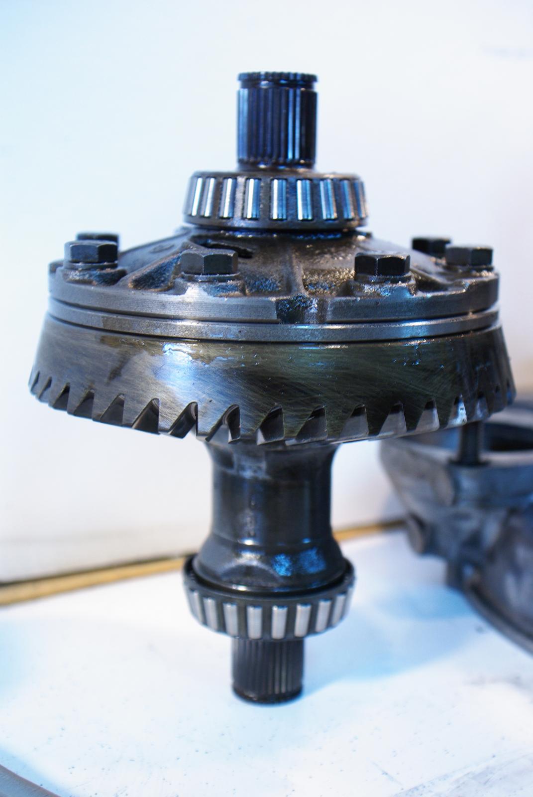

15. Replace the differential side bearings
16. Check and adjust ring gear to pinion gear backlash
17. Set differential side bearing pre-load and mark adjusting rings.
18. The o-rings on the differential side bearing adjusters.
19. Replace the differential output shaft side seals
20. Verify the side play of spacer ring between CV hubs and differential housing.....while simultaneously verifying that the tolerances inside of the differential for the side thrust washers are correct as well as the output shaft centering spacer.
WHAT THIS MEANS: If you find any play in the outer CV hub relative to differential...that is NOT from axial play from worn splines (about 50% of all 004 transmissions have some).....we will First open the differential and using simple inspection as well as by the book methods....make sure that the play found at the CV hubs is not caused by a worn center spacer in the differential between the side output shafts (very common) or even more common...worn thrust washers between the side output shaft gears and the differential housing.
It is MOST common in early miles too have worn outer ring spacers right behind the CV hub if the seals have been leaking and the area is not kept clean...or if the CV hubs have been run with loose or missing snap rings. That is an easy fix. New ones of several sizes are not hard to find. It is the same part as an 091 transmission.
The problem is that if it runs for too many miles....the in and out movement allowed to the CV hub puts in and out load on the differential side gearing. The thrust washers usually wear before the tube spacer between the gears because the spacer is hardened.
But once the thrust shims get a certain amount of wear...increasing the lateral movement....the tube spacer begins to wear. During this increasing in and out movement ....the mesh depth of the spider gears becomes alternately too deep and too shallow causing extreme wear because the spider gears have very long and high gear ratio teeth (makes for quick cornering under power like no other ACVW transmission has). The end result will eventually destroy ANY 004 transmission. When a tooth chips it dumps the debris directly onto the ring and pinion mesh area.
21. Measure and verify pinion gear to crown wheel mating distance from differential centerline. Remove pinion/mainshaft and verify locating shim thickness.
22. Replace pinion shaft bearings and adjust preload
23. Adjust pinion gear to ring gear back lash
24. Mark adjustments and remove ring and pinion and mainshaft
25. Check rolling resistance to spec of each assembly and re-install.

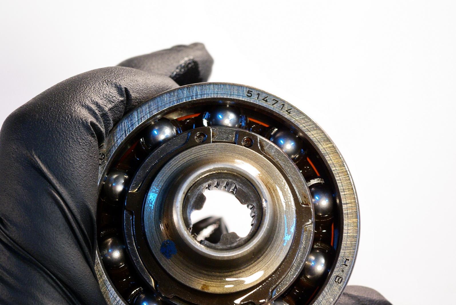

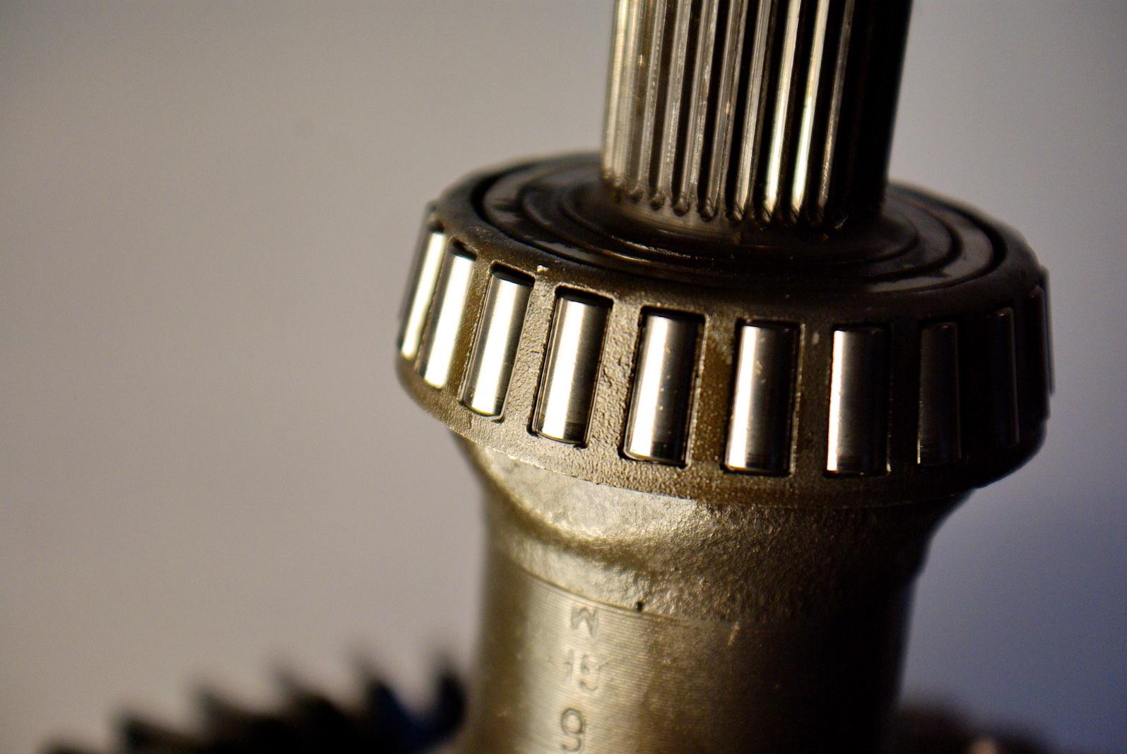

2. Needle bearings MUST be run on the same area of shaft and in the same direction. You cannot flip or move needle bearings or roller bearings.
Observe:
To the naked eye and to touch/feel....the countershaft and needle bearing set in this transmission ...most would clean...oil and re-use. This is exactly how these two parts look to my eyes under good light.
When carefully light to show the imperfections....this is what is REALLY there. These marks cannot be "felt" by fingernail. You can feel them if you drag a sharb pick or scribe across them...more as a "rumble"...than as grooves. That is because these grooves are only maybe 1-2 microns deep (if that much). But...they are damage to the hardened surfaces.
Flipping the bearing end for end, running a different used bearing in its place on the shaft, running a new shaft with this used bearing and even running a new bearing on this shaft....will result in RAPID wear.
Rapid at this scale of time is between 10,000 and 30,000 miles. In that time the needle bearings will literally cut a groove in the shaft.
You can see the same wear on the needle bearing at the other end with careful lighting.

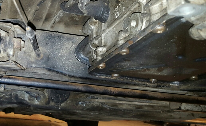

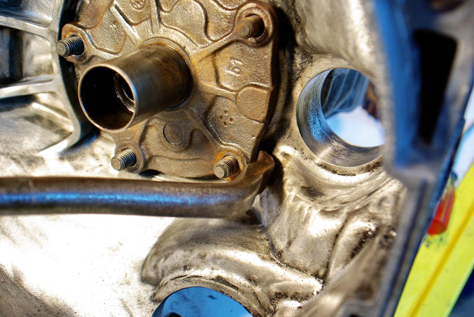

I say this because there are a pair of slanted sloped mounting holes in the rear croasmember.....that would very nearly meet up with the tailcone mounting yoke of the 914 -901 trans. Thesd holes are unused on type 4 cars for anything that i have ever seen.
Is it possibly the hole to the left in this image you mean? If so I have found out how it was used; for the wire to second heater control box at the heat exchangers which was fitted on on each side on cars with the M202 (improved heating ) package.
/Lars S
/Lars S
Ah!....that explains what those are for! I have never seen a car fitted with the extra heater control boxes and cables! Thank you!
Learn something every day! Ray

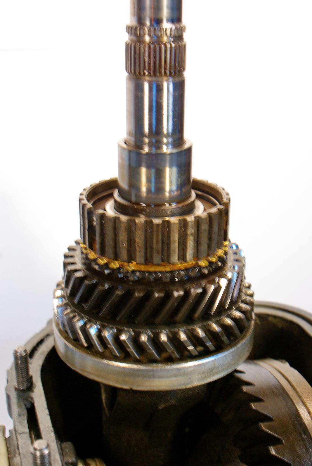

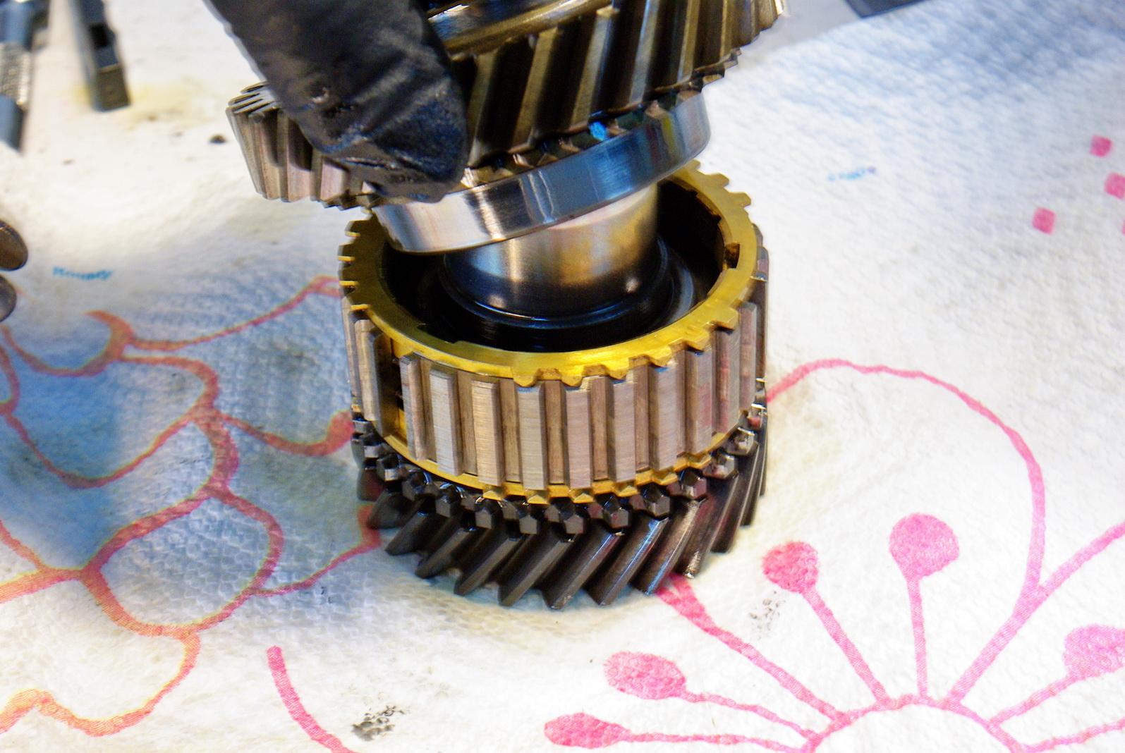

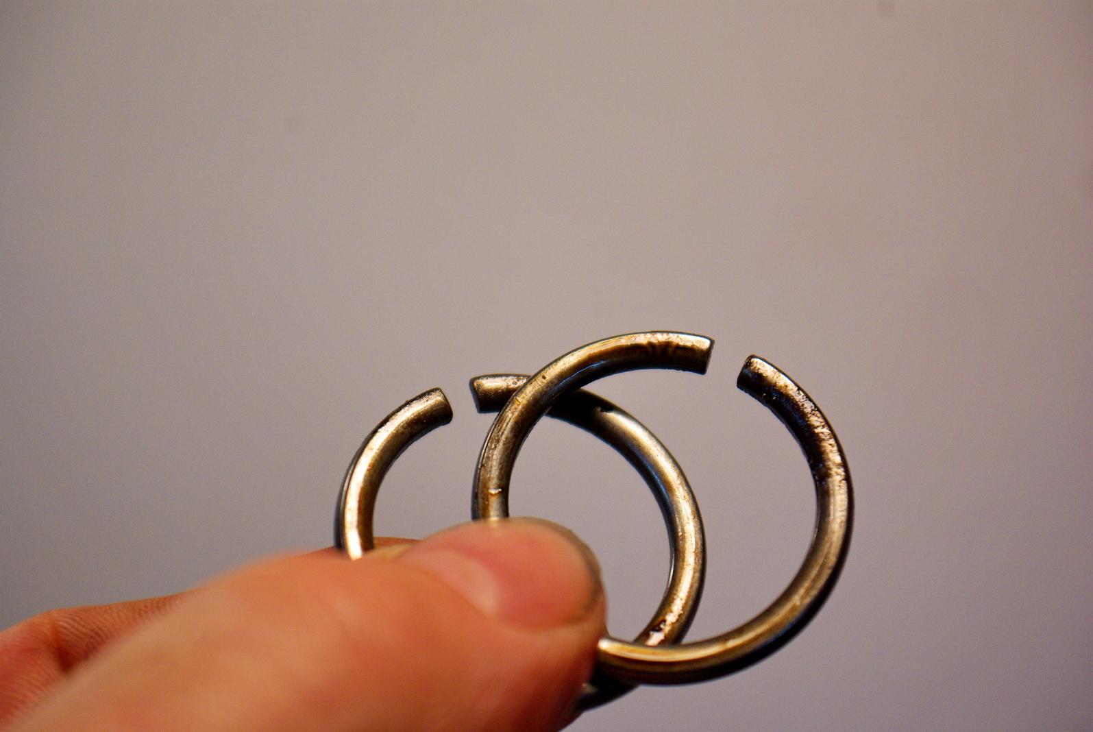

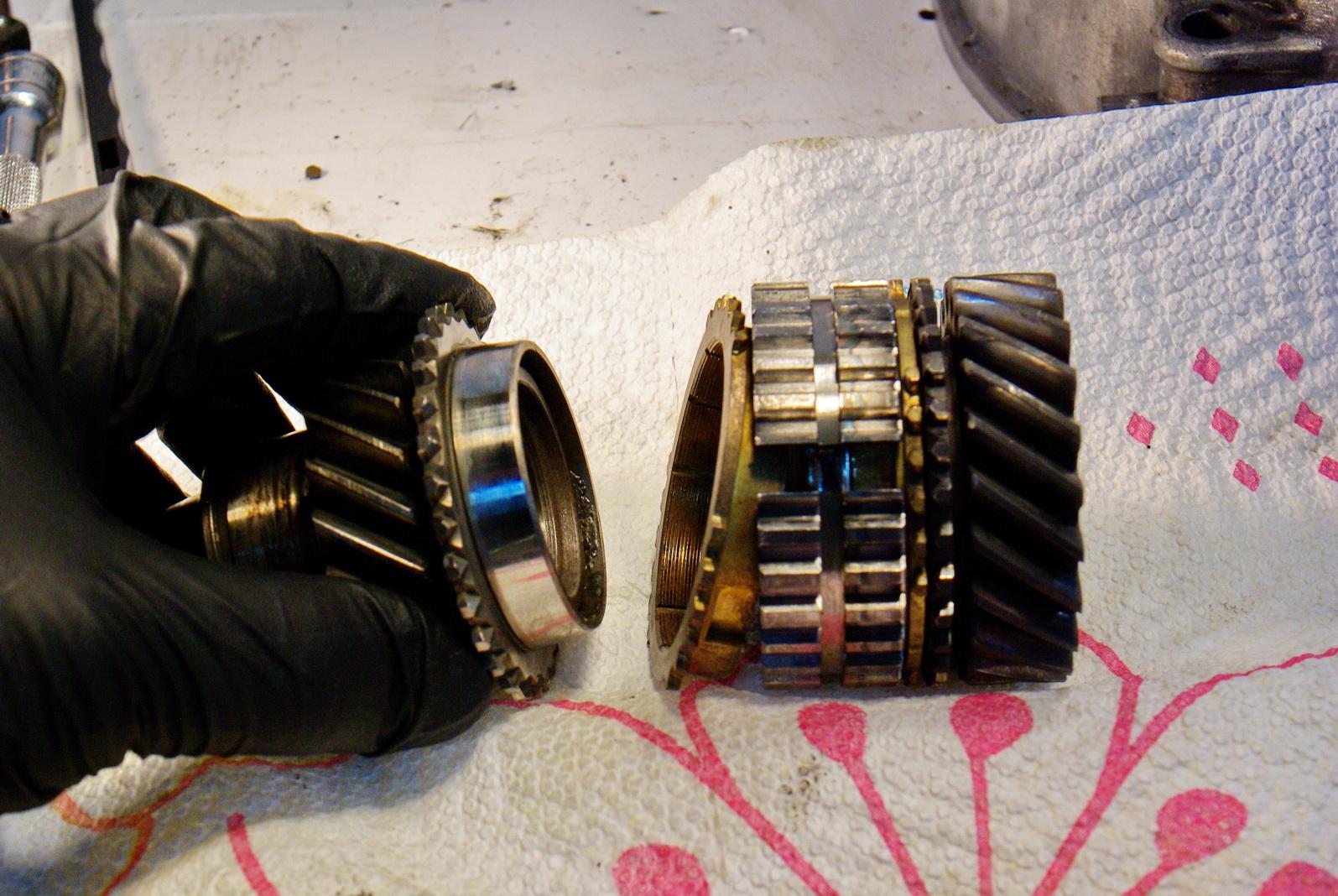

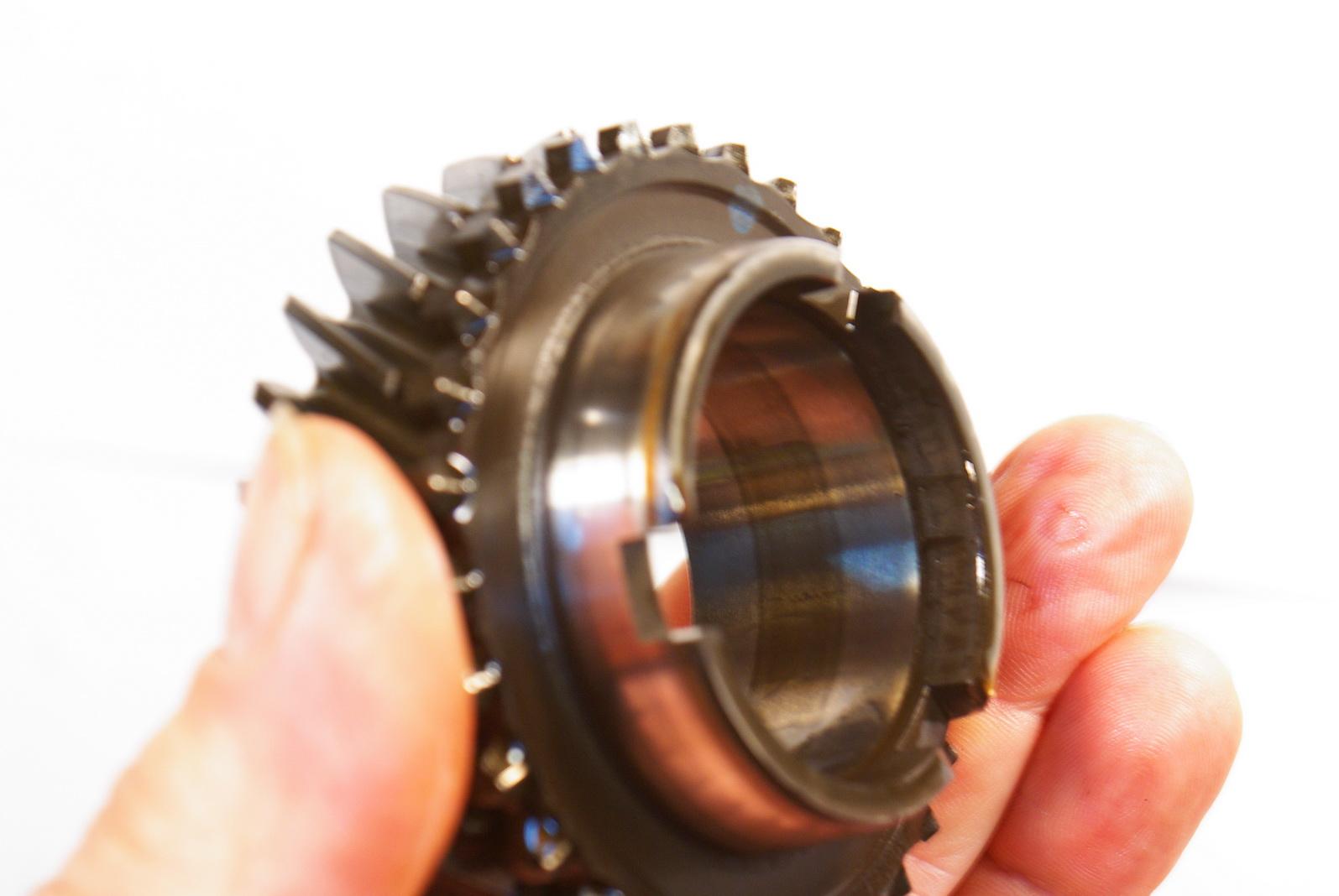

Since I cant update the time stamp of the original title any longer. ...I hope those that are interested are watching the date and time.

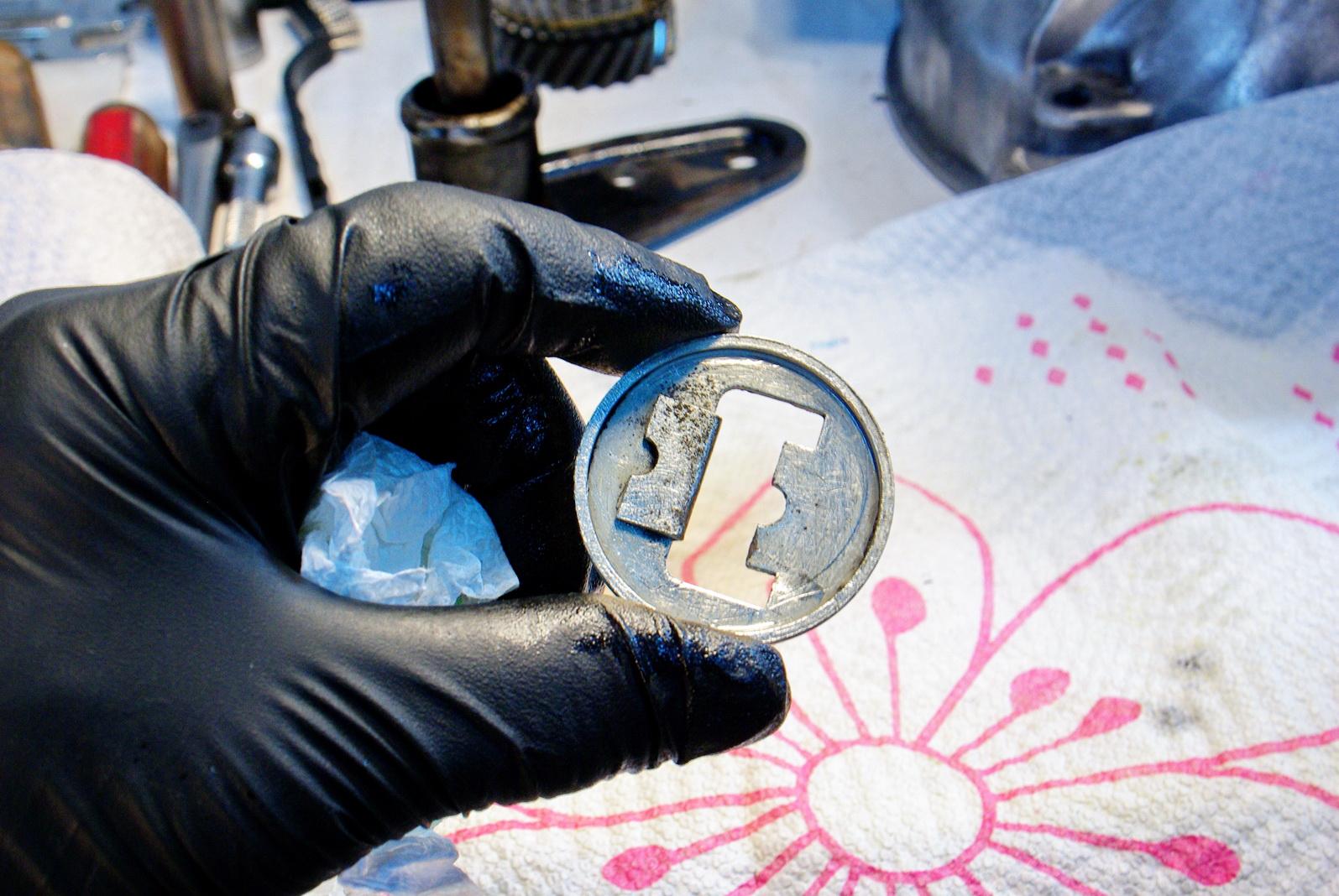

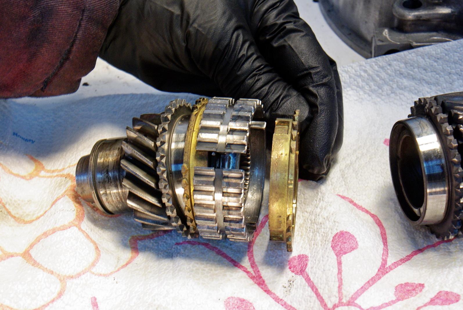

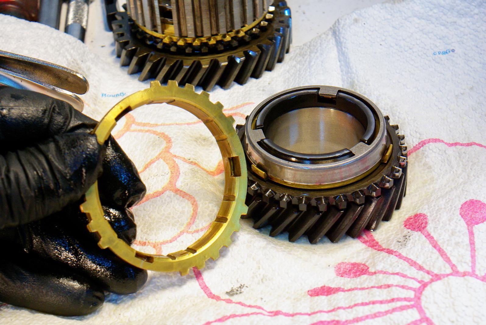

It will be a large update in the am. I am writing this because I just got out of the garage.

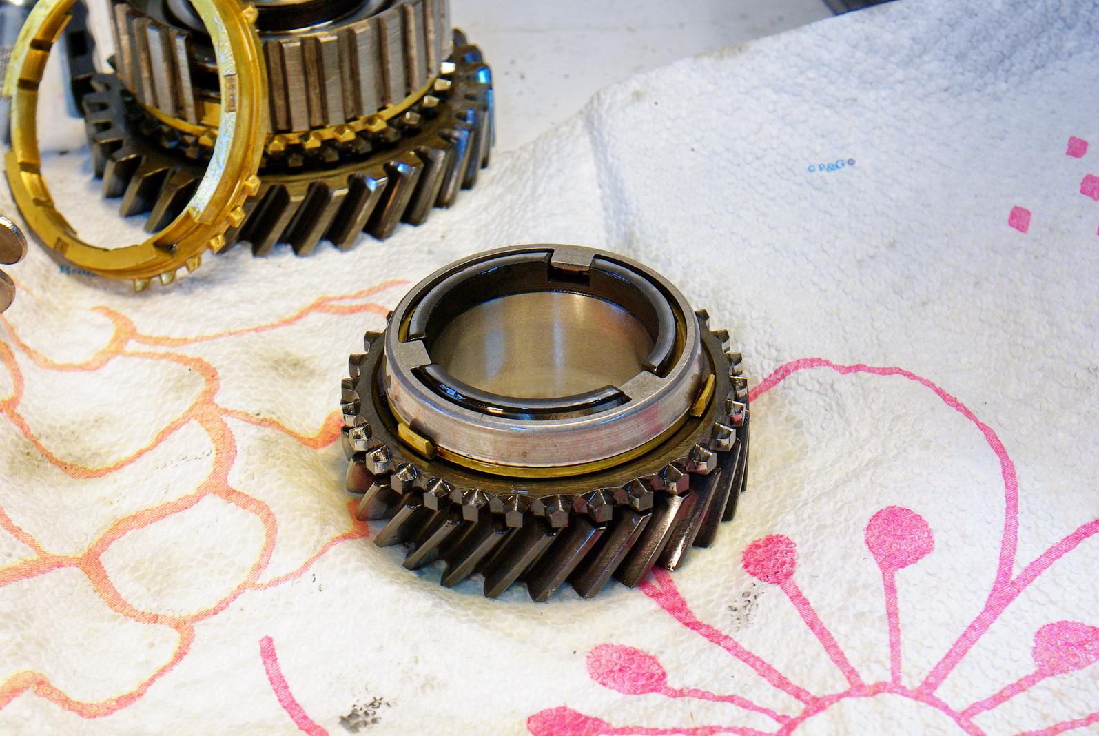

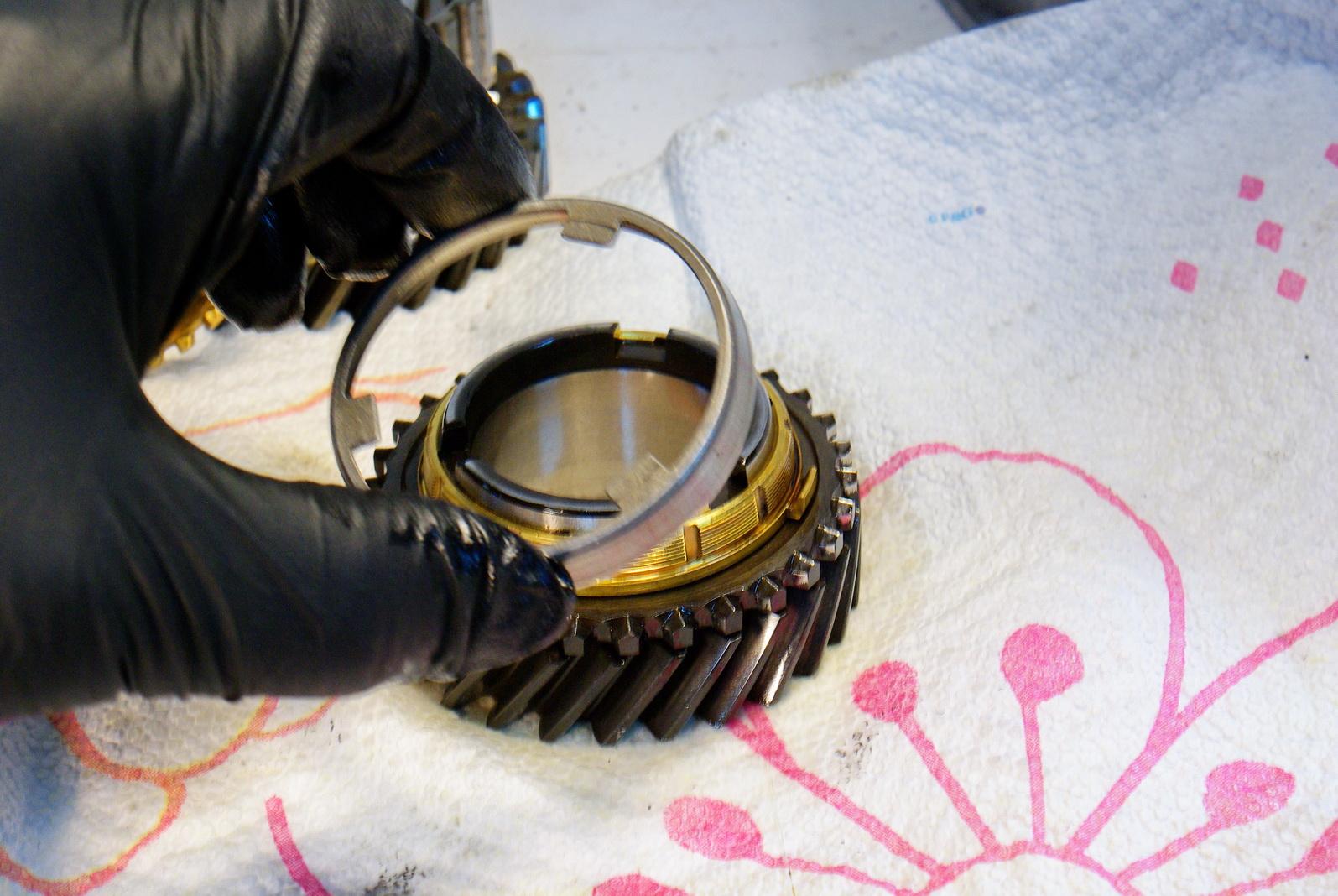

This transmission has been normal.....as you will see in a LARGE update in the am......until I removed the third speed bushing. I noticed right away that two small locking plates were missing on the main shaft spacer. Upon removing the spacer....holy crap!.......I have never worked on one like this!

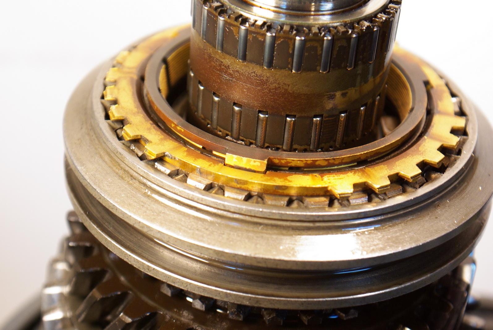

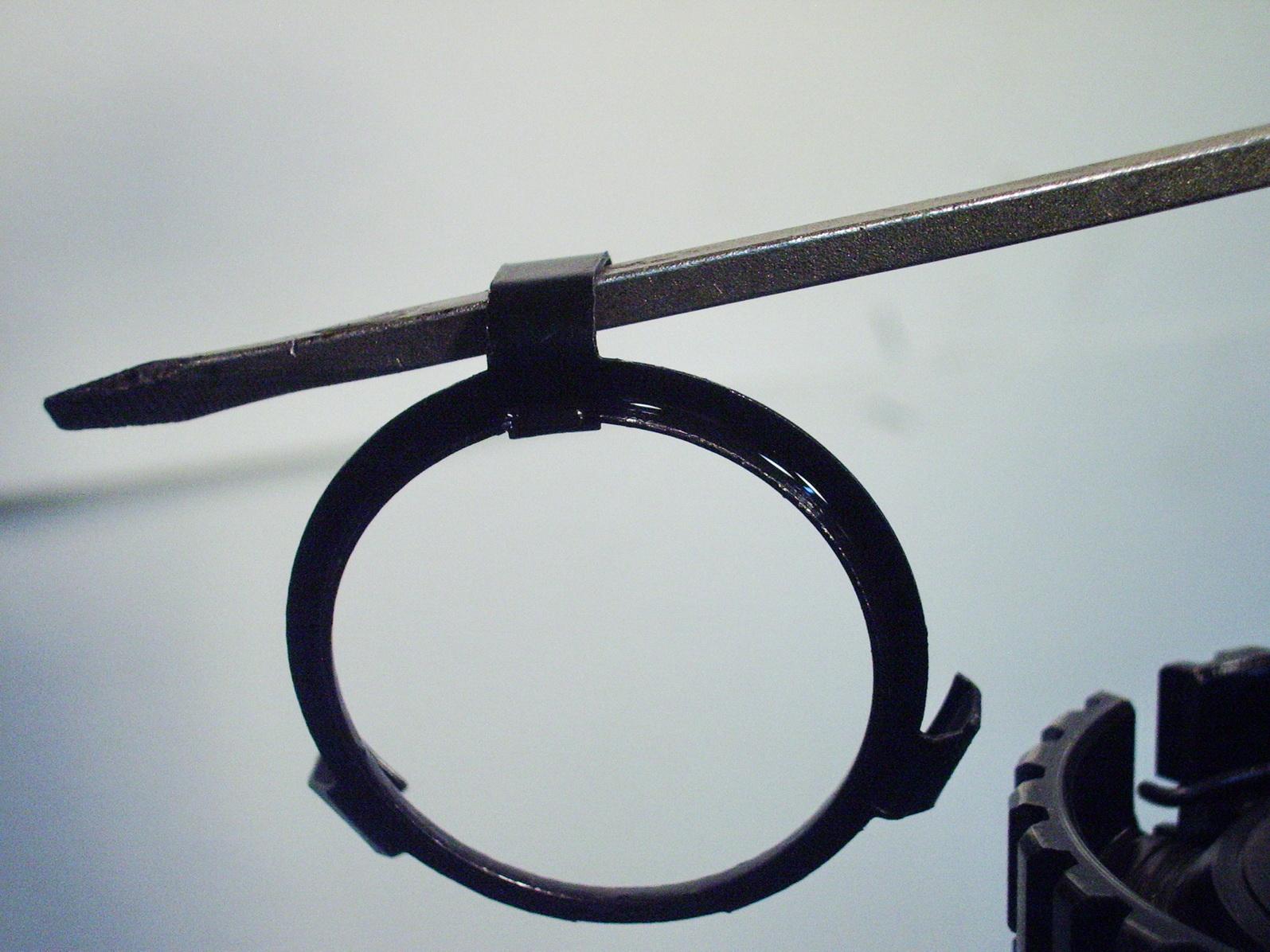

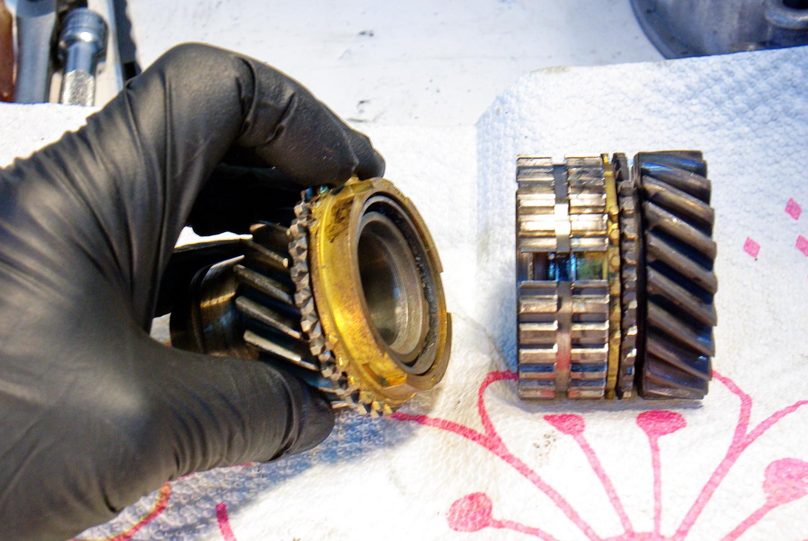

It has a three piece third gear synchronizer.... with a steel face!......that looks really similar to what came in the 901 in the Porsche 914. There was information in the books that for a short period of time.....a three piece synchro was used in early models. I thought those were very early.....like European only and 19mm slave cylinder.
Since its clear that this trans has been at minimum 50% diassemled before. ...due to the sealant on the gaskets......its possible that either this was ine of the interem gearboxes between early with 19mm slave. ..and late standardized. ......or was heavily rebuilt using early or middle years parts.
Either way....very interesting....pictures on the way! Ray

PostPosted: Mon Dec 14, 2015 1:51 pm    Post subject: Re: 411/412 004 four speed trans rebuild (new 12-7 @ 12:51 Reply with quote
3-piece synchronizers were introduced in August 72 (73 modell, early 73s have still one piece synchros). But on second gear - are you sure you found them on third ? So 3-piece synchros should be found in 73 and 74 type 4s.
by the way: Volkswagen reintroduced the 3-piece synchros in 88 for the Passat and said it was a big innovation... And around 2012 I saw a DCT transmission on a fair: Those Volkswagen guys told me, that they now have 3-piece synchros... No one would believe me that they already had this 40 years earler.
Joerg

PostPosted: Mon Dec 14, 2015 3:36 pm    Post subject: Re: 411/412 004 four speed trans rebuild (new 12-7 @ 12:51 Reply with quote
Joerg
Hello Joerg! Than you for the insight! The books are sketchy on these transmissions.
Yes...you are correct...it was second gear.
Also...this is an FC series. I have been inside of FC, FA and FE series...and have been in several of each....and NEVER seen the three piece synchro. i had only read about them.
Having been inside of a few of each series and never seen the three piece synchro...it makes me wonder about production variability.
Wouldn't FC starting in August of 1970 be tooo early? But then again...it ran long enough that they could have started the three piece synchro mid-series.
Also..since this transmission has been fully opened at some point and is in very good condition...perhaps someone swapped cases (which is a bit of an undertaking as I have done this before)....which "may" entail new main stack and for sure new countershaft shims.
Either way...its a very interesting synchro design. What surprised me was when I got to the mainshaft spacer between 2nd and third gears....and there were no locking plates! When I removed the 3rd speed bush and spacer and then 2nd gear.....I had to say out loud ...."what is that!!!?"
Laughing
Also since you appear to be a professional transmission man....please feel to comment on any of my methods. For instance...and I may as well start this update here in another post iin a few minutes. Please comment on my methods!
Ray

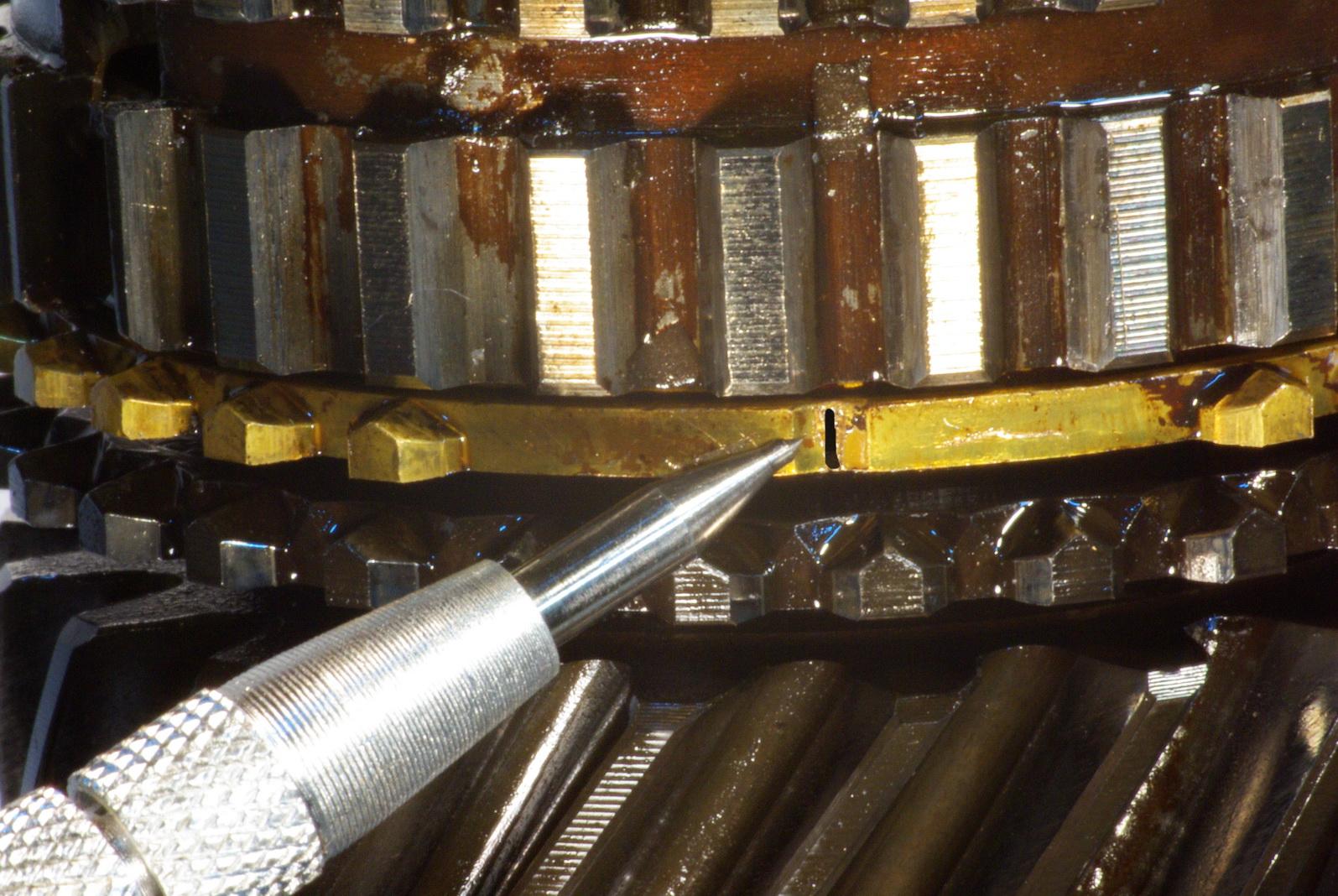

A little bit of information up front on how I am proceeding. Please comment on this! Thank you!

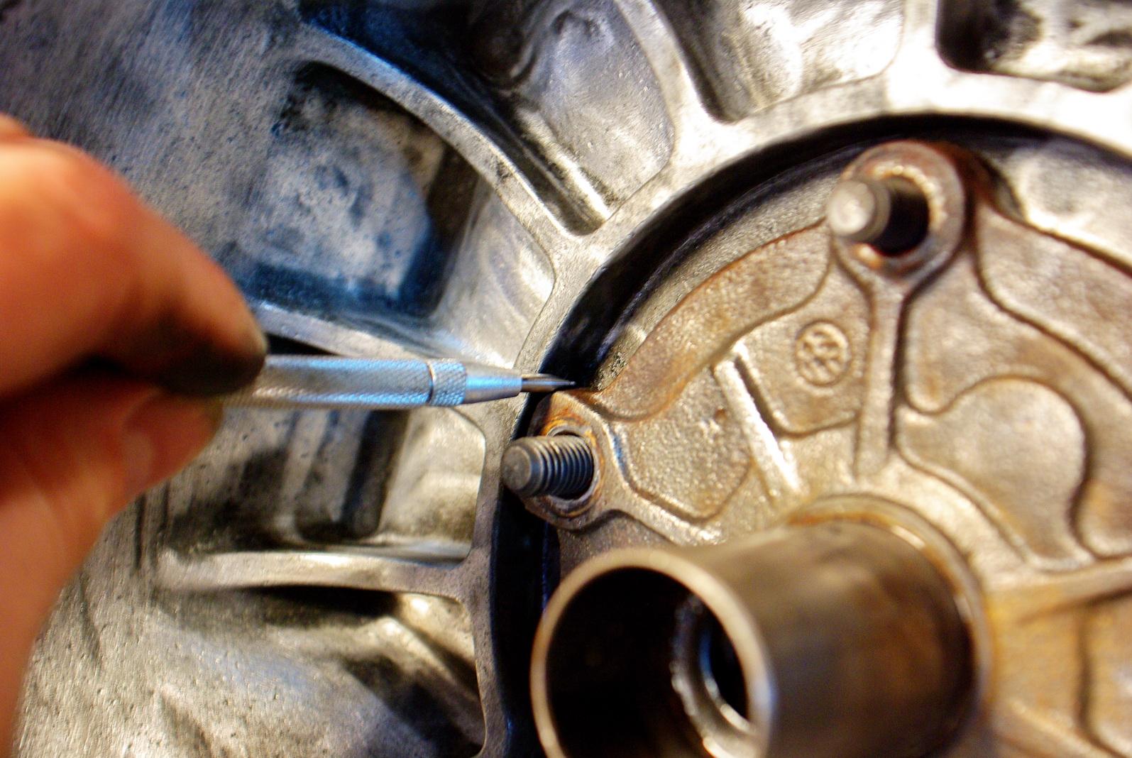

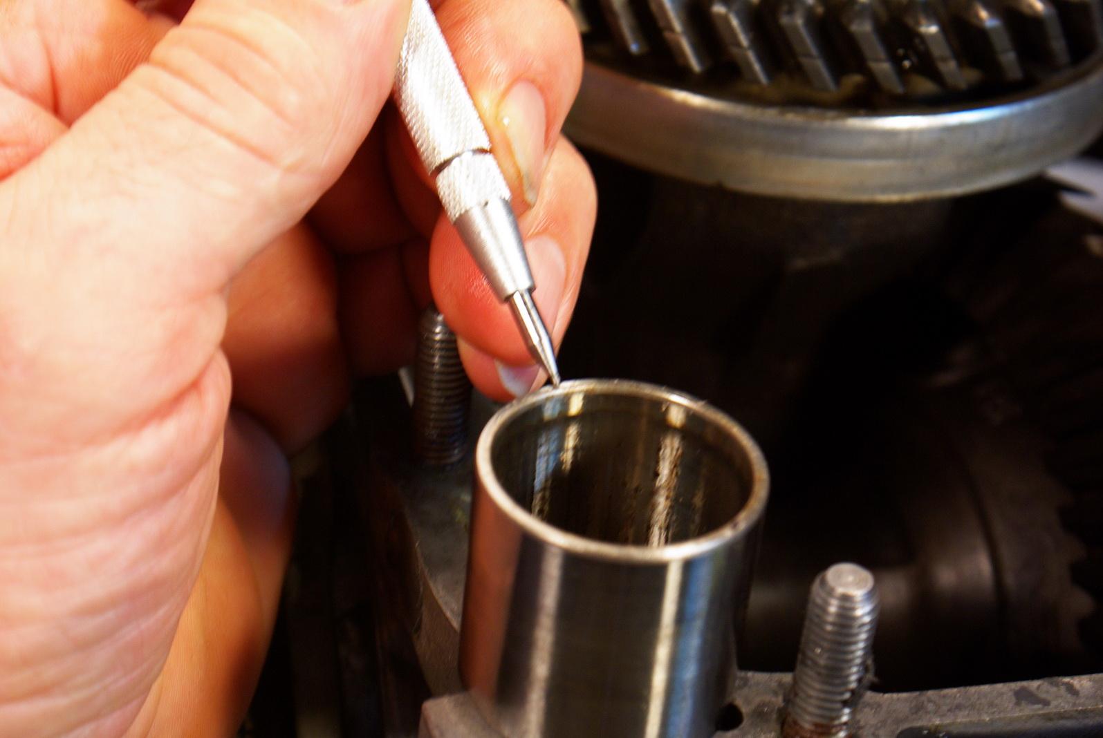

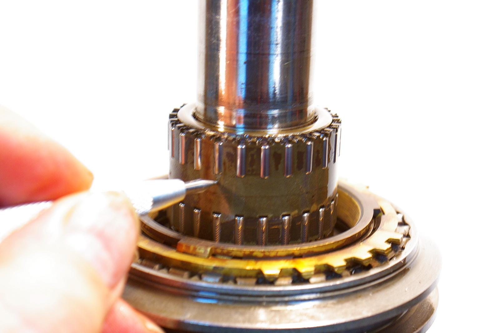

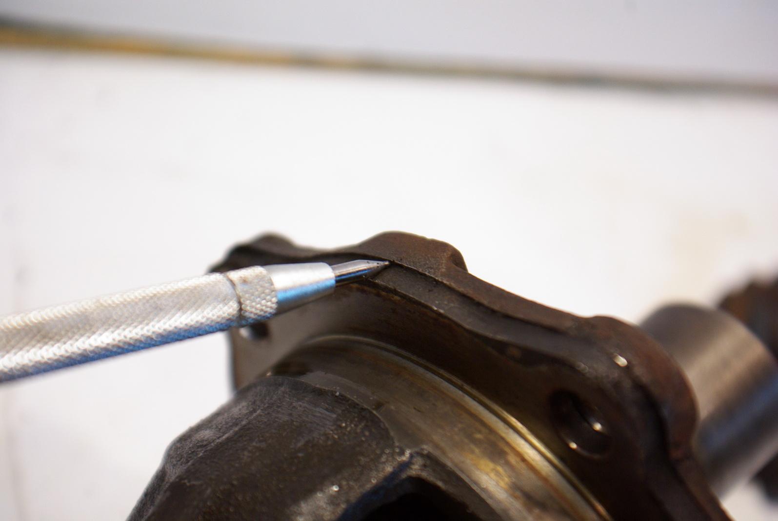

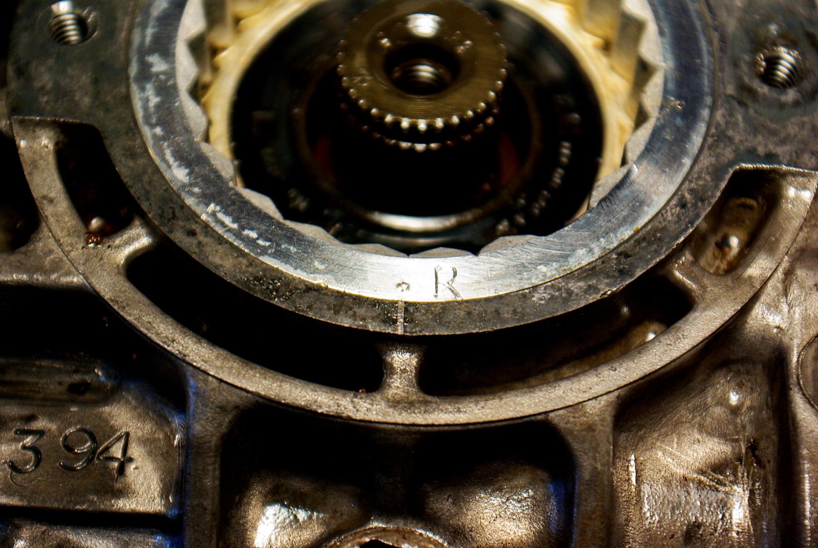

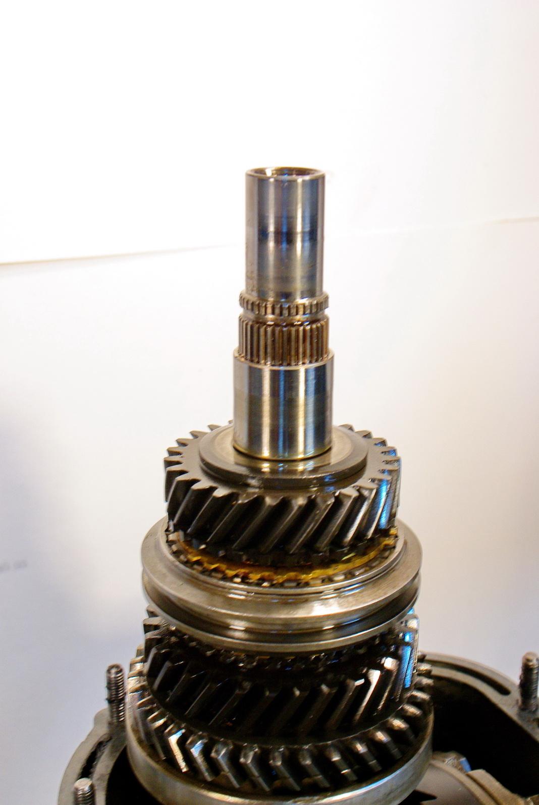

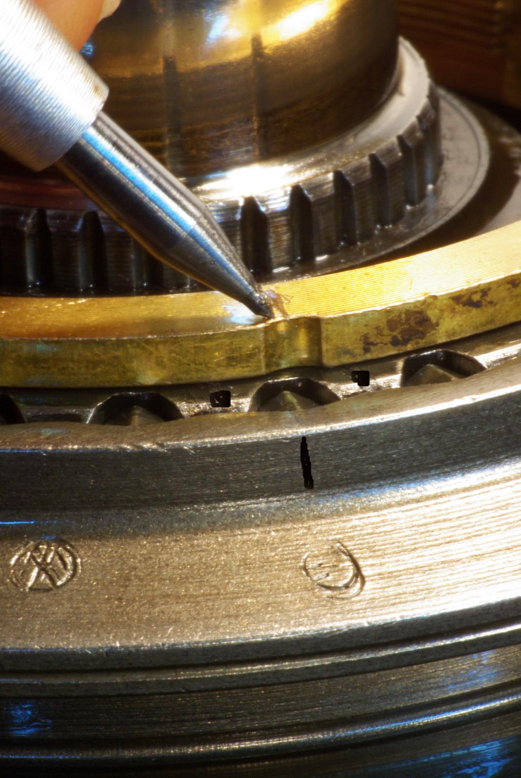

How I like to proceed on dismantlement:
Not being a transmission professional....but having some experience at least with these transmissions...and being cognizant that I am not doing a full rebuild....just a deep refurbishment (bearings, seals, adjustment, cleaning)...and that not all tooling is at my disposal so I will have to improvise at a precise level......and having read alot...and spoken to quite a few transmission mechanics.....this is how I proceed with all of that in mind:
1. I dismantle the gear stack in order.
2. In a notebook (and with camera now) I record any markings found on each part and their relationship to the part above them and below them in the stack.
3. If there are no markings on the part noting which direction they face on the mainshaft or what position with respect too adjacent gearing.....I scribe marks on non-critical surfaces and note them iin my notebook
4. Because these transmissions are medium to high mileage....parts have worn into each other. If the transmission was shifting properly when torn down (or is unknown/un-driven by me).....I mark the position of the synchro hub to the slider and also the brass synchro ring as these have been running against each other for some time.
I dont mark the steel tooth wheel attached to the speed gears...as those are free-wheeling when not engaged.
5. I mark the sliding dogs or clutch keys on the ends so I know the direction they have been running. I also mark keys for position so they go back in the same slots in the clutch hubs.
6. The sliding /key dog springs....are cleaned one at a time and put back into the hub in the exact same degree position it was. The spring tension from key to key is variable to some extent and they have been running this way. If I replace them...which i might in this build if i can get them....they will be going back in the original position.
7. Needle bearings are marked on their plastic shells to direction they are running on the shaft, and what gear they are running with. They are never swapped or moved around. If the needle rollers need to be removed....they are kept in proper left right orientation and washed in a magnetic dish so that they dont roll around out of orientation.
8. All parts are cleaned one at a time in a clean parts washer bath with new solvent. I use either/both brass and nylon brushes. No steel or stainless steel. After the parts are blown dry they get a final rinse/wash in brand new 50/50 acetone and MEK mixture to remove any last residue or small debris. They are blown dry and immediately oiled with WD-40 and placed in order on a clean plastic film covered workbench.
Some transmission experts I have spoken to have also noted that in gearboxes that have been running well for a long time...they proceed this way as well.
Others have noted that when gearboxes that have been running for long periods that do not have overly worn synchros...but are getting loose or sloppy in gear selection....they mark these parts coming out and then rotate them at least one sector...90 degrees to get fresh wear paths.
Any thoughts on my methods are welcome!

A carbide scriber pencil for marking parts

This was another important hint that this transmission has been serviced to at least some level. You can see the gasket sealant on the differential housing. The factory did not use sealant to my knowledge.
The small dent...just above the black dot I drew on the silver spacer bushing at the bottom of the gear stack...is also a common thing that happens when trying to re-install this disc....when you dont use either a press or proper non-marring mallets....is another indicator that this transmission has been stripped all the way down at some point. there is no need to remove this disc unless you plan to remove the differential.
This is the first piece to remove. This the mainshaft ball bearing hub and fourth gear. It simply lifts off to expose the 4th gear needle bearings.
The needle bearings are not hard to find...but replacing them will depend on what quality I can get.
NOTE: these needle bearings have metallic cages. DO NOT scribe on them. Take them out and place them in the magnetic dish...one needle bearing set in each dish. You can scribe the magnetic dishes to preserve order and orientation.
There is no need to remove the large snap ring in this picture unless you plan to replace the mainshaft ball bearing. This one is very smooth and they are very tough and robust. The amount of pressure required to press the bearing from this hub is HUGE. Don't mess with it unless its required. Wash the splined hub and bearing as a unit.
These are the markings on the 4th gear slider hub...facing in the direction of the tailcone and 4th gear ball bearing (which is the direction I have noted in my notebook that all orientation marks will face during this build) the one on the left...obviously a VW logo. I dont know what the middle mark is. It looks like a double stamped "G" or "0". The one on the right is a double stamped "1".
I chose to use the mark in the middle because it coincides between two teeth on the clutch hub that are precisely in the middle of a sector between two sliding keys which also coincides between balance teeth sectors on the brass synchro ring. An easy set-up.
So I made a scribe line here on the brass ring right above a center mark. The black line below it is artificial...just point to the "G" I am aligning with
I also scribed marks on the two teeth of the synchro hub flanking my centerline mark on the synchro ring...again the black marks are artificial so you can see where better.
I repeated the same marking procedure on the third gear synchro ring directly below the ones made on the synchro ring above.
You can now remove the upper synchro ring and slider....BUT....BEFORE YOU REMOVE THE HUB!

This lock plate for the snap ring...is strangely not shown in the parts catalog. I believe it is similar or identical to one found in type 1 or type 3 but for now do not destroy it pry lightly and it will pop out.
Under it is the snap ring.
This is identical in difficulty to removing as the snap ring on CV axle hubs. IT IS NOT THE SAME SNAP RING...do your best to not destroy or bend it. You will need stout snap ring pliers and a small screwdriver.
Later on reassembly I will show how to use a dremel tool or files to put small grooves in the end of this snap ring to fit the snap ring pliers to make removal and replacement simpler.
This snap ring should have a fairly tight fit in the groove. It should only spin when installed with moderate to high pressure from a screwdriver or pick. If its very loose or easily spins...there has been a bit of where in the gear stack. You will have to source a newer thicker one, then file to fit tight.

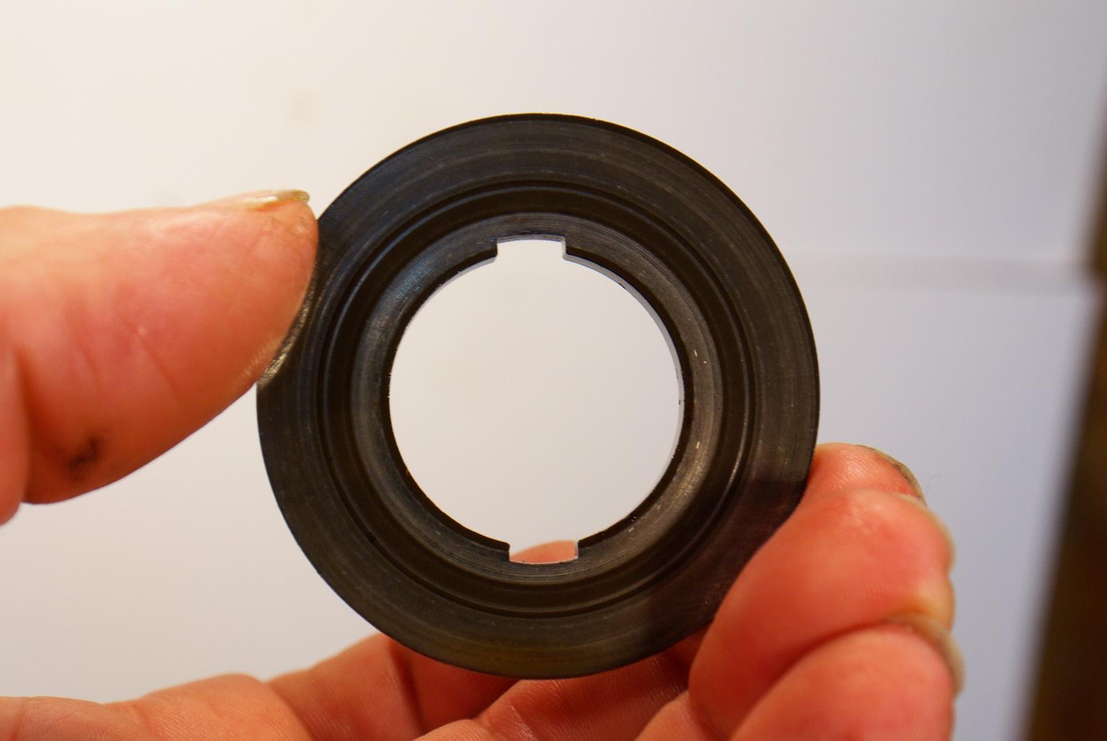

Here is where we are. The silver tube around the shaft just below the visible splines is the third gear bush (no needle bearing on third gear). BUT..its orientation should also be preserved.
This bushing slips right off.
I scribe a fine line just on the edge for orientation towards the shaft end.
This spacer is important. It lifts right off.
It was used to set the spacing between 4th/3rd and 2nd/1st gear clusters primarily to match the countershaft gears. If new gears are installed anywhere on the shaft...it is this spacer that needs to be recalculated and replaced. Note its shape and orientation in your notebook.
There were eight different thickness sizes with different part #'s available. It is a special shim..because its hardened, precision ground and has cut-outs for lock plates in the ID.
This is where it got strange to me! I was expecting two thin lock plates that slip into recesses in this gear ...second gear....no lock plates...no recesses inn the gear.
Carefully lift the gear off. There is a needle bearing assembly in the center.
Top of the gear showing oil relief grooves.
Bottom of gear and synchro...note the three slots (sorry for the poor picture i will replace it in the am)...these index to the steel face of the three piece synchro hub.
Here is the needle bearing. I am scribing the plastic carrier for orientation and position in the gear stack. The other one below should be done the same way.
NOTE: the small square "keys" in the top picture...of the ring that is plugged into the synchro ring.
I mark orientation of synchro rings to hug and slider the same way as I did for the 4th/3rd slider and synchro rings with a scribe line.
Here is the inner brass syncro ring and its steel driving/friction face that operates in the lower brass receiver ring. I will have a picture set later on all of this for clarity.

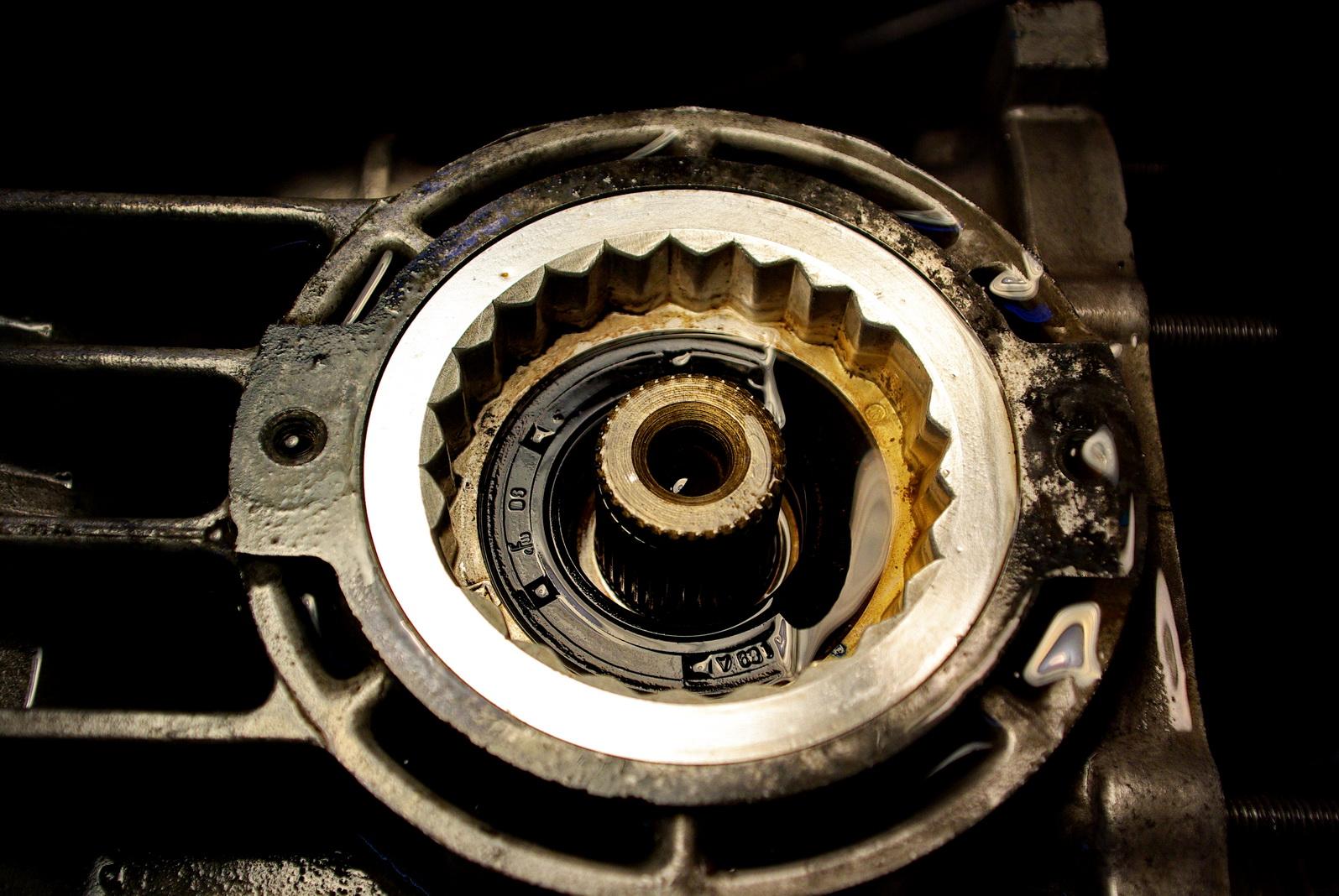

removing the reverse gear. It should slide off easily.
You are looking at the mainshaft, the case centering bushing ring (which i will remove in the next installment), the splined adjusting ring for pinion bearing preload and the inner pinion bearing underneath it.
The plan moving forward:
1. Remove the case centering ring.
2. Remove the pinion shaft assembly..complete.
3. Mark both side adjuster rings for the differential bearings.
4. Only remove the one opposite the ring gear...counting exact turns for removal.
5. Inspect pinion and differential bearings and clean thoroughly.
6. Clean the case housing
7. Reinstall the differential to exact position...without the pinion shaft assembly.
8. Oil bearings and check pre-load by rotation. Record that.
9. Remove differential and install the pinion assembly
10. Oil pinion bearings an check preload by rotation. Record that.
11. Reinstall both pinion and differential and take critical measurements before proceeding further.

This is the normal two piece synchro for third and fourth gears for a 004.
From left to right: the snout on the left normally has the large ball bearing on it.
The gear on the left is fourth gear with its welded gear and male synchro hub
The female brass synchro ring.
The 3/4 synchro hub with keys and slider removed.
The third gear female brass synchro ring.
The third gear male synchro cone and gear welded to the third gear hub seen on the right
This two piece style is very common to most VW trans and many other cars. On most of the 004's that I have seen the first and second gear synchronizers were identical to this. Very simple.
Compared to the models that have the second gear with a THREE PIECE synchronizer assembly:
Here is the complete first and second gear set with three piece synchronizer assembly. at first glance it looks virtually identical in operation and build style.
The gear on the left if first gear. It has a normal two piece style synchro just like third and fourth gears shown above. the gear on the right is second speed gear.
So I will just show the stack up starting with second gear.
This is second speed gear and its welded on synchro cone and gear. Note the three notches milled in the steel synchro cone at 120* intervals.
This bronze synchro ring is what mates to the steel synchro cone surface. Note the three "keys' or tangs that are on this ring.
This is the steel shell that sits on the brass synchro ring on second gear. Note the three tangs on the ID. These mate with the 120* slots on the ID of the second gear hub....and covers the face of the brass synchro ring.
So the steel shell/face is indexed to the second gear.
This is the third synchro ring part. Notice the three rectangular slots in the ring. These are what key this ring to the first brass synchro ring I installed. Those lock the two brass rings into a single unit that move as one...while the steel face in between moves with the gear as one.
Installed.
Then the synchro hub...without keys, sliders or needle bearings in this picture
Then the first gear brass synchro ring is applied. Note...the slots in this part. It is the same part # as the 2nd gear synchro ring even though it does not use the slots. The third and fourth gear also use identical part #'s (generally)....for both gears. I say generally...because I need to check the parts book there may have been some tooth geometry changes from one synchro ring to the other over the years just like they did in other transmissions.
I found one of the repaired tailcones I had done many years ago. I think this is my very first one. Sorry...the welding is terrible. I do a little better work now. But this works very well and is actually far stronger than the tail cone casting on the transmission.
A reminder of the basic plan
You can see that I utilized the tail cone bushing plate...and basically a piece of pipe (may have been electrical conduit). I removed the hockey stick/shift rod from the tail cone casting and milled or filed it flat. I then removed the bronze bushing.
I welded a metal plate in both ends...drilled centered holes and welded in the tube. Then re-installed the inner bushing and outer seal and bushing.
I did not remember until looking at the pictures...that I actually used "freeze plugs" from a water cooled car. they were only a few cents each, were very concentric so they were easy to set up a perfectly centered hole on a drill press.
Then spot weld in the tube so you know its centered. I had to reduce the ID of one or both of the caps slightly with a file and dremel. In this way...I believe it simply pressed in from the back/transmission side...then i tack welded around both ends. I use a gasket and RTV between tail cone and this bushing mount.
You have to make sure that this bushing mount is very securely bolted. If the transmission is installed correctly there should be little load on this part. But if it works loose...with this modification you will know it because it starts affecting your shifting.
I use flanged nuts and Schnoor lock washers with locktite.

For the moment…let’s finish the transmission strip down.

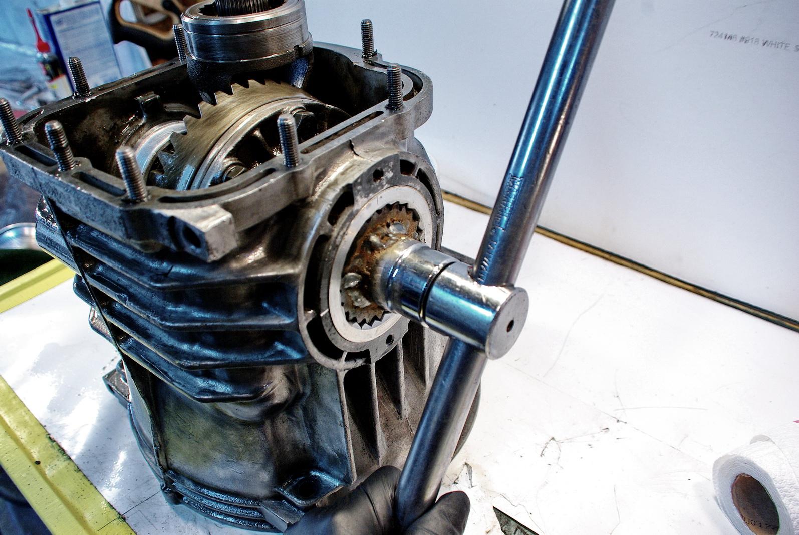

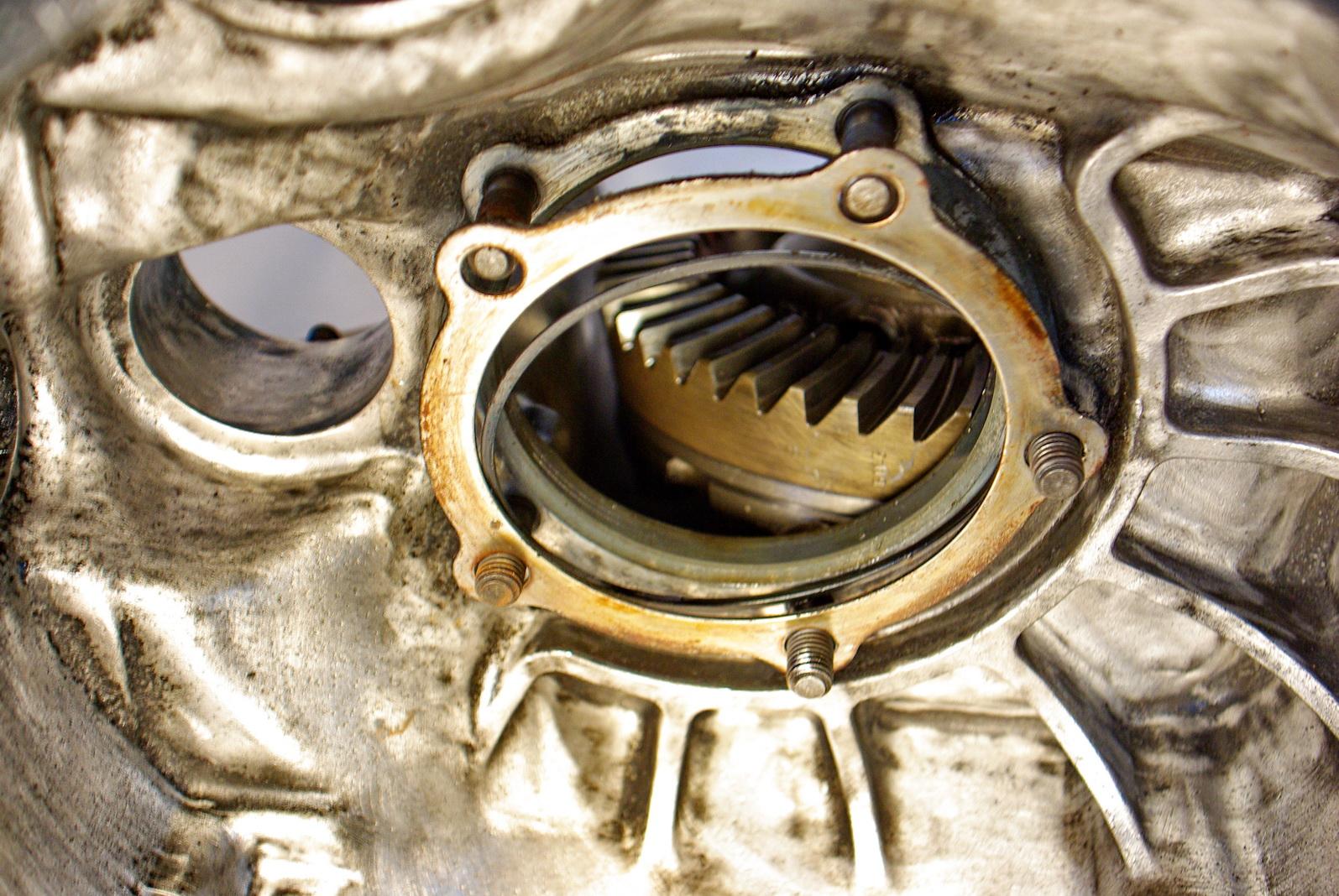

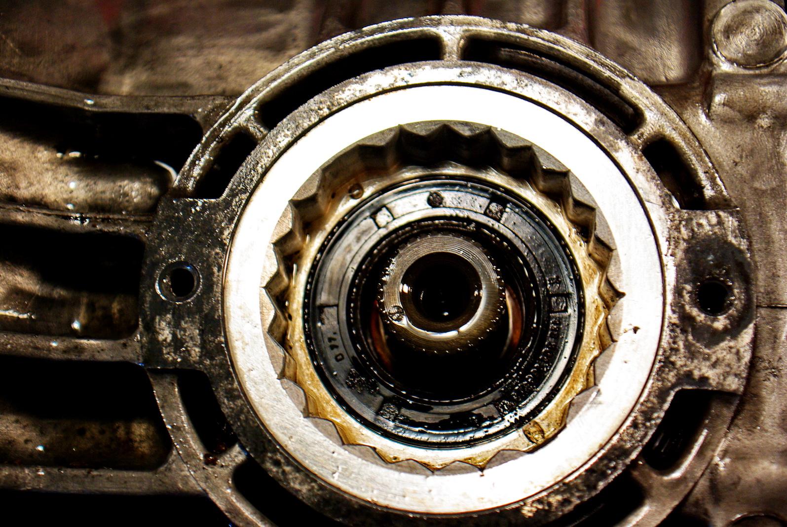

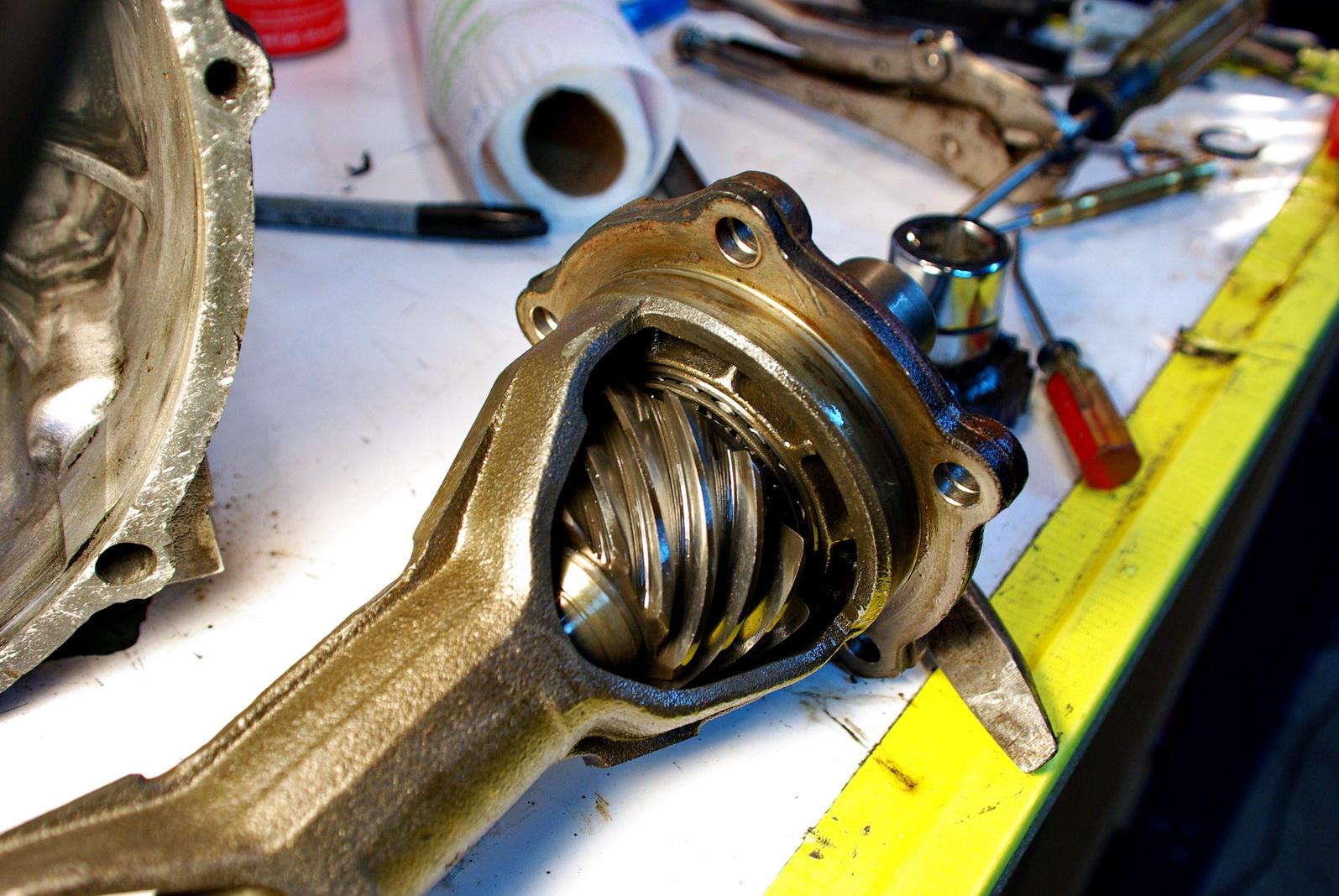

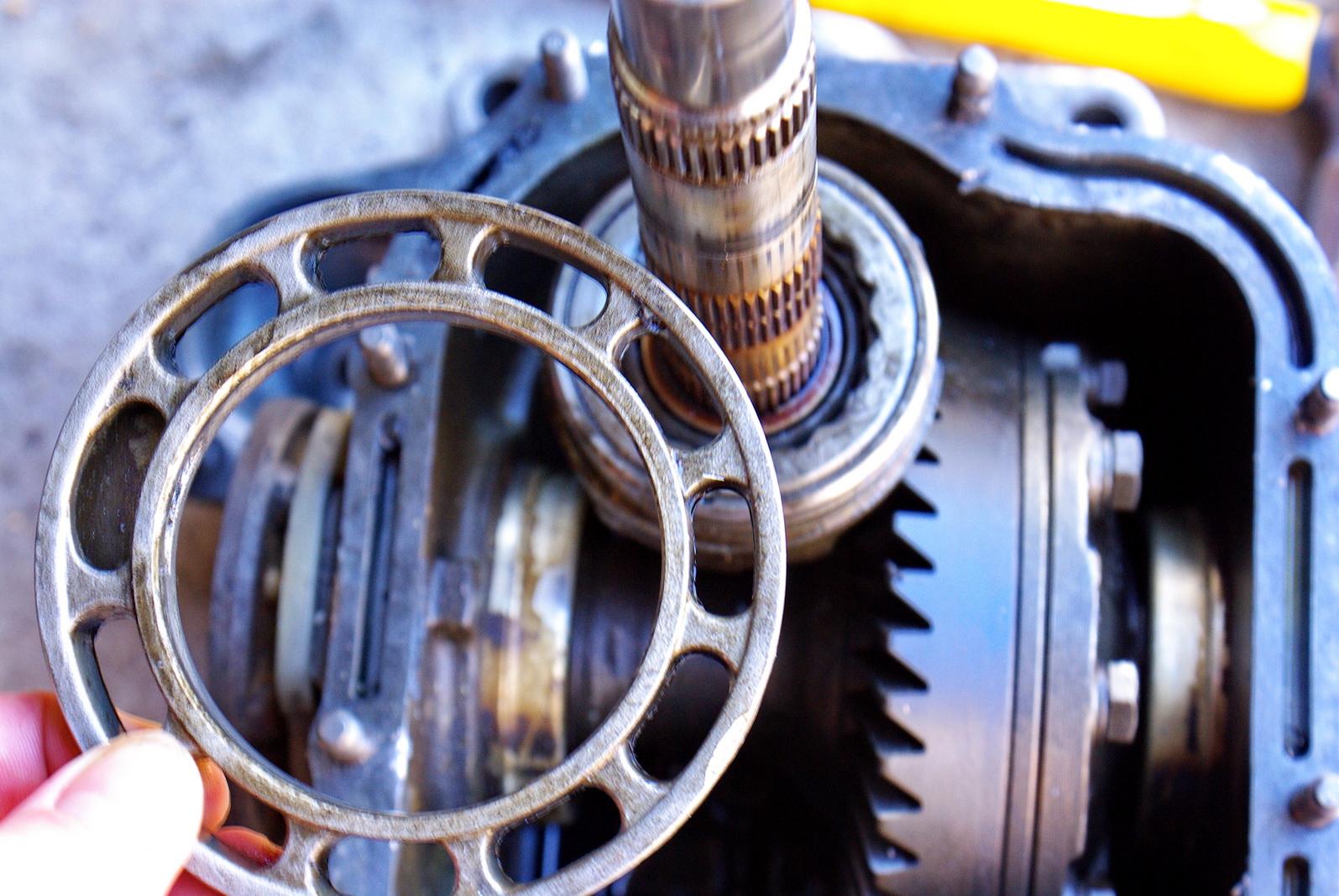

So we are down to removing the shaft to case bushing ring. Notice the snap ring in the picture.
This is not a tight snap ring. It’s just insurance against movement
Remove it by peeling it off.
Put it someplace safe and do not lose it!

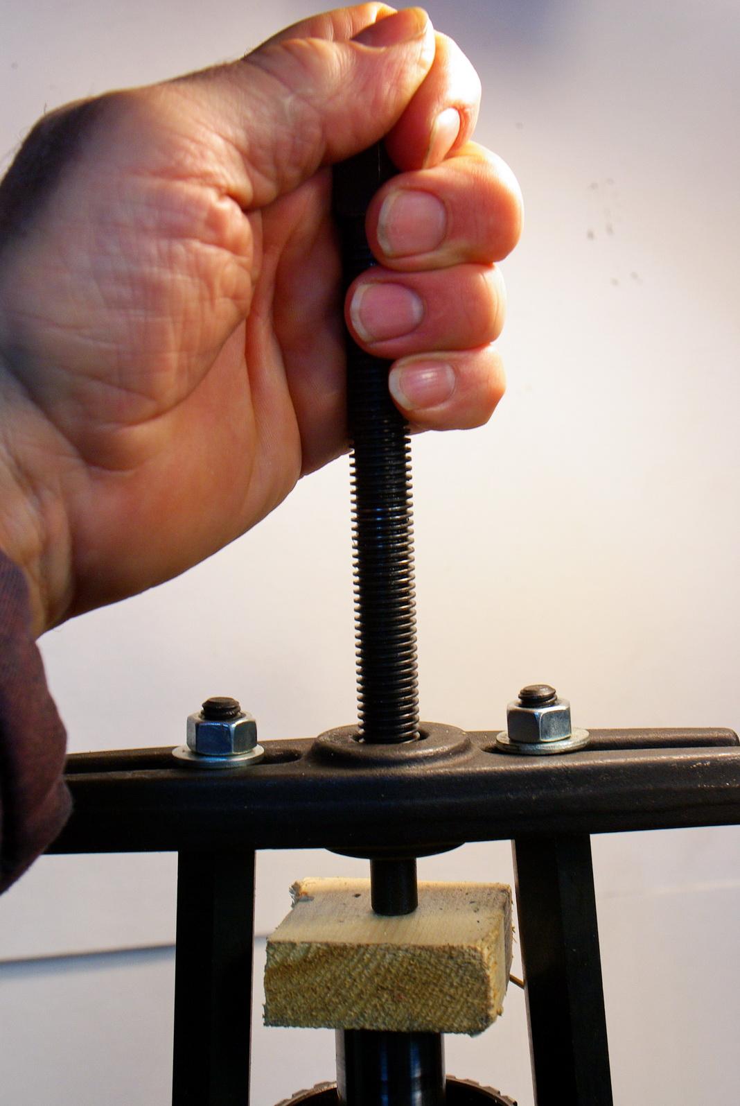

IMPORTANT NOTE: In the Haynes manual they speak of using two methods: #1 a long arm puller or #2 using hardwood hammer handles to lever the ring off.
Having used both…I will tell you that the only ring I have ever broken…and I have broken one…was from using a long armed puller. These rings are one TIGHT!
The twin hardwood hammer handles with a small amount of heat applied to the outer rim of the ring works every time. However…not having any hardwood hammer handles I could risk breaking….I first tried some cheap fiberglass harbor freight hammer handles….I snapped two of them you can see in the background.

Notice the two raised lugs at 180° apart and the corresponding notches in the pinion carrier housing
Light scratches on the case…no big deal.

When you put new side bearings on the differential…..you will use the same tool mounted at this same fixed point to find out if the new bearings have moved the ring gear closer to the pinion shaft centerline or farther away. You are simply using this method to find out where in space the ring gear is…BEFORE you change the factory preload setting or replace bearings.
2. You will need to measure the distance of the pinion gear from the centerline of the differential ring gear: In the factory tool set it has a mandrel that fits in place of the differential that allows a dial indicator to sit on the centerline and measure through a hole in the bottom…to the top of the pinion gear face.
Again….you can pick any fixed point to measure this distance from. It does not have to be the differential centerline. It can be…as noted before…from a fixed point like the case parting line.
All you are trying to find out for now…is how far the pinion gear is from A FIXED POINT. You are finding out its CURRENT location before you alter the pre-load or replace the bearings.
When you put new bearings on the pinion shaft….and measure from this same fixed point with the same tool starting from the same position…..you will see if the distance of the pinion gear to your fixed measuring point…has grown…or shrunk…and by how much.
This will tell you exactly how much to add or subtract from the shim…which is the only adjuster for this measurement.

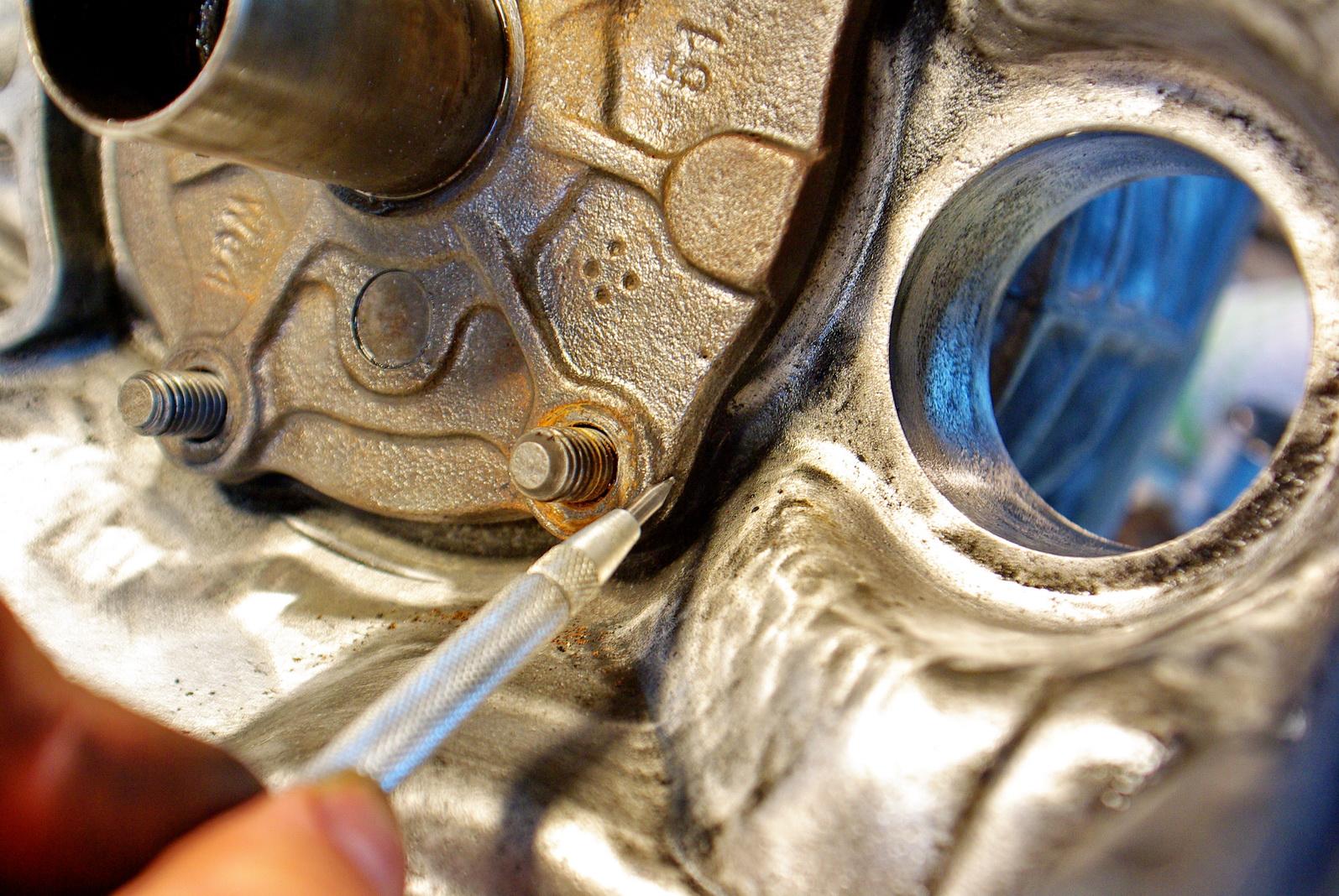

The right side adjuster. It has no markings. So…either it’s never been apart or it was marked by something removable when they did it.
I added a case reference line, a punch mark for starting point and labeled the parts right and left…which you MUST do.
The left side had no markings either

These are left and right bearing races…..notice the roughness?
These are the bearings. Look carefully at the lines of wear in the center section versus the end that had no race contact.
Next….remove the five 15mm nuts that hold the pinion carrier.
There are three points where you will feel an overlap of the cast iron outer hub that you can get a small nail bar, pry bar or large screwdriver behind to lever the pinion carrier out.
Proceed slowly alternating. When the cover is flush with the studs. The pinion carrier should pull out. Careful not to chatter it against the ring gear teeth.
Here is the pinion carrier on the bench. DO NOT DISASSEMBLE IT YET. Put it aside carefully for the moment.
Here is the view into the case.
Here is the pinion gear spacing shim and o-ring…TAKE GOOD CARE OF THESE!
Also…this lip is where the outer pinion gear cover separates……is pressed on…to the pinion carrier. The bearing, race and pinion inner spacer shim is under here. DO NOT YET DISASSEMBLE THIS!
Push the differential to the side…..
Tilt and lift it out being careful not to dent the threads or bearings.
Looking into the case you can see debris. This is bearing or race material. Either from the current bearings or from a previous set. I will not know until I inspect the pinion bearings.
A little bit of this is brass probably from synchros….but much f this is bearing material…not brass.
Be sure you find and capture the spacers between the CV hub and differential housing. Keep them separated per side and do not lose them.

The correct bearing part # for the PINION SHAFT bearings are:
SKF: 331457
Timken: M86648 sometimes listed as M86648-A
I am re-posting this because at one point in time I listed it as M86649...WHICH IS INCORRECT!. The 86649 is identical to the M86648...but the ID is too small by .035"
As far as finding these....I rarely find the SKF bearing available at all when doing a google search. Occasionally I find one on Ebay...but in the recent past the few I have found looked like they were stored poorly...boxes dusty or ripped up...and bearing either wrapped in paper or out of the bag....and no outer race.
I can buy Timken outer races easily as they fit several bearings....but I am wary of mixing races with bearing brands....not to be construed as a form of "racism" Laughing
The only bearings I can readily find are the Timken M8664A...and they are EXPENSIVE...typically best deals are $58 to $70 each without outer races....with peak prices around $112 each.
This leads me to believe they are either out of production or in limited production.
Get what you need to rebuild now or in the future...and keep your eyes open and collect them.
