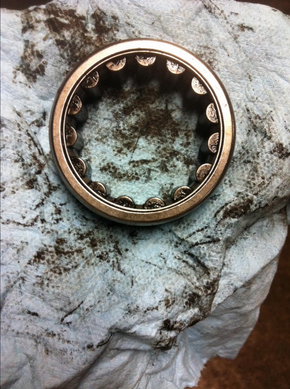

picture of the failed bearing. Notice the closed ends.
84 Westy
1.9TD AAZ
5spd manual with Locking Peloquin TBD
djkeev
Joined: September 30, 2007
Posts: 32988
djkeev is offline
PostPosted: Fri Nov 06, 2015 9:13 pm    Post subject: Reply with quote
As compared to...????????
I fail to see an issue here...... ^^^

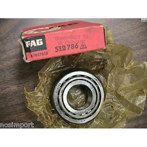

compared to this one. Grease can easily be packed in behind the the rollers. I still don't see how grease can easily be packed in behind the rollers on the failed bearing.
http://www.nosimport.com/image/cache/data/845011286-500x500.jpg
The one you said would be hard to grease looks like it would be the easier one to grease with a needle.

I noticed the caged unit FAG has 17 rollers and the wide open one has 15 rollers. With larger rollers the bearing races are also thinner which may be less able to maintain dimensions. Esp. if the housing is out of round.
I'm having a hard time following which type had the multiple repeated failures. I would guess poor quality bearings would have a shorter life, such as 50k - 80k. The quick failure reported sounds like install error, such as pressing/whacking on the wrong part of the bearing, or an out of round housing.
