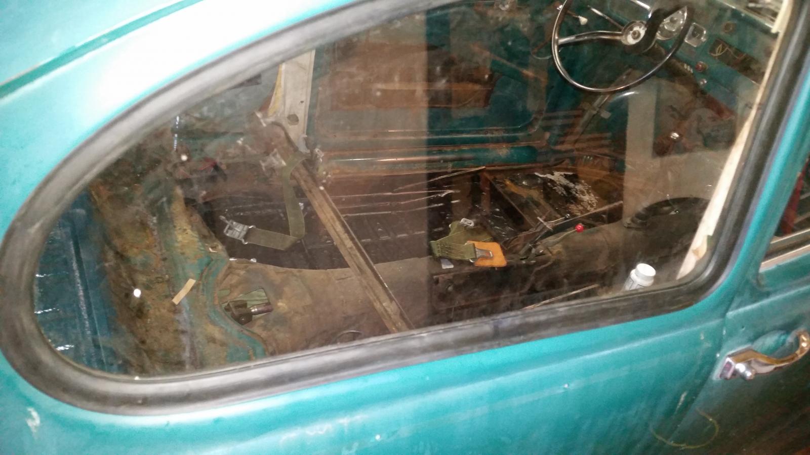

I installed the quarter window seals yesterday.

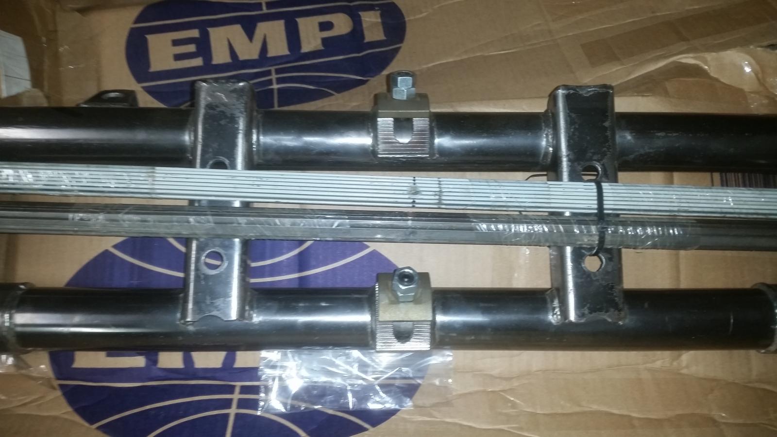

I received a 5" beam in the mail the other day that I ordered from a guy in Arkansas. His business is called fabshop104. Now if I can only find time to install it!

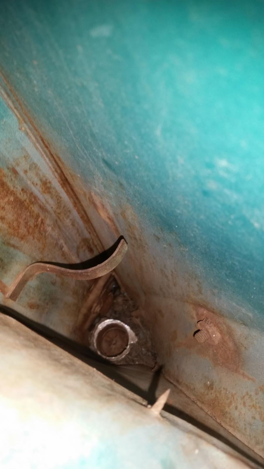

I've been driving the Bug around on short errands for a week or so with no issues other than I have no defrost. I have heat to my feet but not up to the windshield. The first step is to remove the torn up paper tubes down in the quarter panels.
Then I decided to pull the hood of to make life easier.
This is all the crap I pulled out of the passenger side.
Cut off this upholstery nail on each side before jamming you hand in there otherwise it's like an old time raccoon trap.
Now I have to figure out how to get the paper ring left on the tube down below, Any thoughts?
Boy I hope Samba peeps have an answer to this one! I'm in the same spot on this issue. Lots threads get to this point but I have yet to find one that details an answer. Anyone have a link?
I've seen where some guys cut an access hole or opening in the inner A-piller behind the carpet to gain access to this connection... If carefully located, the hole probably doesn't have to be too large I would think. Hope this helps. http://www.thesamba.com/vw/forum/viewtopic.php?t=667248&highlight=heater+tube

I used some tig rod and broke it up a used a shop vac to pick up the pieces.
