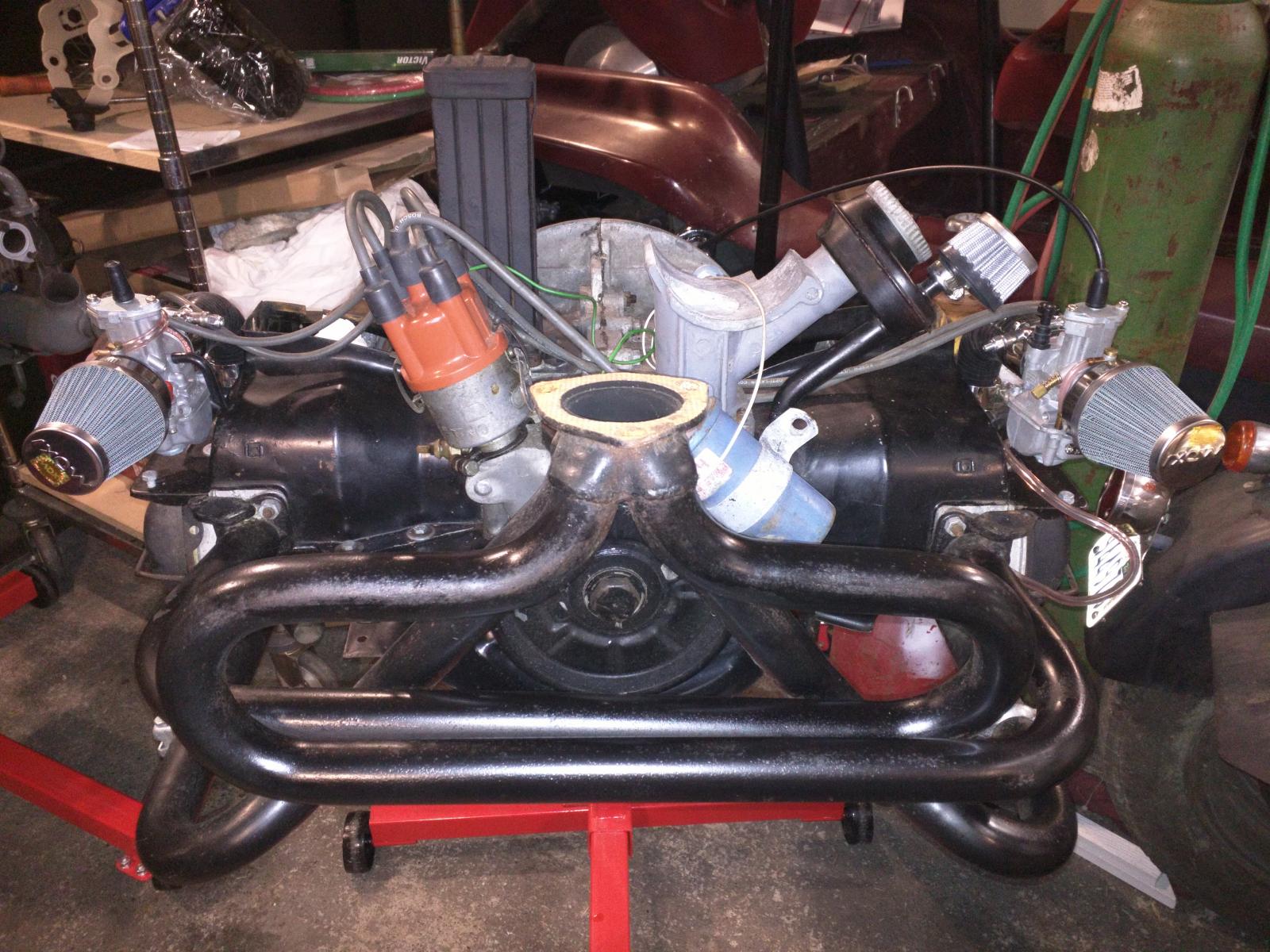

Both carburetors are now mounted, and I am working with the throttle cables
It appears the rigidity of the silicon hoses might be enough to support the overhung load of the carburetors. Will see.

This thread is cool. I like your thinking outside the box.
If the intake hose needs some support you could just weld up a simple heavy wire "exoskeleton " around it just to give it a little lift.

Thanks. I got onto the idea because dual carb manifolds for the 1200 are not readily or economically available; and because I have seen slide carburetors adapted to aircraft applications of VW aircooled engines.
I might even be able to clamp a 1/2 x 1/16th SS bar along its outside curve. My current thought is to use something like 1/2 x 1/16th SS bar to make a strut, running from the unused bolt on the unused corner of the tin, up and tucked under the carburetor hose clamp.
The cool thing about this arrangement is that I can point the carburetors anywhere in about 150° arc, and can greatly shorten the silicon hose legs if I point them outwards, athwartship. I won't know which position is best until the engine is back on the trike and on the road.

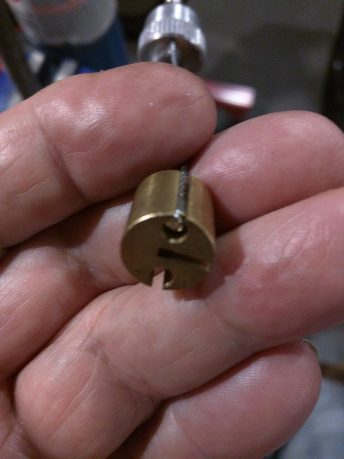

I have been thinking about how to make up throttle cables for my trike project. Dual slide carbs require motorcycle type throttle cables, and having two carbs means joining the two throttle cables into one cable for the Harley style hand grip. Here is what I have been doing.
This project is complicated by the fact I was hit head-on on Halloween night, suffering a moderate concussion from which I may never fully recover due to my age.
So I need to clip the barrel ends off the two throttle cables running from the carbs, and replace them with 'nipple' ends for use in the cable splitter. For this, I opted to use a solder pot instead of applying direct flame to the cable and risk making them brittle. Not having a solder pot, I improvised:
Crucible:
Plumbing solder:
Two minutes later the solder is melted:
Nipple end on left; barrel end on right; installing a nipple end on the bare cable from the carbs:
1/8" soft brass hobby tubing, cut 3/16" long with 'imp' cutter:
After determining the exact length you need the cable to be, cut it to that length, wash the cable end and cut piece of tubing with a no-residue spray (electrical parts or MAF sensor) cleaner, and slide the cut piece of brass tubing over the end of the cable:
Slide the cut piece back from the end, then, while pinching the end of the cable tightly, about an 1/8" from the end, fray the wires enough that when the cut brass is slid back to the end it will hold itself there. It is probably best to leave a little cable hanging out the end, maybe 1/32". This fraying also gives the solder a better grip on the cable.
After sliding the cut brass piece back in place, dip the cable end into plumber's solder flux, then into the solder pot just enough to entirely cover the cut brass; and hold it there for about 15 seconds. Pull it out and let it cool:
Then clean the new nipple up with a smooth file, being careful not to nick the cable:
Here is the first carb cable nipple, in place, in the cable splitter slide:
Here is the throttle cable splitter, closed up, with one throttle cable installed . . . two to go. I had to disconnect the throttle cable from the carb in order to get enough cable out of the housing to put the cable into the slide.
Before doing any of this, I had installed the cable in the carb, and, while in the closed position, carefully measured how much cable I would need sticking out of the housing on the splitter end, so that the nipple would be seated in the slide while it is in the throttle off position within the splitter. Important. I also closed the cable housing adjuster on the carb end so that I would have plenty housing length adjustment to facilitate balancing the carbs, and so that the slide will not top out in the splitter before full throttle is reached. On the other hand, you do not want to cut the cable too short that when it is all put together it won't relax the carbs to the throttle off position.
