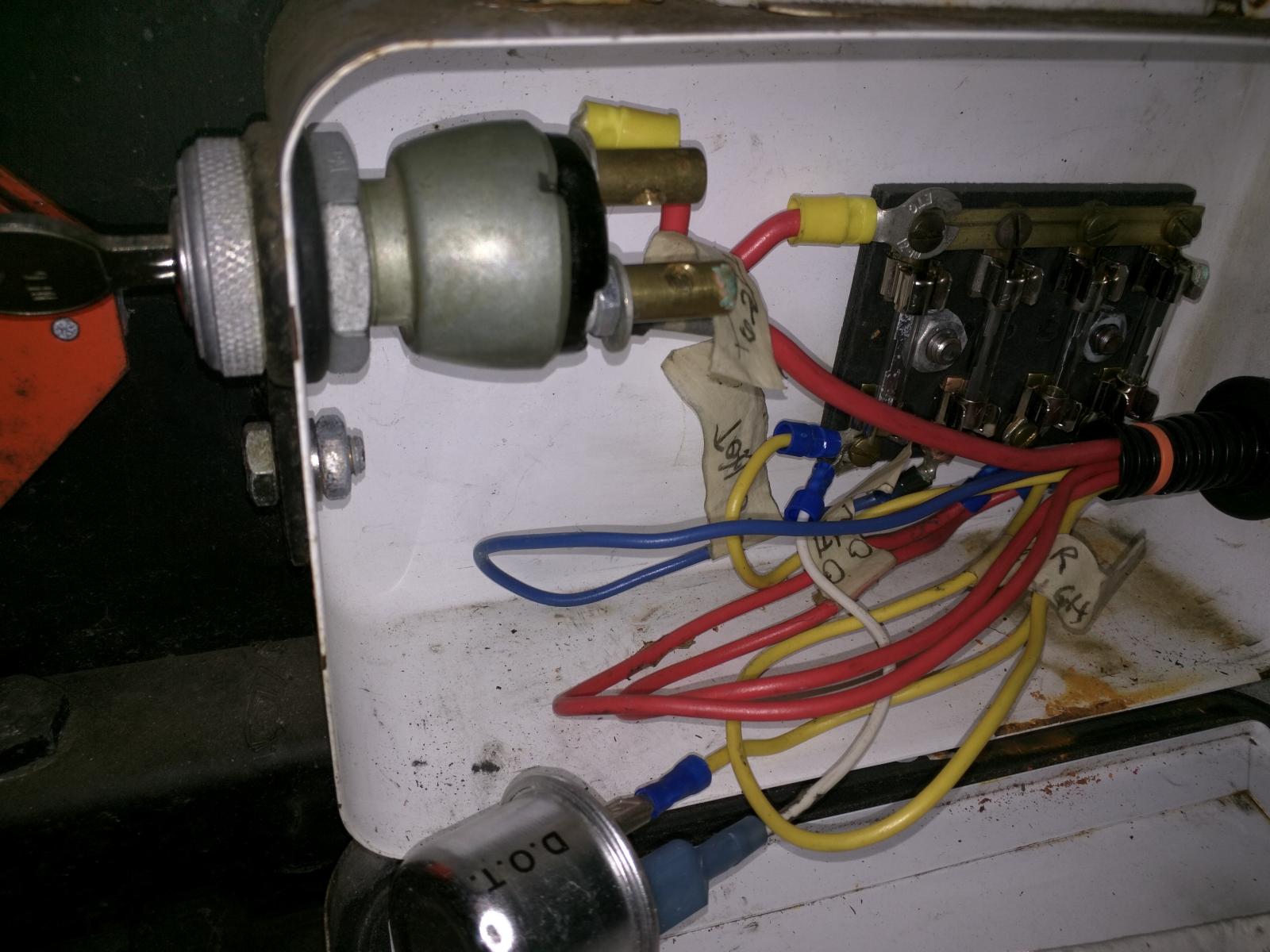

The Electrical:

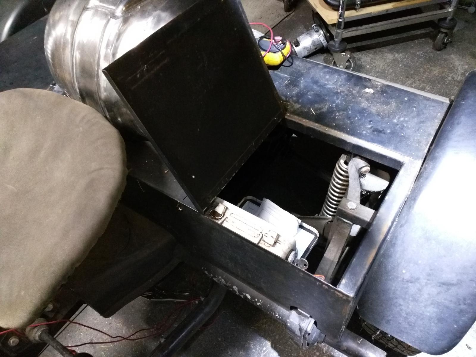

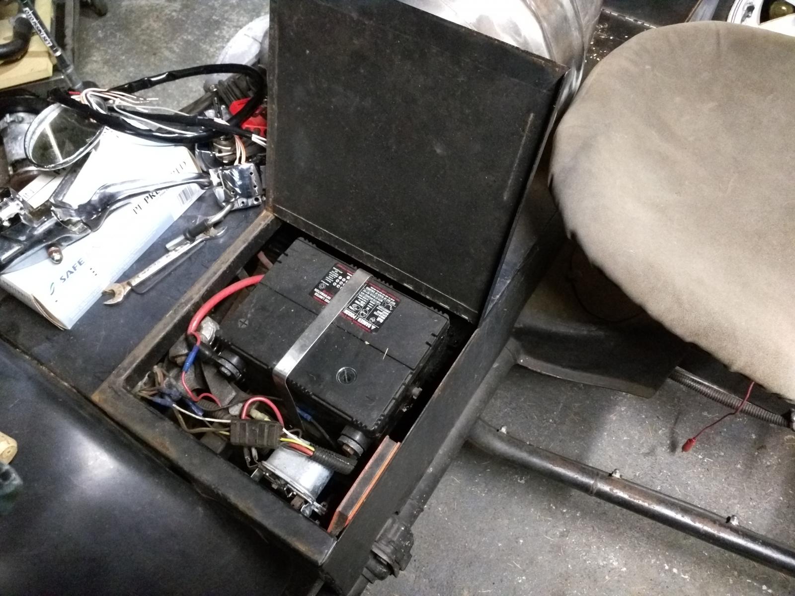

I have decided to replace the brake and clutch hydraulics entirely, with up to date hoses, cylinders, and fittings. I am using stainless steel coated hoses, to match the front wheel hose, with Harley type fittings; and am replacing the master cylinders with newer Wilwood cylinders. They bolt in the same place.
The bike has galvanized clevises connecting the pedal to the cylinder push-rods now, so I am looking for stainless steel clevises.
I have removed the firstaid kit fuse box from the streetside compartment of the trike, and have rerouted the wiring over to the curbside compartment, where I have removed the battery from its tray so that I can locate the new relay/fuse box onto the battery tray. This should make for a cleaner electrical system redo. The battery is moving forward, where it is going to sit on a floor (yet to be devised) between the pedals. This will put some more weight forward, as these shorter trikes have tendency to lift the front end when accelerating.
