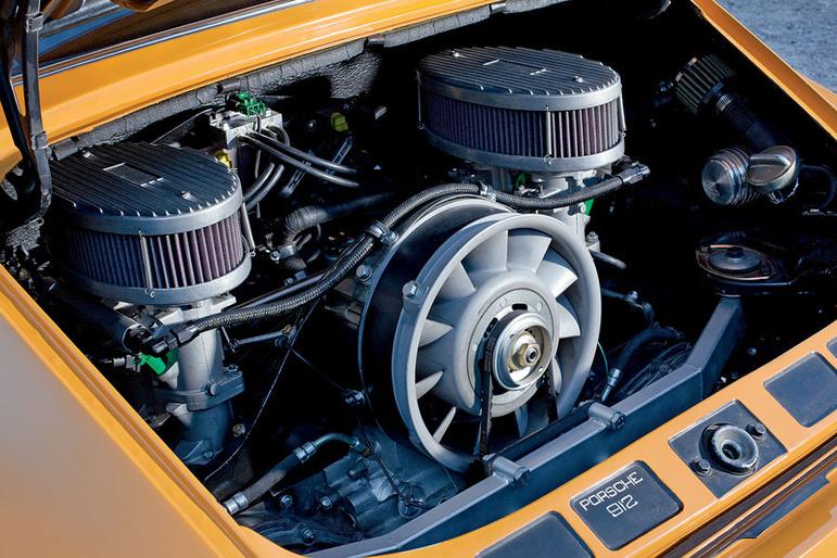

http://www.polomotor.com/
The Polo 930-4 crankcase is manufactured to the highest standards of foundry process and metallurgy. The foundry we use is the best in the business and the same one used by Donovan, Shelby, Fontana, Shaver, Chrysler Hemi and Arias. Only 100% Virgin ingot is used throughout and the metal is heat treated with two different aerospace processes.
Our crankcase also incorporates five main journal supports for added strength. The oil to the crankshaft is routed from the front to the back as is the 911 standard and has an added oil passage at the center main.
Machining is completed by state of the art C & C machine and tolerances are held to the same strict standards of a factory prepared 911 crankcase. The Polo crankcase will accept parts from different vintage 911 engines and has been fitted with many of the later air cooled model updates.
I was recently at an awesome event, www.tejastreffen.com , and one of these showed up in a 912. They sound and look fantastic. He was very popular at the show, you could tell he felt it was money well spent. I don't think money was any object for him at all

7/12/15 Denver, Colorado. VW's, Porsche's, and Audi's were invited. Air and water cooled. Runner up in class voted on by the show car owners. Best of show Engine voted on by the VW, Porsche, and Audi business owners.
3 articles about the World's first POLO powered 912 can be found here. One in Europe and two in the U.S. www.reSeeWorks.com
The case is virgin cast aluminum. 5 main bearings, 11.3 CR, pulls hard from 3000 and spins to 7200, etc, etc, etc. And the sound is just awesome. The sound alone is worth the price. The early overhead cam Carrera engine and this overhead 2 cam 4 have a sound much different than a Type 1, Type 4, or a 356/912 616 based engine. The guy I bought the 912 from had a POLO in his 59A coupe. He took me for a ride. Within minutes I HAD to have one, period end of story. If you go to the tool bar on the site click 912 POLO Car then riders and drivers, find out what others experienced.
