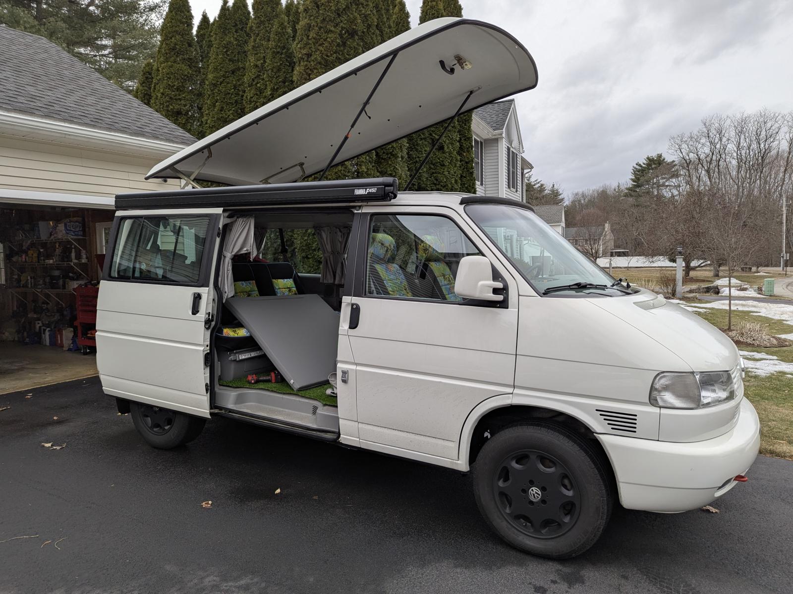

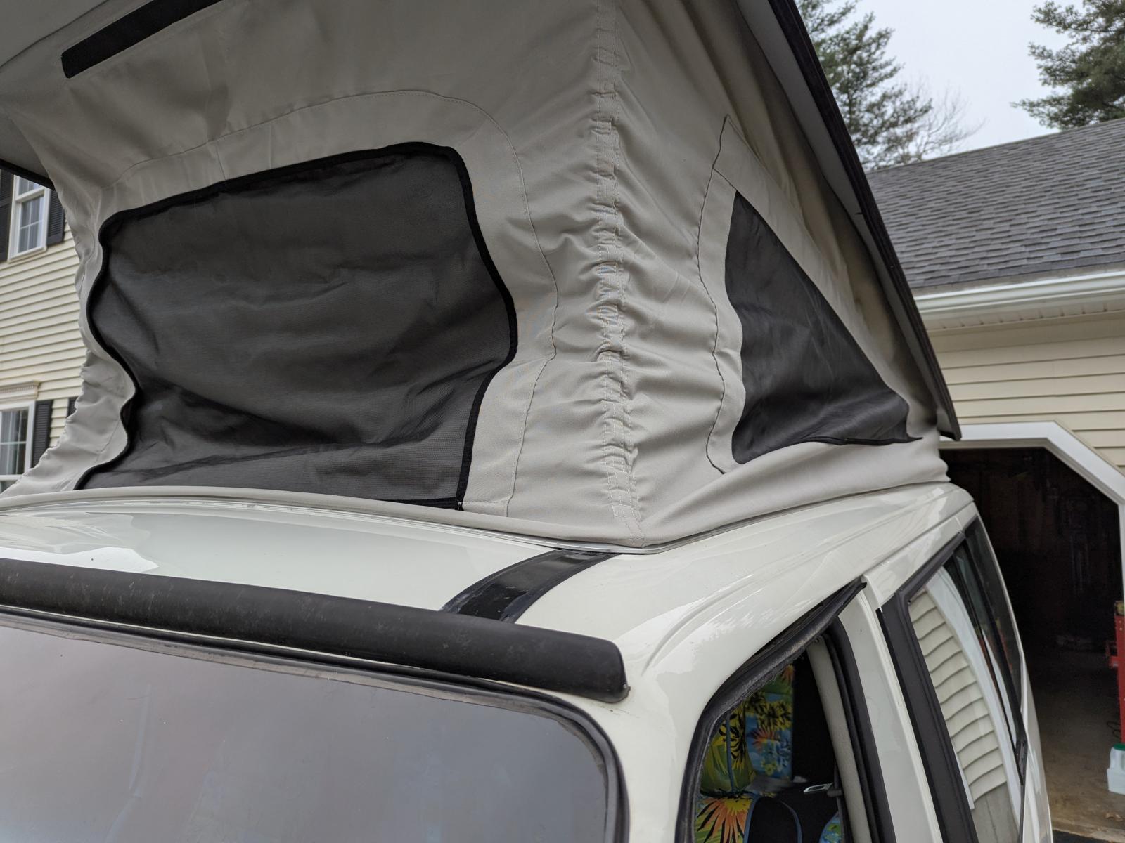

Here are some pics of the process...
Weekender with old tent removed.

Rear bracket passenger side finished. Note the tent/paracord extending out of the corner portion of channel. The sides of the tent are not yet attached. Do that after all the corners on the front and back channels are secure.
Passenger side bracket installed.
Bottom of tent inserted into channel (roof must be held in position lower than normal to introduce slack into tent)
Rubber molding inserted into lower channel. I used a metal trim tool for this

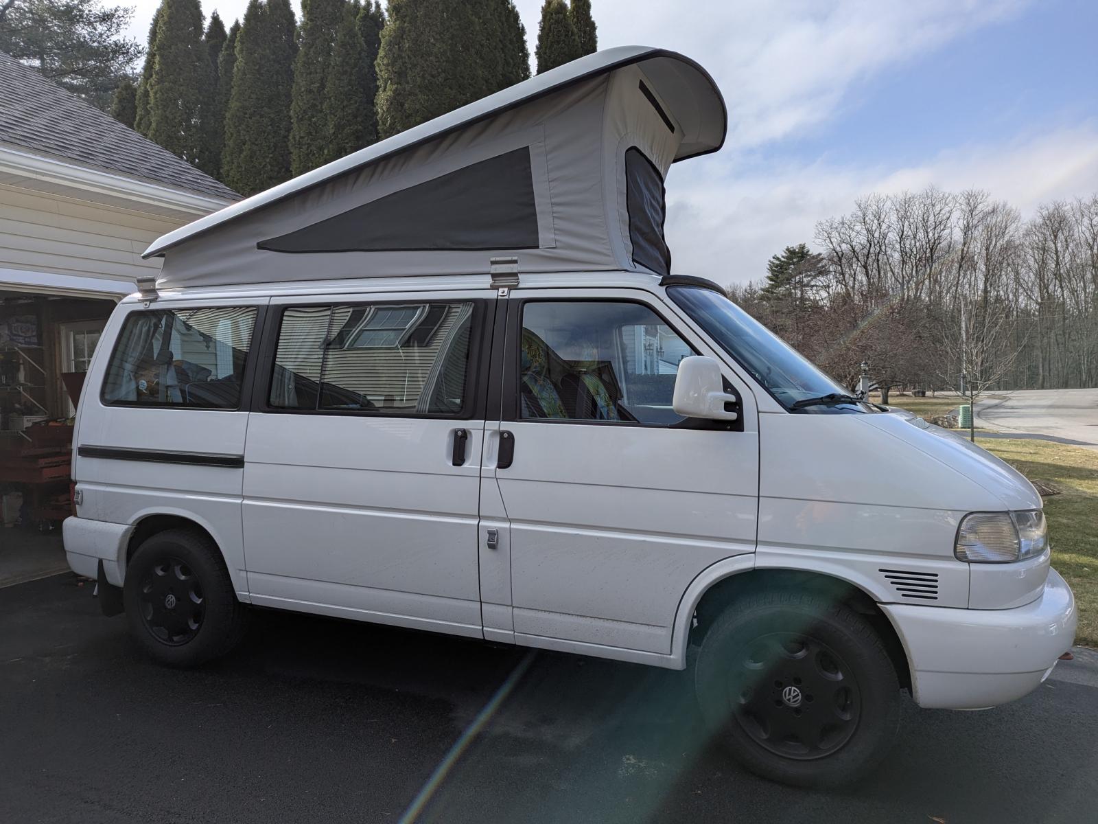

Finished product.

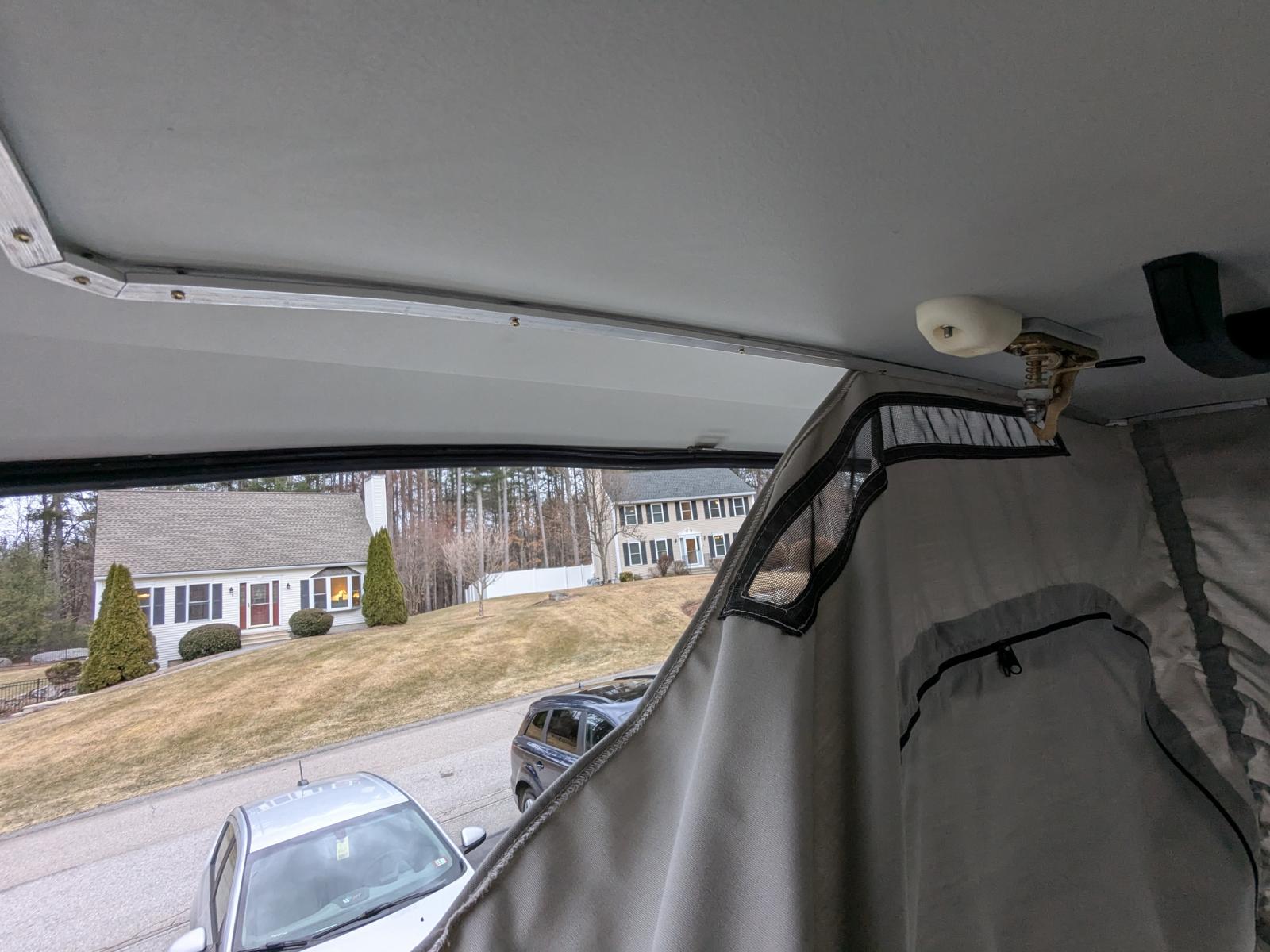

I'm sure I've told Cole this before, but I'll reiterate it here for discussion...
I feel it would be a huge benefit to modify the top in a way that allows it to pop up higher. This would make the space more similar to a Vanagon top where you can sit upright in the top and read a book while viewing nature from your private abode.
My biggest complaint moving from a Vanagon to a Eurovan was that I could not sit upright in the upper berth with the top popped.
This was posted years ago but ... I'm new here. The idea of being able to sit upright in the upper berth seems like a reasonable question. Does anyone happen to know which dimensions are different between the Weekender and Vanagon? Is the poptop longer in the Vanagon? Does it just incline to a steeper angle? Or is it some of both?
I guess worst case I could try to find someone with a Vanagon and get them side-by-side to compare measurements, but if someone has already done this and has the answers...
