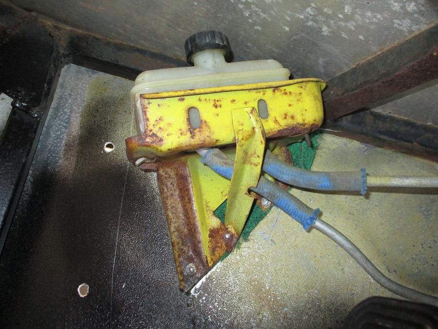

Looking for some help please.
We are starting to make a list of parts needed to rebuild the braking system.
The master cylinder and reservoir the buggy has on it now is shown in the pics. We are needing to know if someone can identify the year or provide a part number so we can order new ones, or if there is a better replacement for it that you may know of.
The pieces of the old wire harness were not connected to the cylinder brake switch so we are not sure how to wire it up.
Another question, why does it have two brake switches?
Thanks in advance for any help you can give.

Your brake master cylinder is a two-circuit style, which means there's a rear and a front. It was a safety design so that if there was a leak or problem with one wheel, at least fronts or rear brakes would still work.
There are dual brake switches because of the brake warning light system, which would illuminate a bulb on the dash if there was no fluid in the master cylinder. It would be glaringly obvious that your brakes don't work long before that bulb would ever light up!
You can wire your brake lights with those style of switches, but you can also get earlier two-prong brake light switches.
https://www2.cip1.com/ProductDetails.asp?ProductCode=VWC%2D113%2D945%2D515%2DH
Search the Technical heading on this website, there are plenty of wiring diagrams. But you could have someone put their foot on the pedal and test for continuity on the prongs, when pedal is down (one switch is simply jumpered to the other)

PostPosted: Sun Aug 09, 2020 4:17 pm    Post subject: Re: Need help please... grandfather / grandson project Reply with quote
VW Bobby wrote:
Thank you Matt!

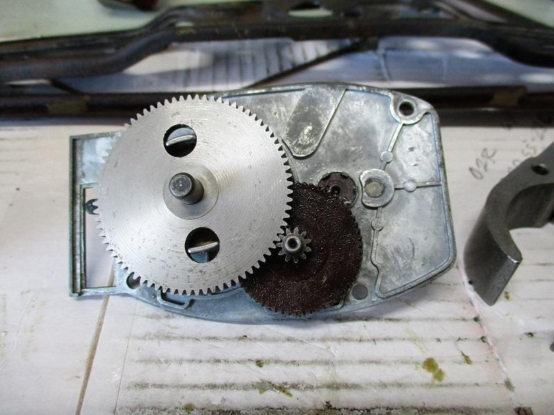

PostPosted: Thu Aug 13, 2020 2:02 pm    Post subject: Re: Need help please... grandfather / grandson project Reply with quote
Disassembled the wiper motor, cleaned and lubed it up to include the linkage. Everything seems okay now so I ordered a 12v to 6v step-down module for it. It’s yet to be seen if it will all work together when the installation happens.
Started on the pedal assembly rebuild. Used degreaser and a power washed to remove the big stuff. The gas pedal was stuck.
It’s soaking in diesel for now and I hope to have it finished on Friday.
Feels like we are making some progress, (yeaaa) but we are still looking for a motor or someone to rebuild the one that’s in it.
