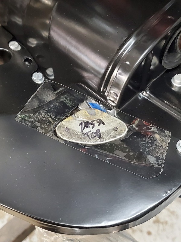

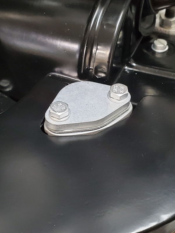

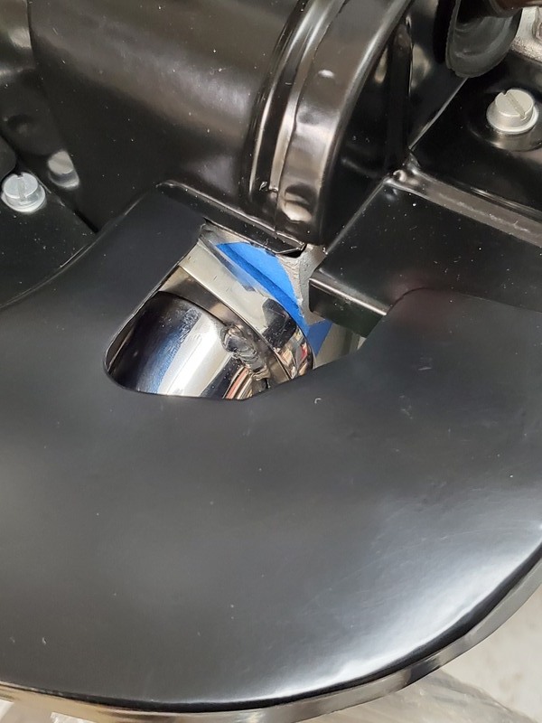

1958ghia wrote:
Joe - these engines look amazing, like normal! Smile Quick question - what do you usually use to block off the heat riser openings in the rear tin? I see some pics after the engine is all done with openings there, and would've thought they'd be welded closed prior to painting/powder coating. Thanks again for posting these works of art!
I think you have me confused with another engine builder. I've never left this area open or even worse, welded it up shut. If this area is left open, heat from hot exhaust would come through and possibly overheat the engine. If this area is patch welded shut, it would not let hot air / heat come up BUT......now it does NOT look original! I'm about building these early engines AS ORIGINAL as possible. In all my 45+ years of building the 25hp/36hp engines, I've never patch welded these areas shut but rather fabricated brackets that would hold the heat riser block off plates in place to duplicate the "look" when there were no provisions for mounting them on aftermarket exhaust systems.
In this photo below, you can see this aftermarket exhaust system has NO provisions for mounting any type
of heat riser block off plates. Leaving this area open allows hot exhaust heat rise into the engine compartment...
BELOW: I make a "foot print" out of 1/4" steel and position it exactly where I want the heat riser block off plate to be installed noting
NOT to make contact on any sides of the rear breast plate and possibly burning the powder coated tin. I weld it to the bracket
and attach it to the top exhaust stud.
BELOW: Here you see the beat riser block off plate as installed with gasket. This makes for a clean installation and
still keeping the "original" look of an engine as if it were to be built back in the day........Cheers! Wink
