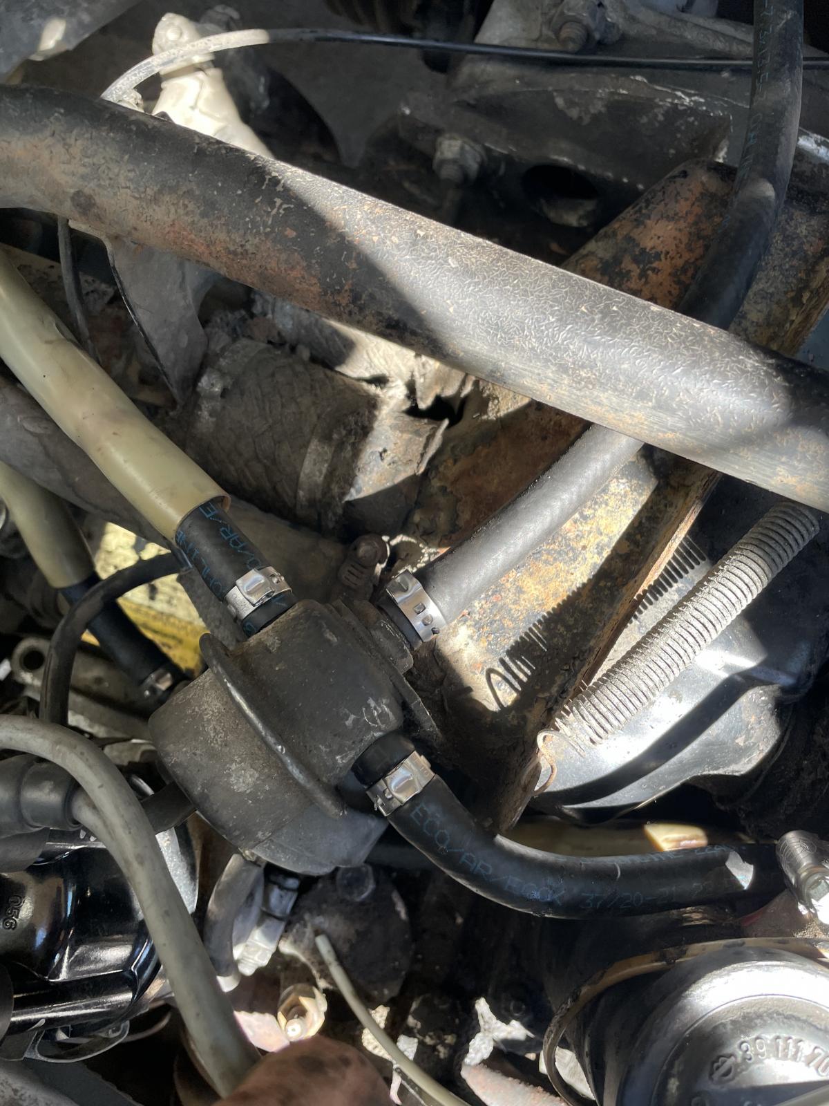

Had another productive work session today. I got the rest of the new fuel lines in the engine bay and new hard lines installed, repaired the worst of the remaining rust spots, fixed the speedometer cable that a previous owner had patched together after removing the mileage/emissions box, installed GoWesty's HD mirror kit, and cleaned up some electrical connections and grounds around the engine.
Next up is CV joint repacking and new boots, then brakes, then tune-up and oil change, and then and then and then.... Laughing

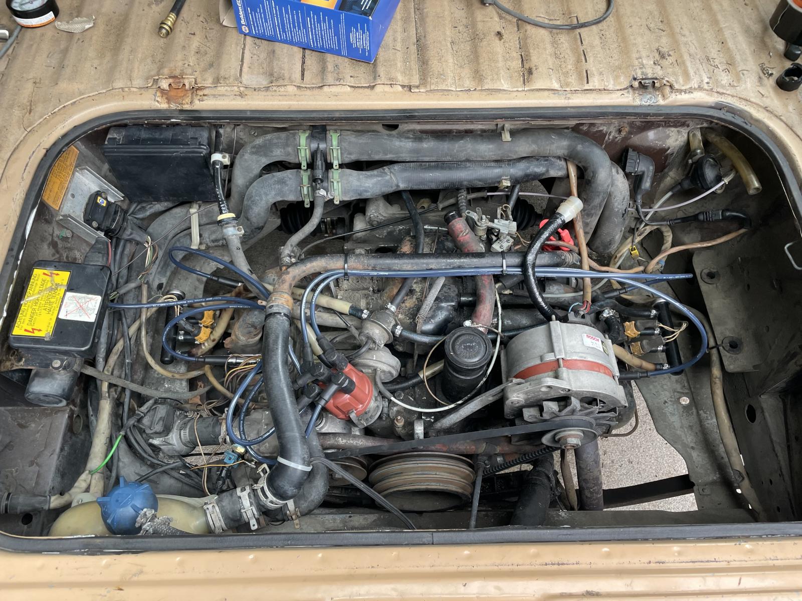

So after the engine had been cranking and idling so well over the last few days, I decided to drive to the gas station for a fresh tank of gas and go for a little cruise since its such a nice day here. Everything was going great until I got about a mile up the road and came to a stop to yield at a roundabout and the engine died and refused to start. I had put a little less than 5 gallons of gas back in the tank the other day after the reseal, so I was fairly sure it wasn't out of gas. Long story somewhat shorter, a really nice couple with a tow strap stopped and gave me a pull back home where I discovered the center post/spinner contact thing on the inside of the distributor cap was completely burned up! I can't believe it was running as well as it was. Anyway, buoyed with the assurance that I had found the cause, I drove to the (second) nearest FLAPS to grab a new cap. Sadly, I still have a no-start situation (and yes, I triple checked the firing order). I checked that the fuel pump is getting power but that's as far as I've gotten with my diagnostics until tomorrow. My plan of attack is to check for spark at the plug, then, if that is good, unbolt the injectors to see if they're squirting correctly. While I'm back there, I'll probably check the compression, too, btw. Is there anything else you guys recommend? Is it possible I just flooded it from trying to crank it so much without any spark?

I'm going to actually check for fuel at the injectors later today, but now that I have it back in the driveway where its nice and quiet, I'm 99% sure I'm not hearing the fuel pump turn on for the half a second or so when I turn the key to ON. The relay in the back clicks on and off, but nothing from the pump whereas is previously made an audible noise. I checked the voltage at the pump last night and read just under 12v for a moment when turning the key to ON and then continuous ~10v with the starter engaged (remember, this is after many minutes of futile cranking on the side of the road). A friend is going to loan me a known working pump to test and to use until I can source a new one if that turns out to be problem.

Update: Fuel pump is definitely dead. I pulled the plug in the tee at the engine and attached a length of fuel line and ran it to a small bucket then hotwired the pump but no fuel came out at all. The pump sorta clicked but made no other sound or any vibration or anything Rolling Eyes
Now to see if I can find a pump here in town.
I did check and there is a good spark at the plug, btw.
Get two. Some critical hard to find items are worth having spares in hand.

While I couldn't find any new pumps in town, a friend had a couple of working used ones he let me borrow until the new one I ordered comes in. After I got the loaner swapped on (cutting and crimping ring connectors which leads me to believe the old pump was quite old), I tried the key and had the familiar buzzing from the pump, but, when I tried to crank it, still no start. Remembering I had swapped on a new cap, I quadruple checked the wiring arrangement. According to the book, all looked correct. But then I remembered how I had once installed the 009 distributor in my beetle incorrectly when I built that engine and had to plug the wires in according to wherever the rotor pointed at TDC #1, I turned the engine by hand until the timing mark was at the case midline and popped the cap. AHA! the rotor was pointed to what should be #4 according to the book. I re-arranged the wires but still had a no start. Well, since the timing mark could either be at TDC on the compression or exhaust stroke, I re-re-arranged the wires as if #1 was where #2 should be. Crossing all my fingers and toes, I tried the key again and happily, the engine sprang to life and settled into what is definitely a smoother idle than before.
/I get by with a little help from my friends.../ Very Happy
TL,DR: It lives! The fuel pump died.

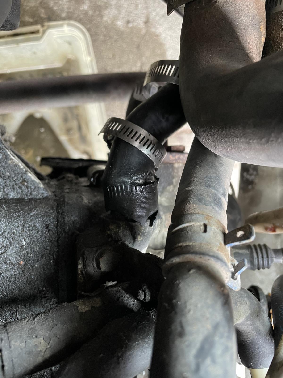

Got my new GKN/Lobro CVs installed this morning and was going to drive to a friend's house to help him drop the fuel tank on his westy, but after a quick shake down run through the neighborhood, my coolant leak is back
I know I should just bite the bullet and replace all the rubber hoses and pipes, but if I just try to replace this one hose, will all the coolant drain out anyway and therefore I should do the lot while I'm at it?

I thought I'd try to repair the hose to make due until a new one can be ordered by cutting off the torn piece and clamping what's left of the flared end on the nipple on the head. Unfortunately, it looks like someone else has already done that!
By the time I cut the bad section off, there was no more flared hose and there's no way I was gonna get a 5/8" hose on a 1" nipple. So, I sealed the ends up as best I could with gorilla tape and hose pliers and cool my heels until a new hose comes.
In the mean time and since I had the air filter box off, I went ahead and finished the tune-up with aa set of NGK 1263 and NAPA's finest plug wires.
I also ran a cold compression test whiile I in there (to the nearest 5psi):
#1 120
#2 125
#3 125
#4 125
I really think once I get the wrinkles ironed out and undo the last couple decades of neglect, this will be a pretty good van.

gates 18965
1" to 5/8" hose to use off of cylinder head.
