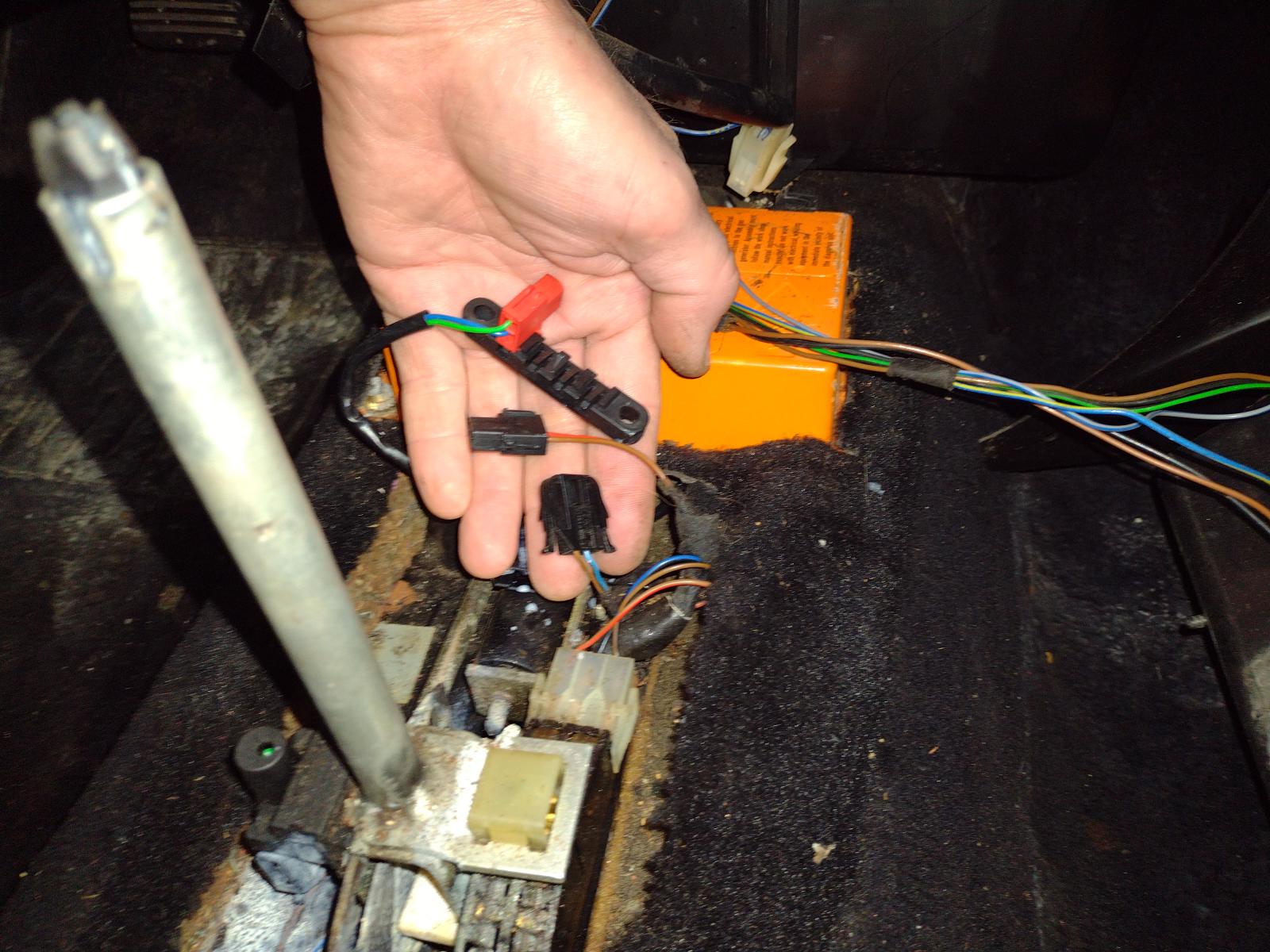

If anyone is out there and knows... I'm wondering what these wires are for in the shifter box? My guess is seat belt alarms? They were loose like this so someone disconnected them at some point.
http://www.cabby-info.com/airbag.htm Wink
Keep up the good work!👍🏻
~Kamz Anxious

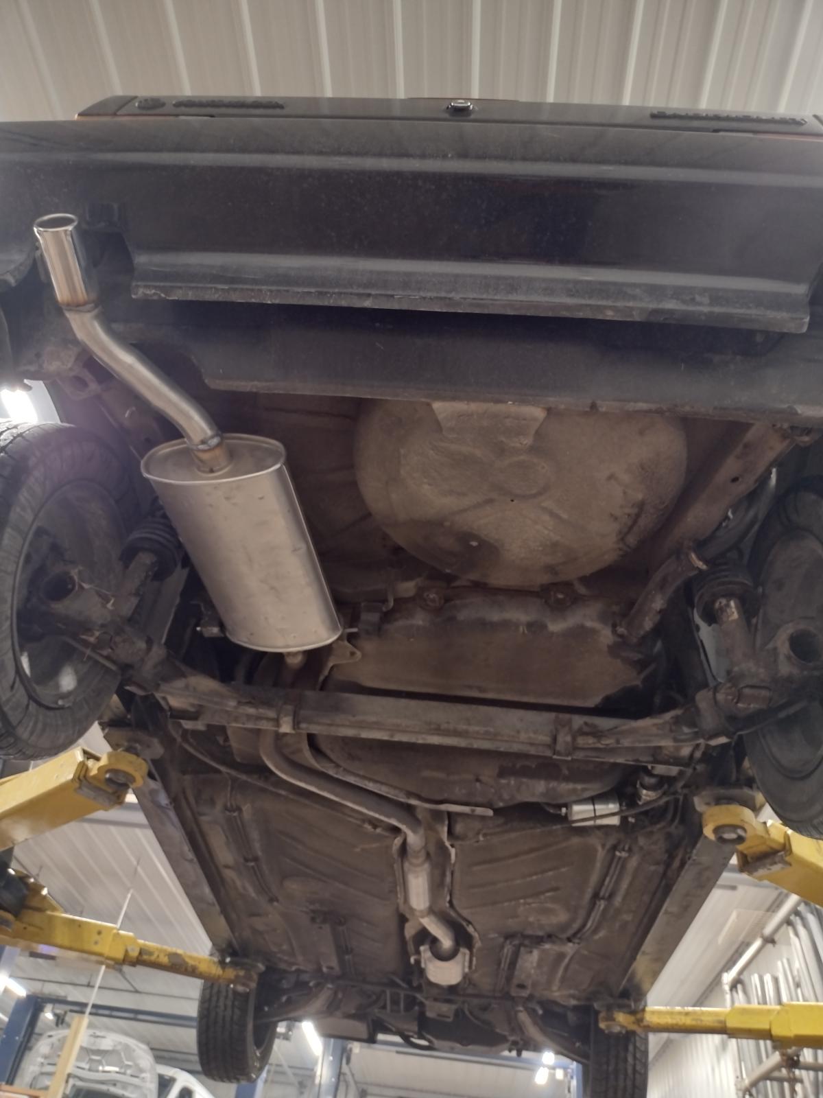

The Rabbit is nice and quiet with a new cat, resonator, muffler and tip.

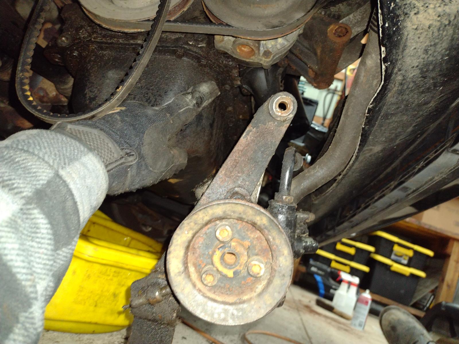

PostPosted: Sat Jan 22, 2022 11:14 am    Post subject: Re: Buggeee's Topless Bunny Reply with quote
Missing bolt on that PS bracket.
Looking good with no oil leaks too.
Thank you Butcher! I love having an extra set of eyes on things.

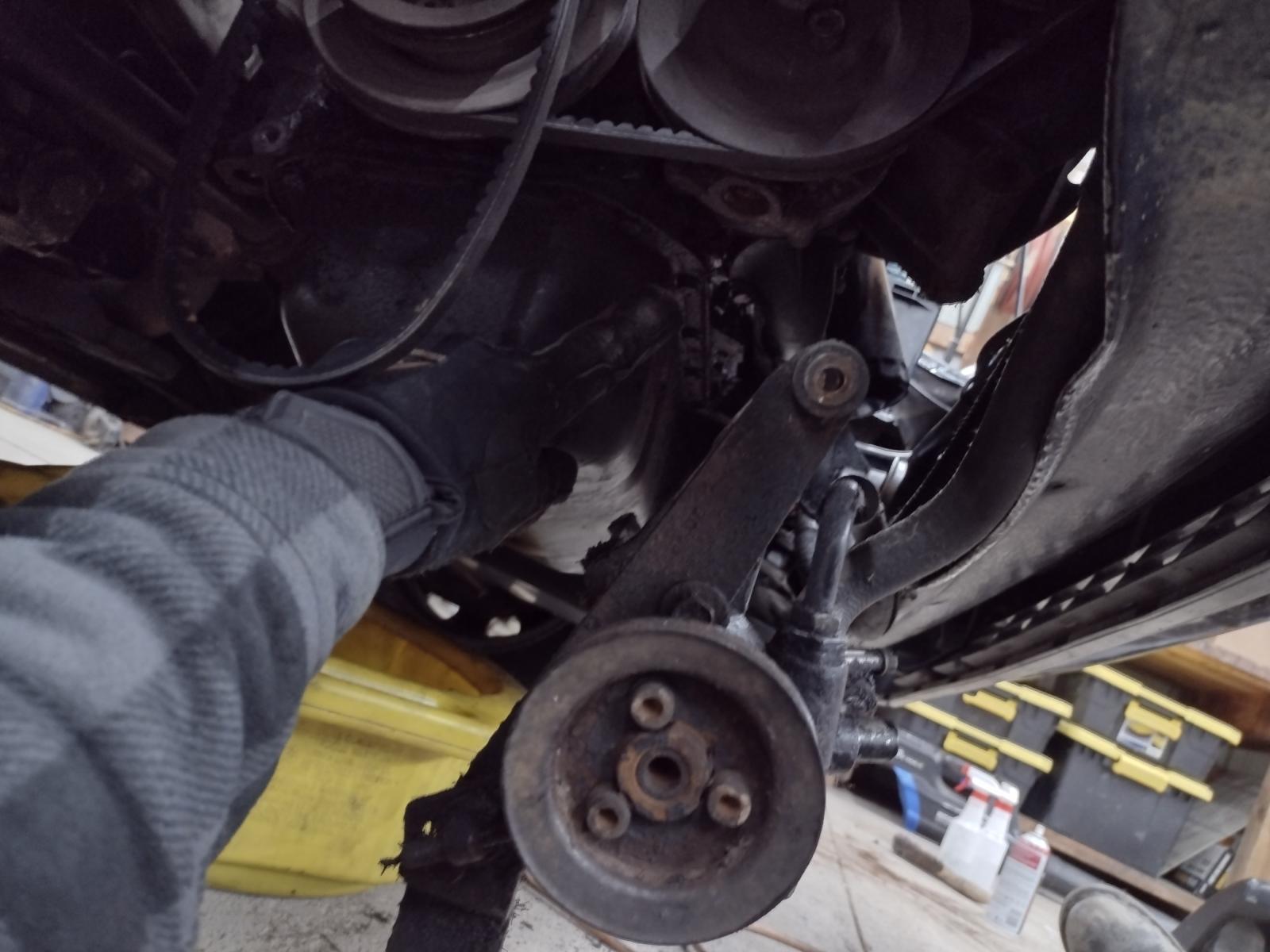

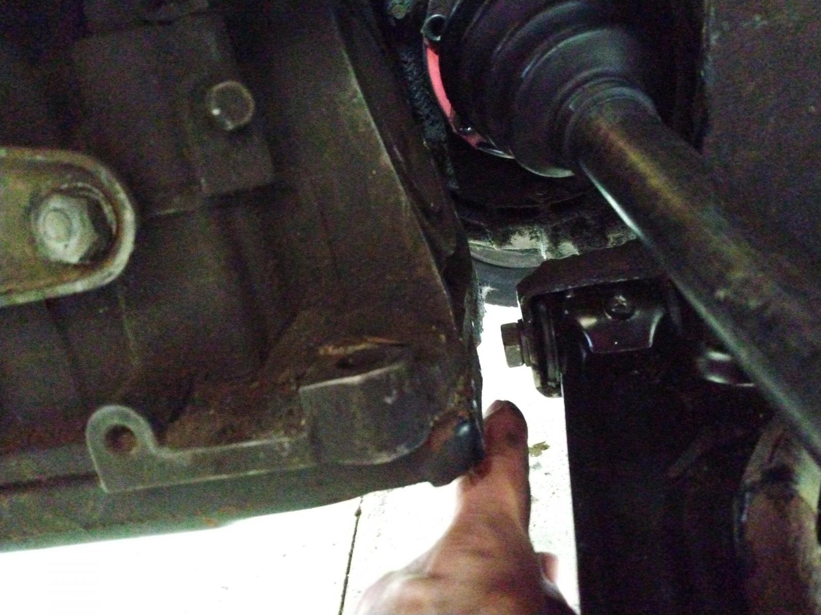

The bracket or tab on the front of the block that the bolt would screw into is broken and the bolt is missing for that reason. From the grunge on the face of the break it looks to have been gone for quite some time. From where I was, I could not see if it's an integral part of the block itself, or a bracket that is mounted to the block. The outer half of the ring with the threads through it is cracked off, leaving the inner portion of the circle, still with remnants of the threads. Here are some useless pictures pointing generally to the missing tab, which isn't visable both because of poor lighting, and because it's missing.
Eh?
I'll revisit that area when I have everything off to replace the timing belt at some point. Until then I just buttoned it up without that bolt.

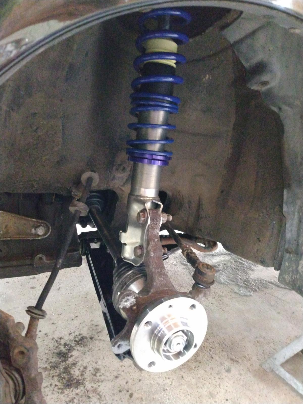

The front struts, and one of my front wheel bearings, were completely shot and it was much more cost effective to get a set of four adjustable struts for some reason so here we go...

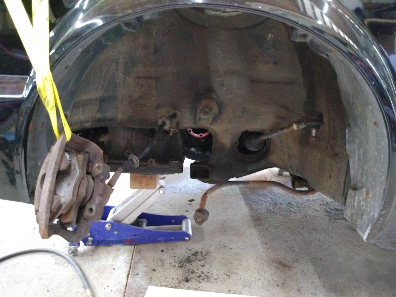

I've gotten the front done so far. While I was in there I replaced, on both sides:
    wheel bearings
    hubs
    strut tower bearings
    control arms
    rubber bushings for the control arms
    rubber bushings for the stabilizer bar
    complete axles with cv joints

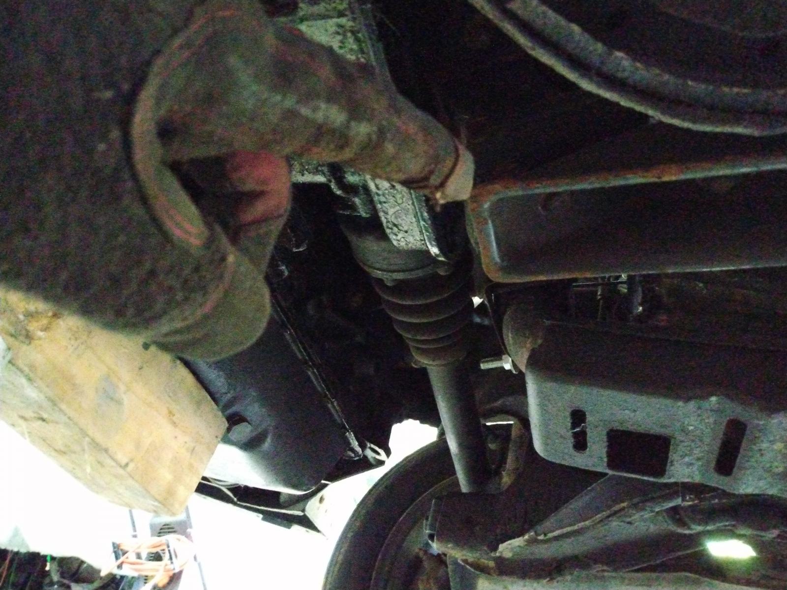

With an automatic transmission the driver's side control arm bolt is trapped by the transmission.
So the transmission and engine need to be raised a little bit with a floor jack to clear a path for the bolt.
The rear transaxle mount to the floor loses a nut.
The front engine mount to the bumper loses two bolts.
And the whole driver's side transaxle mount comes off the transaxle and the car.
The bolt is free.
You don't have to do any of that to replace the struts, just the control arm on a automatic car.
And the wheelwell is cleeeeeaaan. (metaphorically speaking)
Nobody in town had a shop press in stock so here I am hobbling together some jig with angle iron on my bench vice in order to pound out the old bearing with the Thor Hammer. The old bearing is destroyed upon removal, per Bentley.
The new bearing got pressed into the carrier with a ball-joint press/air impact gun and then pounded onto the new hub on the vice with the Thor Hammer (being careful to only persuade the outer race into the carrier, and the inner race onto the hub).
Here's everything in place.
And with the old brakes (still with much life, somebody has been in here before)

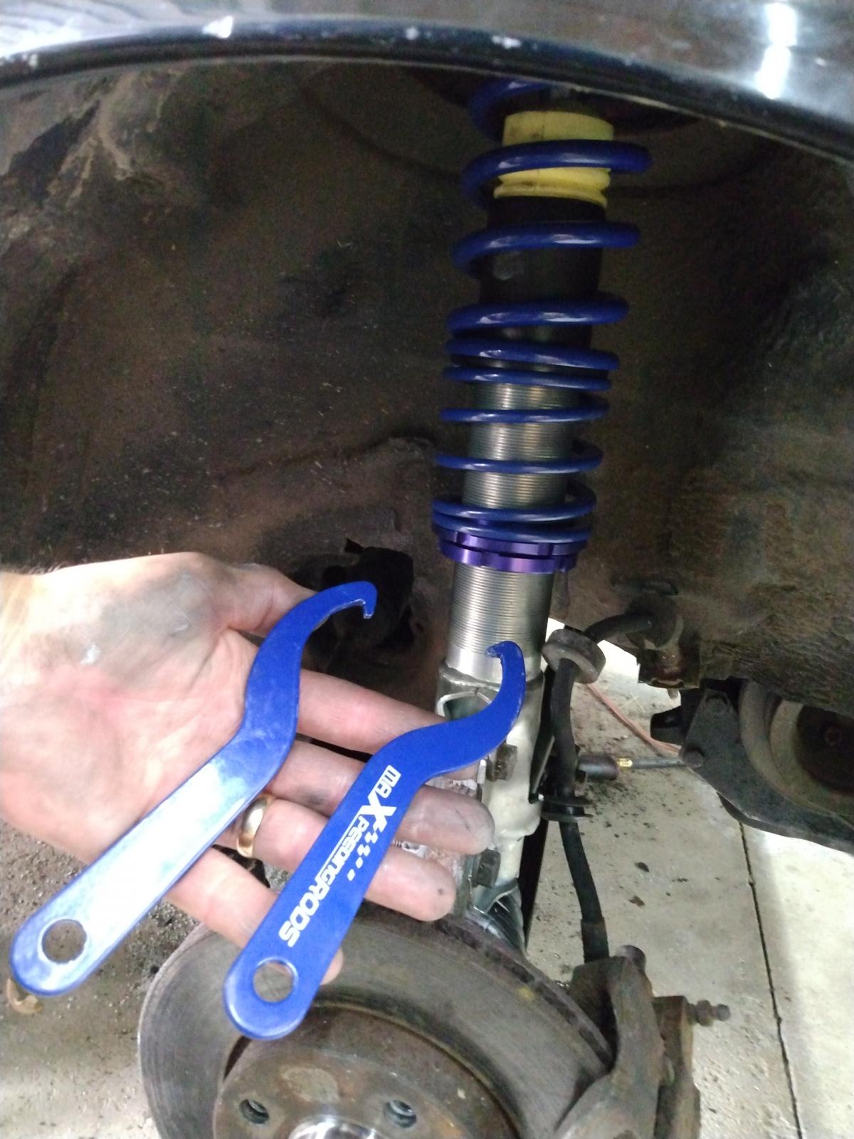

These adjustable struts do not have a bump for the cam to ride on, although there is room for camber movement in the hole, so setting the camber will be an adventure.
The struts came with these wrenches and they can be adjusted while the strut is still on the car, which is nice. Very Happy
I just guessed at a level for the adjustment and got lucky first try. I like the stance and nothing rubs! Cool
The car drives great, as far as front suspension is concerned! Tracks pretty straight for not yet getting the alignment, which it needs now.
