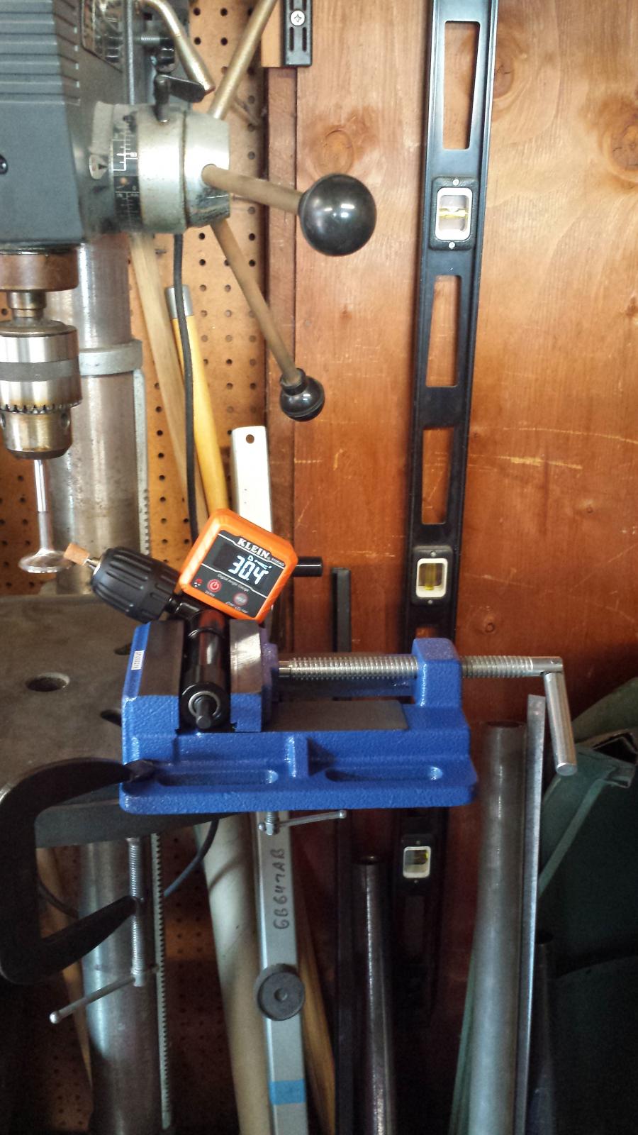

Here u go. Not hand held, actually clamped good in the jaws. No way for the dremel, lol. I may experiment swapping it around some , before i test it out. And i will need to figure out measuring the cut angle as the adaptor has a fair amount of play in the chuck. But i can compensate, if i know the cut angle.

Nice work. I am sure that will work well. May be a little slow, but should work fine. Valve grinders are quicker and are easier to get a consistent width of the back cut. However, with a bit of time and care, you can get good results with the set up you have.
I actually know a guy who reground his worn out R8 spindle taper in his Bridgeport mill by clamping a die grinder in his mill vice, angled the head to match the taper, then with the mill and die grinder running, fed the grinder into the spindle. Turned out great. He checked it with bluing and a good R8 arbor. Even blue coverage everywhere. Took his spindle runout from about 0.001” inches to about 0.0002. Not perfect, but probably better concentricity than most collets on the market today.
Just goes to show that you can get good results with basic tools, a little ingenuity, and patients. Wink

PostPosted: Sun Sep 04, 2022 8:26 am    Post subject: Re: The Machine Work Thread Reply with quote
My version of adding a DRO, lol. Very Happy

Your valve grinder setup is very far from optimum, but there are some good ideas in there too.
I like the idea of the valve held vertically, and using the angle meter. Very Happy

I don't think that angle attachment is gonna be fast enough to do grinding w/ that iddy-biddy stone. Maybe use a Dremel tool instead?
I can see a toolpost grinder bolted to the table and just swing it over to the valve to remove material. Maybe a 2-inch wheel?
For grinding, the chucking head only needs to spin very slow. But the grinder wheel needs to be spinning pretty fast if it is small diameter.

Thanks for the input. I was wondering about the speeds. Ive made a couple changes, so just waiting for some valves to try out

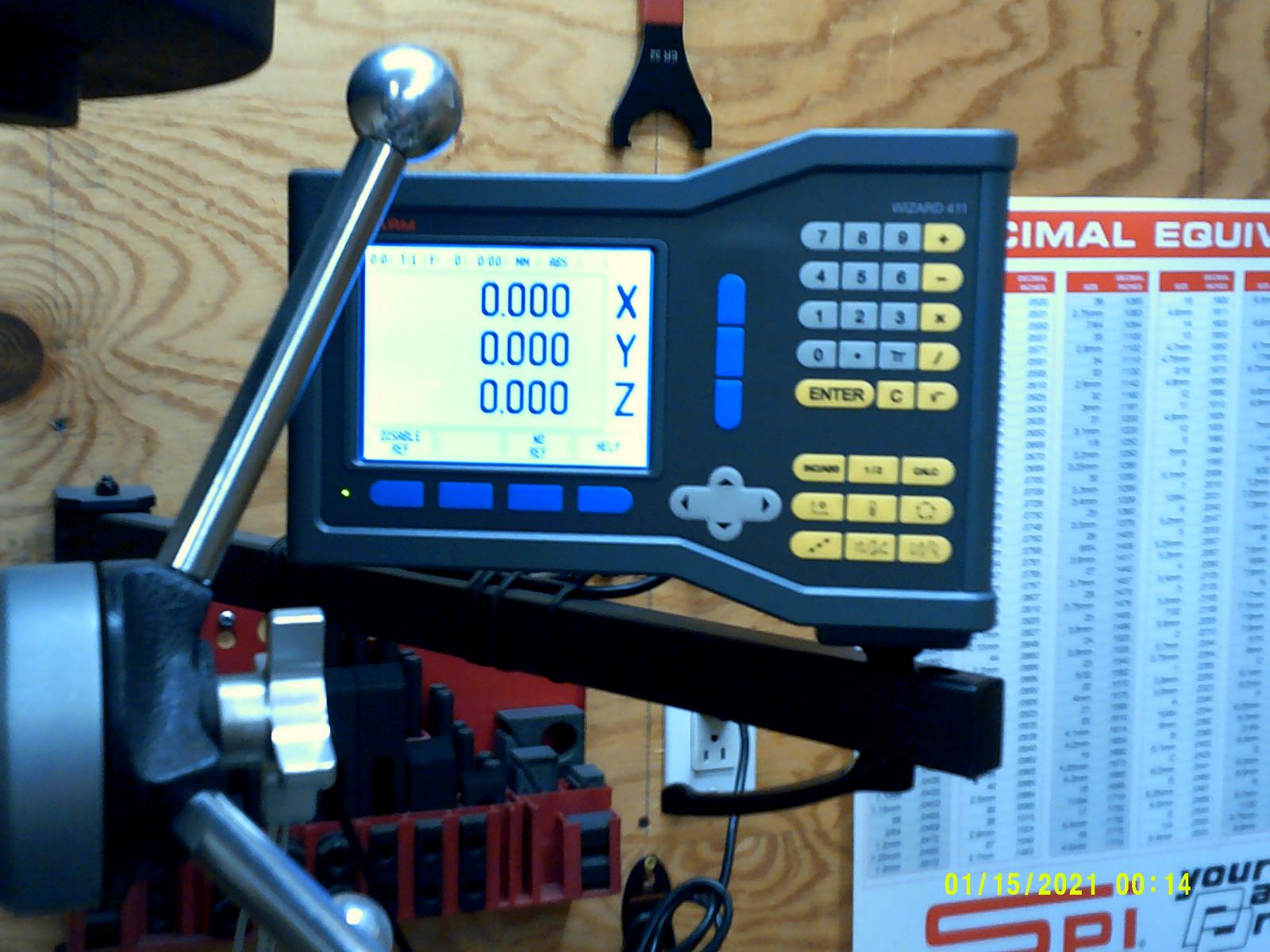

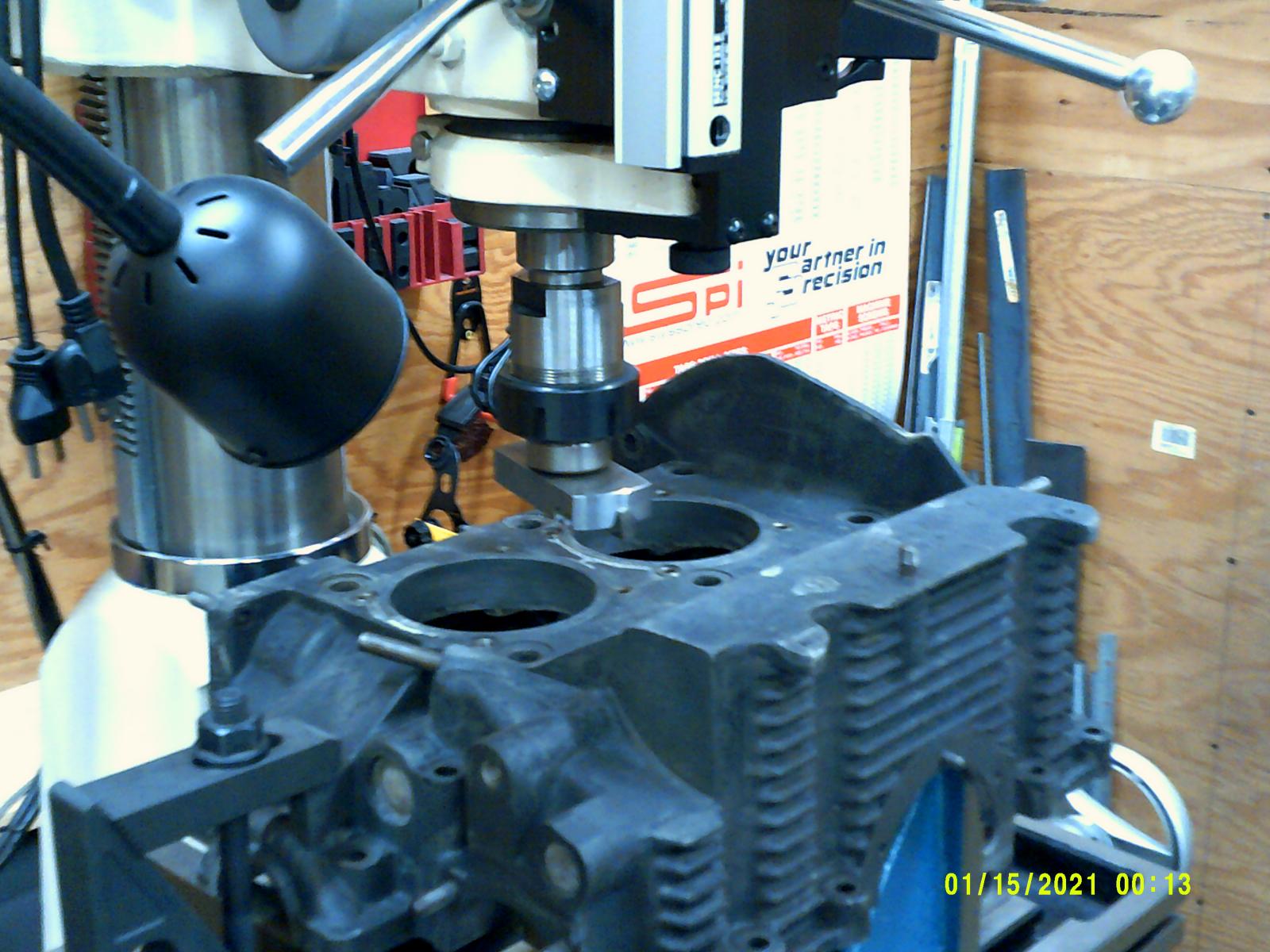

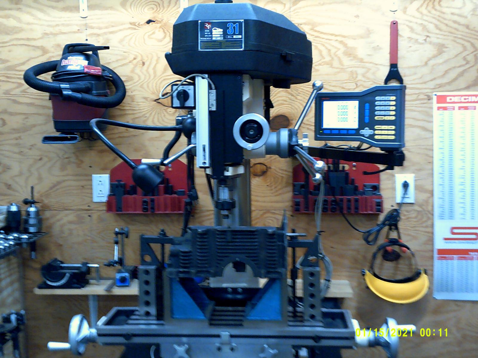

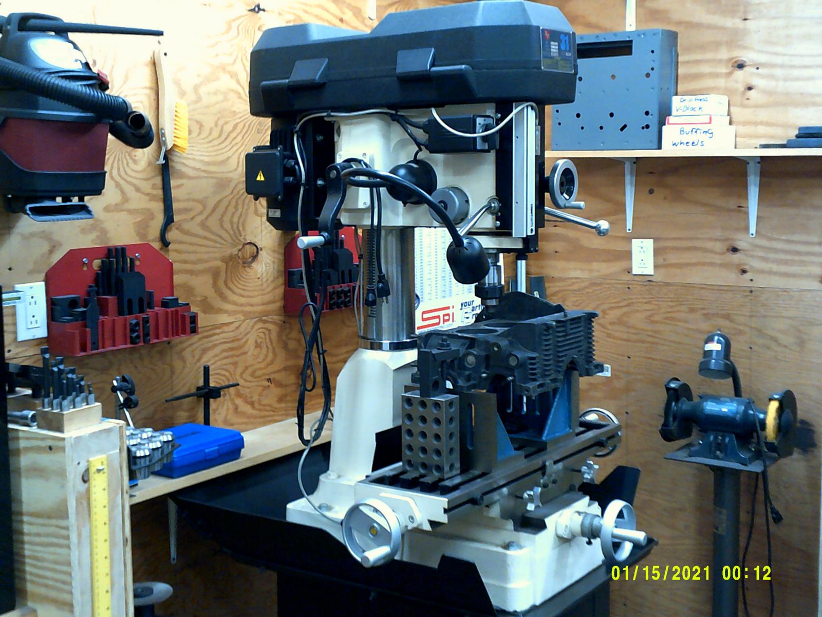

He are some pics of my Rung Fu RF-31 mill that I use to cut a case for bigger cylinders and to deck the case.

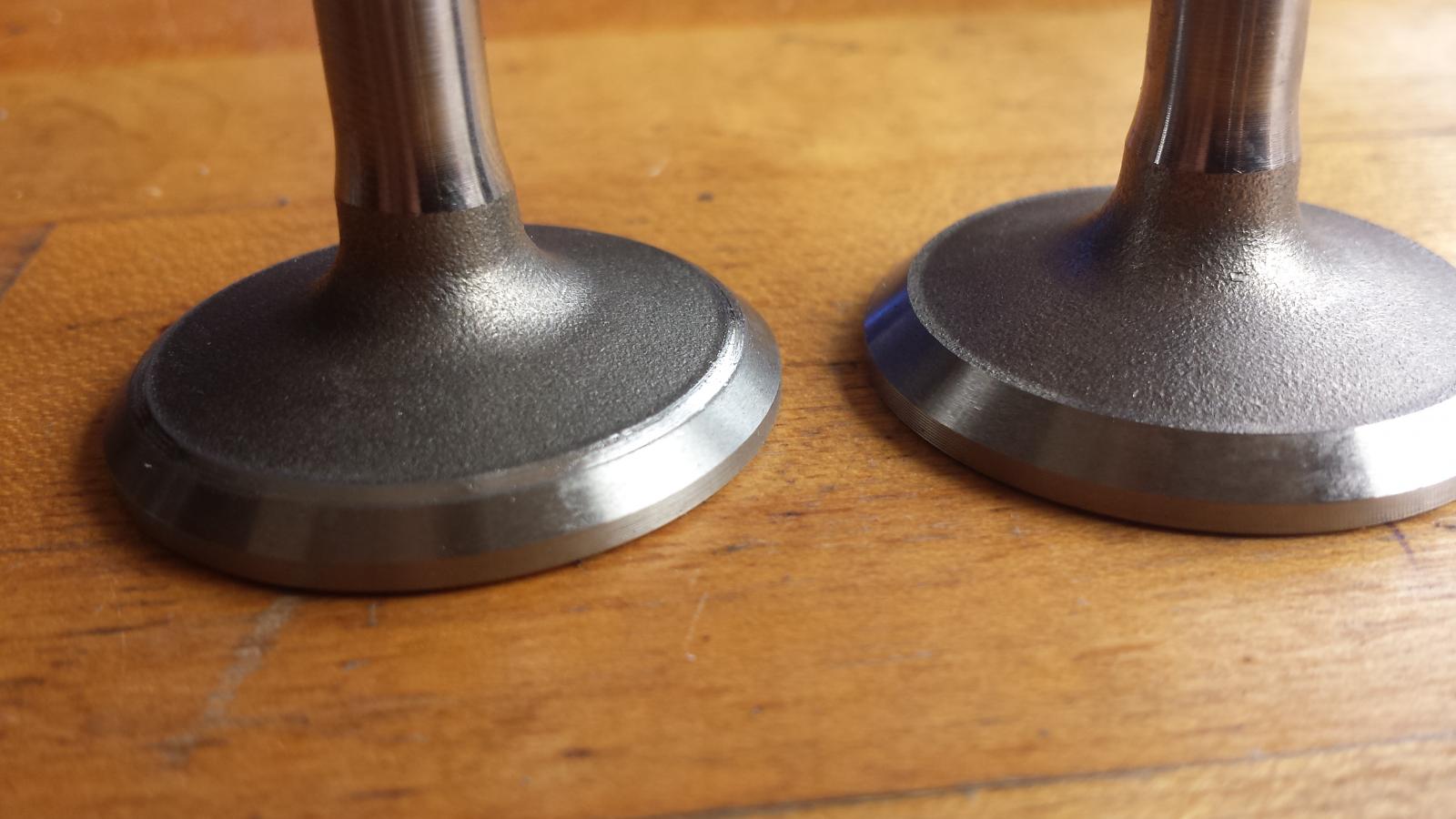

PostPosted: Thu Sep 08, 2022 2:42 pm    Post subject: Re: The Machine Work Thread Reply with quote
Well, My experiment to back cut valves didn’t go well. The stone does not leave a very smooth finish. I think its wobble in the spindle of the stone attachment tool
( right angle drill adaptor). My 30 degree angle seems right on tho
Cut on left, virgin on right
So next stop – machine stop. But hey, don’t know what will work until you try
The cut doesn't need to be super smooth. The valve isn't sealing anything there, just getting it out of the way of the air. I actually prefer them super rough, just like my ports. Laughing
Lap them to show where the seats land, and send them up here. I will roll out the 1930's Sioux valve facer, and toss a back cut on them for you.
Correct. You need precision bearings and a well dressed grinding wheel, and a better chuck too. Best way to learn is try
Nice!! This is super interesting. How did the case bores come out? Very nice way of mounting, but did having just 1 hold down on each side keep it tight enough?
Also, i see that you have the DRO installed, Is your DRO X axis slide reader on the back side of the table? Im curious how you mounted it.

PostPosted: Fri Sep 09, 2022 7:14 pm    Post subject: Re: The Machine Work Thread Reply with quote
Cylinder bores come out good. You have to keep the runout in the spindle bearings checked and adjust the cutters according. Yes one hold down on each side is plenty. The scale is on the back side of the X axis. The Rong Fu mill comes with the mounting holes tapped for this brand DRO it is a simple bolt on

Where do you buy those giant 1 x 2 x 3 blocks?
