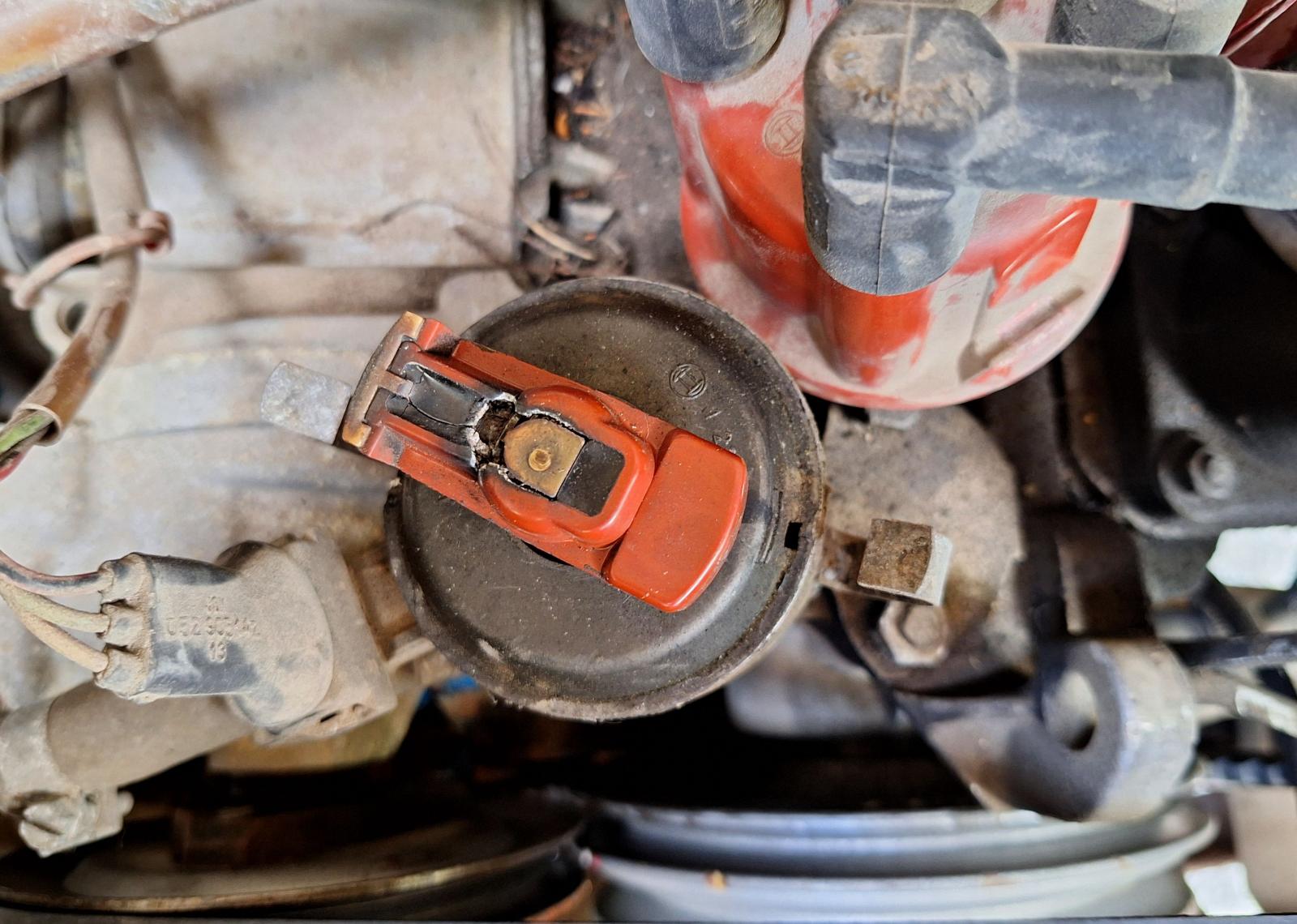

PostPosted: Mon Jun 10, 2024 5:52 pm    Post subject: Re: Sanchius in Hoosierland Reply with quote
Our guest husky, whom we've named "Cupcake" for her super sweet demeanor, and I spent a couple hours Sunday morning running all over town picking up supplies for some house projects.
I've really enjoyed that the van has been extremely reliable since the rebuild, always starting and running fine, even after being parked for long periods.
A half block from home, I blipped the throttle to downshift for a turn and the van shut off and wouldn't restart.
I coasted to a safe parking spot on the side of the road to figure out what was going on.
It would crank over strongly, but wouldn't ignite. The sudden and complete shutdown felt electrical in nature.
I opened up the back, connected my inductive timing light, pointed it at the drivers seat, then went up and and cranked it to check for spark. Nothing...
PROTIP: Keeping the timing light trigger zip-tied in the "on" position makes this remote operation easy.
I've had mine this way for 15 years and every time I use it, I think to myself, "That sure was a good idea."
Since I keep spares of common ignition problem items onboard, let's try some quick blind swaps.
I grabbed one of the two spare ignition switches I keep under the seat and swapped it in (~10 seconds). No joy...
I swapped in the spare computer (~1 minute). Nope...
It was a warm day, so I swapped in a spare coil (~3 minutes). Still no fire...
I popped the distributor cap to check that the rotor was rotating and the problem was evident; a burnt up rotor.
I thought I had a spare full distributor onboard, but couldn't find it. Grrrrrrrr
We were very lucky that this happened so close to home. Cupcake and I walked back to the house, found a spare rotor in one of the parts boxes, and walked back to install it.
But, to my shock, the van still didn't start. ?????
I opened the distributor cap and saw that the rotor I had just installed was now burnt up too, exactly like the first rotor. Cr*p, I just destroyed my spare and didn't have a clue what just happened.
I looked closer and figured out it looked TOO much like the original burnt rotor and there was no smell of burnt plastic. Strange.
I fished the other rotor out of my pocket and it was pristine.
In my haste and confidence that I'd found the solution, I'd installed the wrong rotor. Once I put the right rotor in, it started right up.
I didn't remember seeing burnt rotors documented on TheSamba/Vanagons, but as usual, a few minutes with advanced search turned up something similar: https://www.thesamba.com/vw/forum/viewtopic.php?p=9571931#9571931
My rotor was not Bosch, but had the distinctive three circles molding marks like on the dead lower rotor in this picture from the link above:
Two new Bosch rotors & caps have been ordered and when I get some time, I'll see if there's too much vertical play in the distributor shaft.

PostPosted: Mon Jun 10, 2024 6:21 pm    Post subject: Re: Sanchius in Hoosierland Reply with quote
really interesting rotor pictures! the rotor has a 5k ohm resistor that obviously is not as robust as a solid brass link. to that end and wanting the hottest spark possible, i bridged the carbon link in my rotor with some solder to make a zero ohm rotor instead of 5k. no noticeable driving difference but i FEEL better.
but again, cool. i've never seen a rotor burn up mid-stream.
-dan
