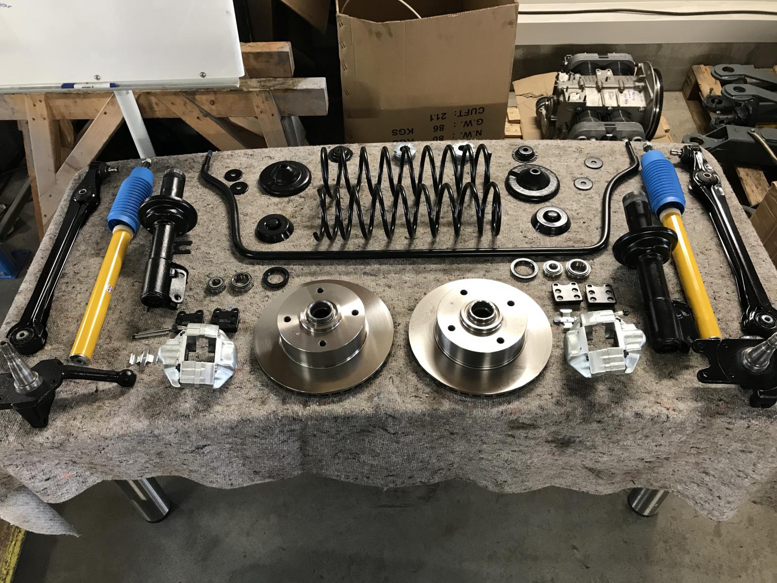

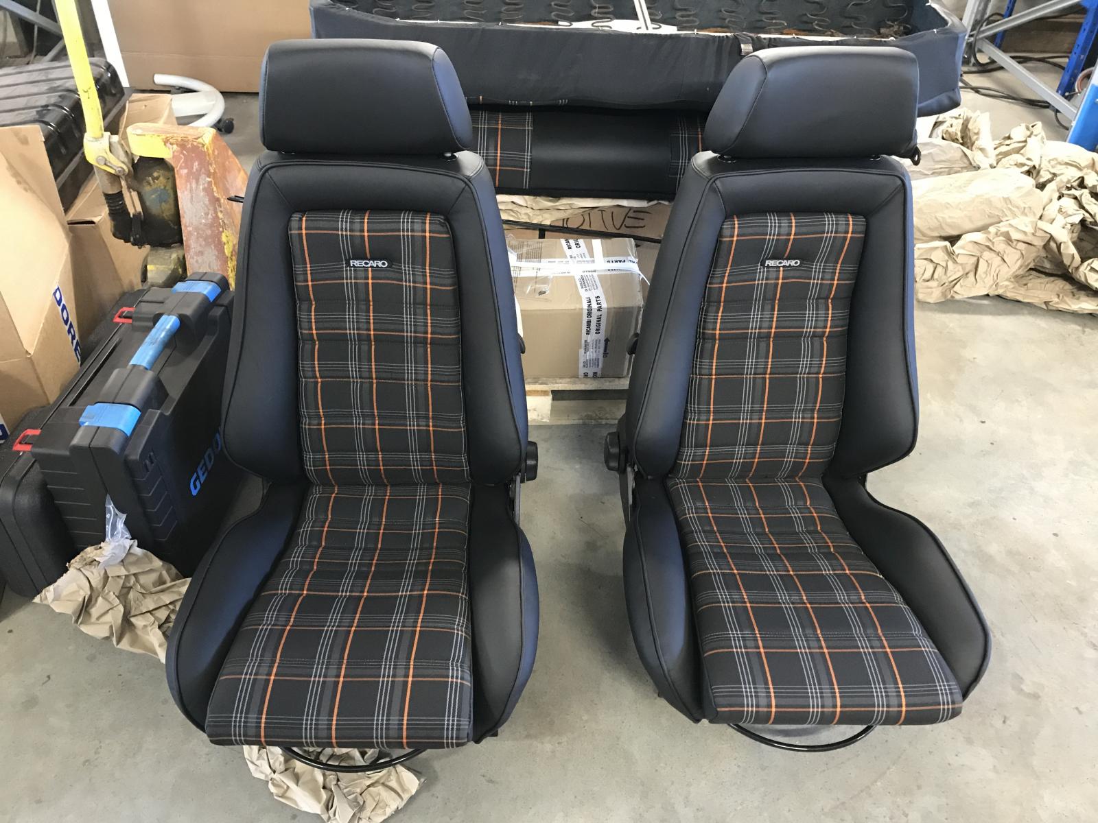

next few steps.....we put recaro seats in it, uppolstery in real leather with karo style cloth.

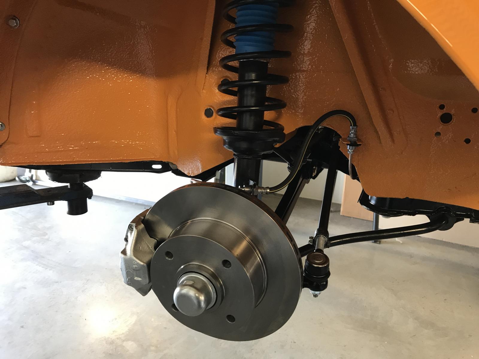

Front axle parts are blasted and painted with new Bilstein shocks, CSP front disc break kit

PostPosted: Fri Feb 09, 2024 10:52 am    Post subject: Re: German "Hazard Streaker" Baja Reply with quote
Headlights and indicators are installed
Gearbox and the rest of rear axle is ready

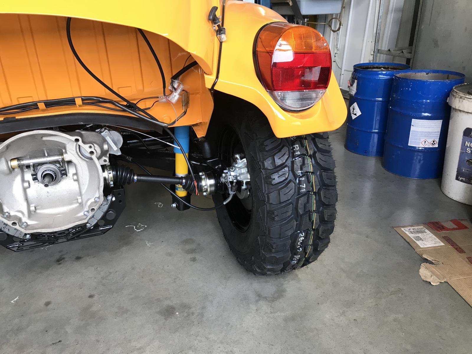

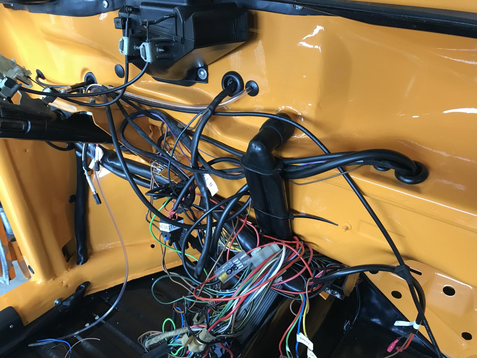

Cables for engine and rear lights installed. Fucking shit, the new rubber for the ball joint is cracked
Front breaks from CSP installed, stearing is completed, now we can roll it first time
Rear windows and side bars mounted... what do you think, will the tires fit?

electric is gettin ready. we put extra cables for oil pressure, oil temperature and tachometer on it.
the heating parts are installed, the gas tank and wiper motor is ready.

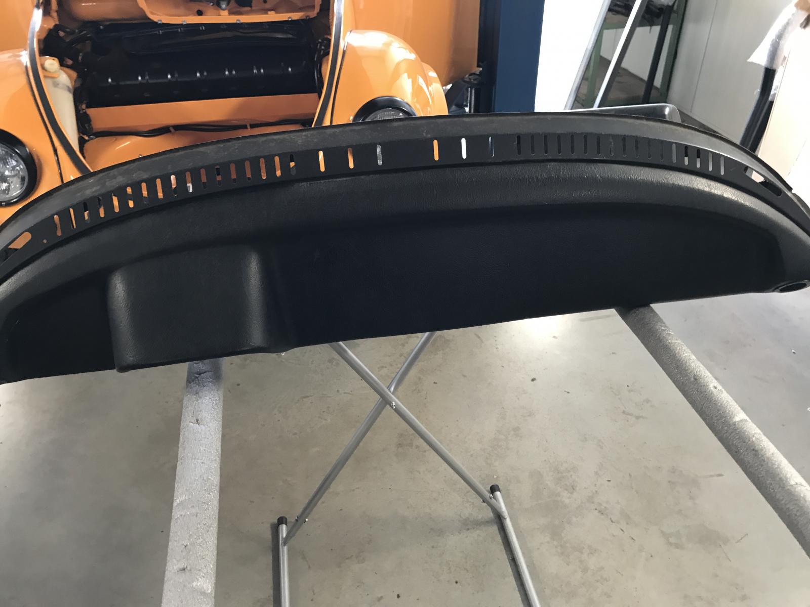

Dashboard ready to install... front hood seal is mounted.

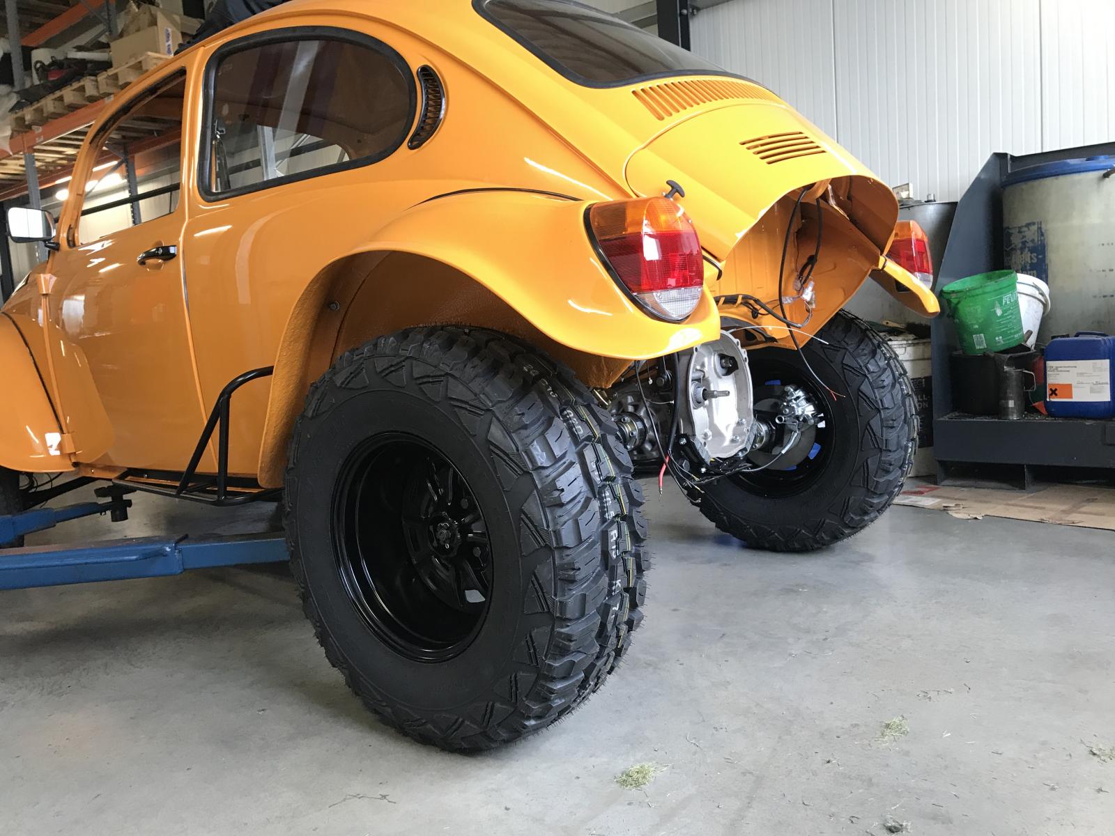

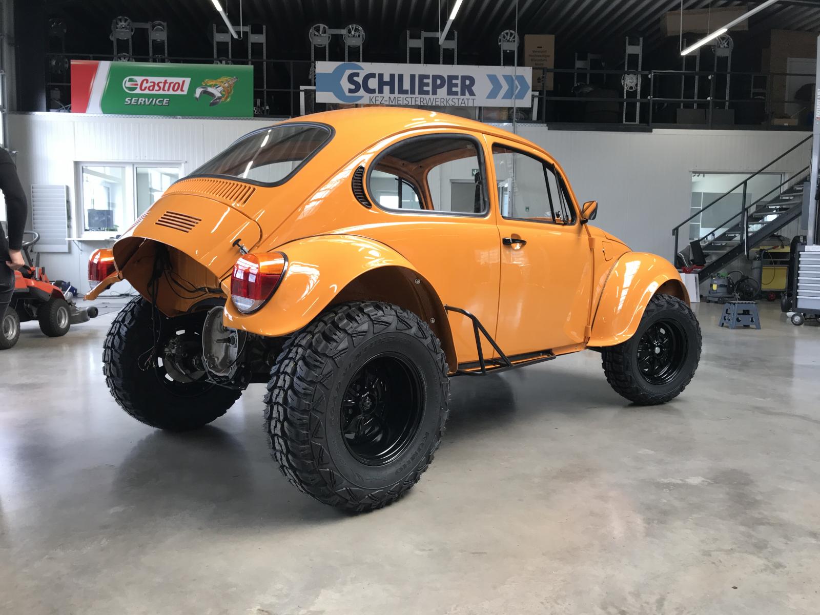

doors get windows in it and yes yes yes.... we put the new tires on the coated rimes....
after putting 20mm spacers on it it fits perfectly!!! What do you think, isn´t it great?

Can you share details about the amount of lift in the rear, and about the tire size? Thank you.

Rimes:
front 5,5jx15 Lemmerz Stahlsportfelgen with 195-15 Kumho tires
rear 8jx15 Lemmerz Stahlsportfelgen with 31x10,5 Kumho tires
i dont know the exactly measurements at this moment because we changed it a lot of times, but i think latest we put it up to 12cm in the rear

This is looking really good. I had the same problem with tie rod end boots cracking Before even finishing my rebuild.

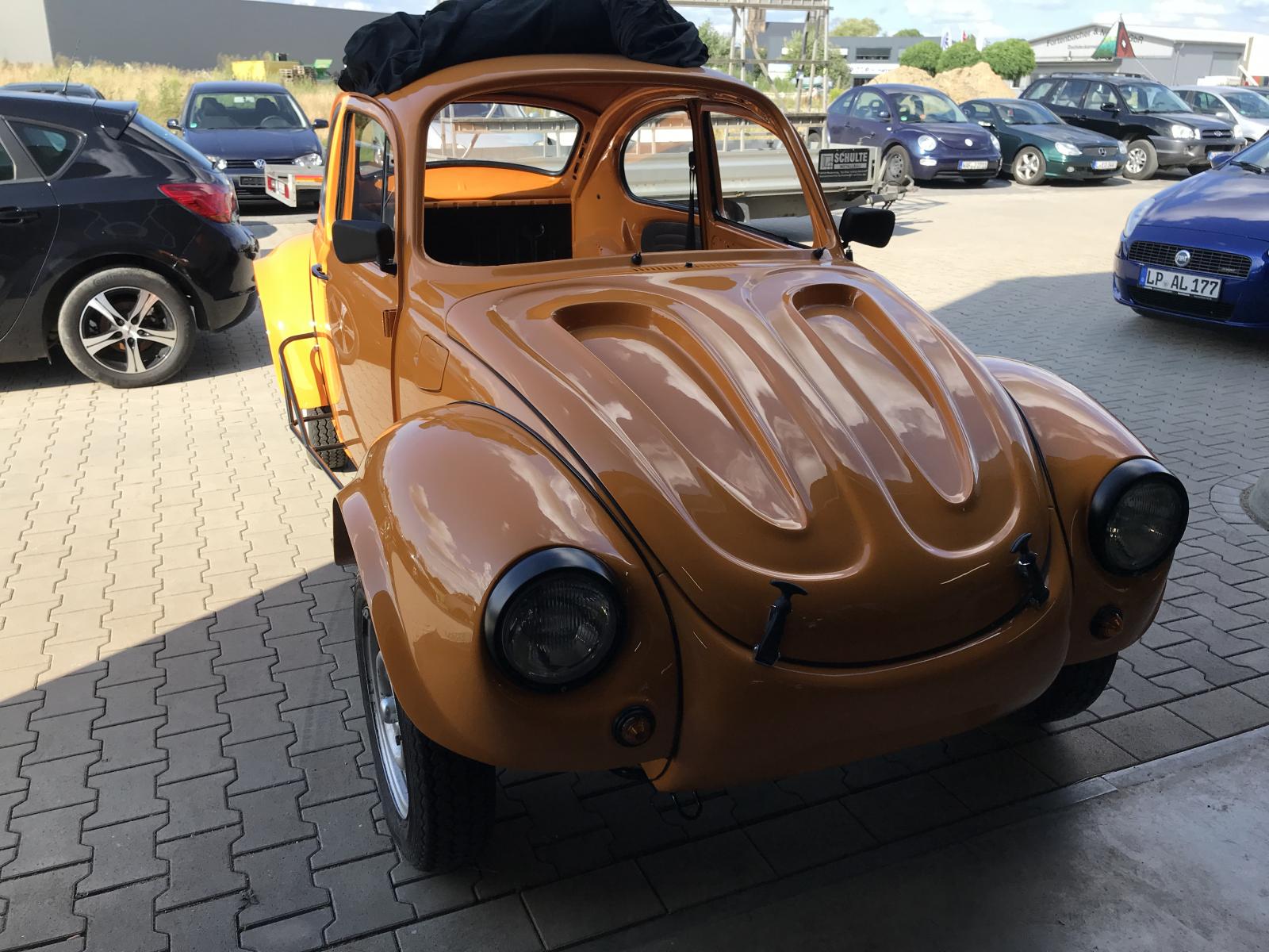

the car gets a new sky!
