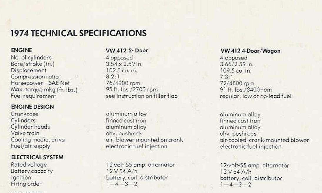

nothing is incorrect in the owners manual of the 1974 USA market 412 i posted.
here is the Volkswagen of America sales brochure for the USA market 412.
this information checks against the owners manual for 1974 412s.
it is only for the last year of 1974 that 2 door with the 4 speed still coupled to the 1.7 D-Jet is restricted to the 49 states of USA.
the reason is simple. the continental United States operated a two tier structure during the introduction of emissions regulations in the early 1970s. California introduced a set of emissions standards on year in advance of the remaining 49 states. This rolled on to the next year the same way and so on. until quite recently. California emissions standards were set by CARB, the California Air Resources Board. 49 states were set by USEPA. cars were separately certified by CARB.
in 1974 it worked like this.
Californian cars were certified to 1974 CARB emissions standards.
49 State Cars were certified to 1974 USEPA standards (= 1973 CARB standards)
that is why the 1974 2 door 412 with manual transmission remained only for sale in the 49 states.
additionally the breakdown of the engine types for the USA market was more subtle than the engine numbering and types you list.
eg. in 1974 for the 412 1.8 L jet it broke down into two types of engines.
the EC-D for california and the EC-C for 49 states.
and for the 914 the 1.8 L jet broke down into two types of engines.
the EC-B for 49 states and the EC-A for california.
our research tracked down the CARB documentation for 914s from 1971 through to 1976. additionally we had 80 examples of 1974 1.8s on our files with information linking emissions stickers, tune up stickers, engine stencil numbers, points of original sale. the 412 certification is on the same documents as the 914. all there to read. lists only the wagon (variant) and the 4 door (sedan).
the documentation published by most sources glosses over this.
the EC engine in the 914s and the 412s was not USEPA and california certified.
ie universal to the whole market. it broke down into two sub classes.
the differences in the engine were small and in the case of the 914 amounted to connecting both the retard and advance hoses on the distributor double vac can to the throttle body for the EC-B engine. in the case of the EC-A engine the advance hose was disconnected. the engines were certified separately. the EC-A could be sold USA wide as it exceeded USEPA standards, the EC-B could only be sold in the 49 states. they had distinct and different emissions stickers in the engine bay with the certification limitations.
main point is the 412 2 door manual was not a grey market car in the USA and Canada. it was available in all regions until the end of 1973. it was restricted in the last year of life to not being available in california.
during 1975 the EC engines in the 914 continued to be distinguished as two different engines with distinct certification. the californian engines had EGR and catylists fitted. the 49 states cars were identical to the 1974 californian engines
i do not know the reason why VW chose not to make a version of the 2 door 412 for sale in california that met emissions standards. i suspect it had something to do with sales numbers. instead they chose to let it soldier on for its last year with a restriction not for sale in california. there is a loophole there that VW also exploited for the last year of the 914, the 1976. technically the 1976 914 did not meet california emissions standards. however manufacture ceased before jan 01 1976. this let it be certified as a 1975 model standard.
if you look closely at the specs for the 1974 412 2 door you can see it was not in fact meeting 1973 californian standards which you would expect for a 1974 49 states car. if it did its rated horsepower would have been 72 hp as per the 1973 california 412 with the EB engine. instead it has 80 hp and is the EA engine.
i think VW pulled the same trick. all the 1974 412 2 doors were built before jan 01 1974 and certified by the USEPA as equal to 1973 standards and restricted to sale in 49 states? a case of running out the model and stocks of engines and calling an end to it? Sad
and of course 50 years down the track with cars scattered all over the USA and dealers and mechanics who once worked on the cars long retired or passed away no one really knows the ins and outs of it any more.
all the information regarding the L-jet 914s has only recently come to light.
like the 412 the 1.8 914 has been long neglected as the least desirable of all the 914s and any reliable information concerning them has been thin on the ground.
regarding horsepower figures quoted in literature.
bear in mind that in 1973.74 the standard measures for horsepower quoted in the USA are transitioning. from SAE measures. i can't quite remember how it goes but there was two ways of measuring horsepower.
for instance the 74 914 1.8 is variously quoted at either 76h or 72/73 hp depending on the source of the literature. german or UK or USA.
similarly i have seen two figures quoted for the 73 EB calif engine as either 72 or 69. and also for the 75 and 76 2.0. so figures quoted for the 74 412 can also vary depending on whether SAE or the other measure being applied.

Thank you again for all your interesting and detailed information.
Based on the theory of 2 different measuring methodes around 1973, 74 which makes an EA to 76 hp, an EC to 72 hp and an EB to 69 hp, all given info make sense.
The newer method brings a loss of 3 or 4 hp.
Maybe a different altitude or outside temperature of the measuring location can also cause a difference in hp. (compared to german DIN hp)

no - wasn't me that pointed out a 2 door auto was available.
everything i have ever come across says manual box only.
re the official availability of 2 door 411/412 in USA market.
i confess all my research instigated by the 1.8 L jet 914s in relation to the VW type 4 concentrated on the 412 of 1973 and particularly 1974.
i always take someones views seriously re raygreenwood stating no fastbacks ni North America ---last night i dug into sales literature of the VW 411 which i have not really ever looked at. i concentrated only on the 412 with the 914 research (and even with 914s it was all around the 1974 75 models). everything i found says that only the 411 4 door and 2 door variant were available in the USA market from 1971 to 72. the years the 411 was sold there.
and.......with the 412, VW of North America started offering the 2 door fastback.
it looks like that is how it went.
the 411 was sold exclusively as the variant and the 4 door only in USA up to 1972MY
the 412 was offered as the full range of variant, 4 door and 2 door. with manual box in the 2 door fastback and auto box only in the 4 door and variant for 1973 and 1974 MY. with the fastback restricted from sale in california in 1974.
Djet engines across all the models of 412 in 1973.
L jet engines in the variant and the 4 door in 1974.
with the curious anomaly of the Djet 1.7 in the 2 door only in 1974.
i extracted this info from the archives section of this website looking into the sales brochures. i had never looked at the 411 sales brochures.

here is two documents i found last night looking into archive section of this website. this material was in addition to the VW of North America printed sales brochures.
kind of clears up the mystery of the two door fastback in north america.
was only ever a 412, never the 411.
