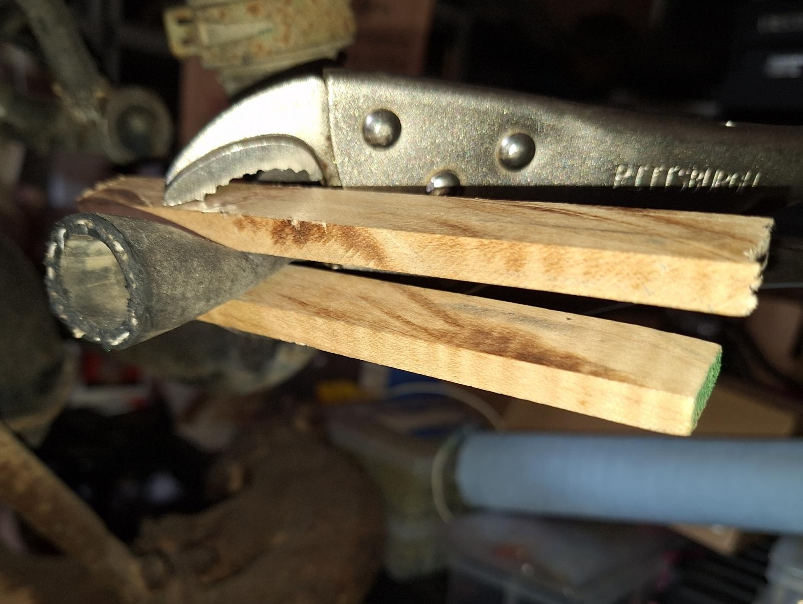

Alternatively- you can use two pieces of wood clamped onto a hose with a vise grips to close off a hose.
