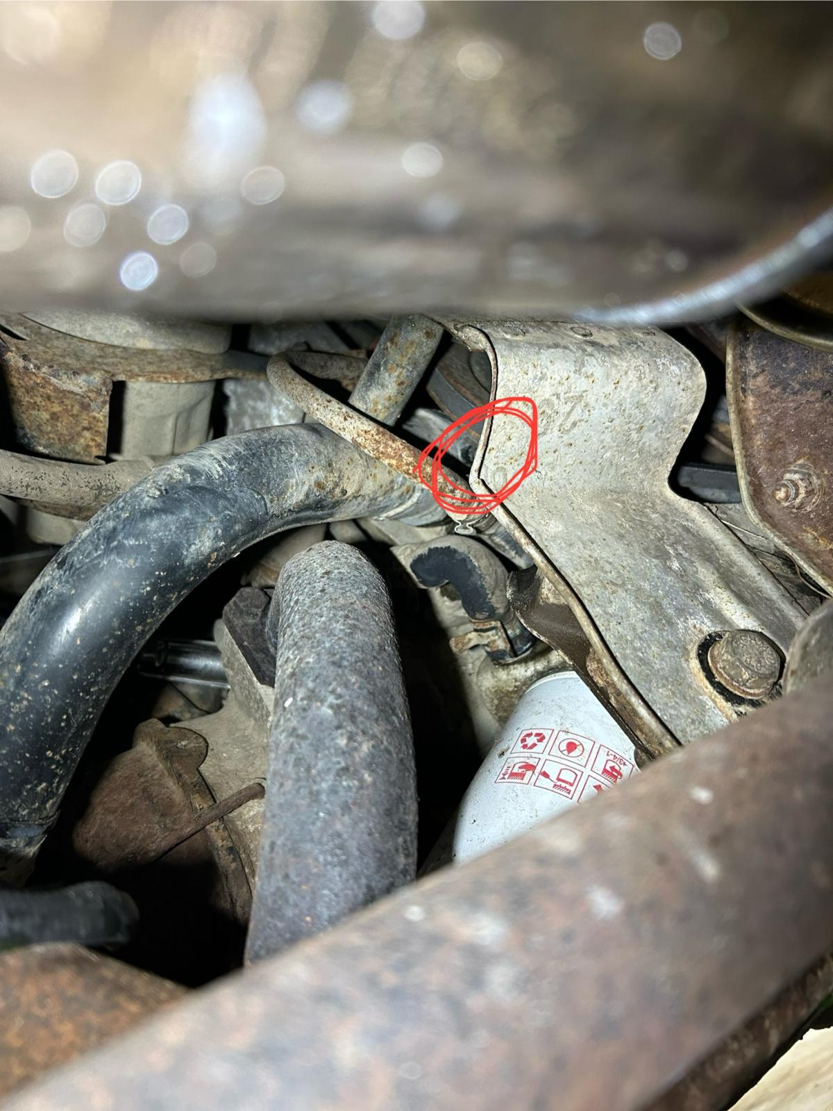

I think the plug in your hand is for the cruise control pump, does the van have a cruise control signal lever?
Ah, that would make sense, I don’t have cruise control so nothing goes into it. Would it be hard to add it?

PostPosted: Mon Feb 10, 2025 2:47 pm    Post subject: Re: A 1991 Syncro L Single knob “Rome” rebuild Reply with quote
Ceckert64 wrote:
Actually it's fairly complicated. I stripped almost all of it except the turn signal/cruise control stalk from my Syncro. There are several harnesses, control module, valves, pipes/hoses, vacuum pump, and hookups.
I have all the bits in box (PM me if interested in buying)(EDIT, Sorry sold) but without the stalk not sure how you would be able to control. Would need a stalk from a parted out bus.
The cruise/turn signal stalk does not interchange with the non-cruise stalk on the steering column hub (would need that also) so I had to keep.
There are some aftermarket units that may be easier.

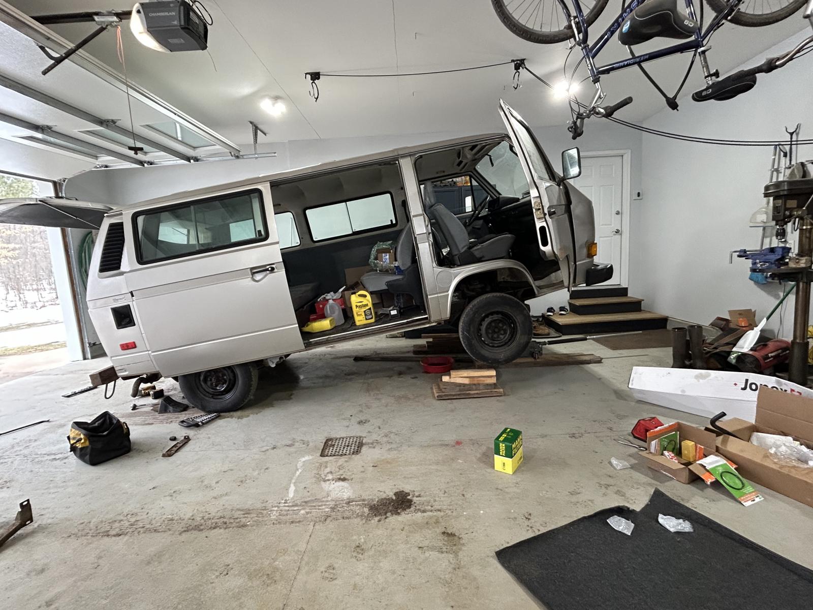

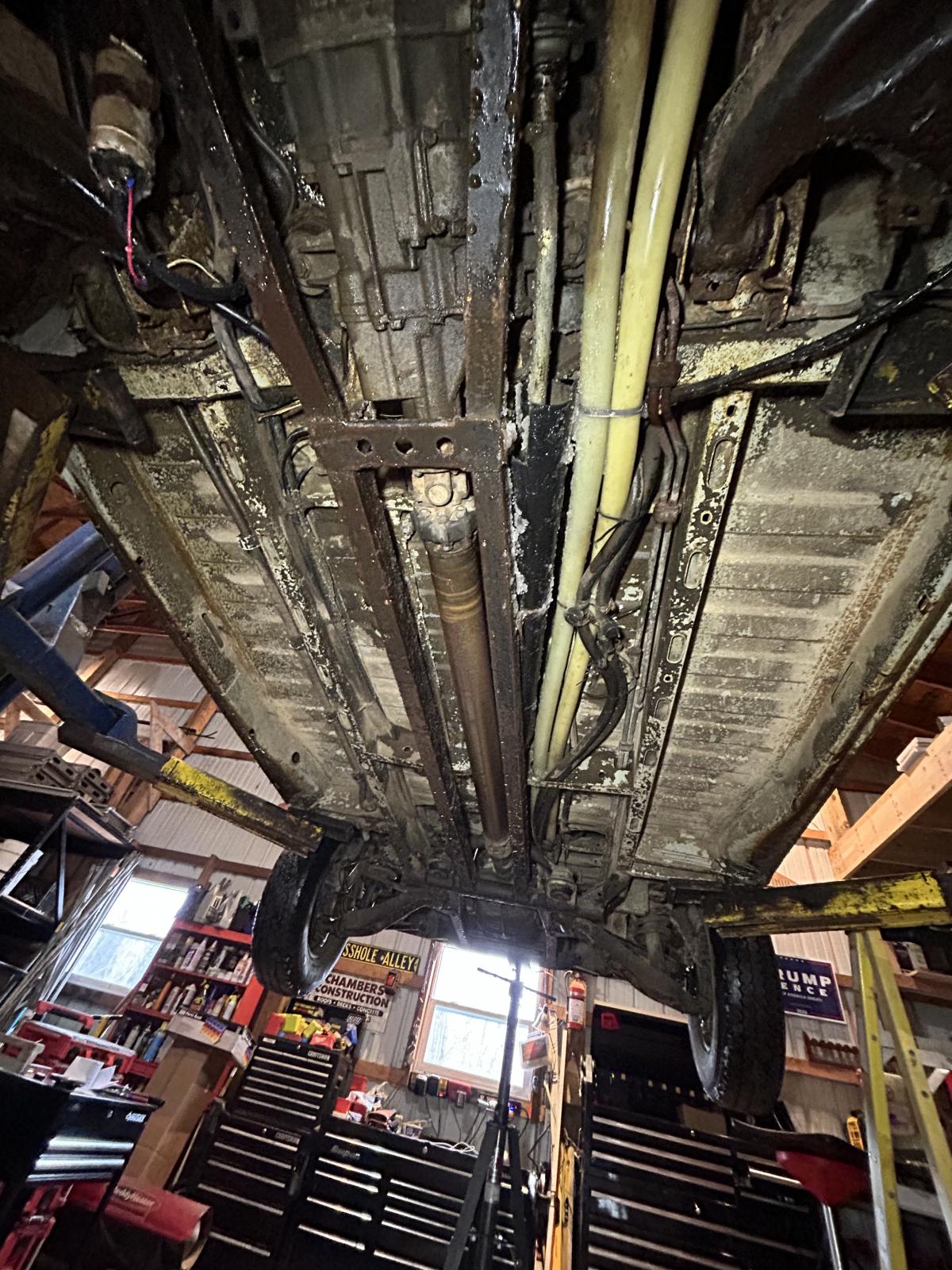

I got back from school on spring break and got to work. I started yesterday on the coolant system and the exhaust. I got the stainless steel coolant lines and new rubber hoses. I replaced the plastic junction piece and I found the holes in it, it was strange how it broke. I found the main coolant line had failed too. It looked like after the brass part came out a bit, they reclamped it on the brass part.
I also started to replace the soft brake hoses, all the hard lines are in good shape, no rust on them. My plan is replace those and rebleed the brakes.
The current plan is to drive it back up to school at the end of the week. I have to finish up the brakes tomorrow, replace the CV boot, bleed the coolant, replace fuel injectors and change gear oil to get it all ready. It seems like it may be possible Laughing
Thanks to my friend for letting me use his lift. It makes life a lot easier :

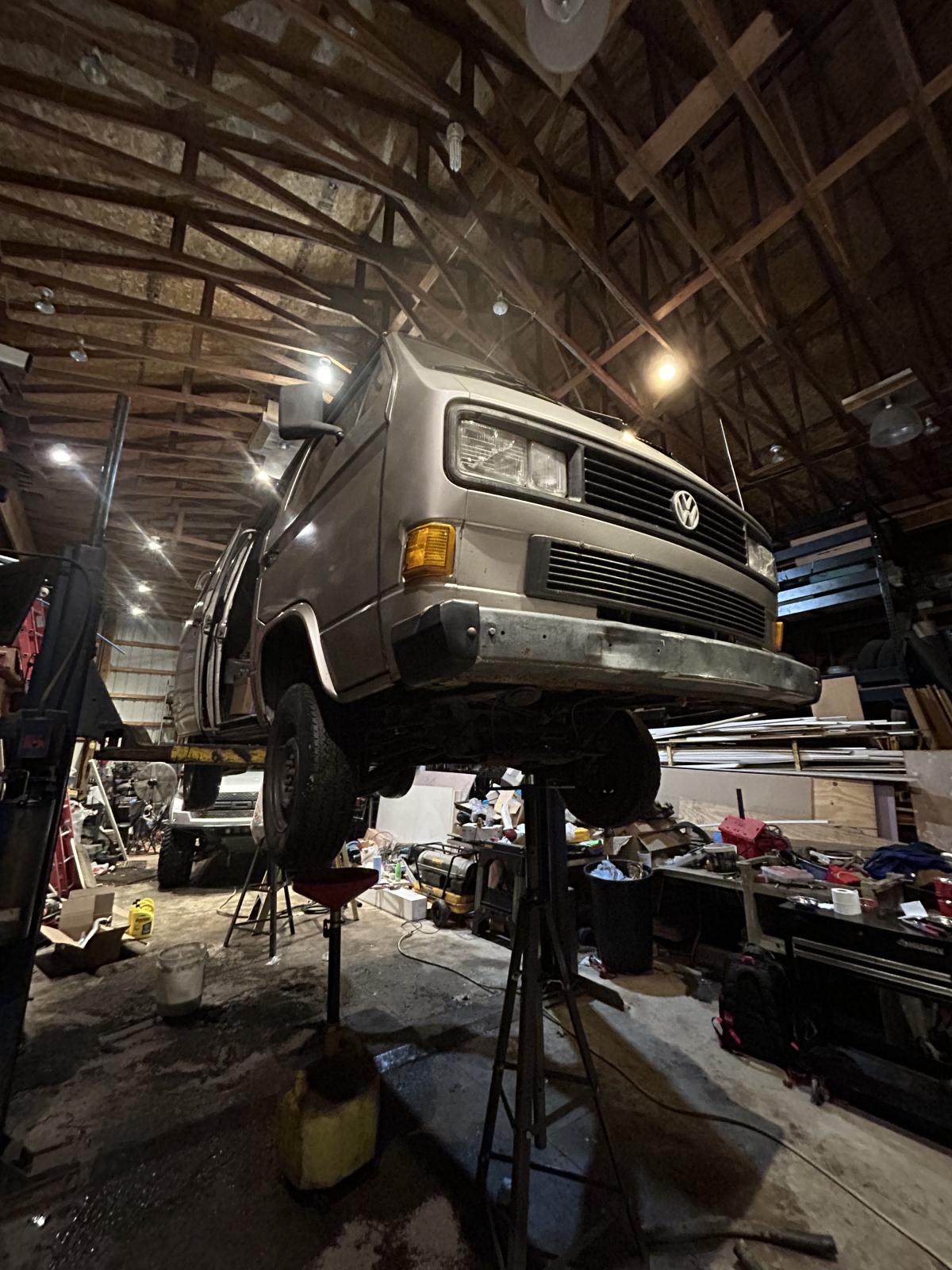

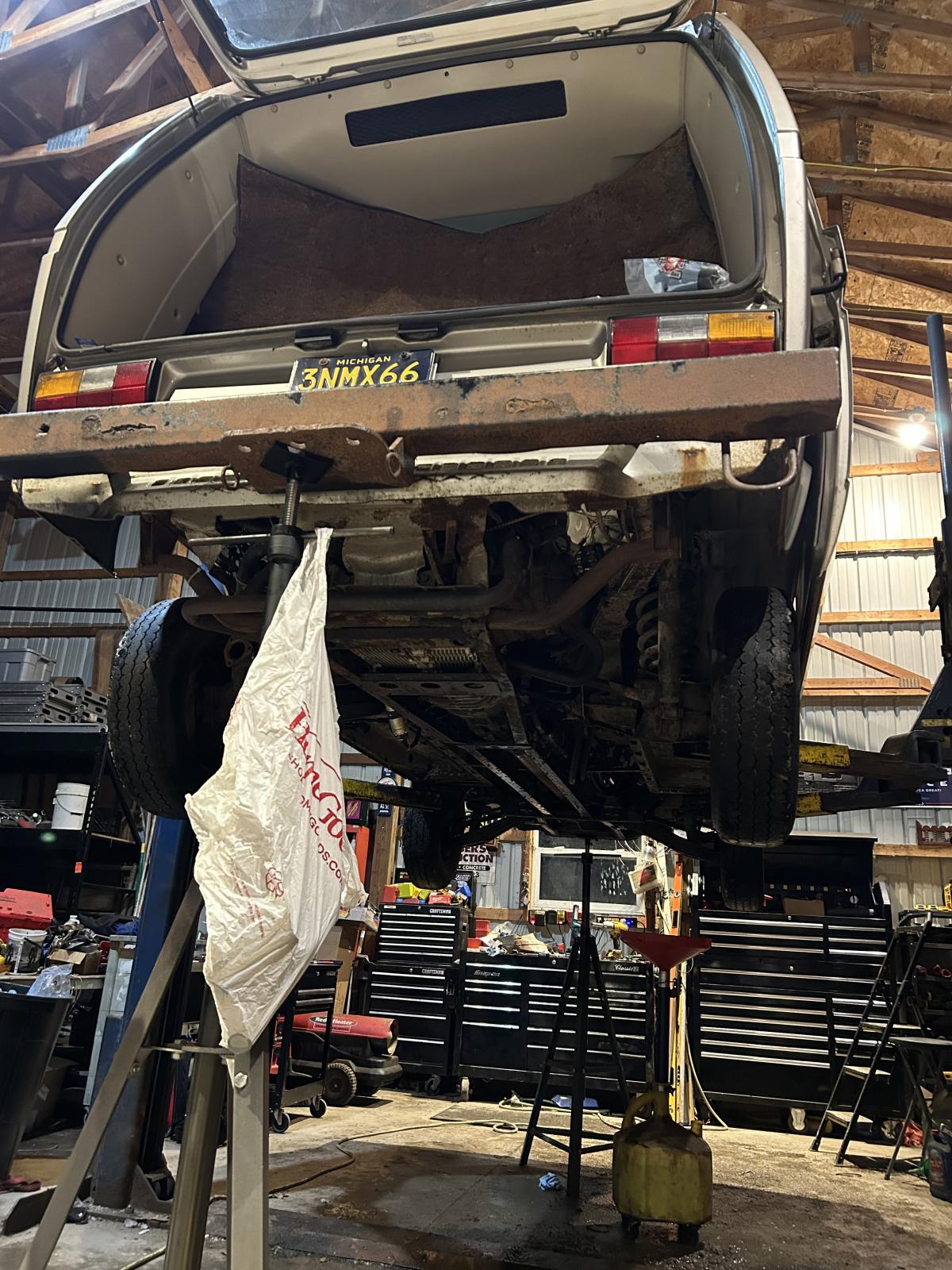

PostPosted: Wed Feb 26, 2025 5:06 pm    Post subject: Re: A 1991 Syncro L Single knob “Rome” rebuild Reply with quote

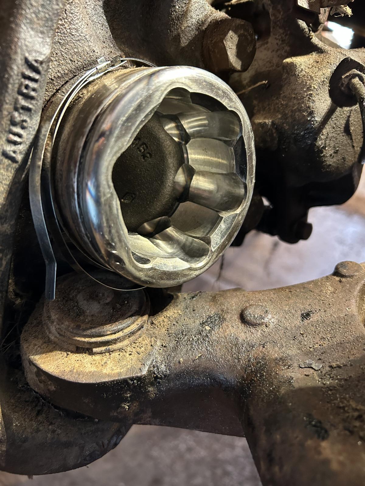

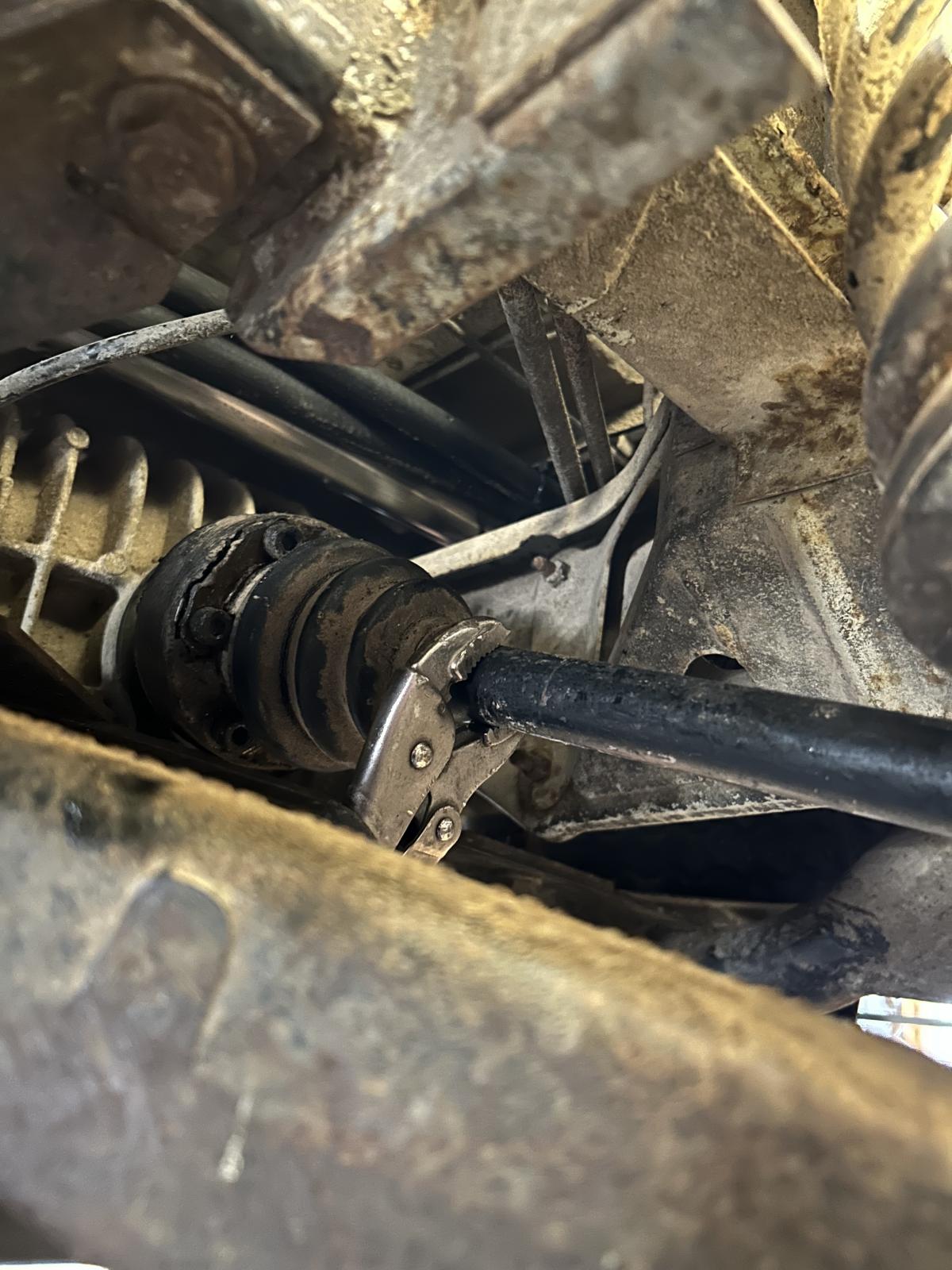

Yesterday I got the CV joint done with a new boot and regreasing it. The trick I found that works for in the car is shove a bolt with a 10mm head inbetween the clip tangs and then use a pair of vise grips to pound on. I got it out without removing the axle stub as I read that it can screw up the bearing if you take it out wrong.
Then I got all the soft brake hoses replaced and rebled the brakes. All seems good there. The biggest issue is the brake light switch is stuck on so the brake lights are always on. That will get replacement soon.
Today I put in the rebuilt fuel injectors, a new fuel filter and did the great oil change. The gear oil was something Shocked Evil or Very Mad The oil did look too bad but that job is such a pain. Between getting the skid plate off and working to get drain plugs out in tight spot and raising the van up to fully drain it Shocked but it now has swepco 202 in it so it should be happy. Here are the drain plugs. The front diff on I had already cleaned off in the picture and the transmission one had the “fuzz” on it.
Then I took it for a longer test drive, it was perfect to start, ran smooth and had good power. It was driving smooth and felt great. I stopped and got gas and when I took off again it started to act up. It would bog if I gave it too much gas and started to seem to miss at higher rpm. I couldn’t get it to go much over 40-45 and then it’d want to bog. Any thoughts on the issues? Fuel related? AFM? I got back and it seems to rev up fine but the issue seems to be under load so I’m thinking maybe fuel starvation when it’s needing more gas and runs out?
I also found the power steering pump is leaking bad and there is a bad coolant leak by the water pump. I looked and realized that one of the bolts holding the pipe on was missing. That’d cause a leak Laughing

Did you replace your temp2 sensor? AFM and DME are two other causes. You already took care of the fuel filter.
Interesting way to service the front axles, by leaving it in the strut. I suppose that saves some headache and introduces a few others. I don't think you can damage the bearing by removing it, but you will absolutely wreck the wheel bearing by driving with the front axle removed. Although, if you leave the stub in like you had you can drive it that way.
I have not replaced that yet, but I did buy a replacement one for a spare so I’ll give that a try, thanks for the suggestion!
Yeah, it definitely made it a little harder to get out. I was on my friends lift so I could be under it which helped. If I had it sitting on the ground I’d definitely not recommend it. That makes more sense on the wheel bearing. I had just done some quick reading on it so I probably read it wrong.

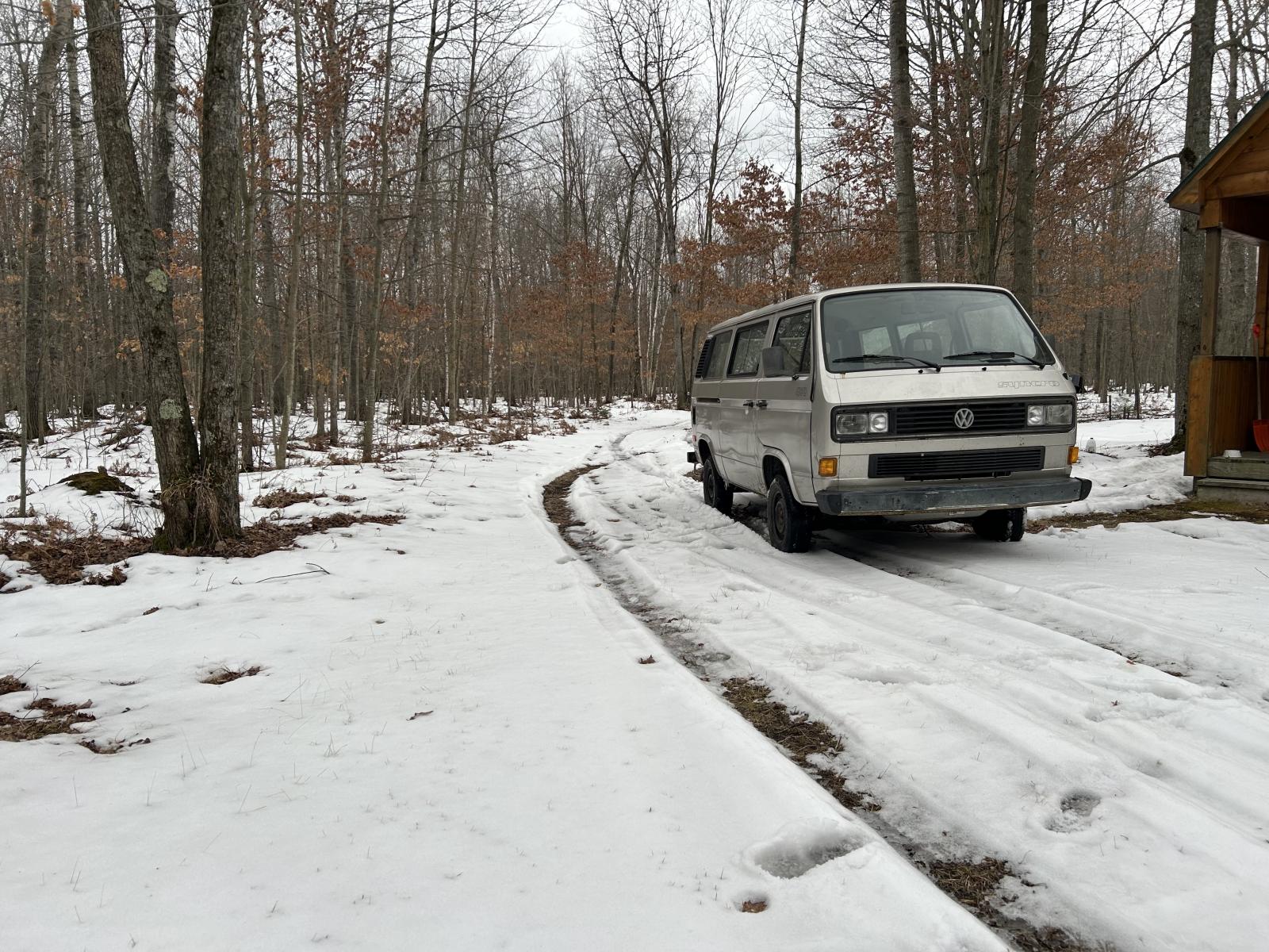

I’ve put 120 miles on the Syncro so far Very Happy Only one break down and it was losing power to the fuel pump since the wire came off. I replaced the TS2 and it did the bogging thing one more time after and then it was good for the last 90+ miles. Maybe just a fluke or the bad fuel pump connection? Think It will also idle high on occasion. But it’s driving really nice so far and the heat works good. I got the one coolant leak fixed that was due to a missing bolt and took the power steering belt off since it was leaking bad.
The missing bolt was on the flange to the water pump. Odd place to be missing a bolt
“Rome” 91 Syncro

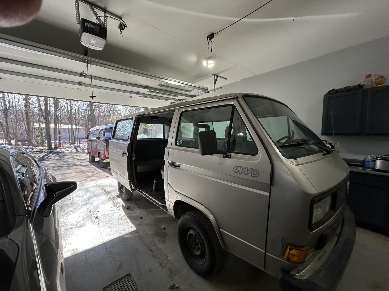

Today the Syncro got a wash, it was covered in salt and there was still moss in spots on it. It looked nice cleaned up.

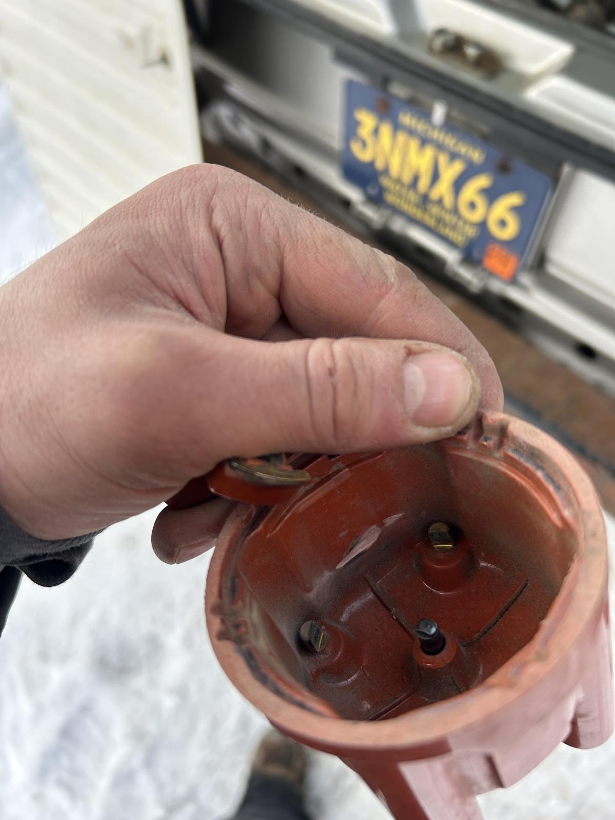

I started looking into what the running issue was, I was going to start with grounds but I noticed the distributor cap wasn’t attached Shocked the one clip had came off so the cap had came loose and rotated messing up timing. The rotor had been eating into the cap and the points in the cap and the rotor got burnt. I went to replace the cap and figured out why the clip was messed up. The clip broke off and I looked and discovered it had been previously broken and another clip had been welded to it Laughing so till I can get a new clip I had to zip tie it. The old rotor was also seized on and was a pain to get off, it ended up breaking taking it off.
But after getting it all fixed, I went on a drive and it was running better again and it seemed to take care of the issues. No more stumbles or misses. It still idles a little high but I’m happy it was a simple issue.
