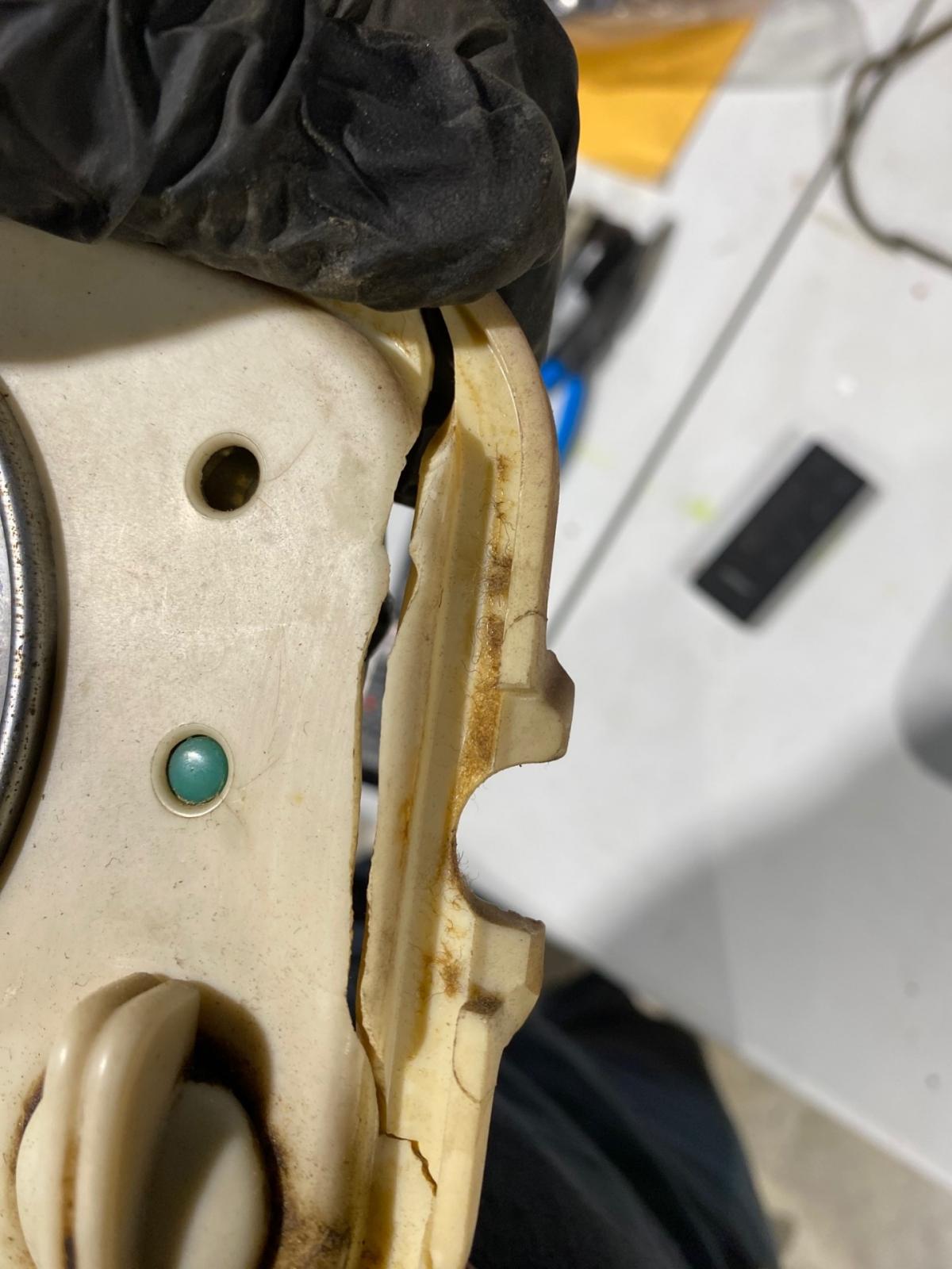

I think I can see a 12 on the speedo pod ground fork. 12.49? Would match the speedo. VERY cool.
That crack in the pod is typical Unfortunately. It can be addressed by Dremeling the crack deeper on the backside and JB welding. Do not try and use a powder solvent (white) product like Plasti-Pair. I used it once on an ivory bakelite pod like yours. It worked for a while but after a few months it literally just fell apart on its own.
And regardless, those pod "mounting ear" breaks will always be at risk of re-cracking, it is a stress area.
Yes John for sure I thought the same. Started clearing the canvas and getting parts ready for electrical.

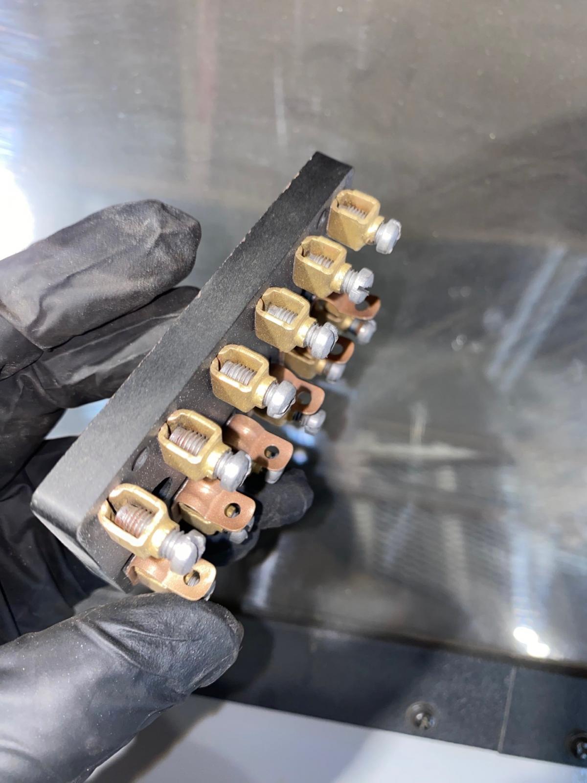

Very nice job on the details of this build!

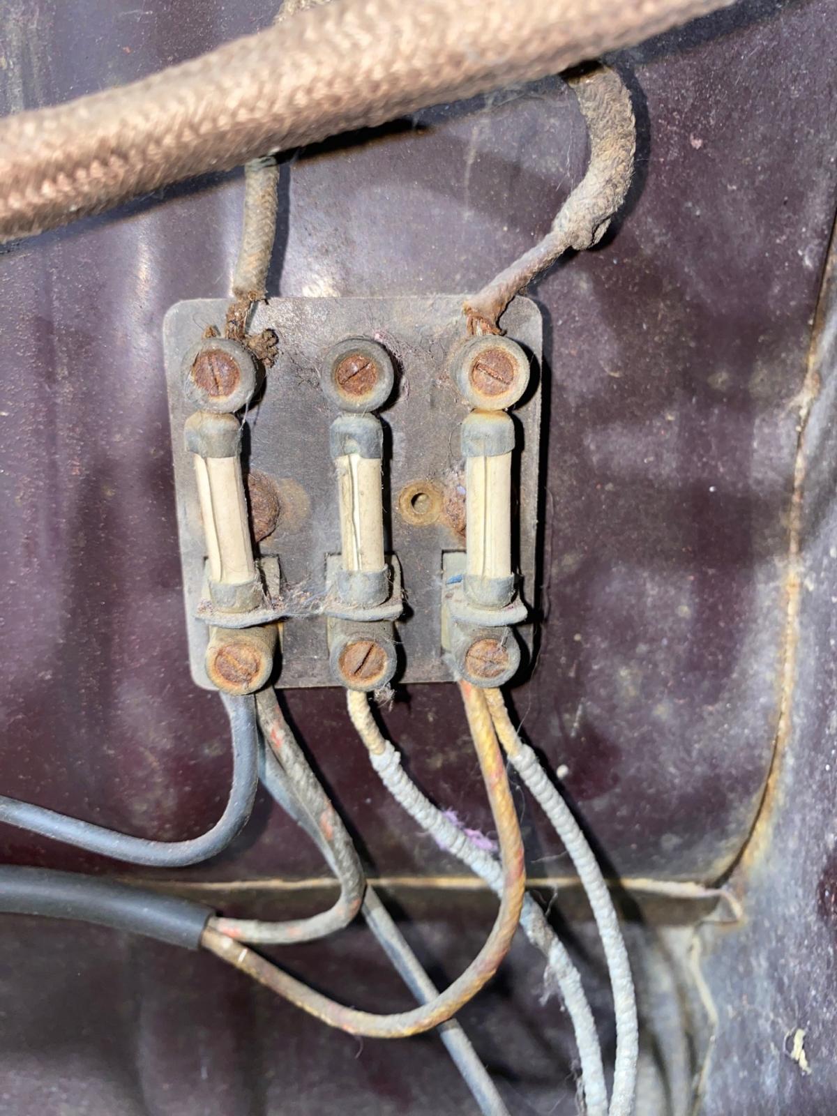

How did you clean the fuse box in the above post? Glass or ice or....?

PostPosted: Thu Jan 30, 2025 6:38 pm    Post subject: Re: 1950 January Original Paint L-51 Deluxe (Preservation build) Reply with quote
Thanks! I like to use glass just need to be more aware on what parts you use them on because it can get in everything. Here is the rear block which cleaned up nicely but cracked when trying to break rusted screws loose and og button I cleaned up nicely.

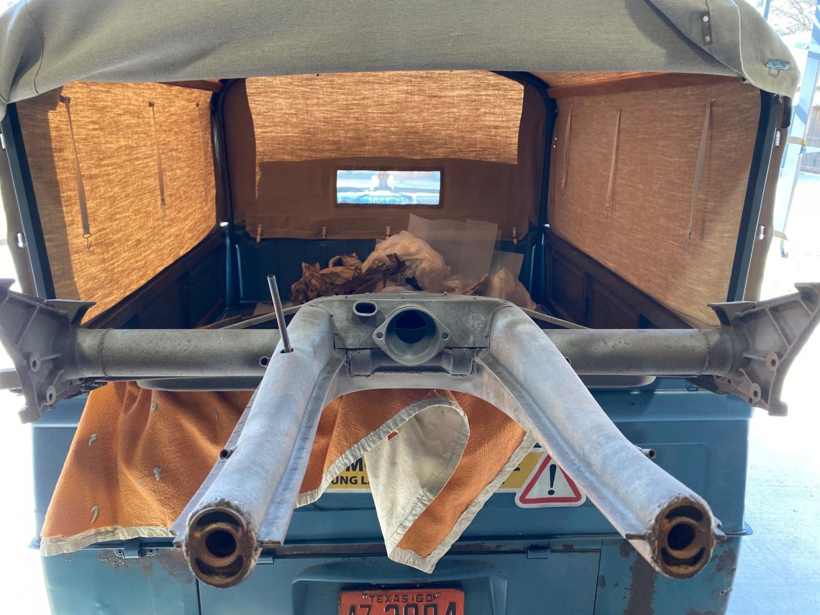

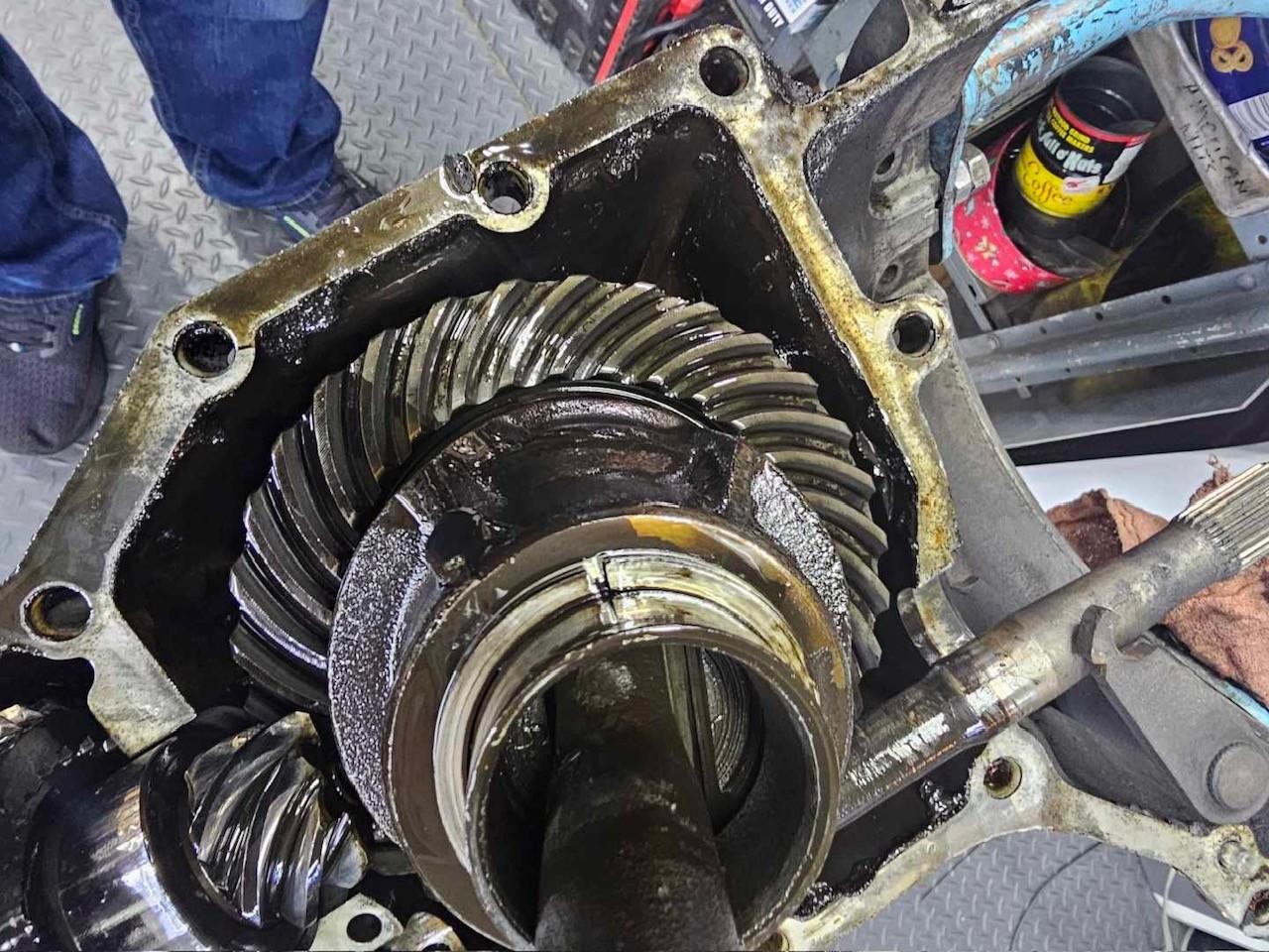

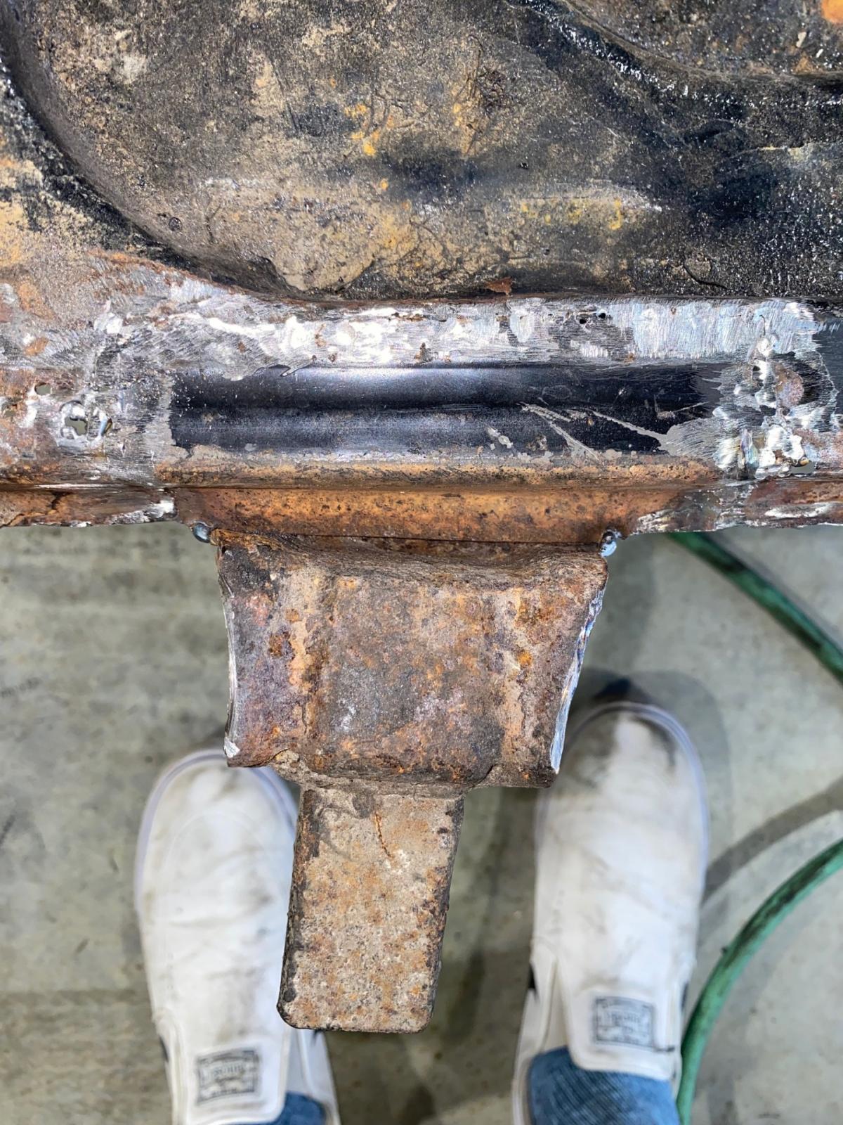

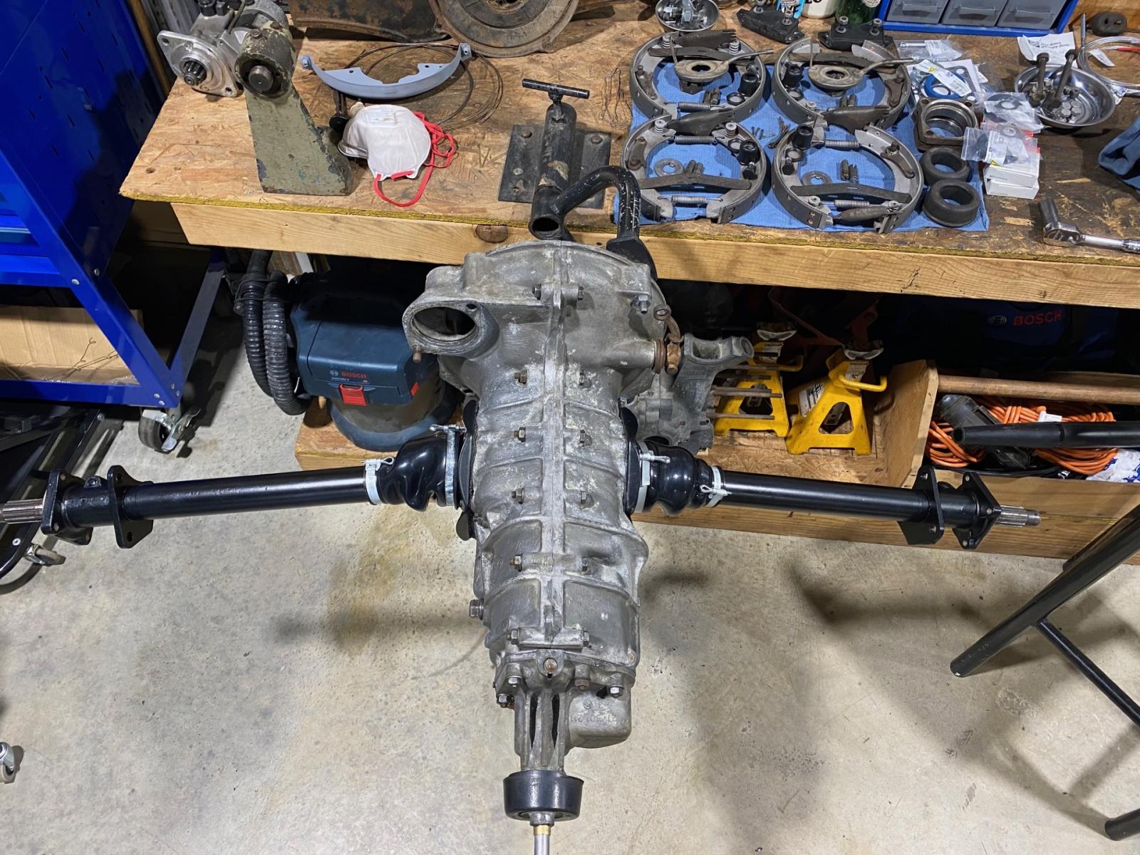

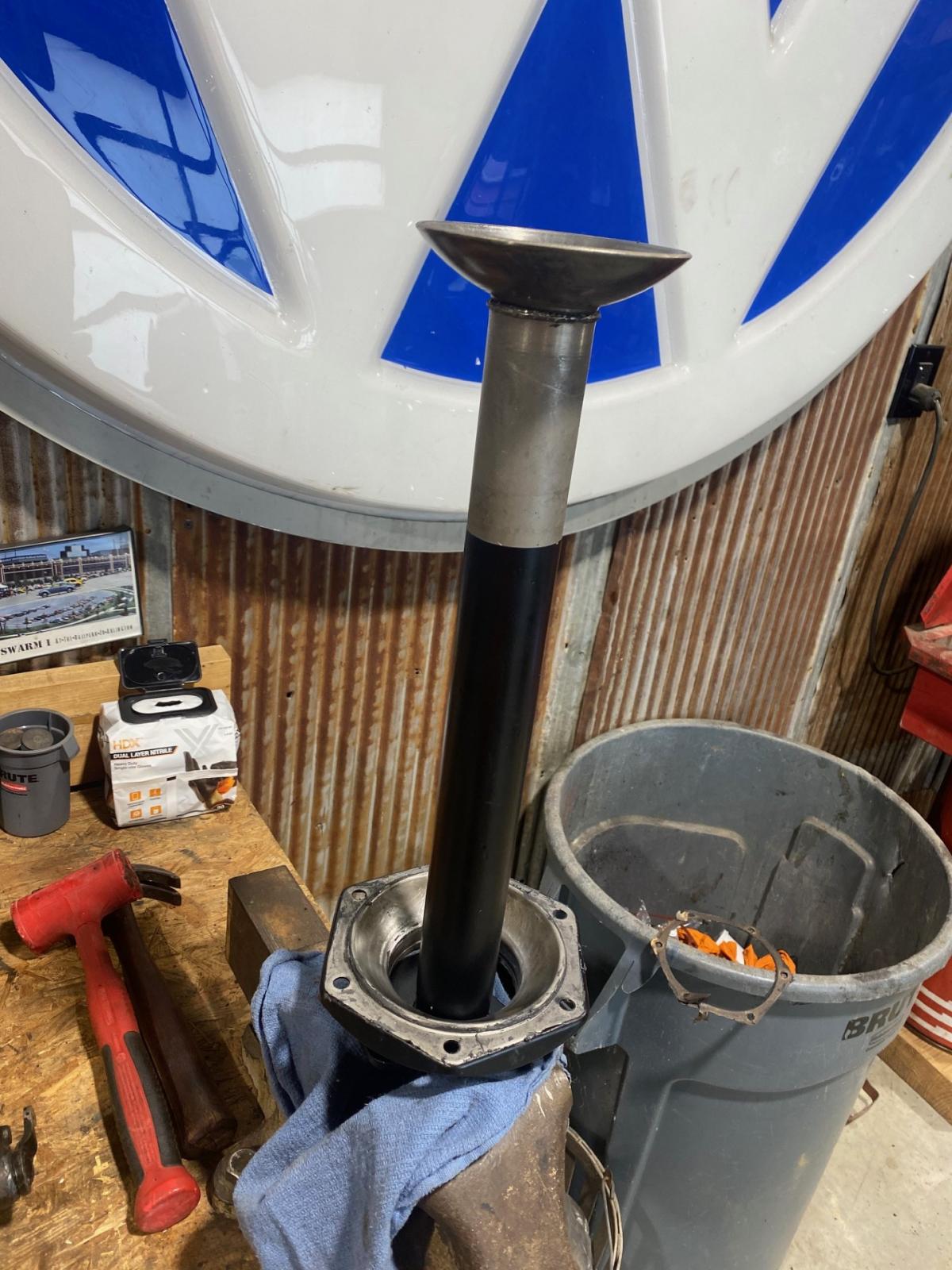

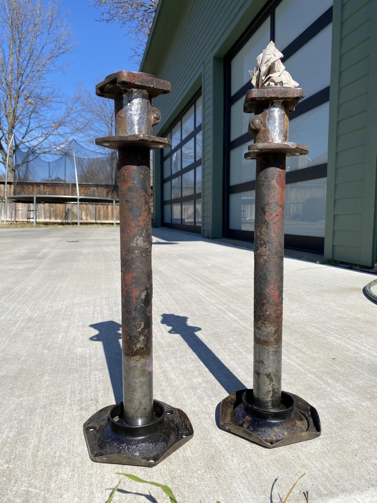

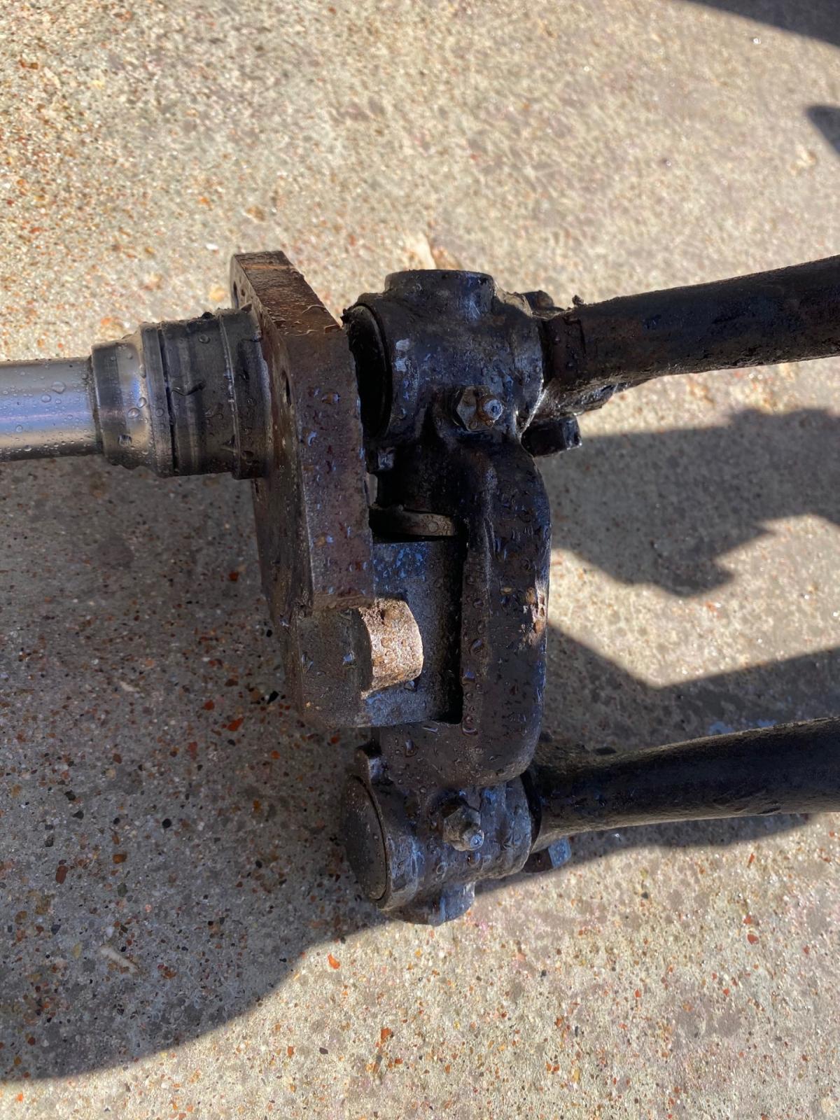

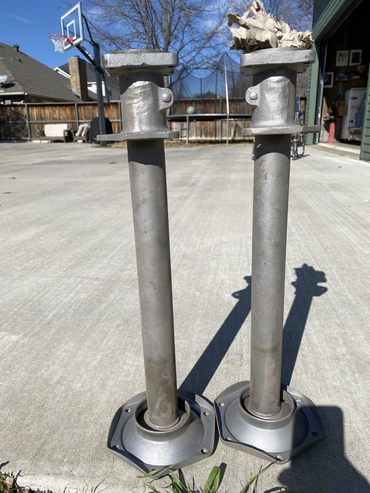

I got the wheels off and drums, so I dropped the oval transmission and then did a quick clean because it was loaded with gunk, then off to Damon for a rebuild because I don't have the time and I hate leaks if I can help it.
Then the oval axle tubes that someone slick rick cut, so I trimmed it down so it has a better split appearance and in the media cabinet in prep for the powder coat pile.
Got the tranny back in no time at all and really didnt have much things wrong with it but I always like to have it checked and resealed before running them.

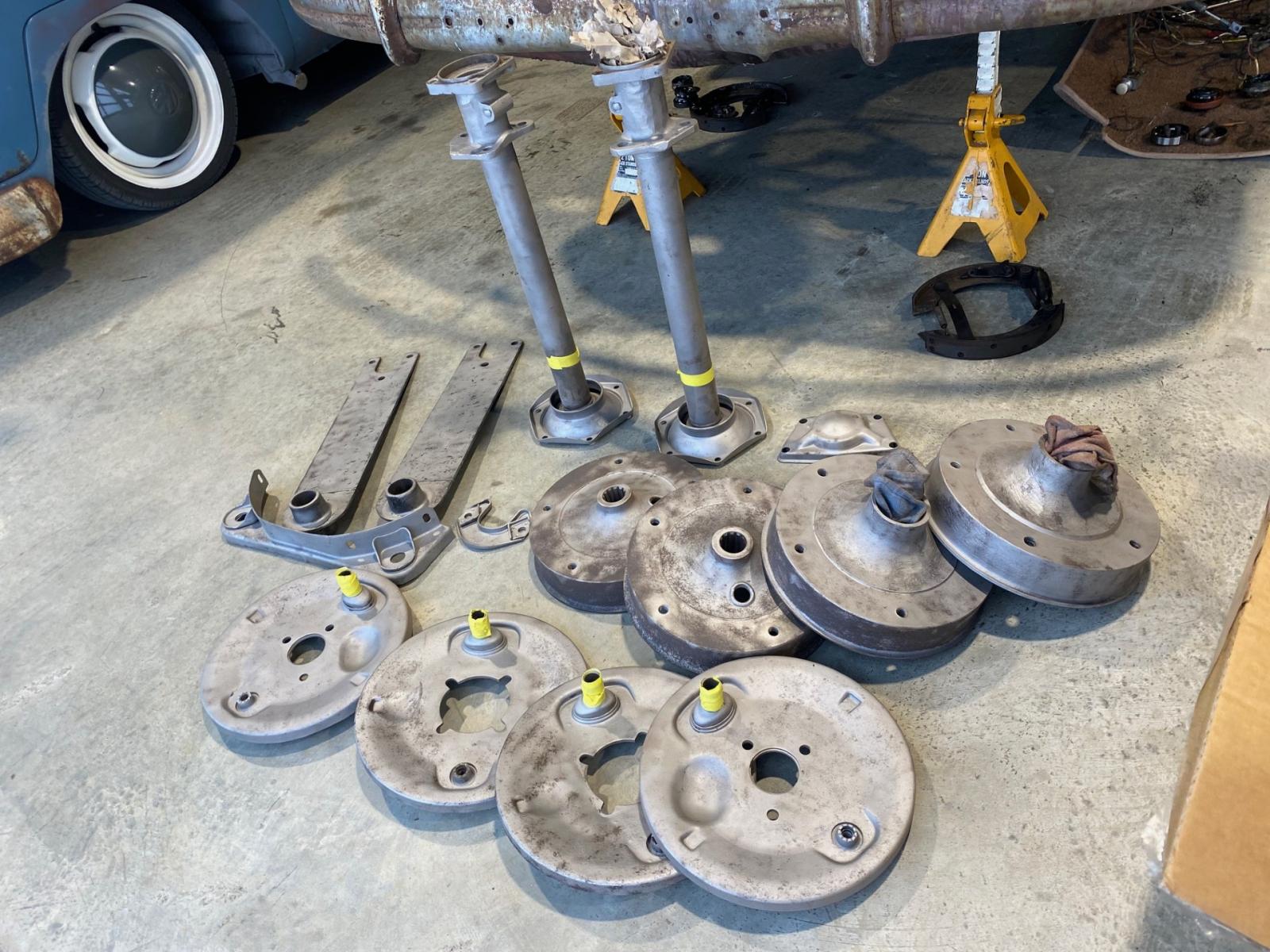

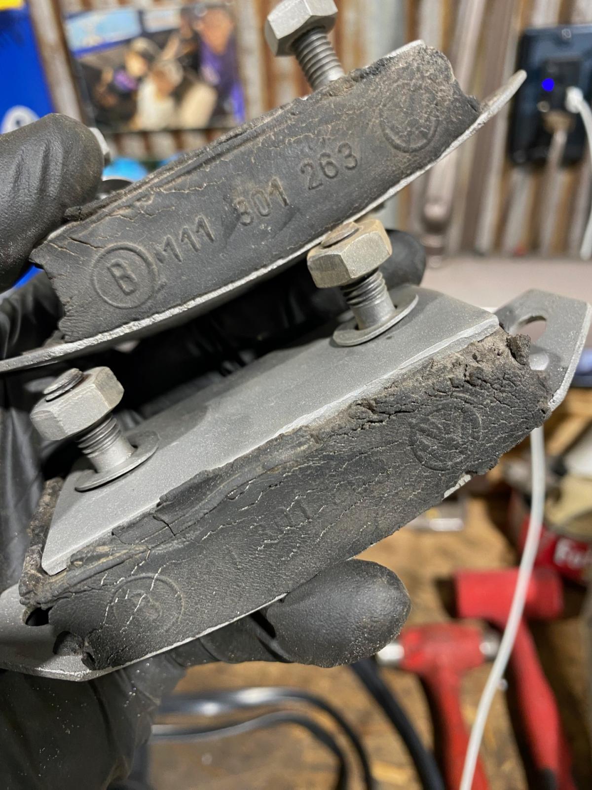

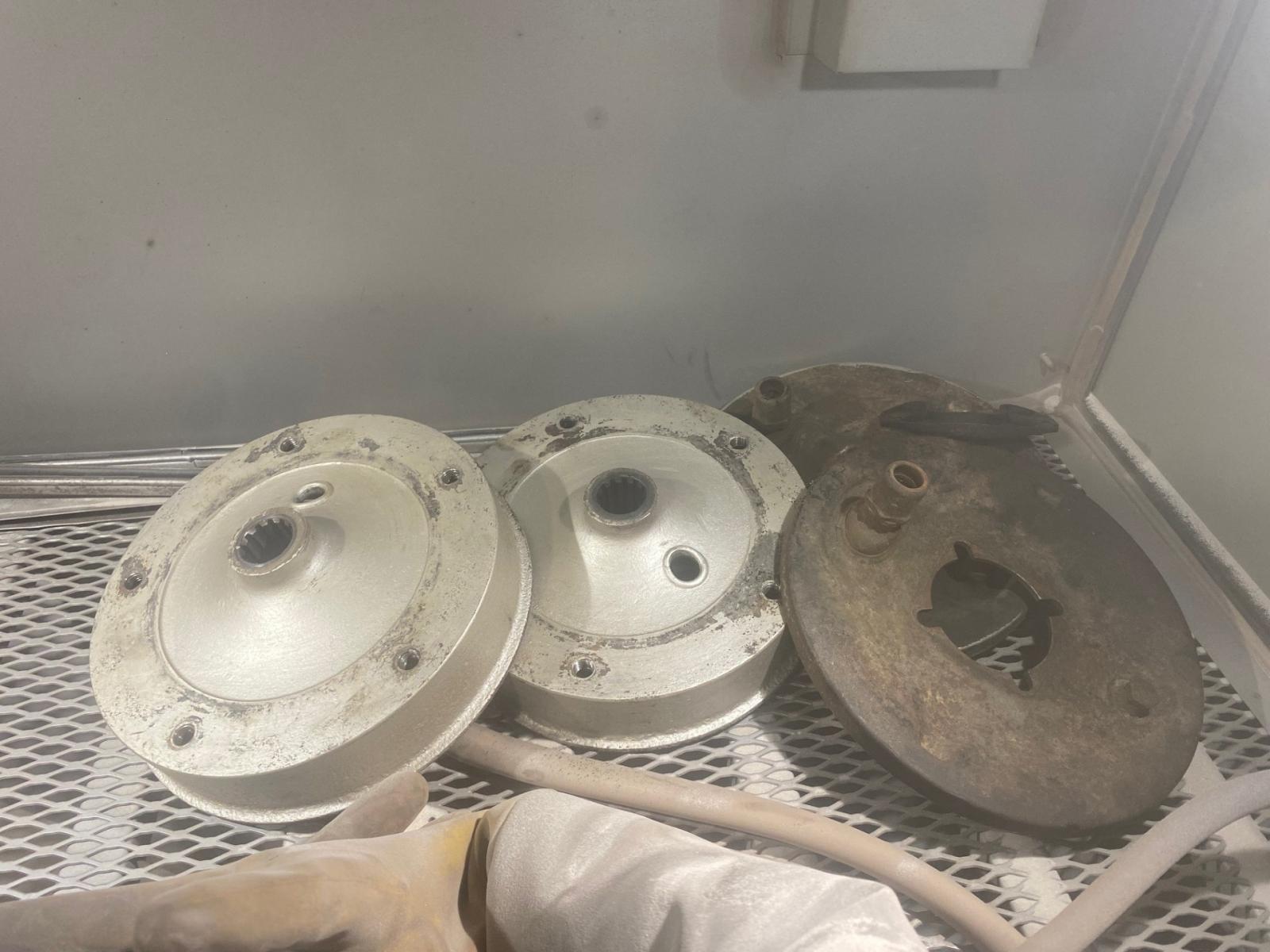

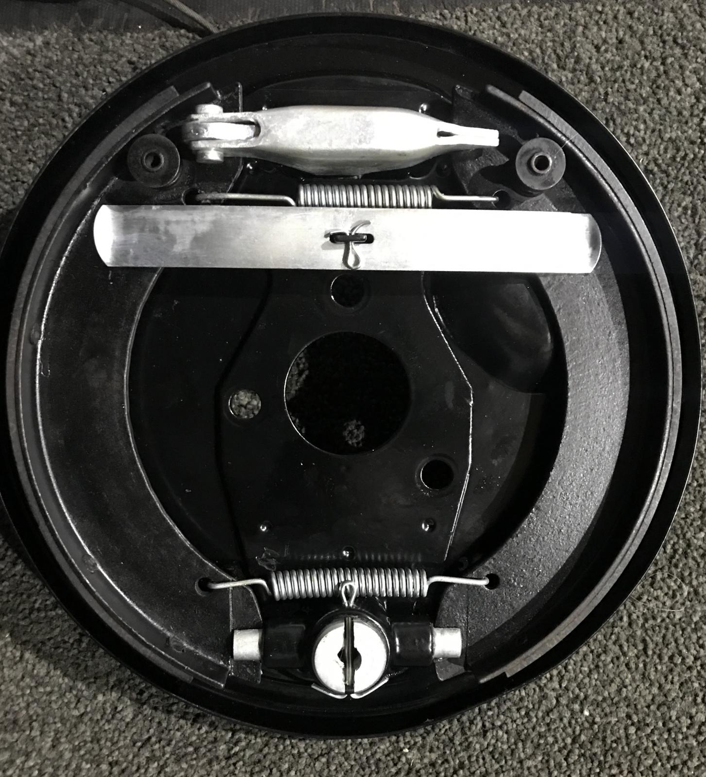

But I've gotten more done just now getting more progress posted here is all the backing plates and drums getting in my media cabinet.
And even cleaned up these og tranny mounts and the rubber was still soft so Im gonna run them.
Now all of this is off to powder coat to give it the forever life it deserves.

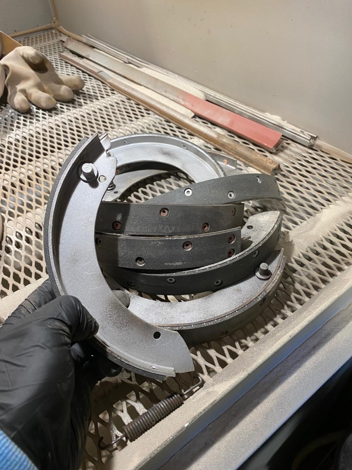

While I have the time I will clean these amazing riveted pads. I even found a couple of them that had the NOS stamping like the same style set I put on my Hoffman. Very Happy Very Happy

I absolutely love the mechanical brake system. I had some good results with a home zinc plating kit when I did the 11e.

Yeah, I've zinc'd and coated some of my other stuff; it's a great look that most never get to see. On the beam I haven't found one yet, Sinclair, but I do plan on having one. Thanks so much; it's been years in the making, and it has a lot of locally VW history and all over the world from my travels and just being a VW nerd. Laughing Laughing Laughing

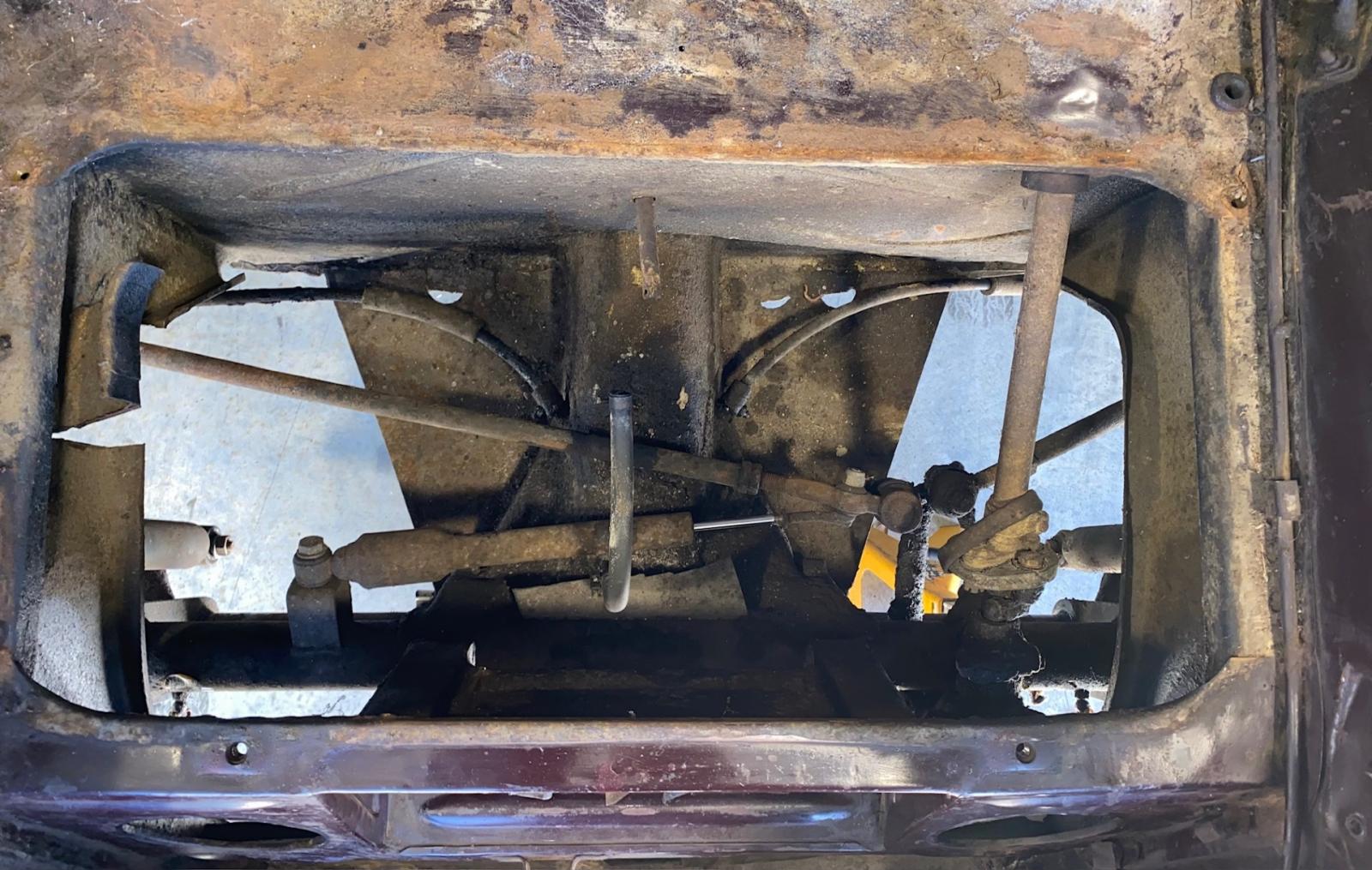

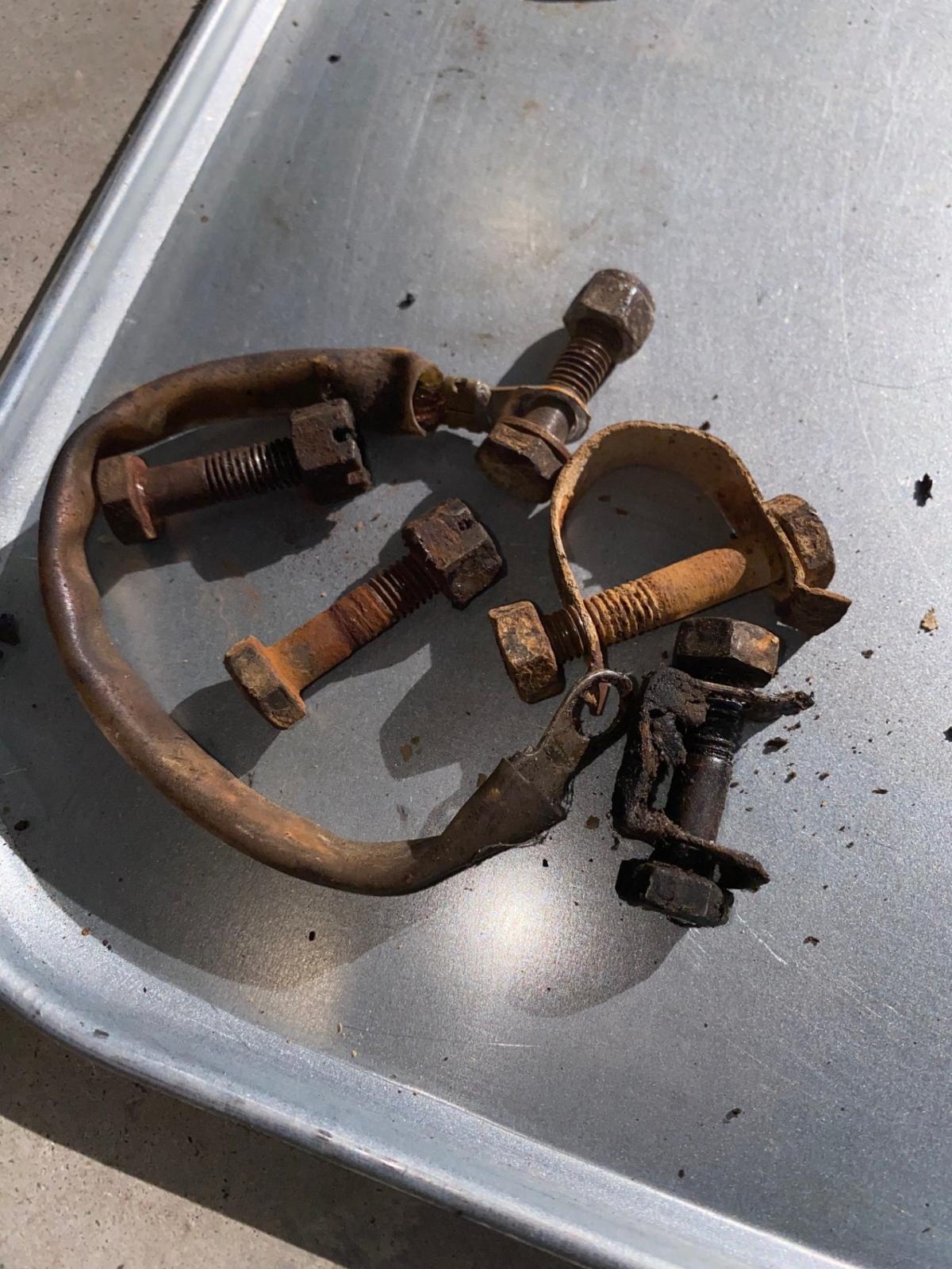

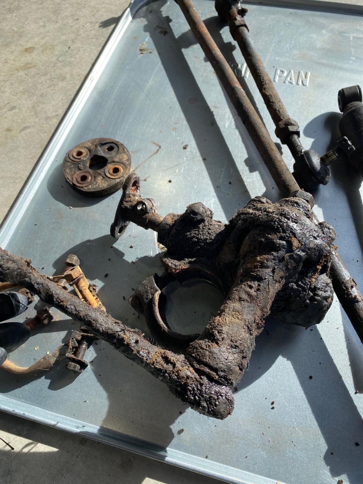

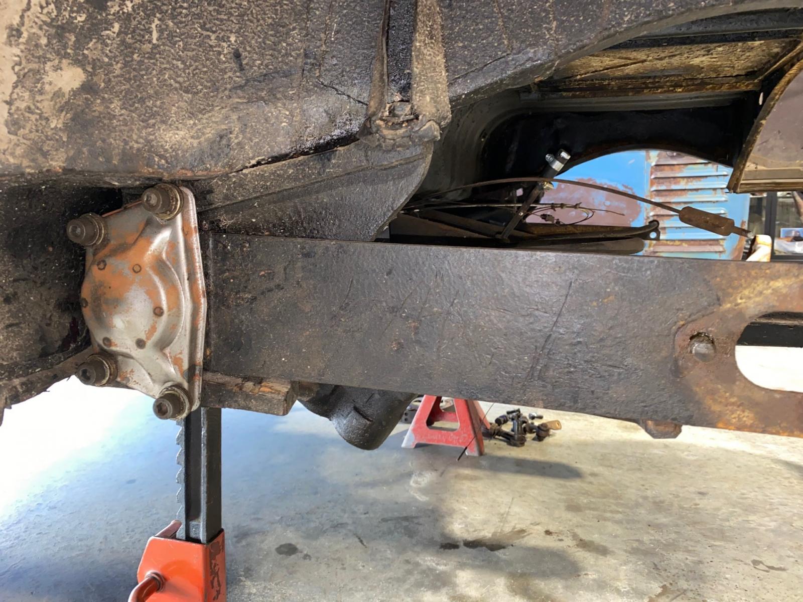

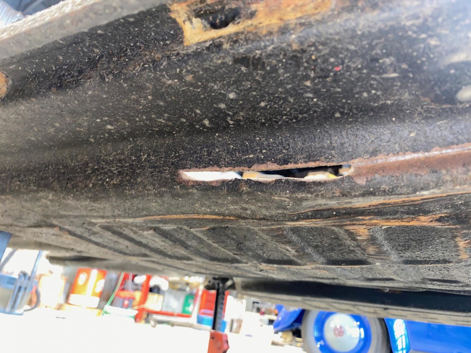

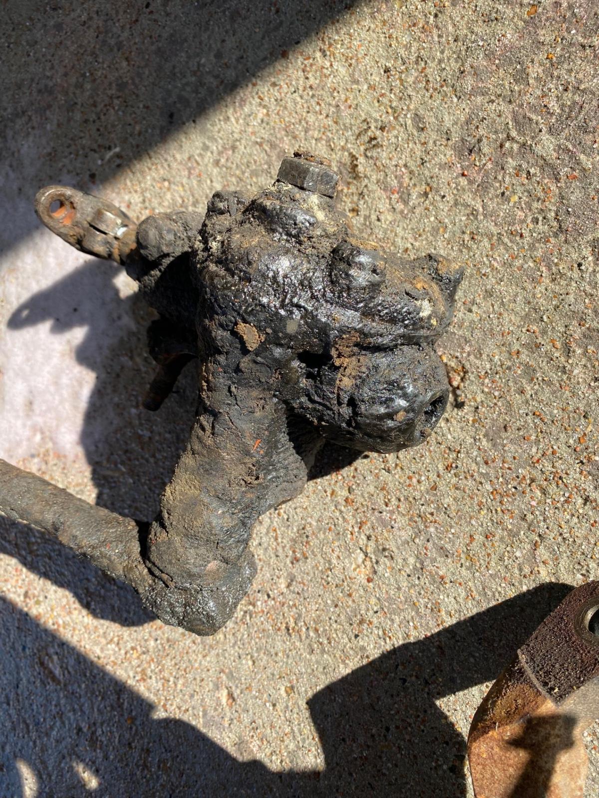

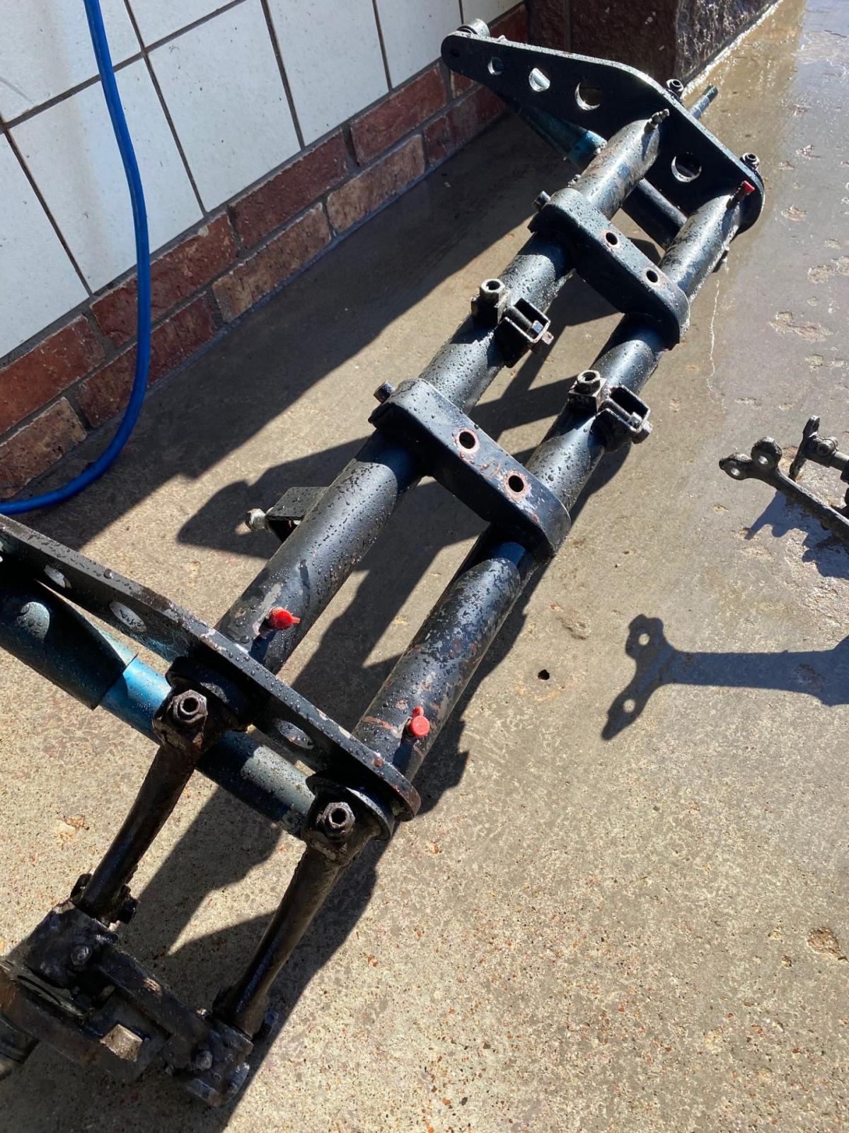

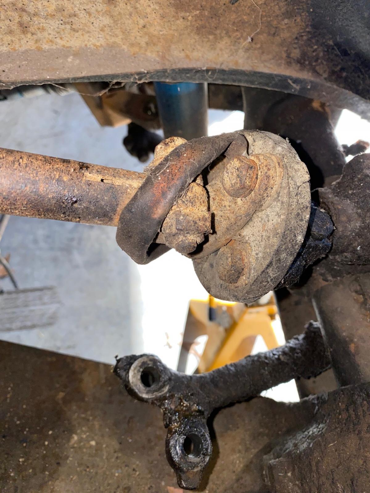

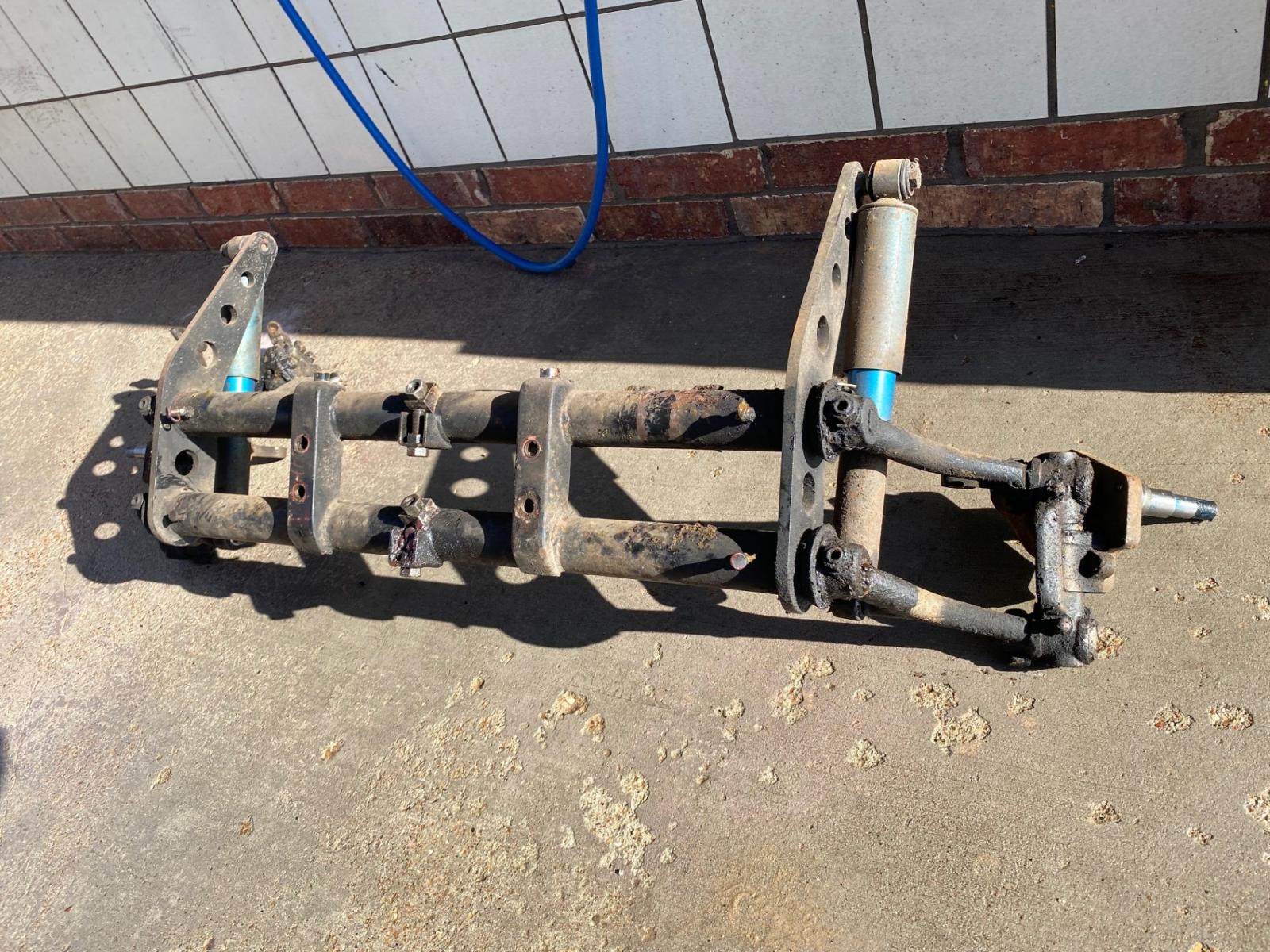

Not the fun stuff but had to get the front end off and see what is wrong and what I can use plus removing 50-70 years of $h!t. Laughing Laughing
WTF WTF!!! Evil or Very Mad Evil or Very Mad Evil or Very Mad Evil or Very Mad VVVVVVVVVVVVV
I always look forward to seeing the logos and parts number under the gunk.

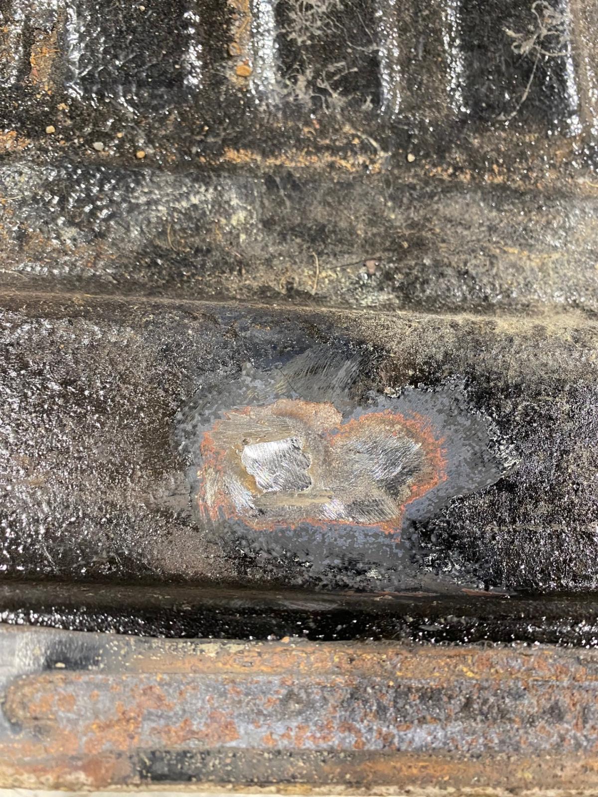

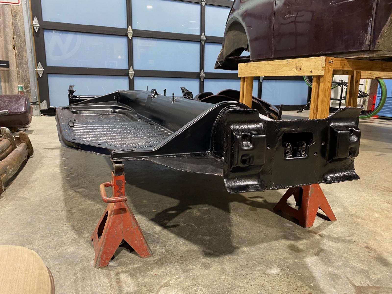

Got something little knocked out as I just dropped the chassis off at media and powder coat I will post that soon.
Got everything in media cleaned back to bare metal showcasing all the VW stampings then shot matte black on all pedal assembly parts. Getting it back to how these parts are supposed to look. Very Happy Very Happy
1950 Deluxe Sedan Build
Two Glove Boxes IG

PostPosted: Mon Feb 17, 2025 8:31 pm    Post subject: Re: 1950 January Original Paint L-51 Deluxe (Preservation build) Reply with quote

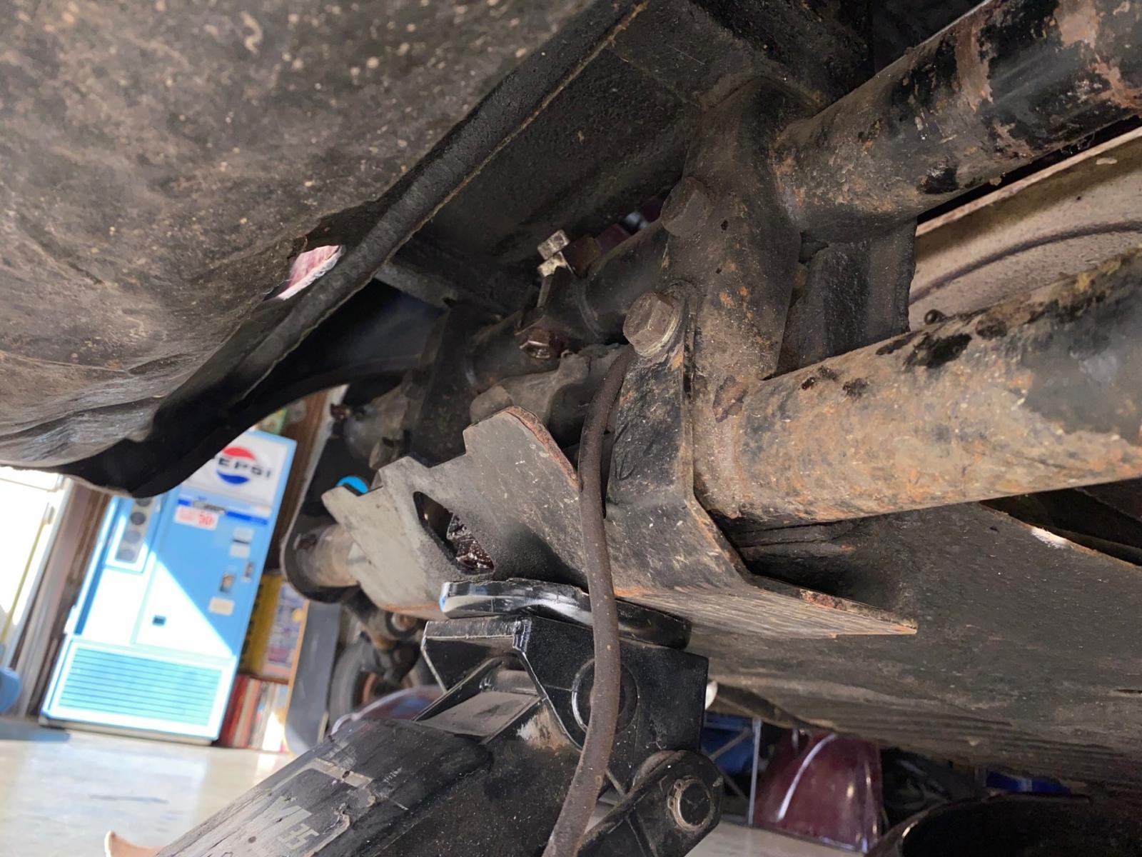

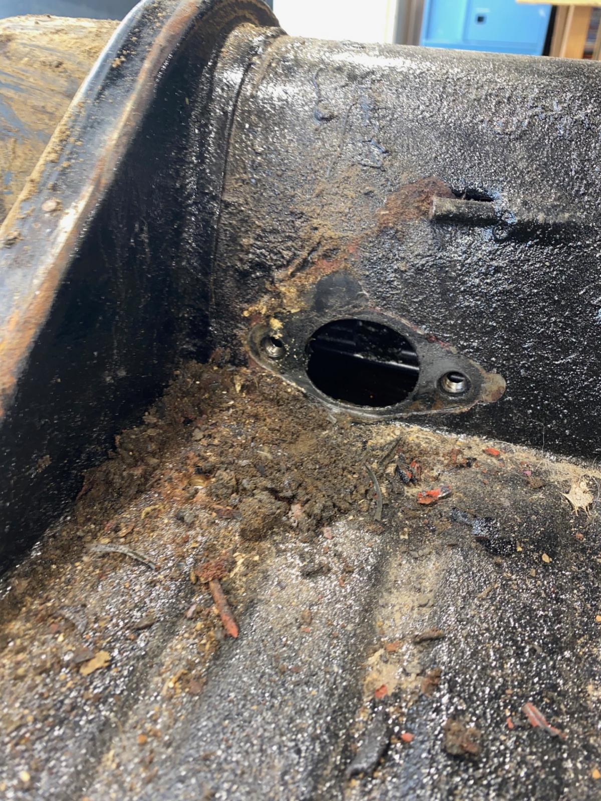

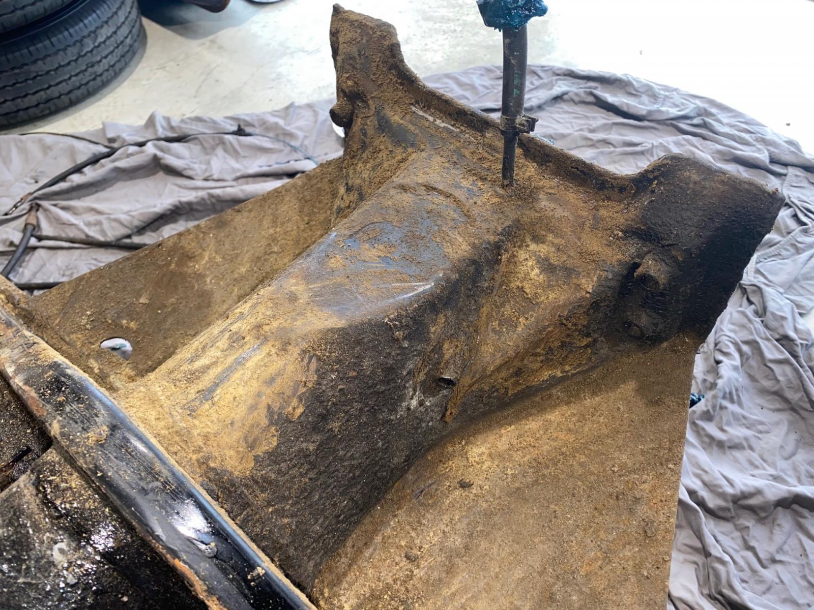

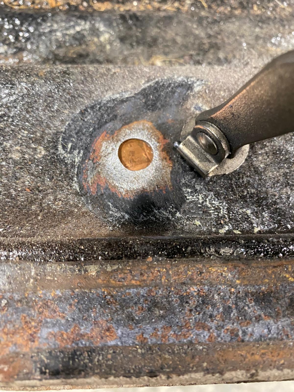

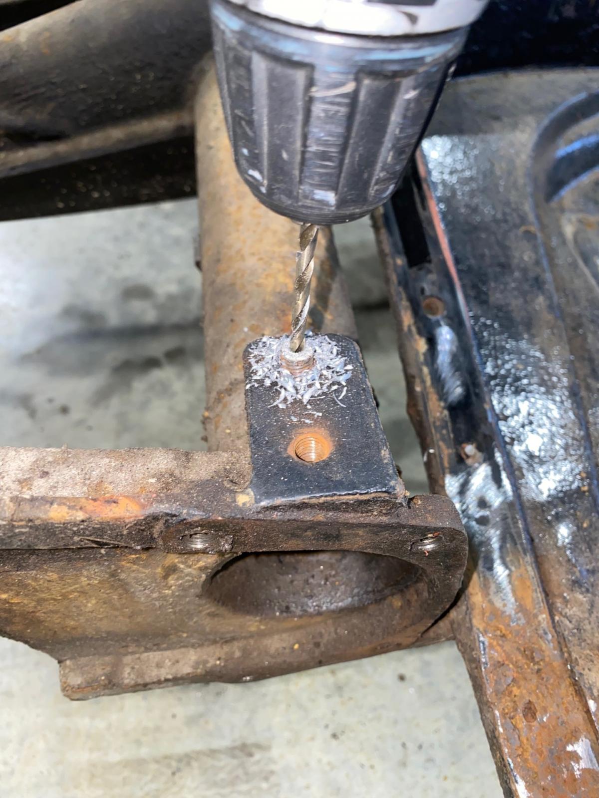

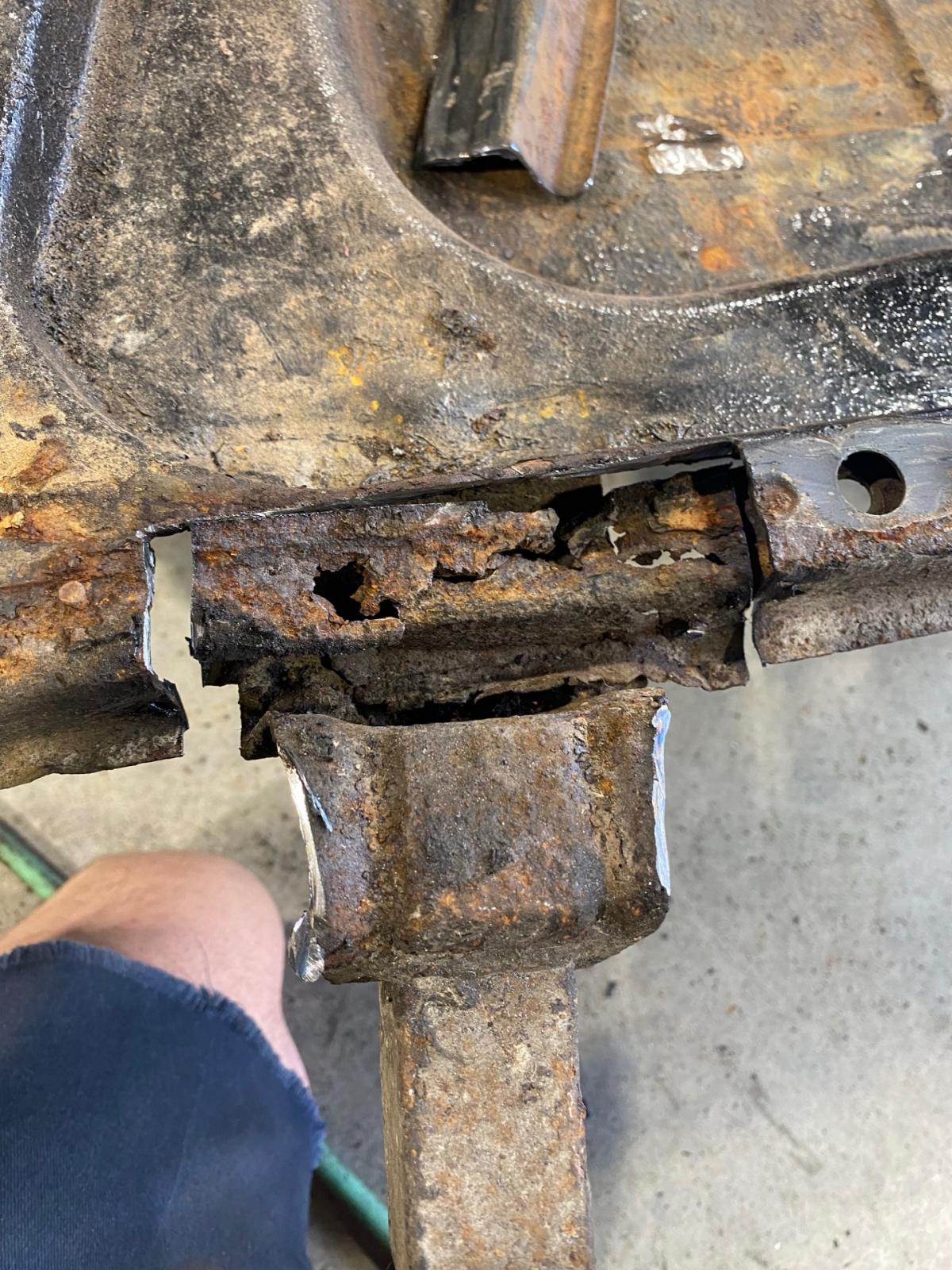

Finally getting this chassis to her originally glory show casing all the bad areas that need to be repaired.
One down 900 to go and all broken studs which I'm sure this car will have a lot of. Laughing Laughing Laughing Laughing
ignore the bs broken stud tool next to the pb blaster that doesn't work but fixed and fixed.
Got everything ready for media.

PostPosted: Sat Feb 22, 2025 10:03 pm    Post subject: Re: 1950 January Original Paint L-51 Deluxe (Preservation build) Reply with quote

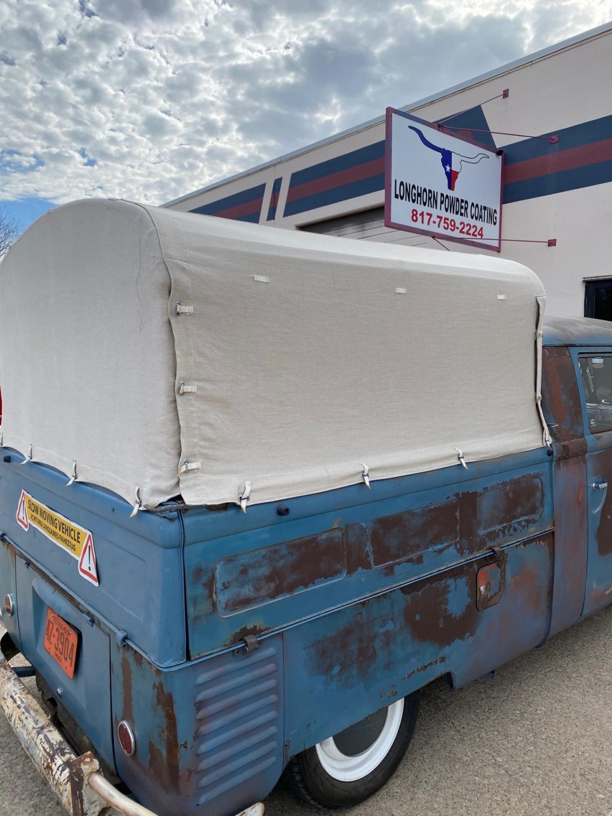

Finally got the call from powder coater that everything is ready for pick up.
They did great detail work as always on all my pieces so jumped back on the tranny getting it outfitted the axle tubes and boots.
You know the drill heat rubber condoms. Laughing Laughing Laughing
During this post I got that the call Laughing Laughing Laughing the chassis was ready from media so I went a picked up and did a couple of additional miner repairs.
Then loaded the chassis up in style back to the powder coater.
Then after a bowl of cereal I got the call the chassis was ready from powder coater. Well it's internet speed. Laughing Laughing
And I think it looks tits and should last another 70+ years!
