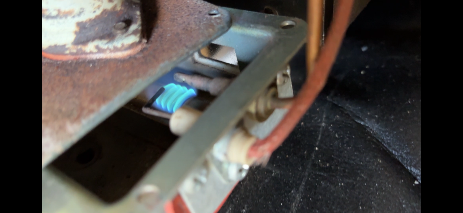

I'm in the same boat as well. The flame that I see in the little viewing hole does not get any brighter when I increase the thermostat.
I would think that even if the jet was not the perfect size (i.e. some buildup) you would still see a noticeable different in the flame as you increase the thermosta?.
I have a spare fridge for parts but is there any way I can actually test the thermostat?
The spare fridge works on propane as well and displays the same issue. So I am at a loss on moving forward. I really, really like the propane fridge, so I want to keep going with it.

This is the combustion flame on full. I don’t have picture at idle but it’s just a slightly smaller flame.
The only way I know to test the thermostat is to take the fridge out of the van and visibly watch the flame change as you rotate the thermostat. Before you remove the fridge you can also watch the camper panel LED change brightness slightly as you rotate the thermostat. This works best with the GoWesty LED camper panel installed as the blue fridge light is bright compared to the stock green LED.

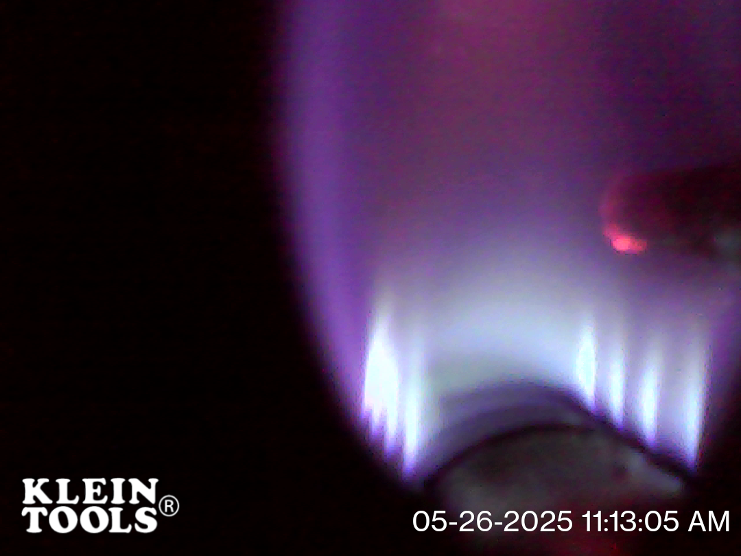

My fridge does not get very cold as well. I cleaned the burner chamber etc. but still no joy. Here are pics of low flame and high flame. Do they look resonable?
Also the OP said he heard a roar when he put it to high. Mine is quite silent on high. Wouldn't know it was running unless you touch the exhaust. Thanks all!

PostPosted: Tue May 27, 2025 8:55 am    Post subject: Re: Fridge runs on propane but doesn’t cool Reply with quote
I'm suprised nobody commented on my flame, however looking at one of the posts from above, I would say my flame is poor. It looks blue on the sides but nothing in the center of the burner. I wunder what could be the cause? The jet looked very clean. Comments? txs

Pictures are a bit dark to tell. Might need to check your gas regulators water column pressure, or thermostat function. If the flame looks small when the thermostat is full, something is restricting gas flow.
Dan above said that even though his jet nozzle looked good it needed ultra sonic cleaning and he got that done at a jeweler. Maybe…
