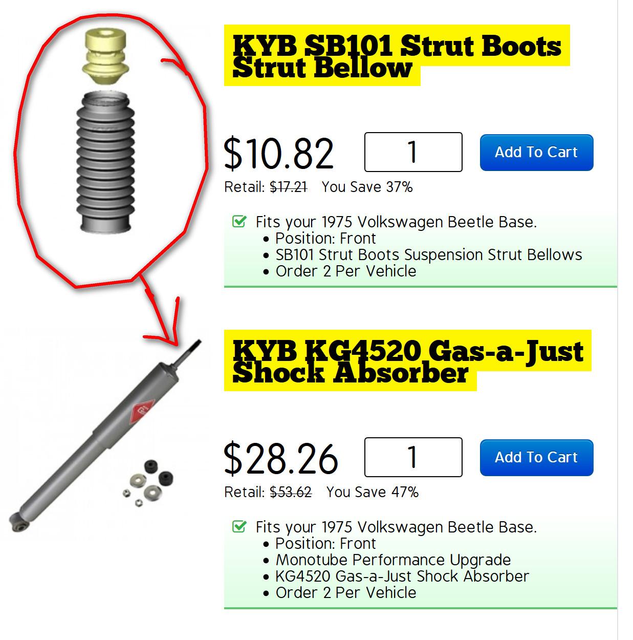

PostPosted: Mon Jul 02, 2018 6:56 pm    Post subject: do i need these boots to go with my shocks? Reply with quote
Working on my mild baja build and need to order some shocks for the the stock bj front end. Do I need these boots to go with the front shocks?

PostPosted: Tue Jul 03, 2018 6:55 am    Post subject: Re: do i need these boots to go with my shocks? Reply with quote
No. The shocks should come with the correct top rubber mounting.
Not sure but it looks like that boot is for a super beeetle with struts. Or it’s just for looks.

PostPosted: Tue Jul 03, 2018 4:07 pm    Post subject: Re: SHOCKS SHOCKS SHOCKS Reply with quote
I agree that boot and bump stop are for McPherson strut Super Beetle, not for a beam suspended Bug.

PostPosted: Tue Jul 03, 2018 7:06 pm    Post subject: Re: SHOCKS SHOCKS SHOCKS Reply with quote
Thanks, somebody along the line put them on front of my 75 standard. I thought it looked like it needed to be on a super. Gettin ready to order new shocks.
