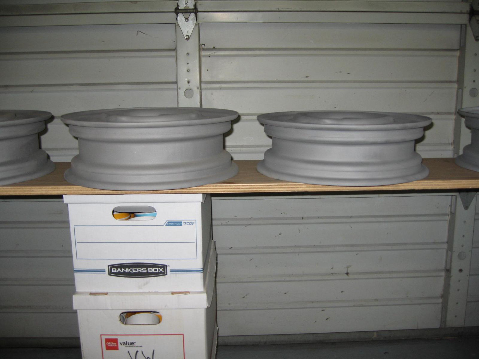

PostPosted: Sun May 01, 2022 5:57 pm    Post subject: Re: 1973 Bubbled Rear Apron & Restoration Thread Reply with quote

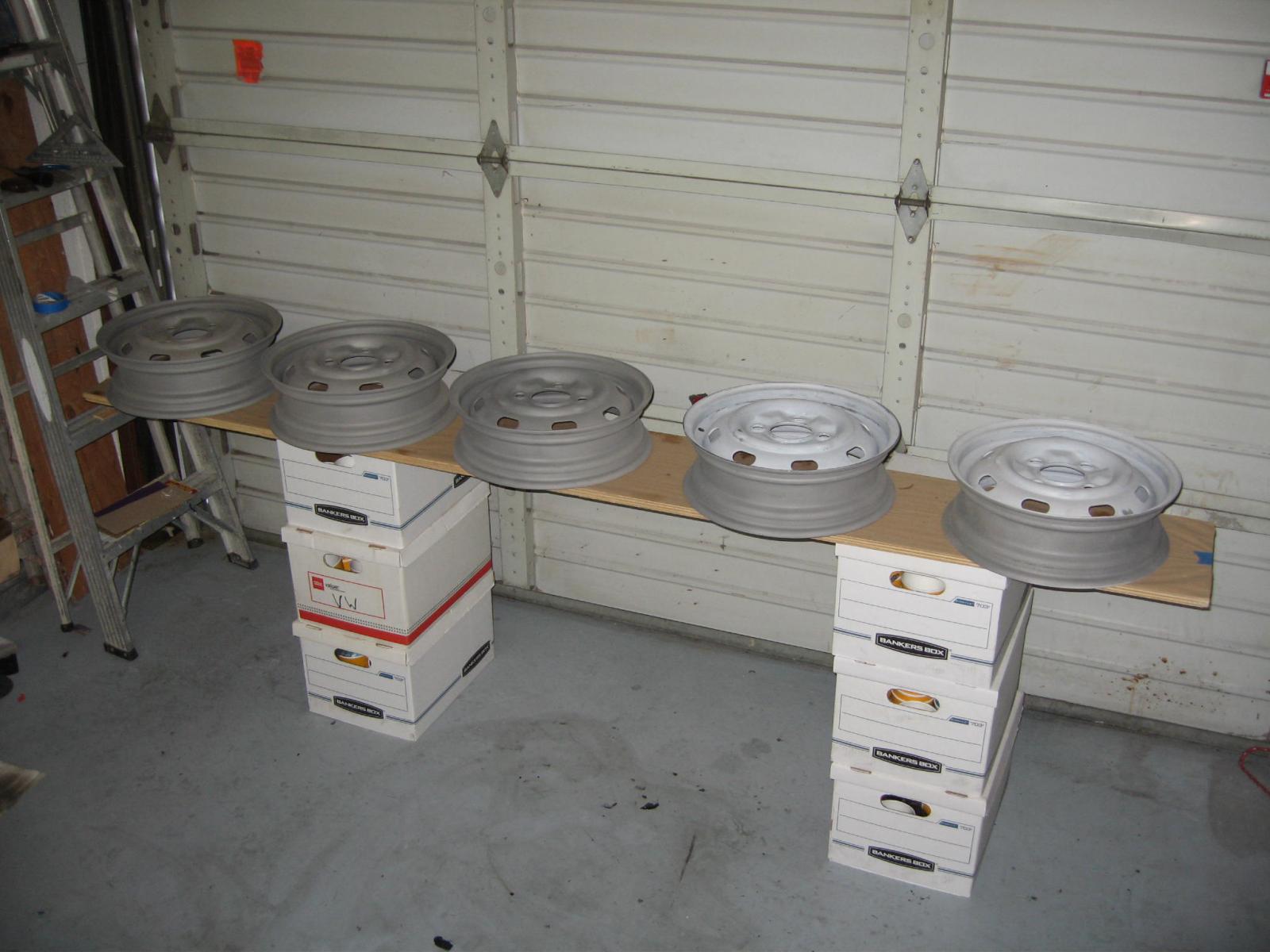

Sunday Fun Day Cool

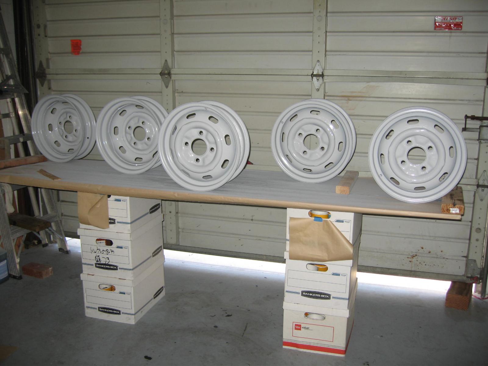

The Blasted Rims Cool
The smaller rim for spare Cool
The Epoxy Cool Cool

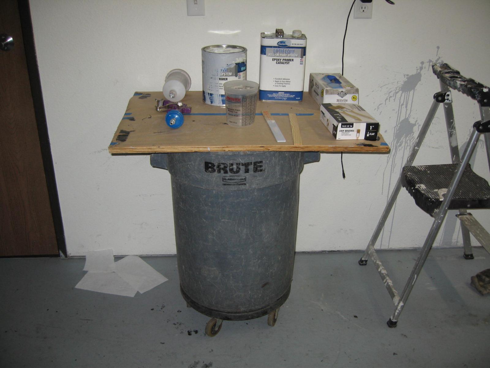

The Setup Cool See what happpenes when the cup slips out of your hands Embarassed
I never understood what a Rim Job was, guess its painting your rims Shocked Shocked Shocked Very Happy Shocked Shocked

PostPosted: Mon May 02, 2022 6:11 pm    Post subject: Re: 1973 Bubbled Rear Apron & Restoration Thread Reply with quote

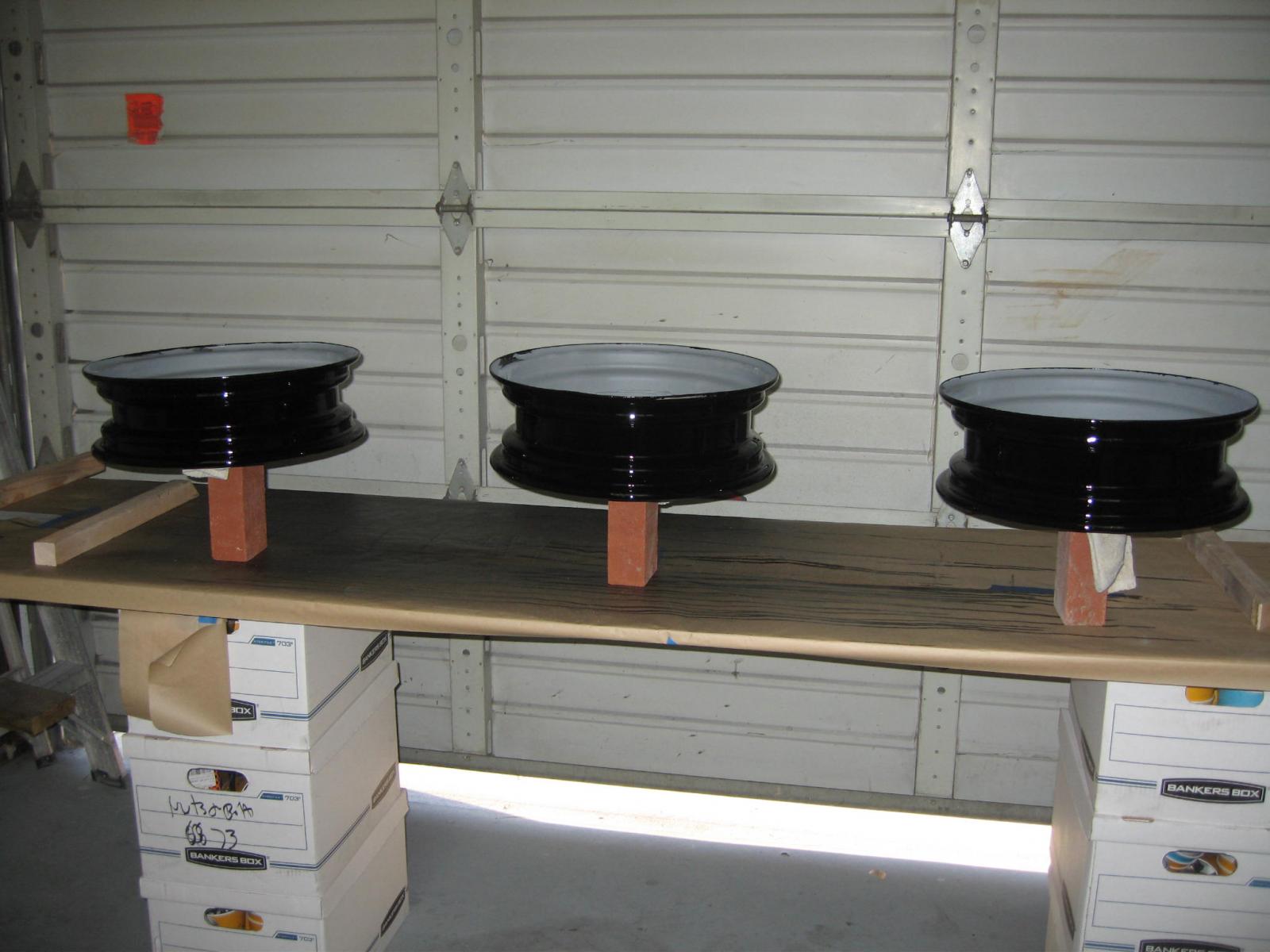

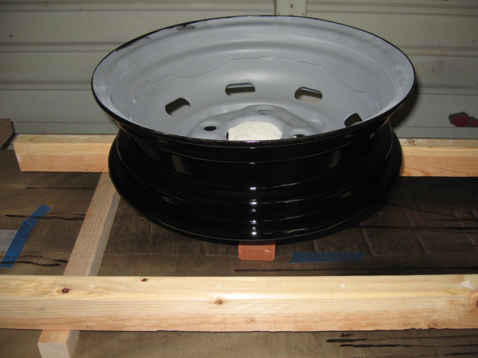

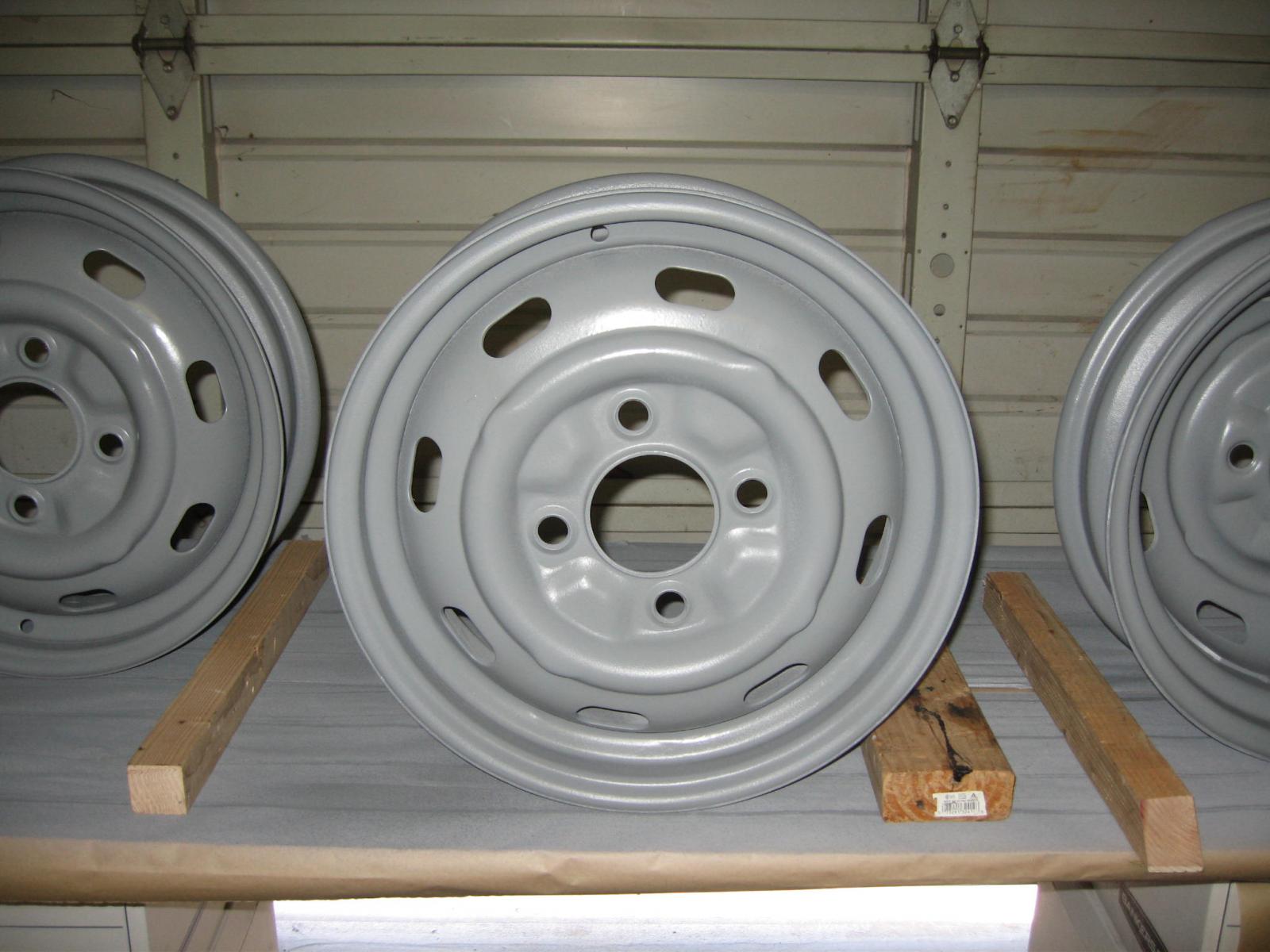

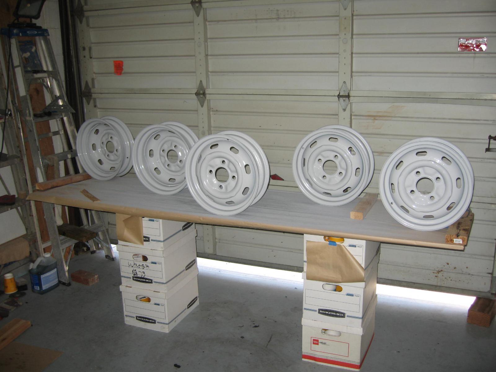

Rims Rims Rims
Dry Epoxy Arrow Arrow Arrow
The inside Arrow Arrow Arrow
The Urethane Arrow Arrow Arrow
Next up. Black inside, thats inside the tire where no one will ever see except the insane who trys to make things perfect Shocked KOOKOO, KOO KOO KOO COO KUCU OOOKOOO Shocked ...and Silver out Cool

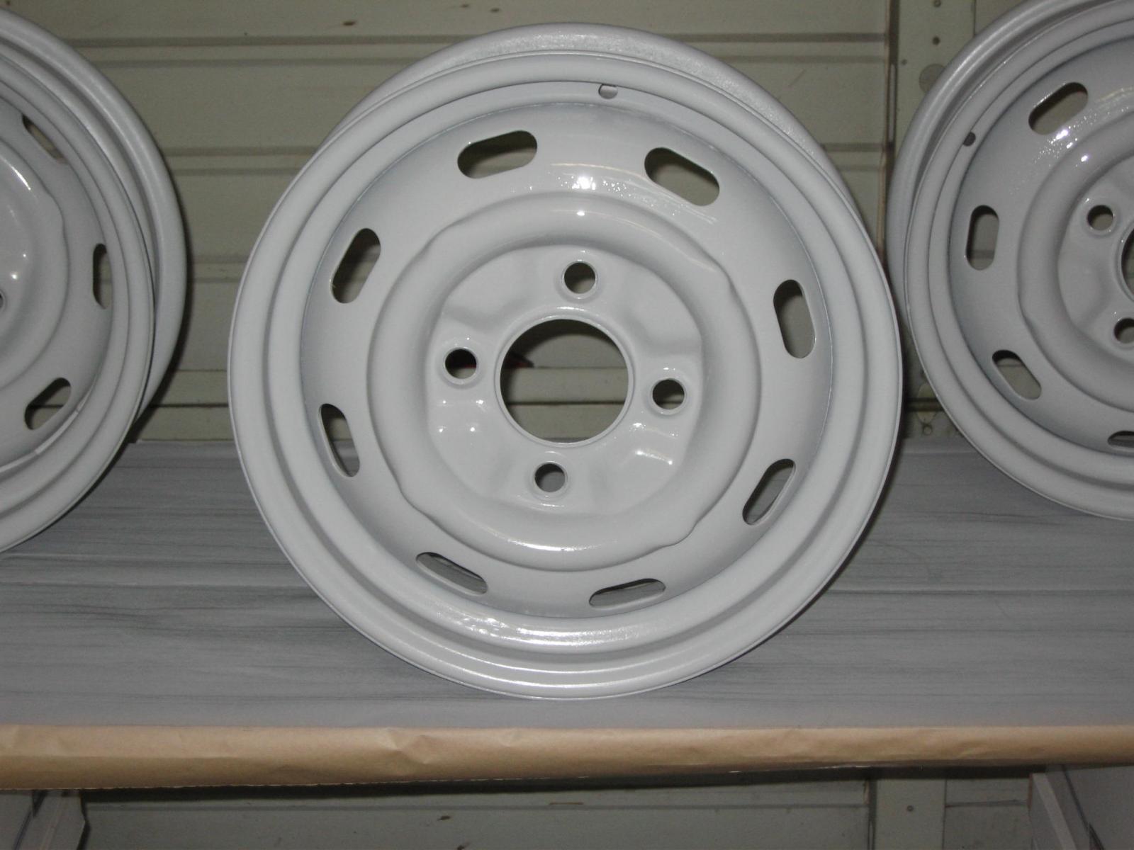

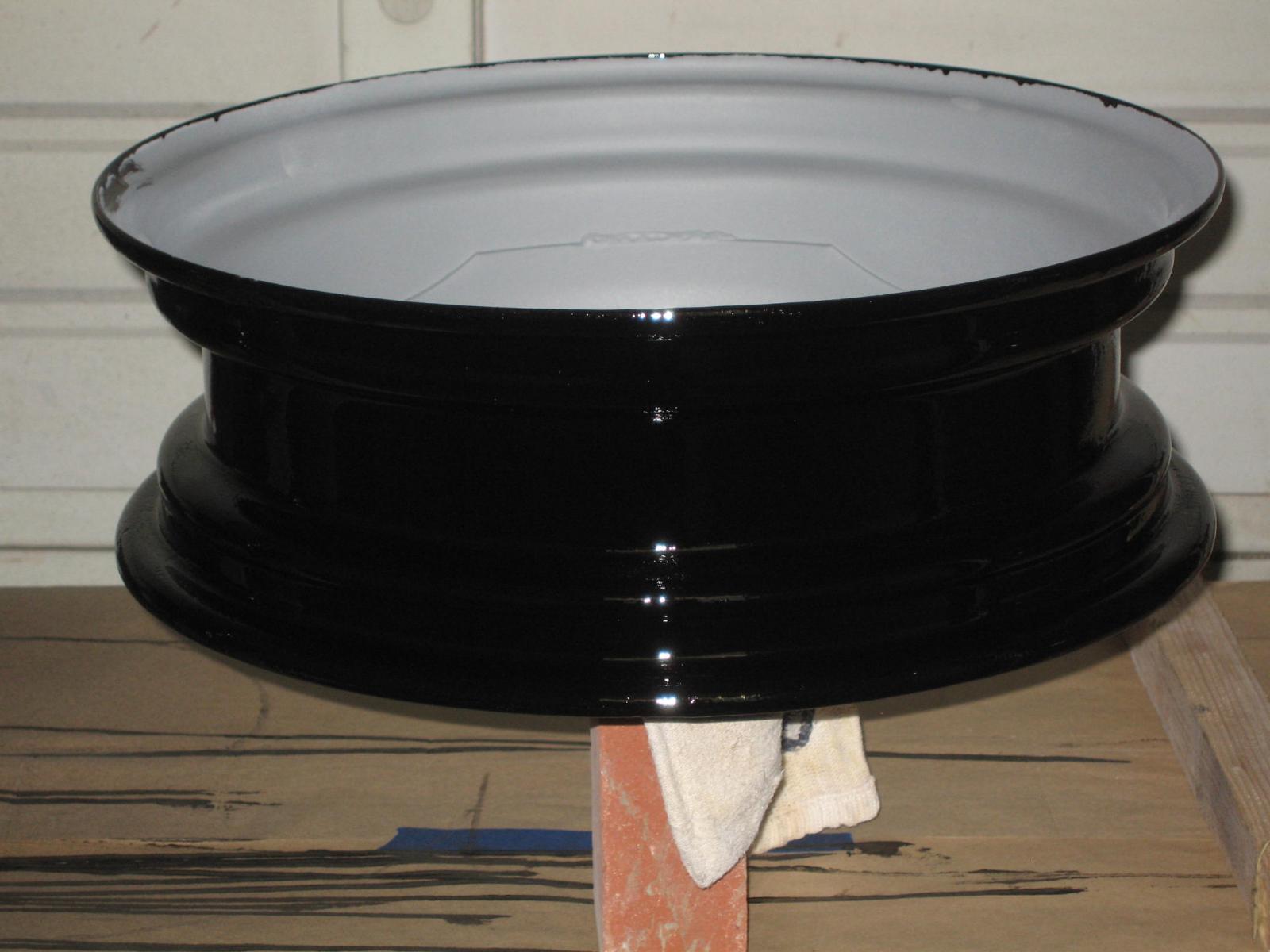

Got this for $10 Very Happy Works awesome for this paint Cool
Sweetness. At 30psi. Now Drop to 25 for the thinner urethane. Had it at 30 for the thicker urethane primer.
See the roll marks. Roll your rim while spraying, comes out beautiful Cool
A real wacko would color sand a buff this.....OOOBoy, Im not that KOOKOO Shocked
Lookin good. Cool Cool Cool Let it dry for a few and paint the rest. One side at a time or both at once.

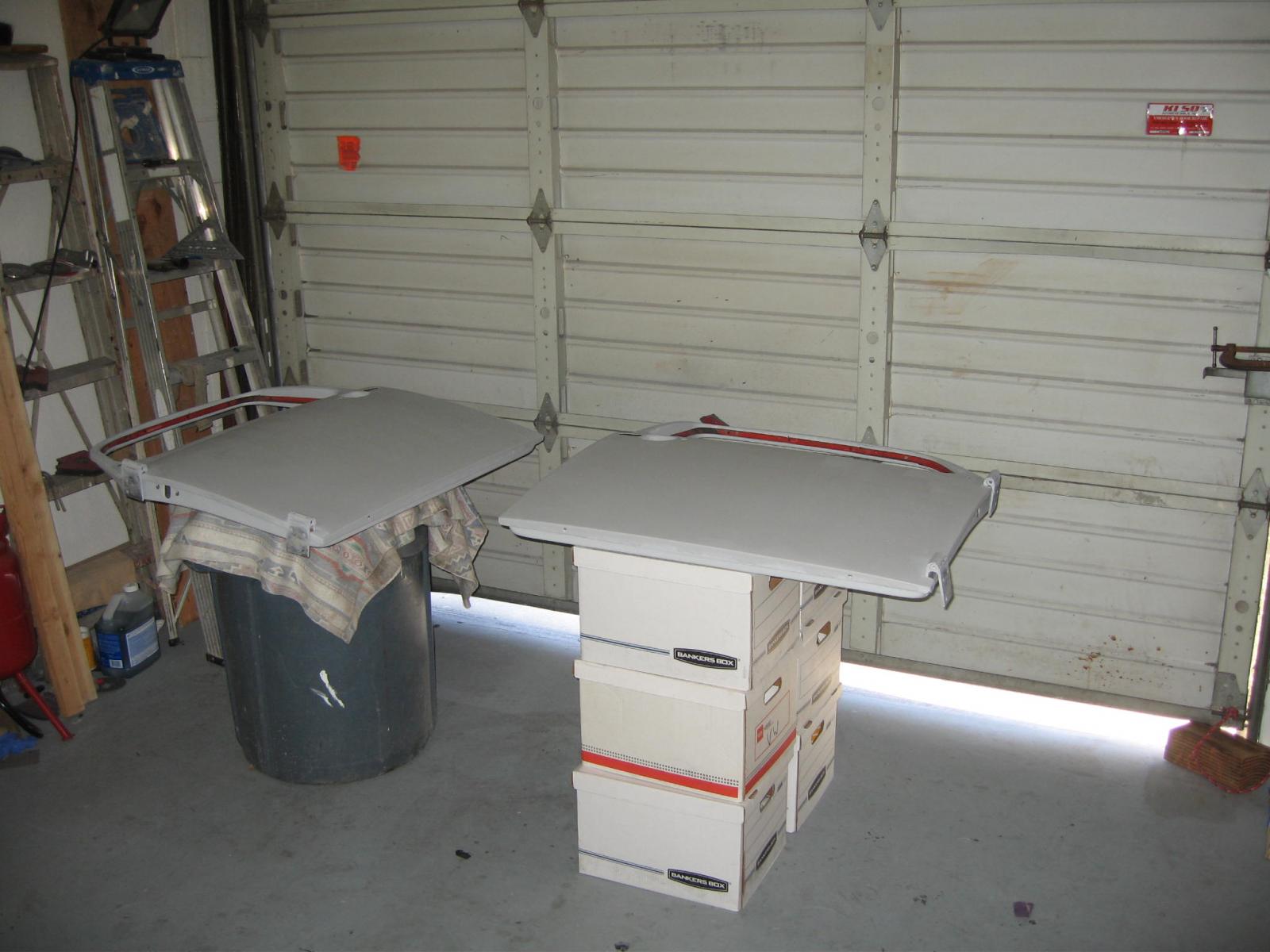

Door painting Cool
I have a gray door and I want to paint it red. OOOYeah Cool
Epoxy, poly fill than urathane. than red Cool Cool
Sand sand sand. I have an electron microscope in case I missed a scratch Shocked
The painting order.

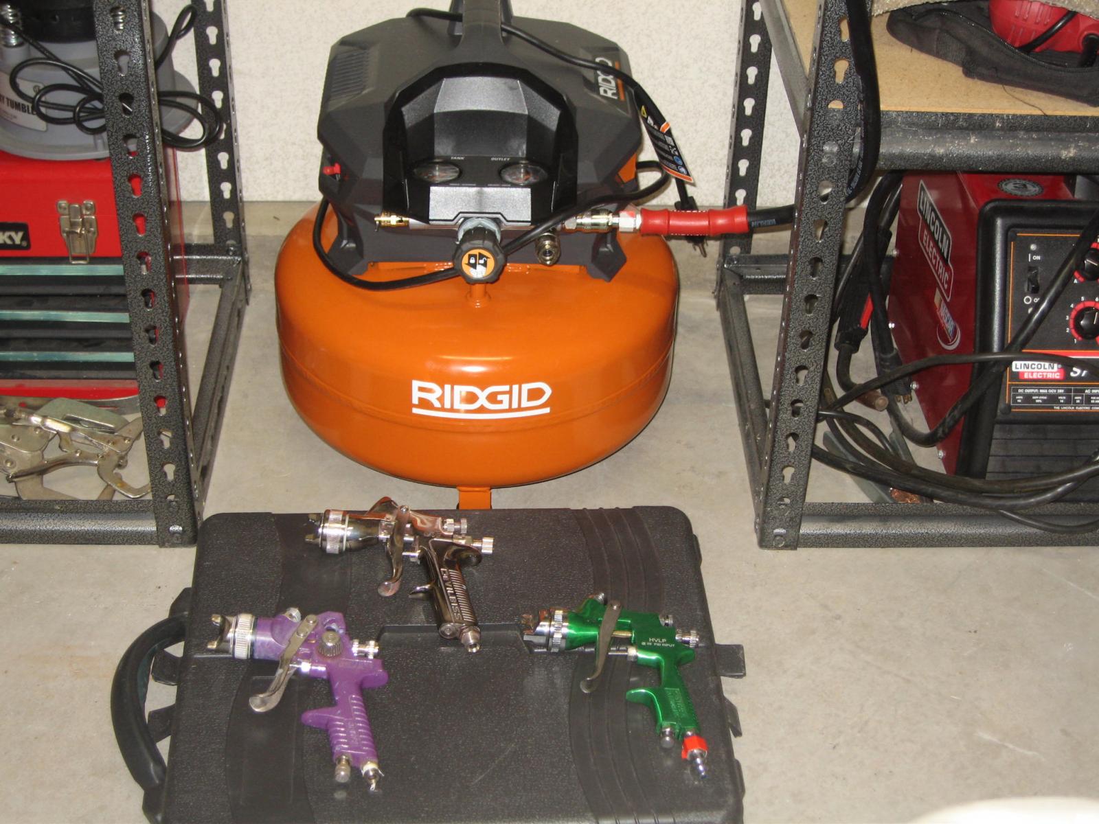

Ready to paint a whole beetle with this combo? Question Question Question Arrow
Witch gun??? The $10, $20 or $400 hmmmm Cool
Can it be done. Lets find out Cool
Buggeee
Joined: December 22, 2016
Posts: 4893
Location: Stuck in Ohio
Buggeee is offline
PostPosted: Tue Jan 24, 2023 8:36 pm    Post subject: Re: 1973 Bubbled Rear Apron & Restoration Thread Reply with quote
You are not in need of anybody's advice, specifically mine, so here's my thought on painting with a small compressor.
It will be running all the time to keep up with the gun, so the air will be hot and full of moisture. My solution was to run a 50 foot air hose up the wall, accross up to a peak in the middle of the garage, back down to the other wall, down the wall, and near the bottom tee'd off a drip leg with a ball valve at the bottom to let the water out. The whole run was shaped like an upside down U. I also had a tee'd off drip leg with ball ball valve at the compressor side as well, one at the bottom of each end of the upside down U. The idea was to give a long run for the air to cool down and moisture to condense out before hitting the filter at the far end of the run (like a moonshine still) From the filter I ran the 25ft air hose to the gun. At the gun handle, I also had a small clear air and oil separater to see the condition of the air at the gun and then one of those disposable orange ball filters between that and the handle of the gun.
I was amazed at the volumes of water that this long run was able to condense out at both ends. I still burned through filter elements even though the filter also had a drain.
I like the pressure to be 40psi at the gun, and then use the gun air control knob to fine tune it from there. Fan control basiically almost wide open.
I cant wait for it to warm up again over here. I've now got a toilet paper filter on my big compressor and I love it. The elements are almost free, single ply rolls.

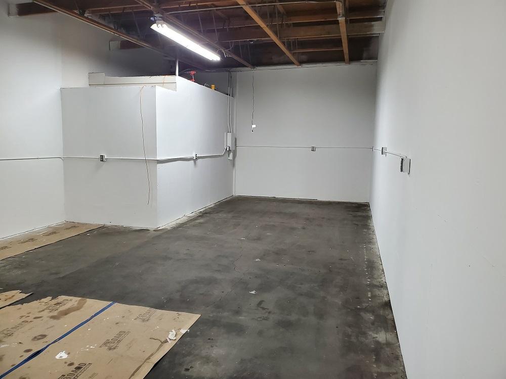

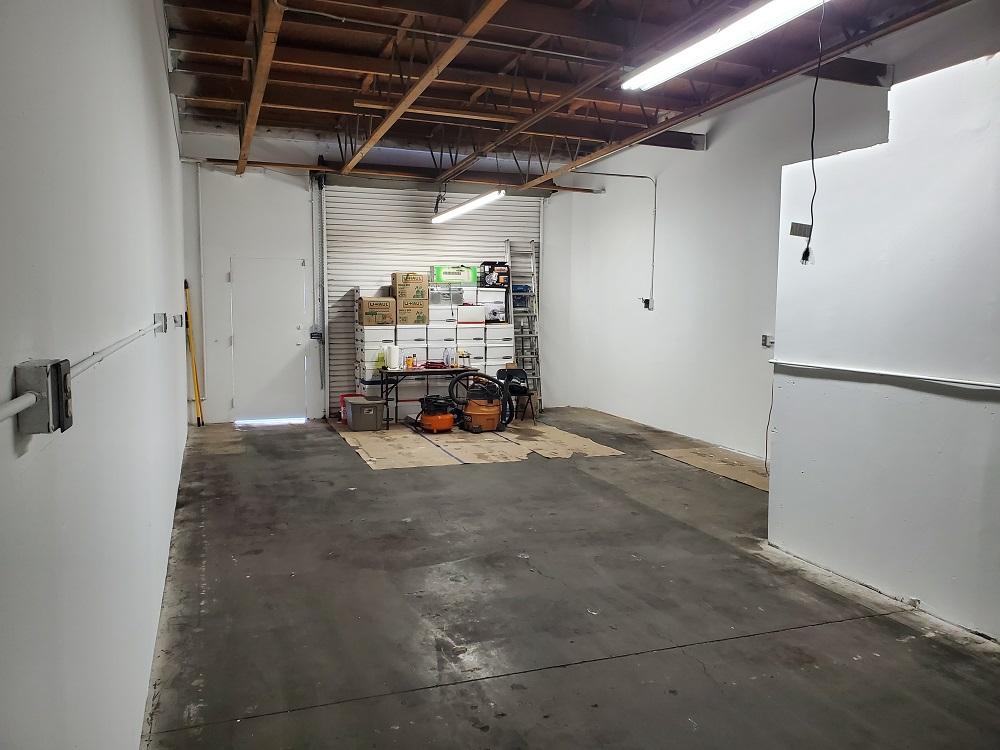

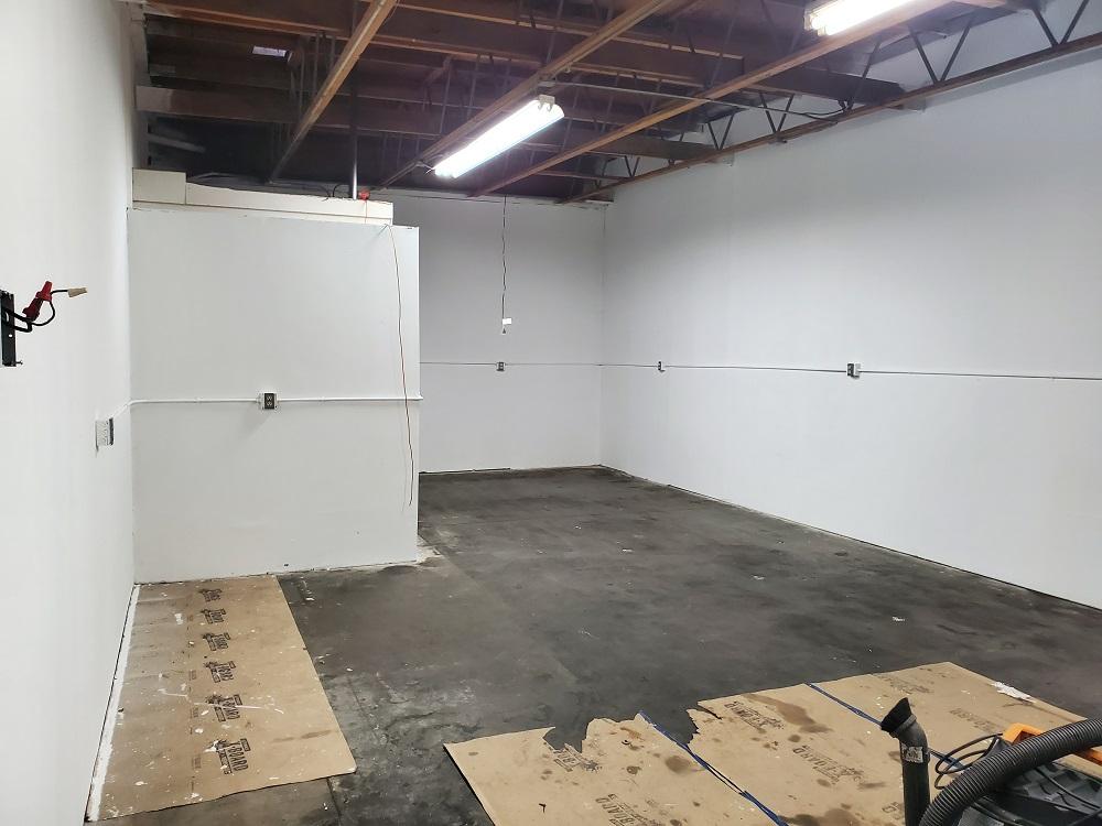

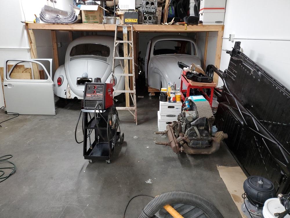

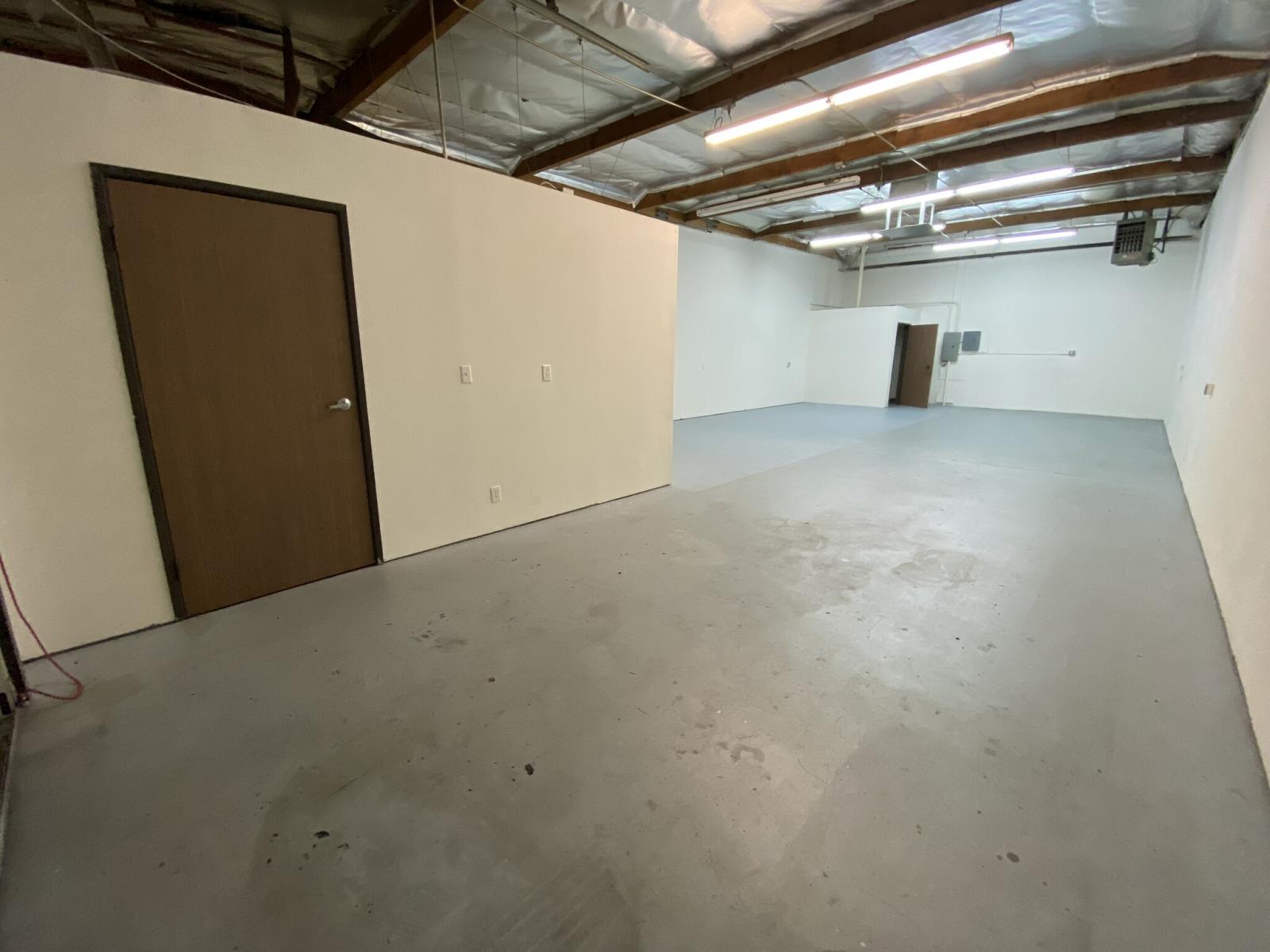

Got a new shop Cool Cool Cool Cool
Dirty Arrow Arrow
Painted, Rolling 14 ft walls. The fun Mad Mad Arrow Arrow
$100 and hours of rolling. Time to transfer beetles and make it pretty. Than back to finishing. I did it, I did it Cool Very Happy Very Happy Very Happy Cool Cool

Finish insulating the roof/ceiling, exhaust venting and Question Question Question

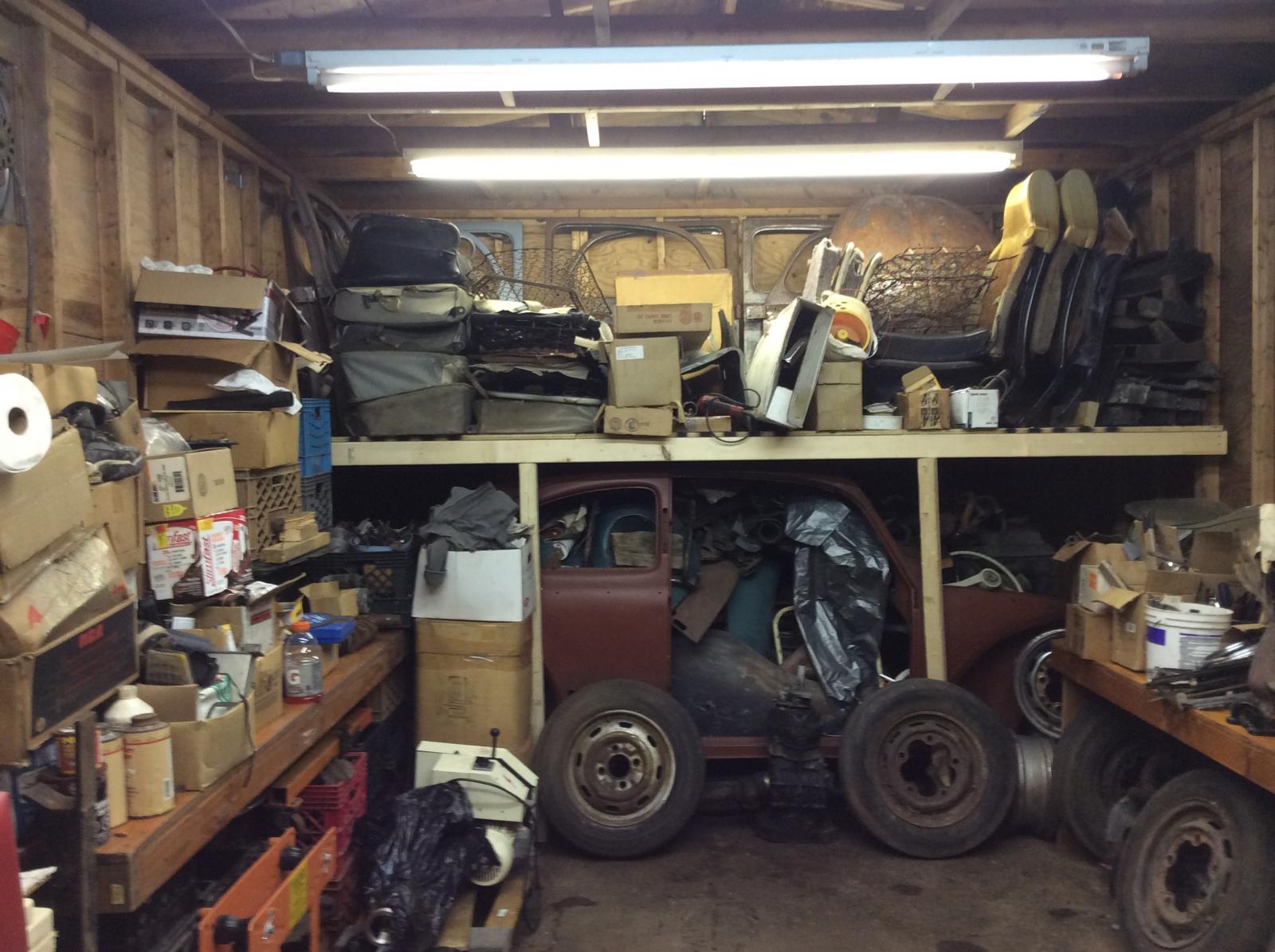

That right there is storage efficiency! Lookin smart.

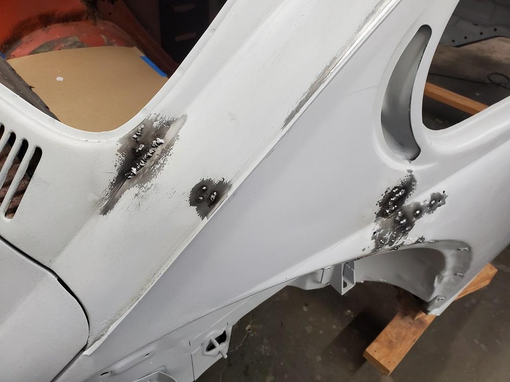

Since Ive been in the welding mood Cool Cool Cool
I will finish up all the welding Cool than re-prime and, um, Question Question Question

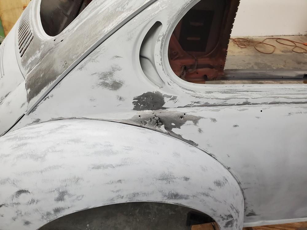

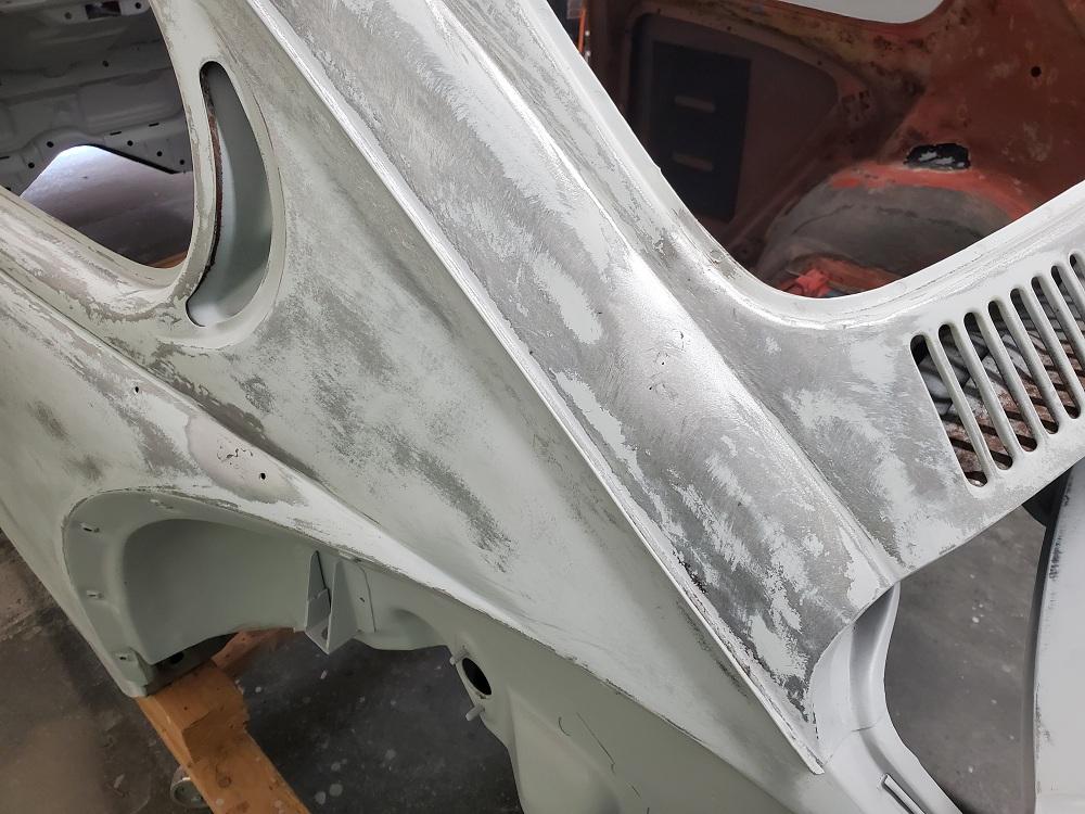

Ready to finish this time. Im in Prime, Fill and Sand Mode Very Happy Cool Very Happy
Before its too hot, lets see what I got Very Happy
Sands in minutes, its so tiny compared to the tank,
Reprime epoxy, weld some, again, urethane and ready? Question Question Question Idea Idea Idea

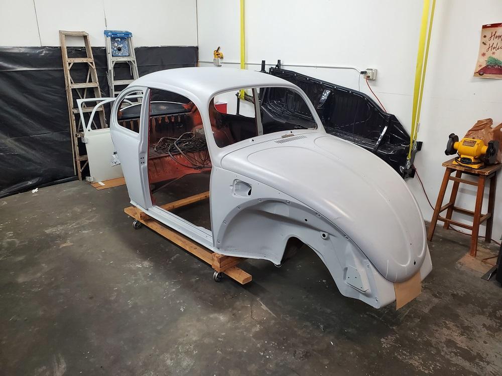

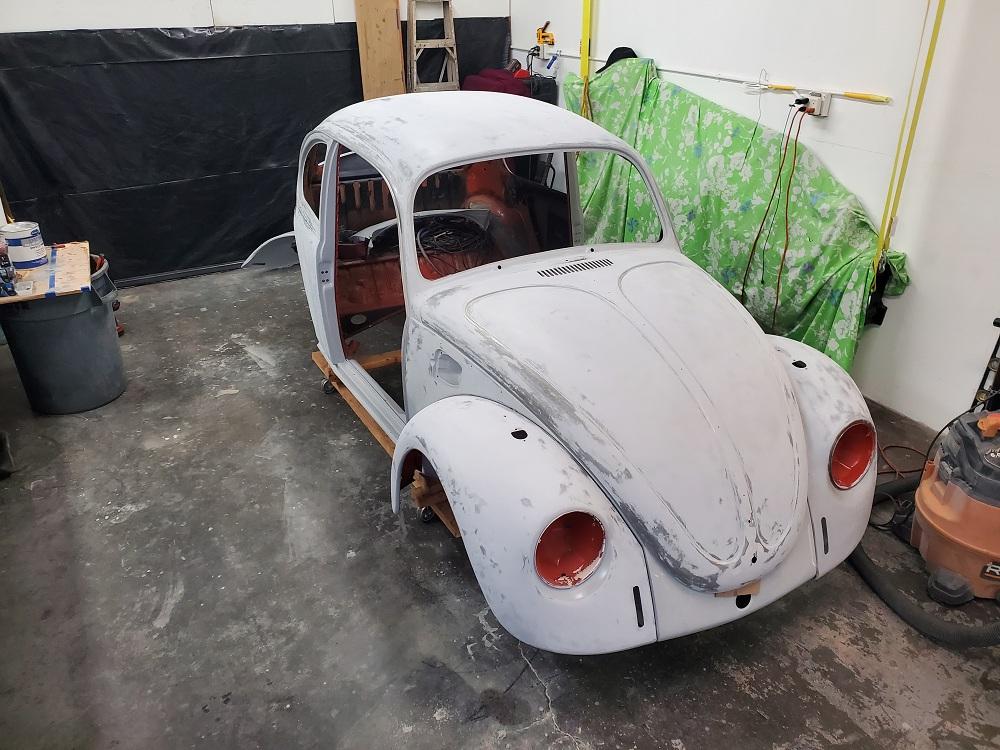

PostPosted: Thu May 15, 2025 1:13 pm    Post subject: Re: 1973 Bubbled Rear Apron & Restoration Thread Reply with quote
Motivation baby....How U Ask Question Question Question
Drugs,
little sudafed for the sinus and U gots MoTiVation Shocked Very Happy Cool
Beetle Booty Cool Cool Cool
Finish welding Cool Cool
Next Up Question Question Question Idea Idea Idea Arrow Arrow Red Bug Red Bug Red Bug Red Bug Red Bug Red Bug Thumbs Up

Welded up. Came out good. Cool Cool Cool
Somethings wrong here. Why can I see through it, hmmm Shocked
